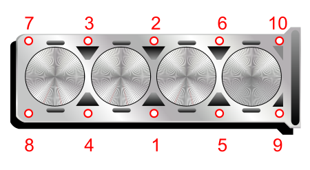

So after things going so well and dyno booked I found a leak, not massive but coolant drips from the head gasket. Exchanged a few messages with Alex and by all accounts a HG leak on an F4R is very rare which pointed to something being wrong. I went through what I had done and looked at the pictures I had taken when I remembered that I had used the new HG when checking the piston to valve, only torqued to 20Nm and I remember checking on the internet if this was ok. It looks like it wasn’t. I had also spent so long on working on the head I believe I had become a bit complacent on the surface finish.
Alex mentioned it might settle after some heat cycles, I slept on it and decided it wasn’t worth the risk. 3 hours later including a drive back to get my timing tools I had her stripped back to the block. I made the right decision as there was evidence of oil on the pistons and valves. Left her for a week as I needed a break.

what do you mean headgasket tighten to 20nm? I dont think thats possible.these are the torque setting if that helps.
Cylinder head
Renew the bolts
Renew the gasket
Stage 1
30 (Nm)​
Stage 2
155 - 205 (°)​
Yeah, 20Nm was what I used when measuring the piston to valve so that I could get an accurate measurement with the gasket compressed before she then came apart to remove the checking springs and torqued correctly.
