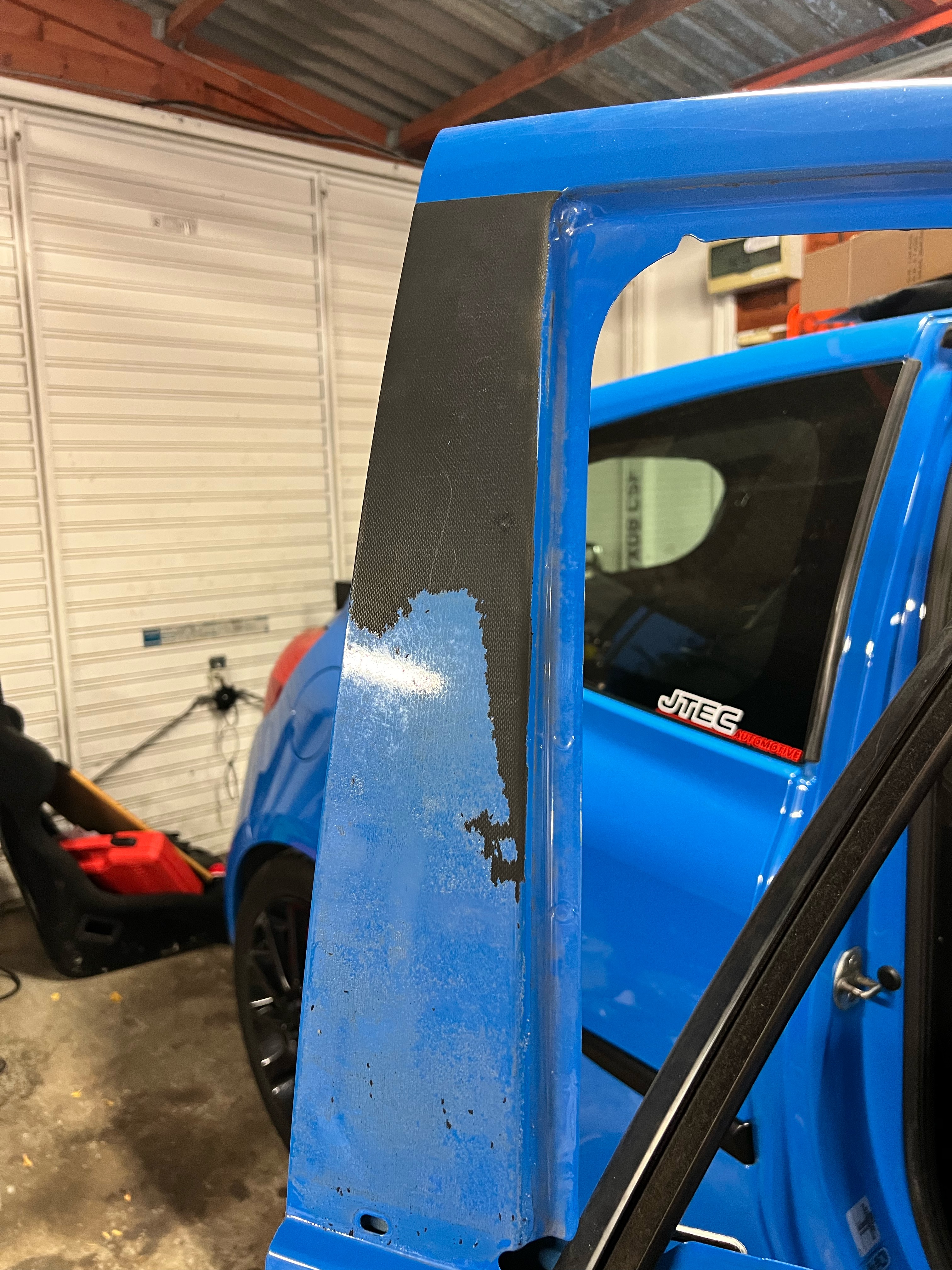

We decided to sort out the B pillars today. The Clio had a set of faded and crusty B pillar stickers with door weather strips that had seen better days. The drivers side was the worst with a clear visible white line down the edge of the door.
Replacing the B pillar stickers is a horrible job. But after some heat, scraping with an old bank card, and some tar remover the door was looking okay. The drivers side paintwork under the pillar sticker had turned very slightly yellow - but as it was going to remain out of sight it was not a problem

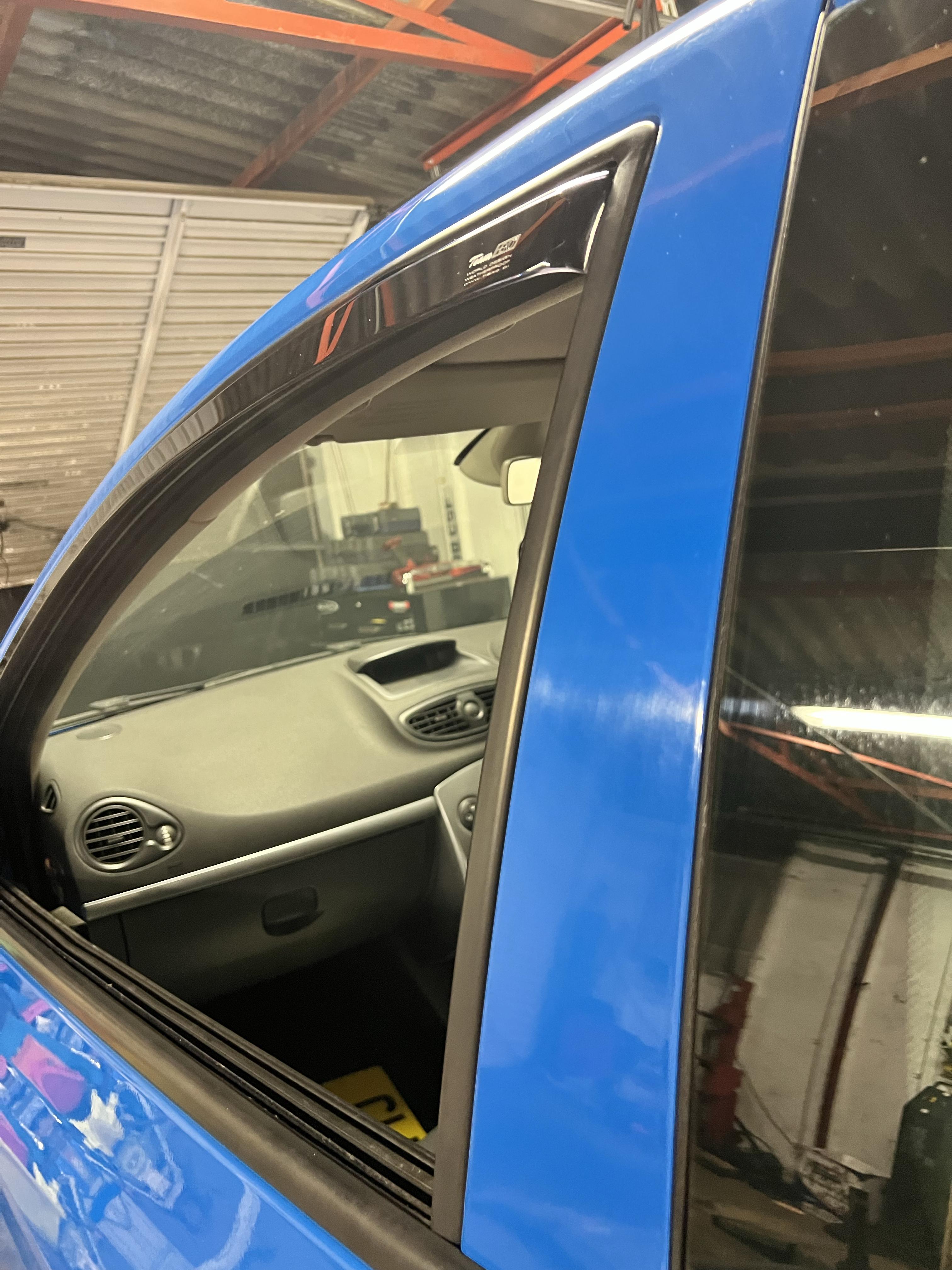

The B pillar sticker was carefully applied to avoid any bubbles. Once the stickers were on the new weather strips were put in.
After the window trims went back on the car was looking more presentable.
