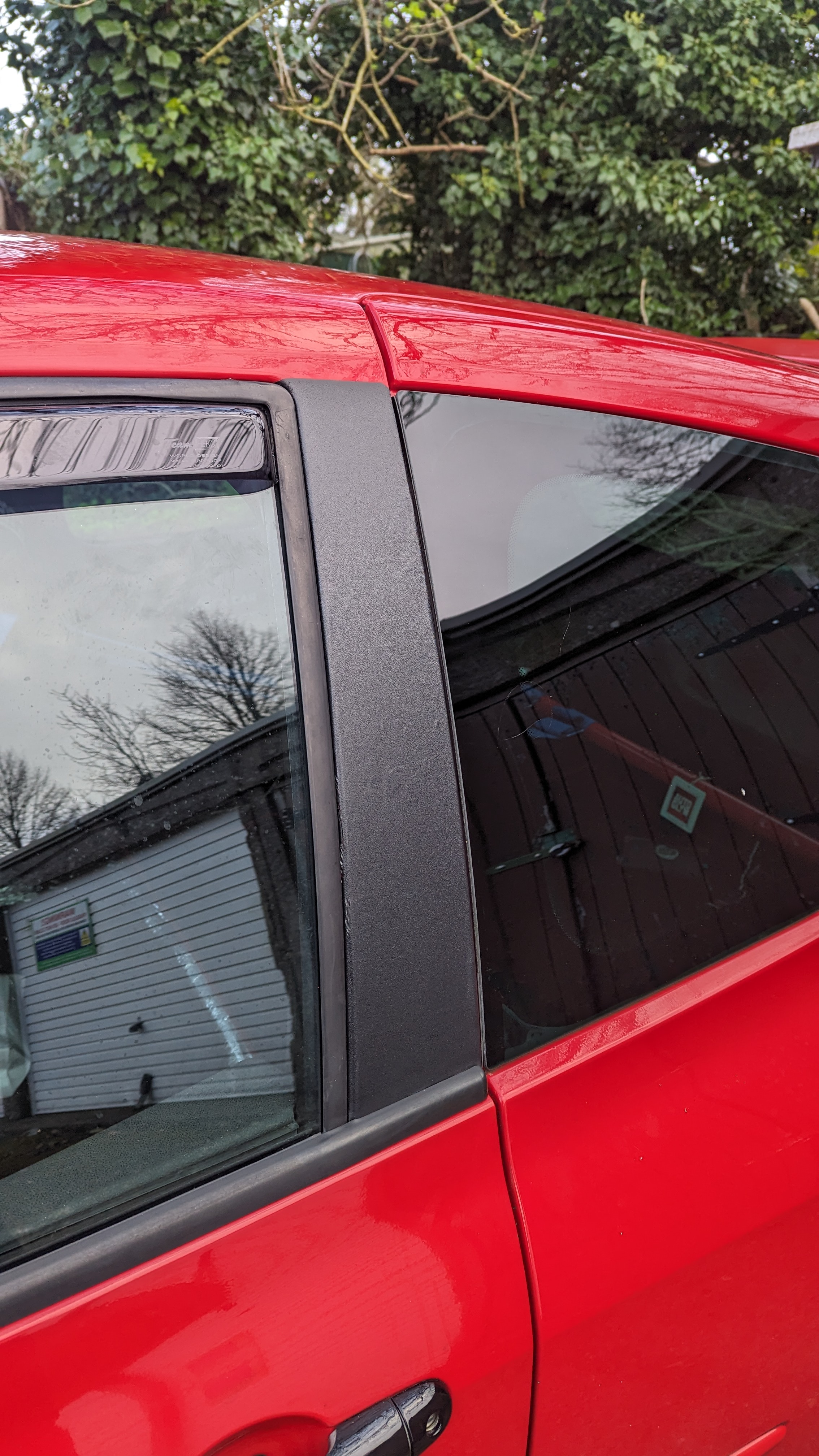

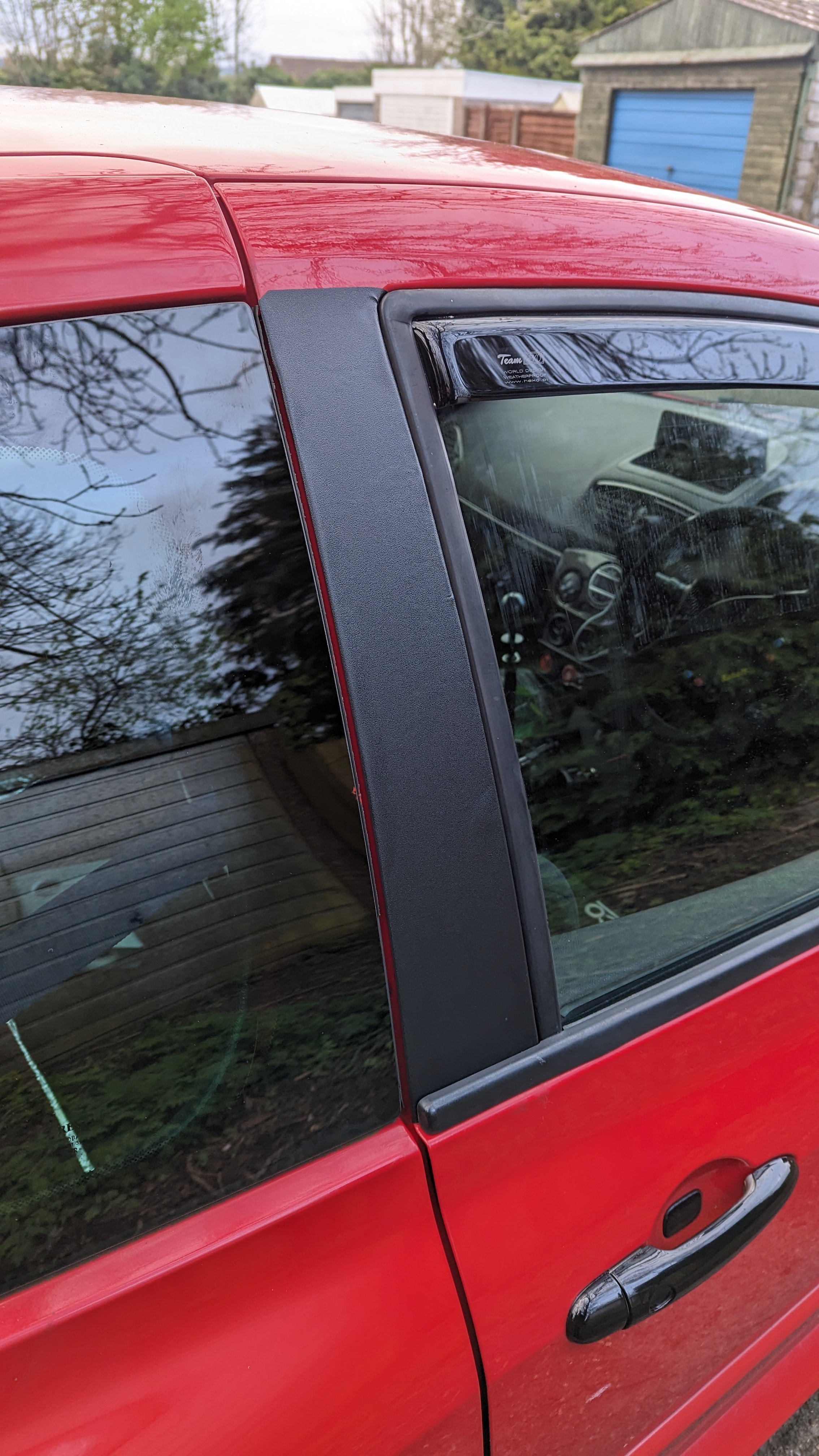

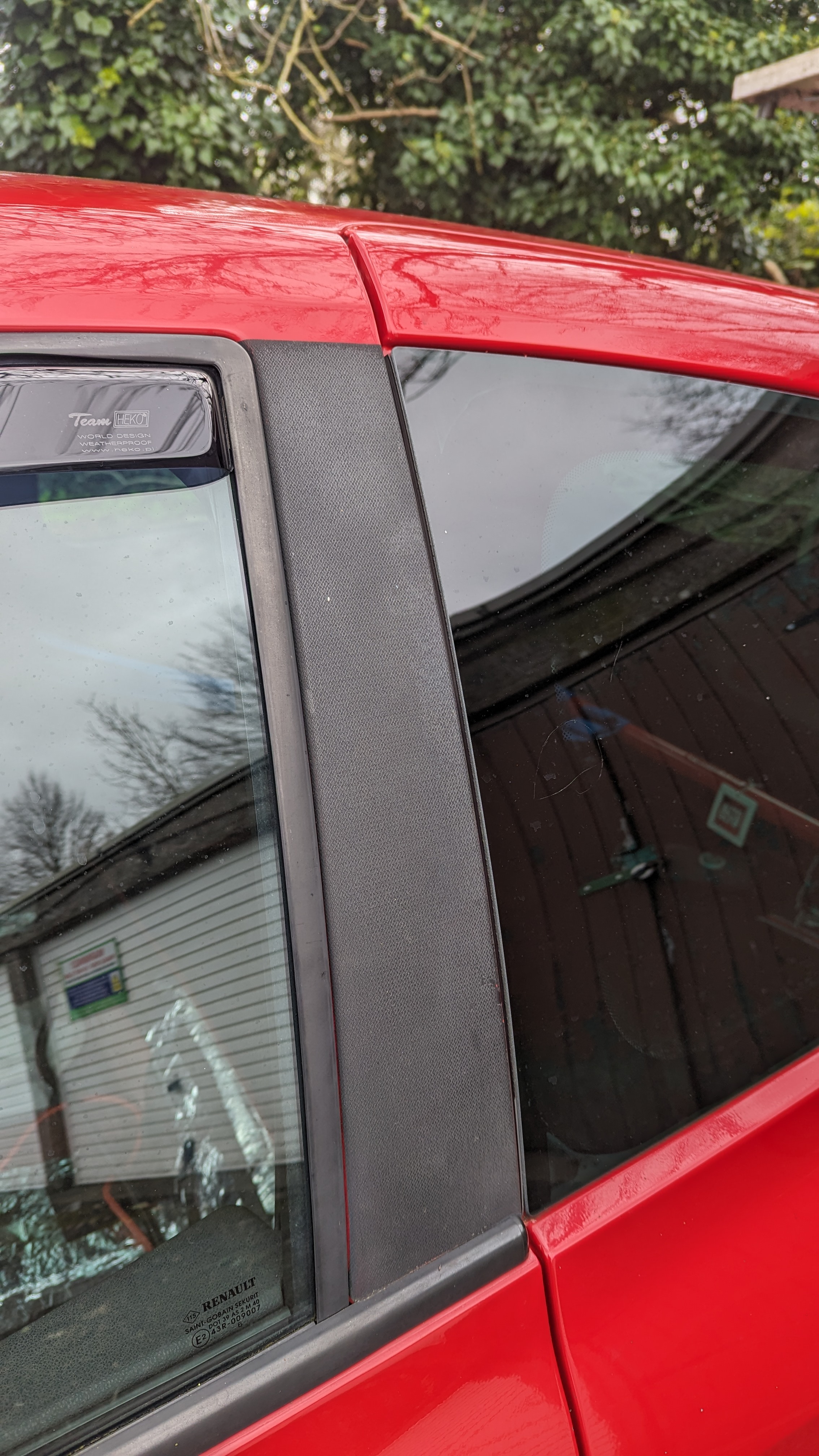

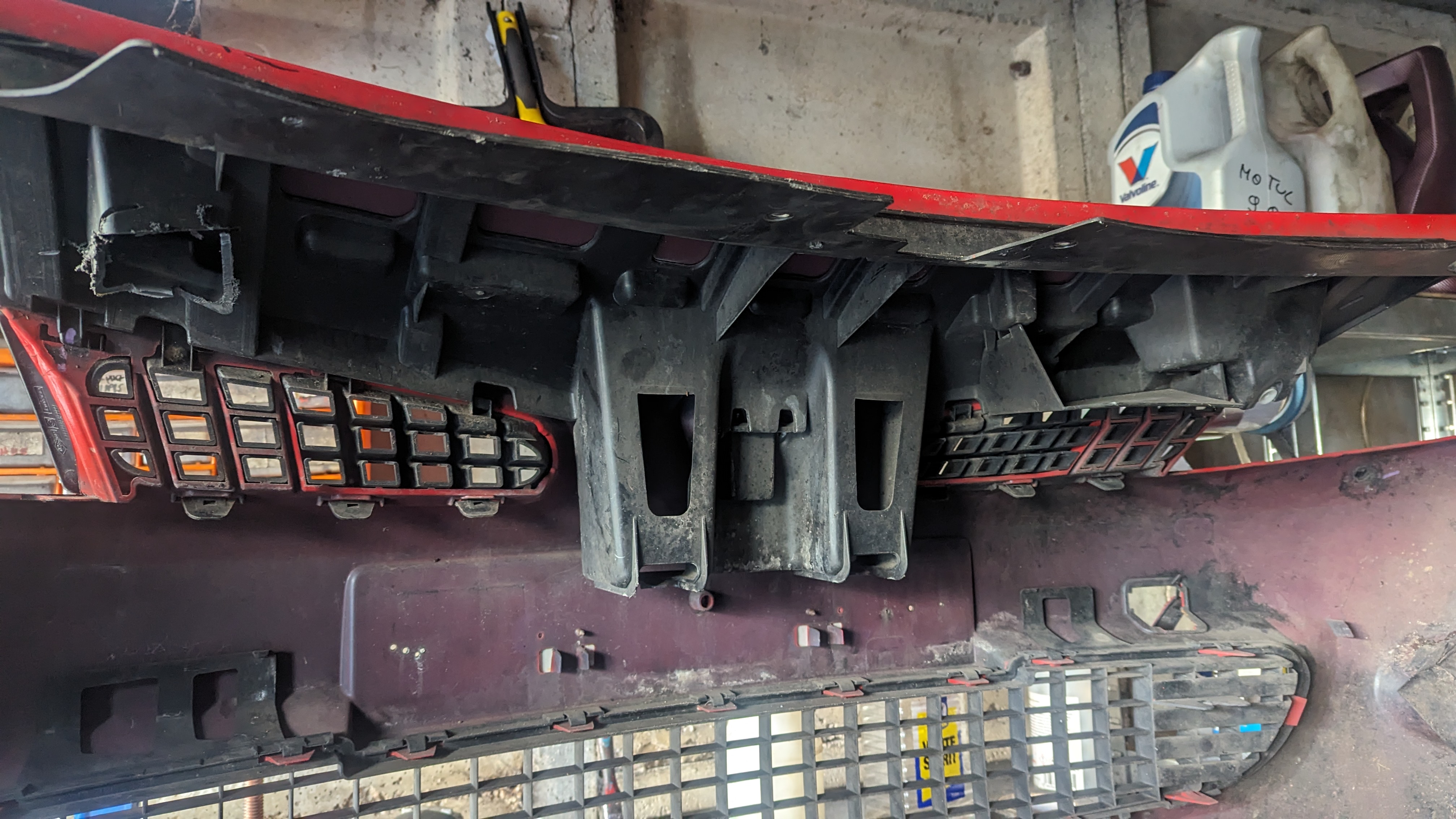

Few jobs to update,got around to fitting new door vynil as they were faded and coming apart,bit of a pain to take the old one off and the new ones aren't perfectly smooth but they will do for now,before:

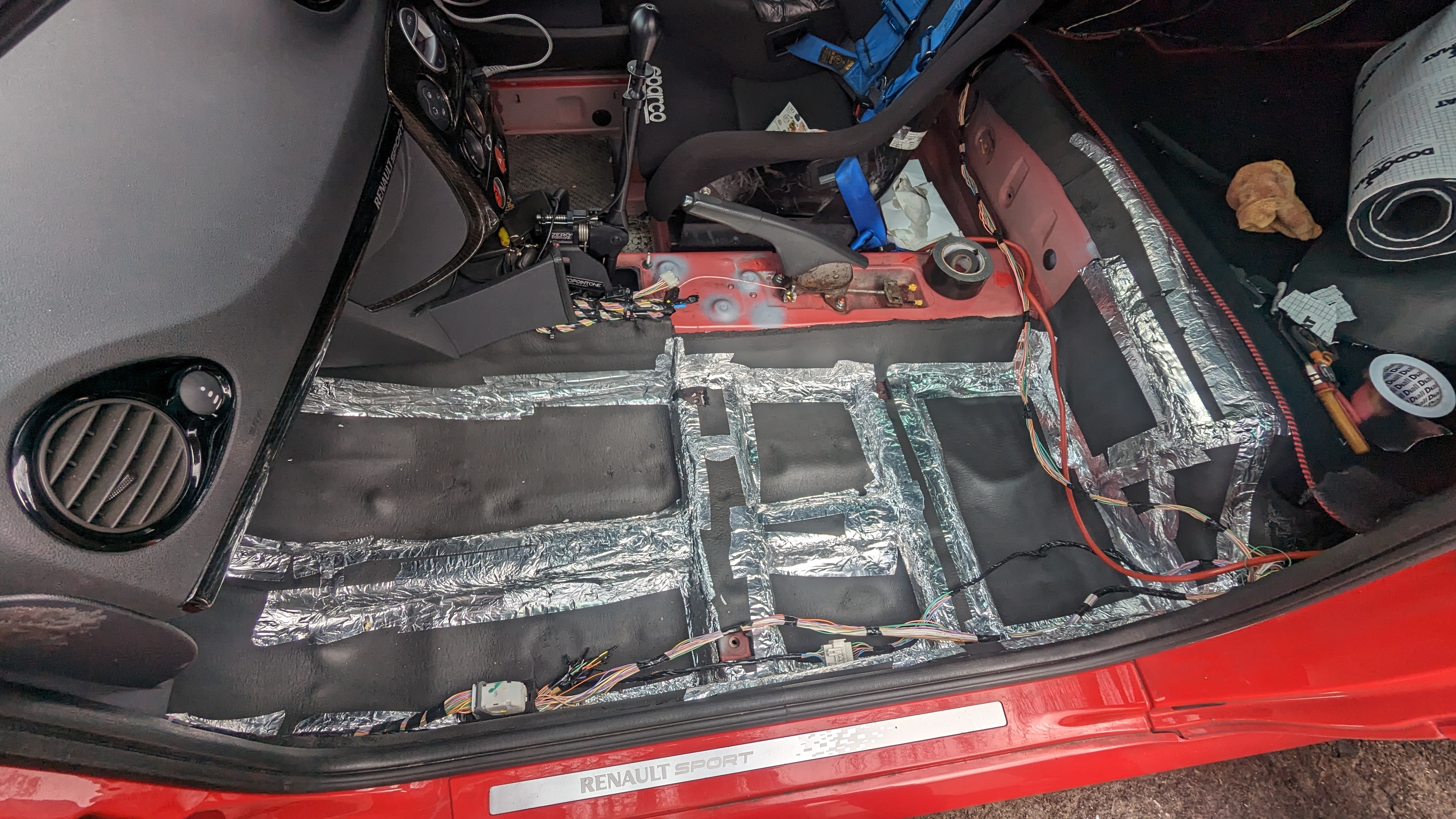

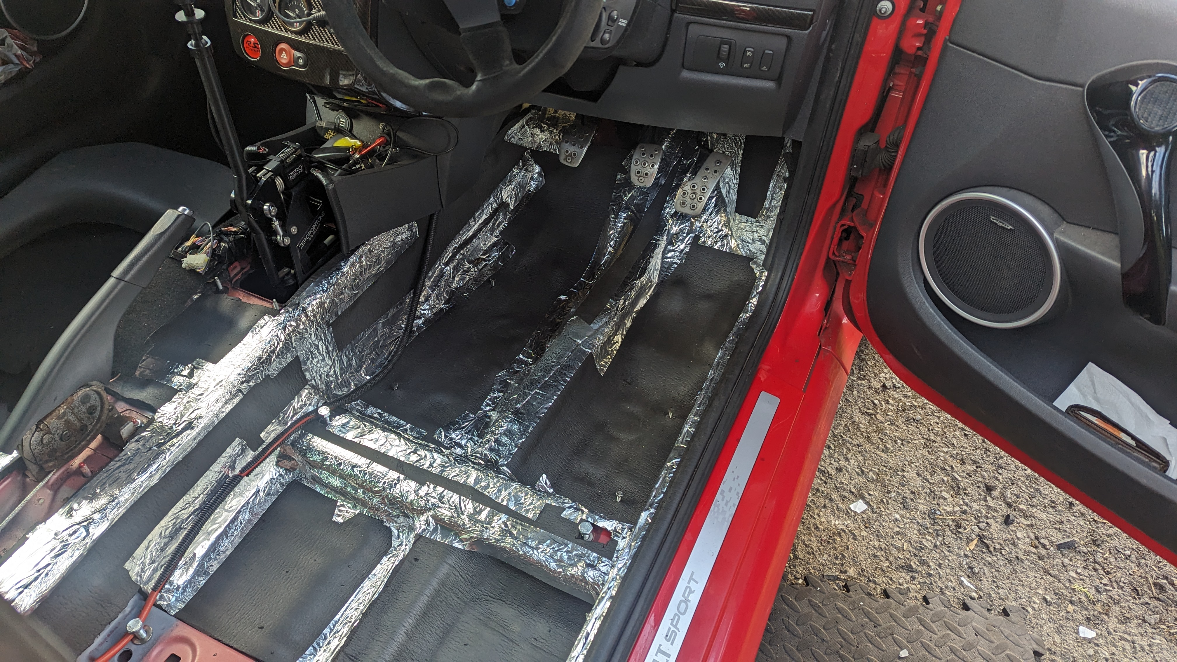

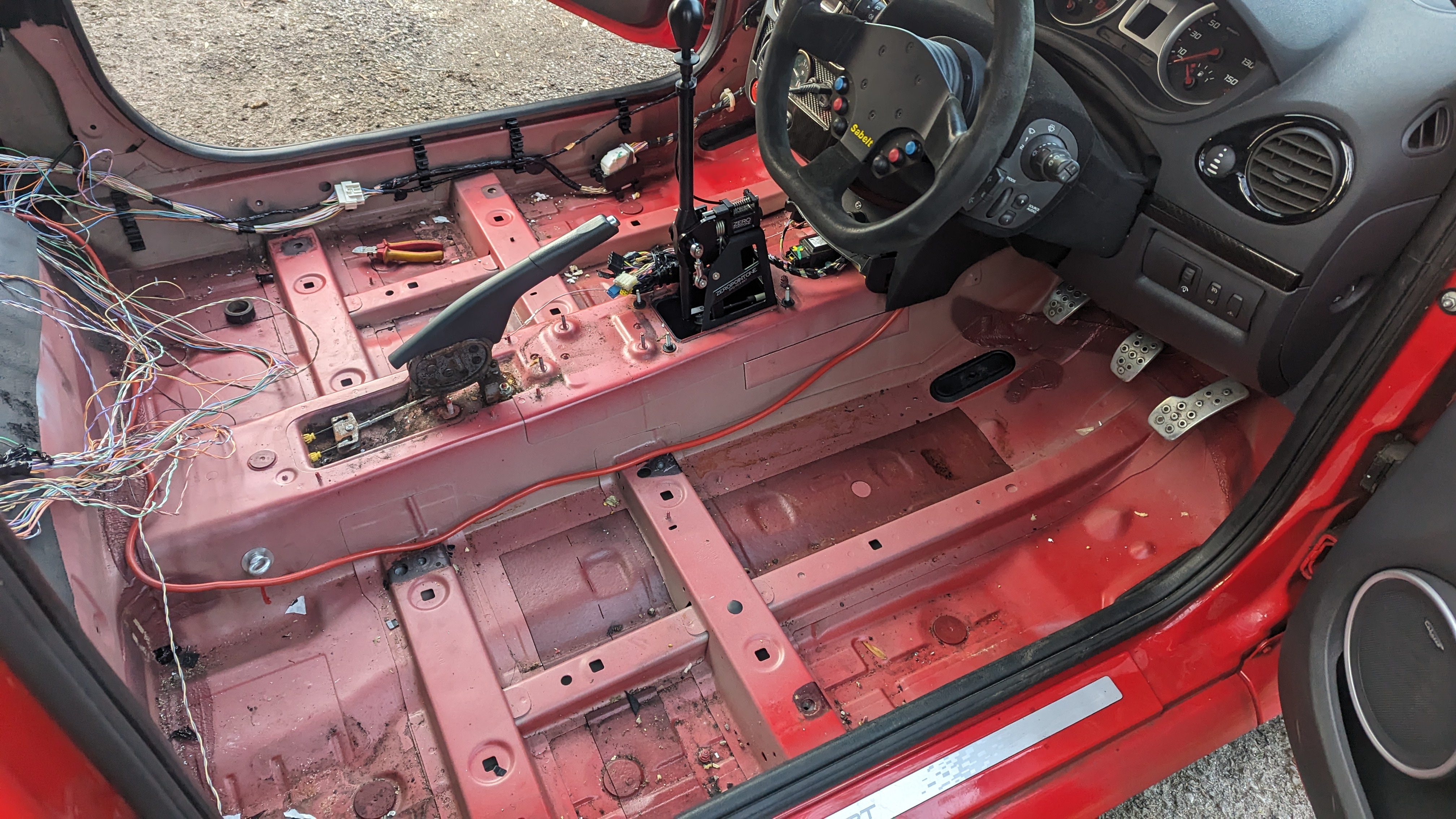

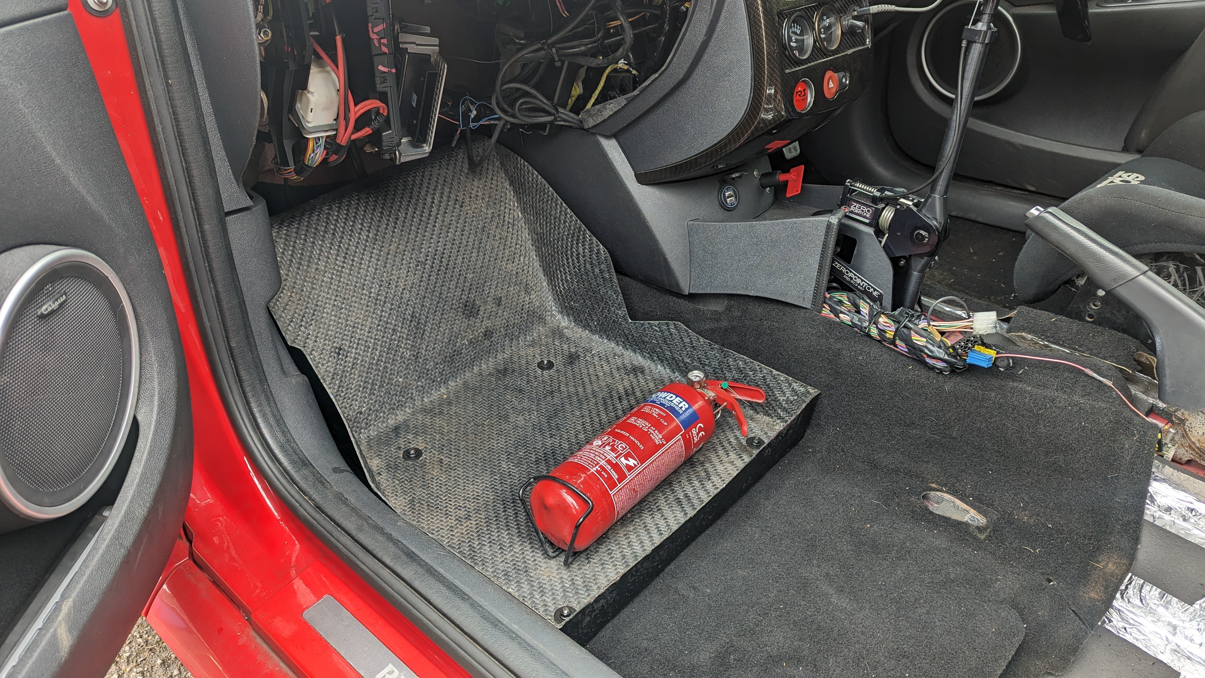

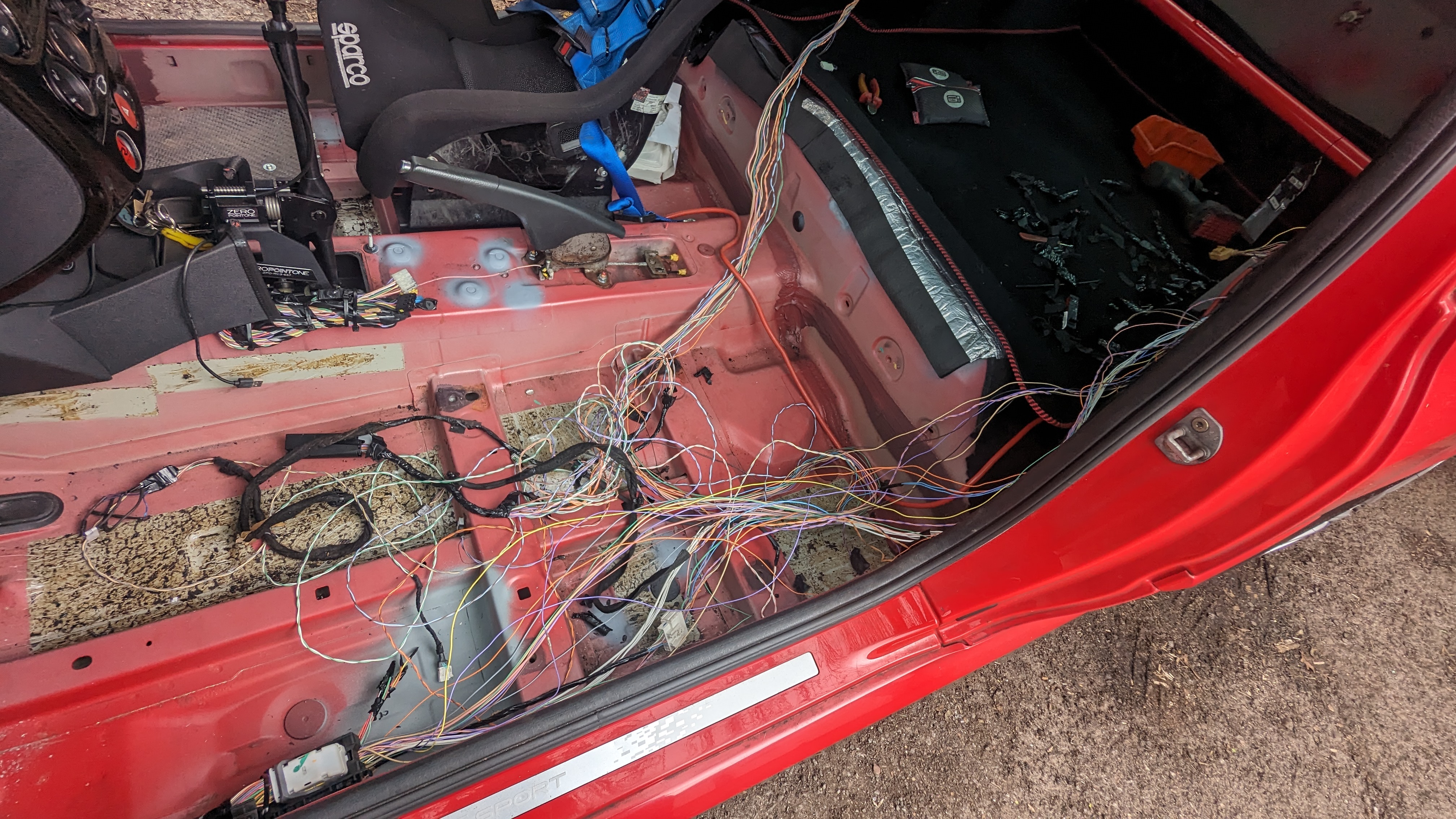

Got a passenger carbon footrest which I had from my last track car and put to use,provides a solid surface after removing all of the original sound deadening which was a lot thicker than what I fitted now,also installed a fire extinguisher just in case,safety first.

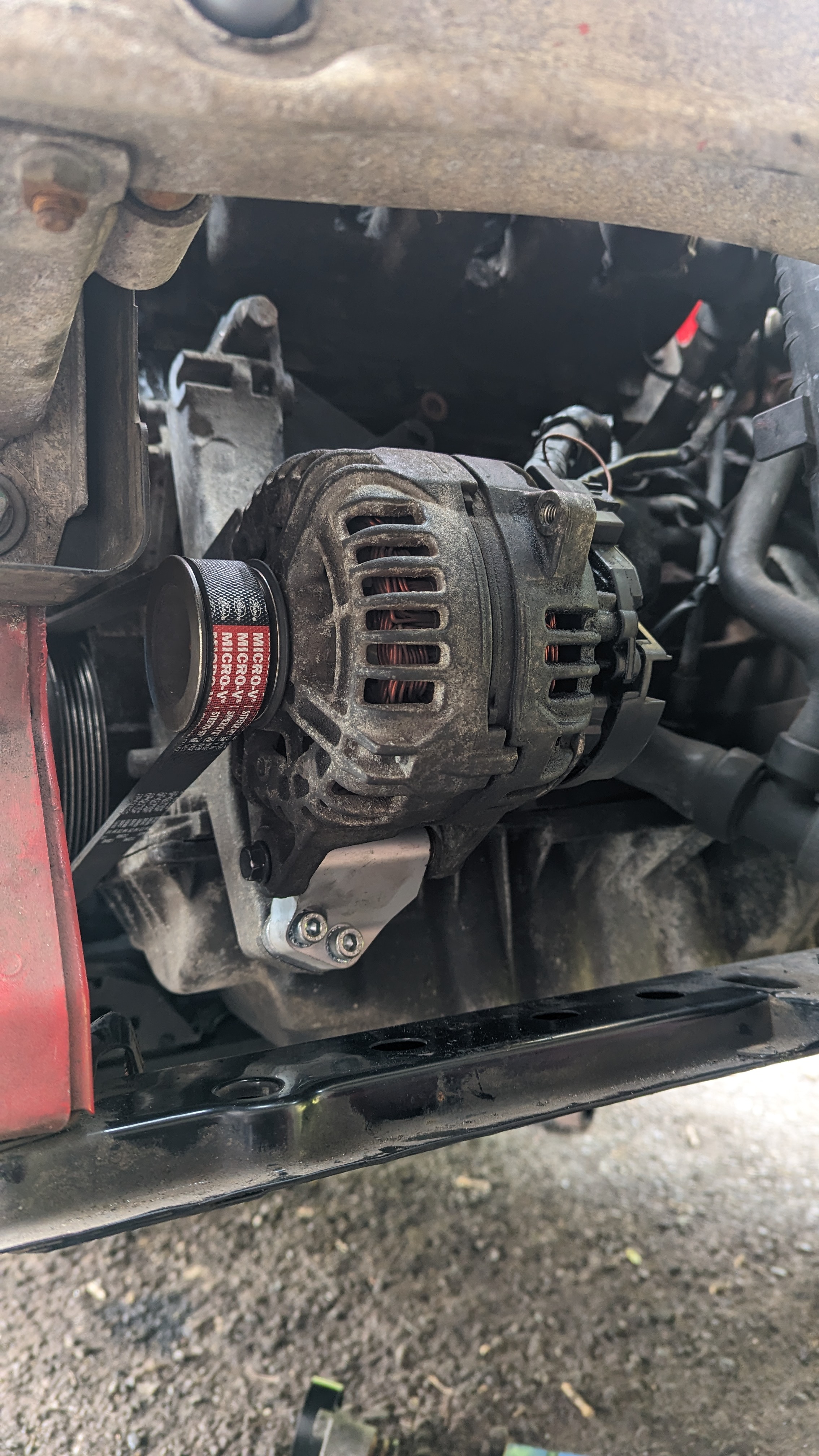

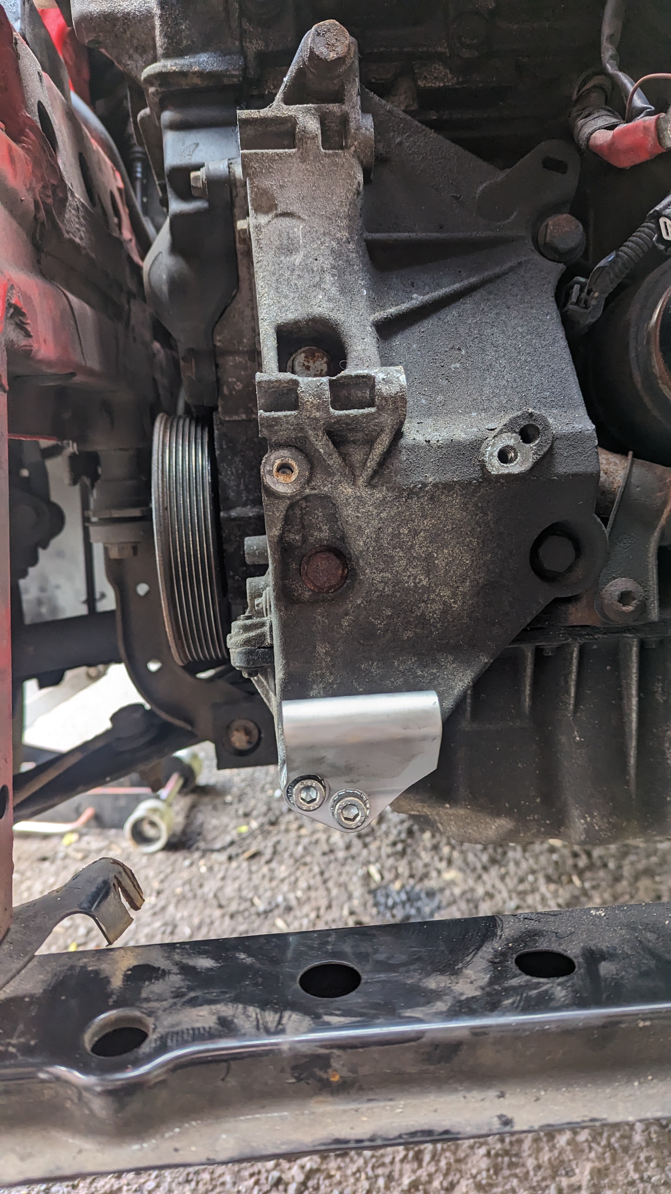

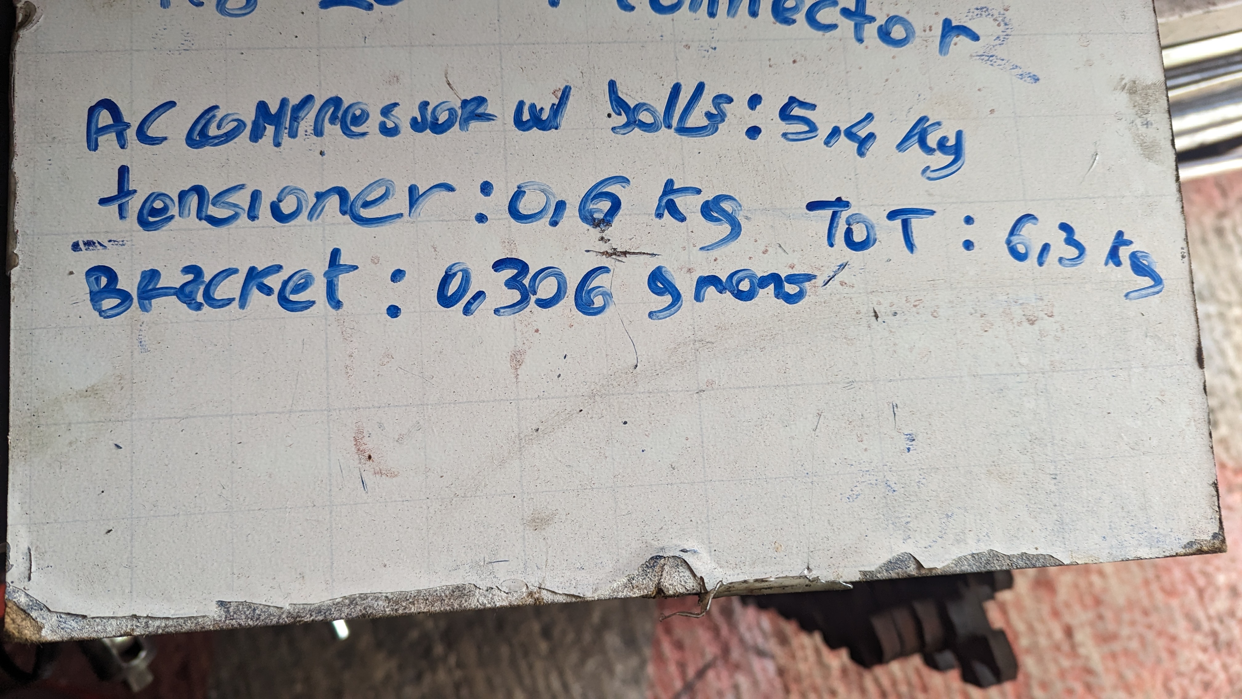

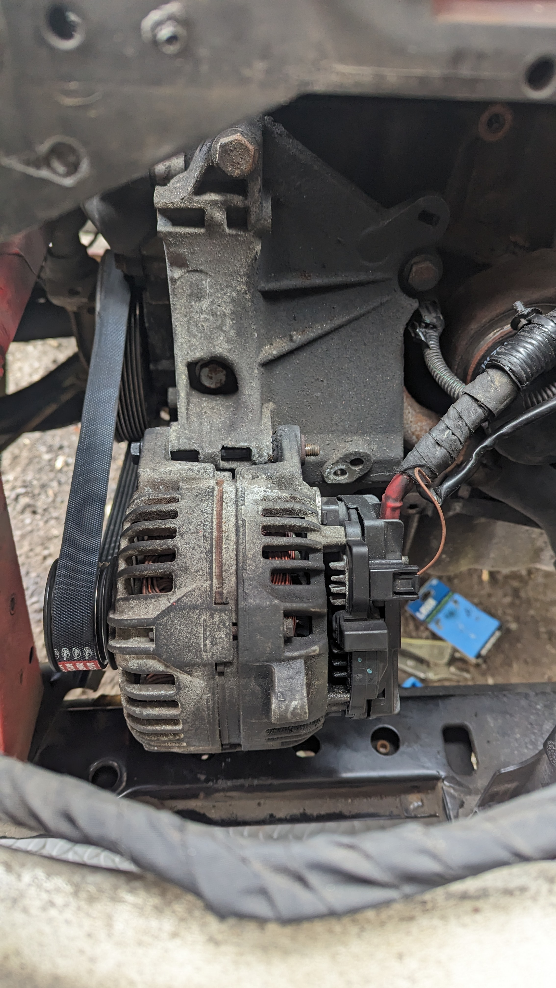

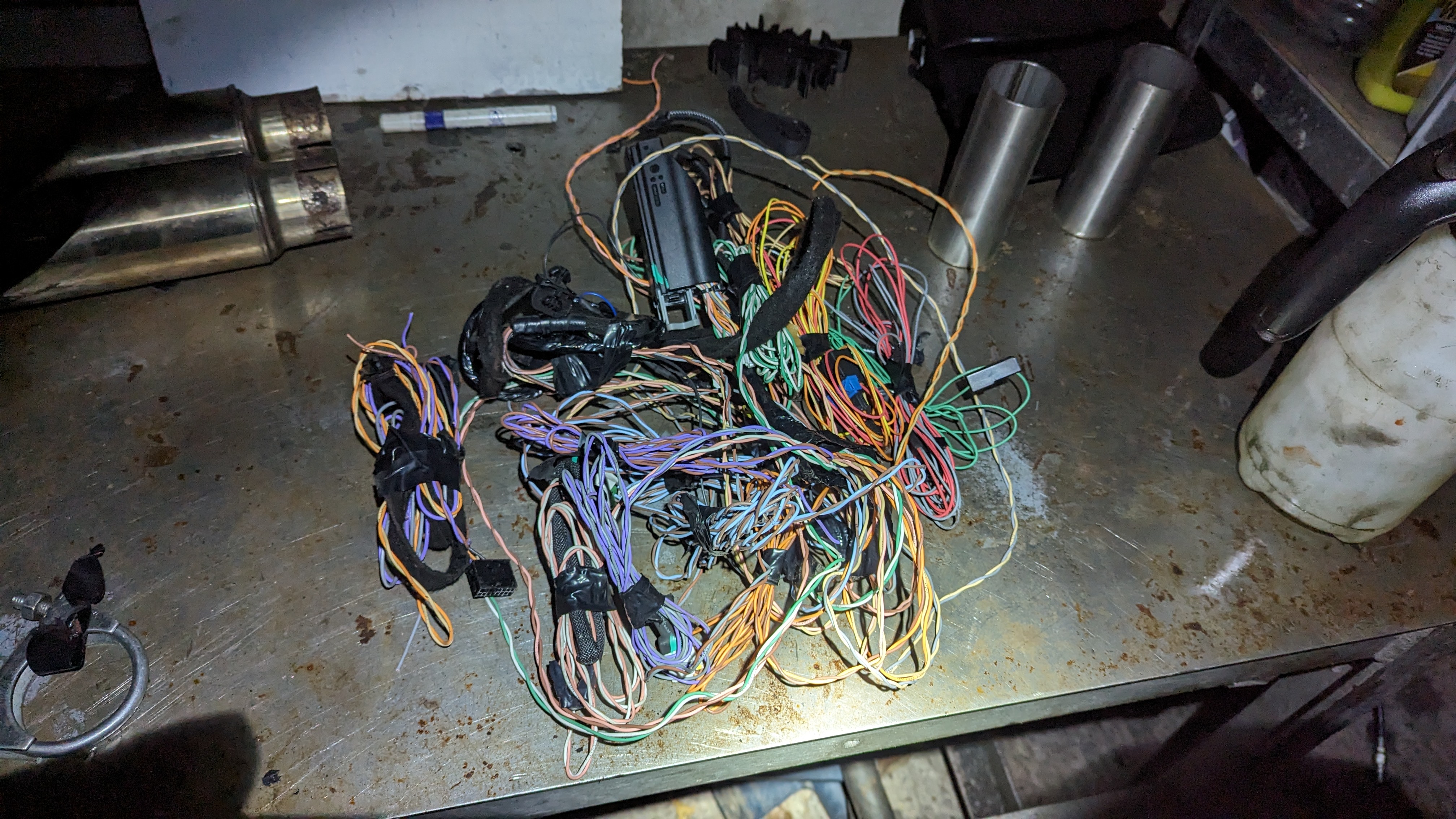

the AC stopped working due to a leaking compressor I suspect so just decided to remove it completely and fitted the Ktec kit:

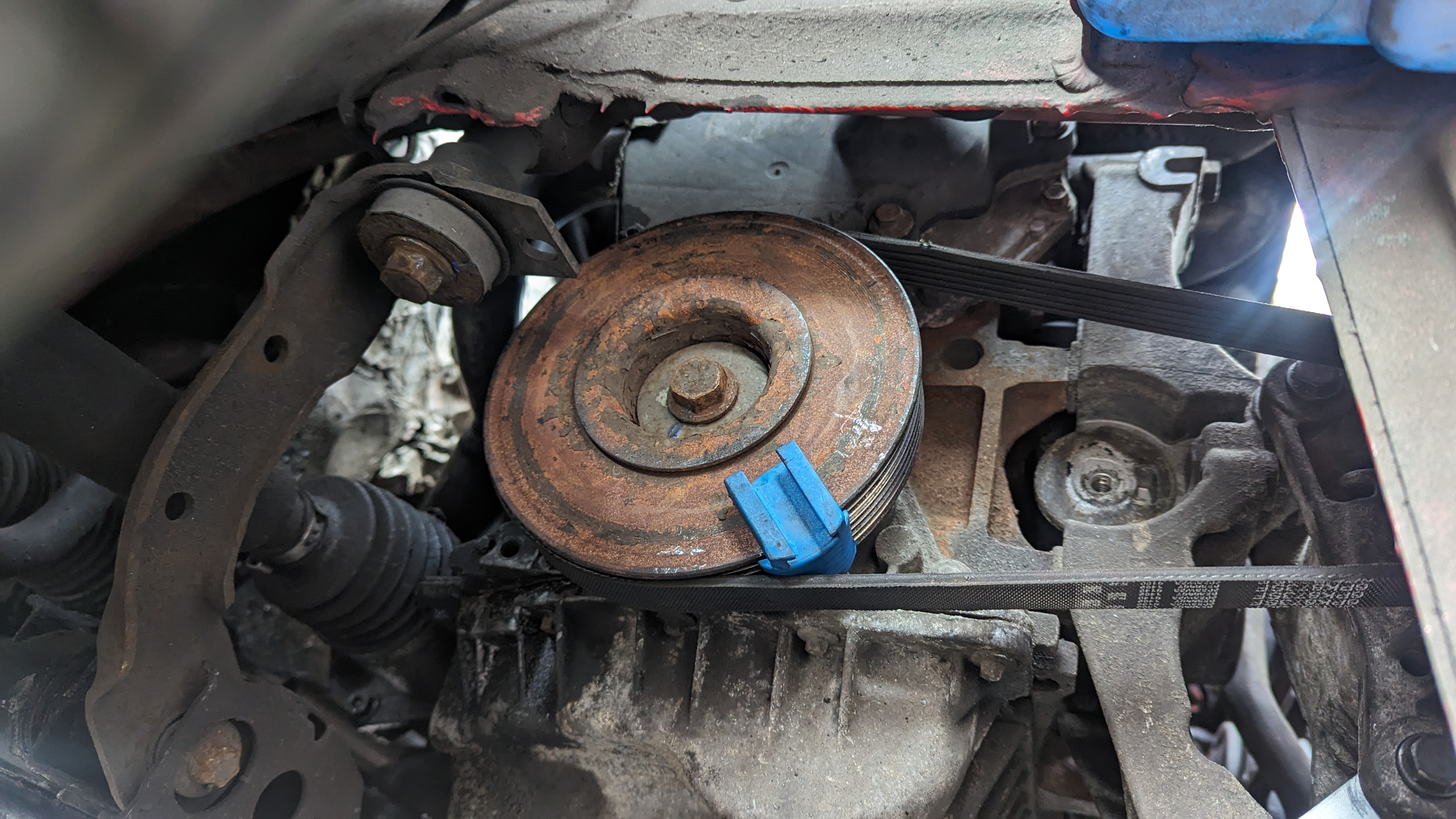

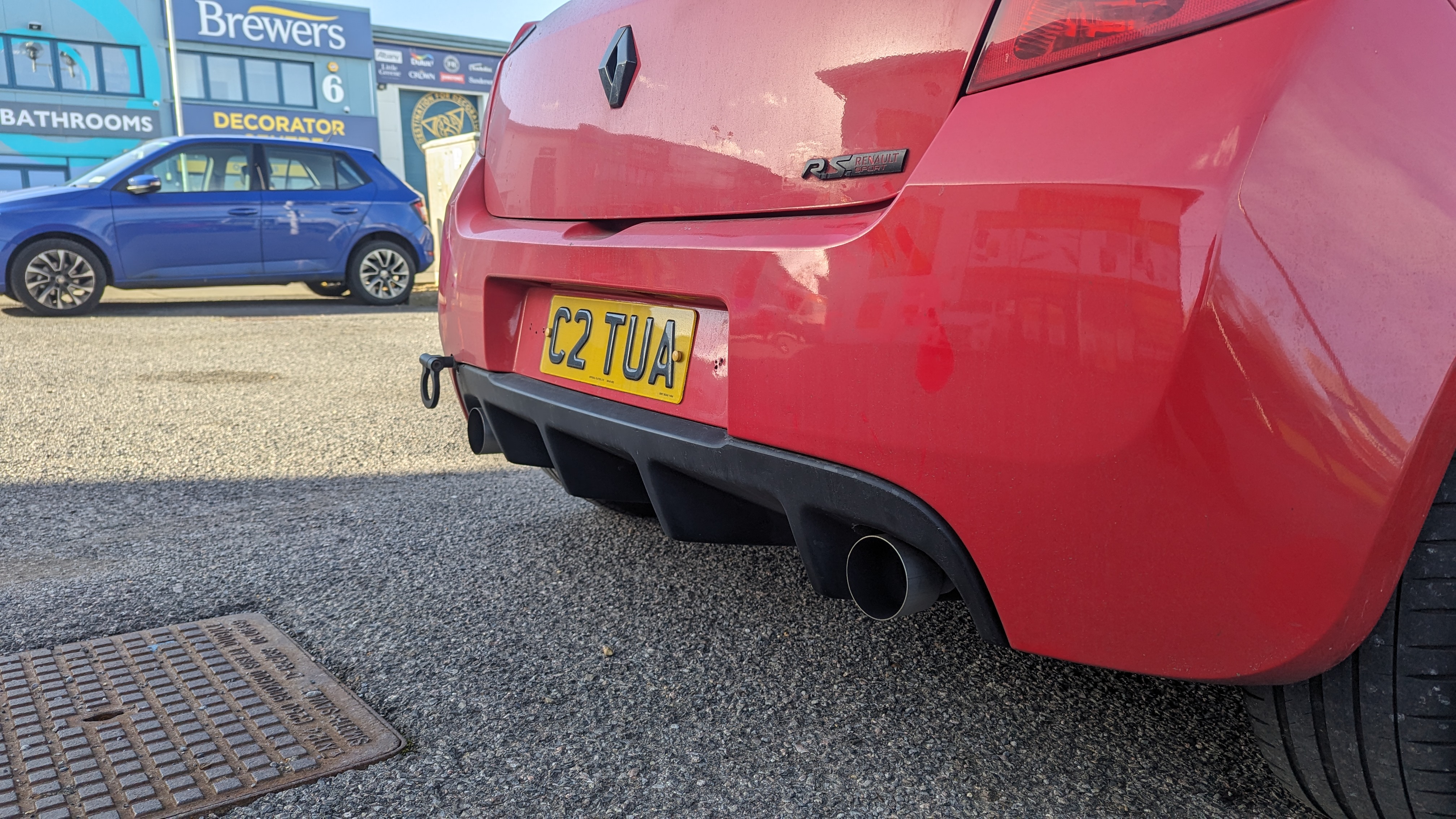

what a pain it was to fit the strech belt,in the end the Laser tool I had worked after much swearing.

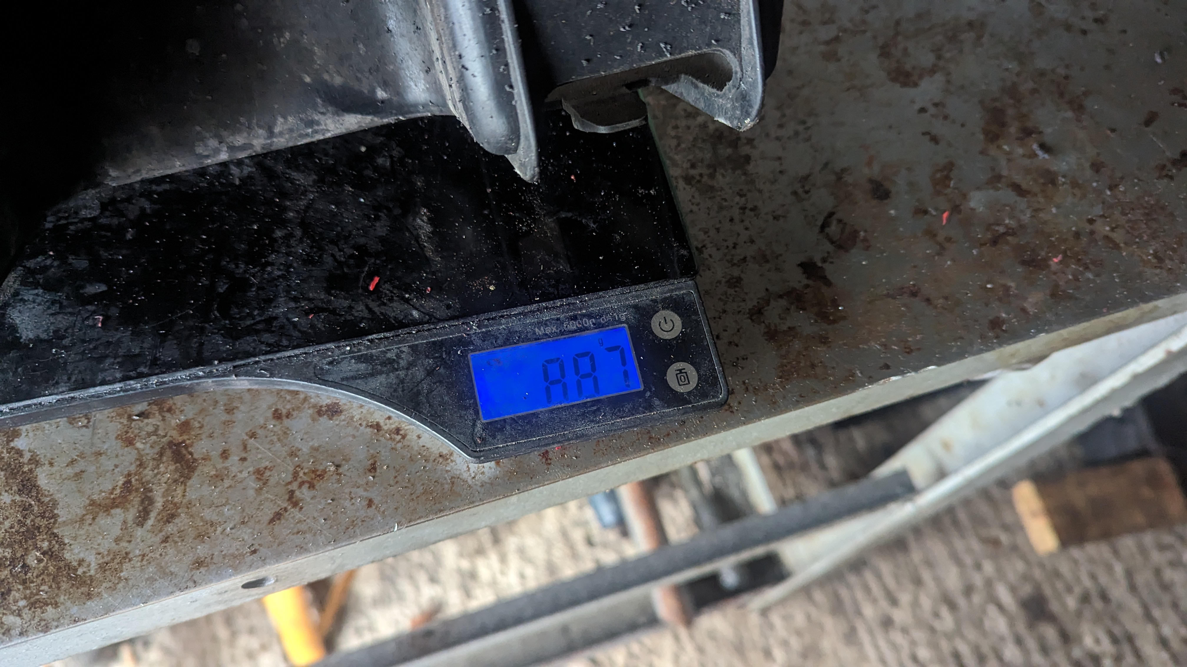

total weight saving for this kit is 6,3kg,pretty happy with it,it definitely feels more responsive than before,I'm now looking to fit the 182 pulley to save another kilo.

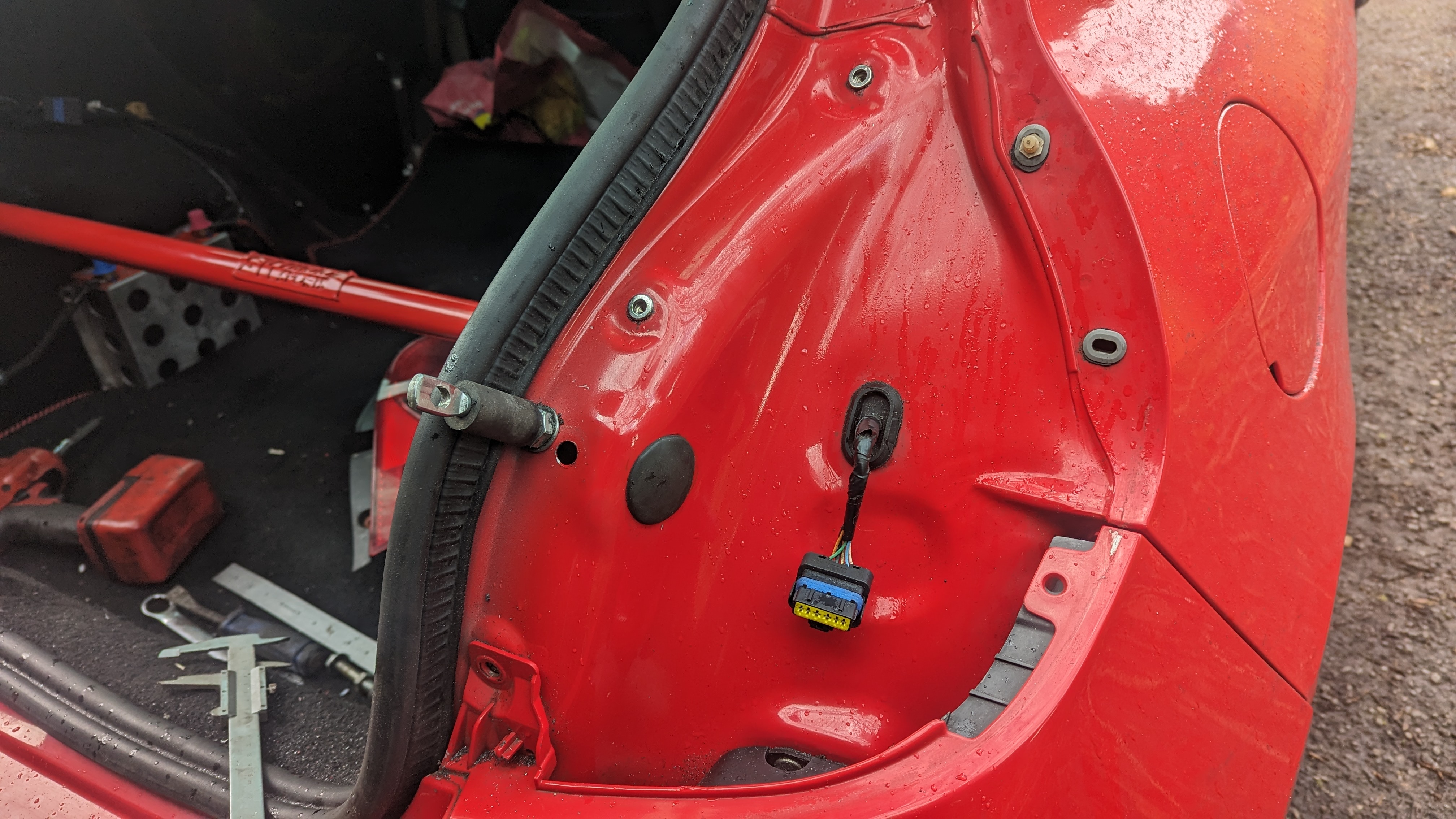

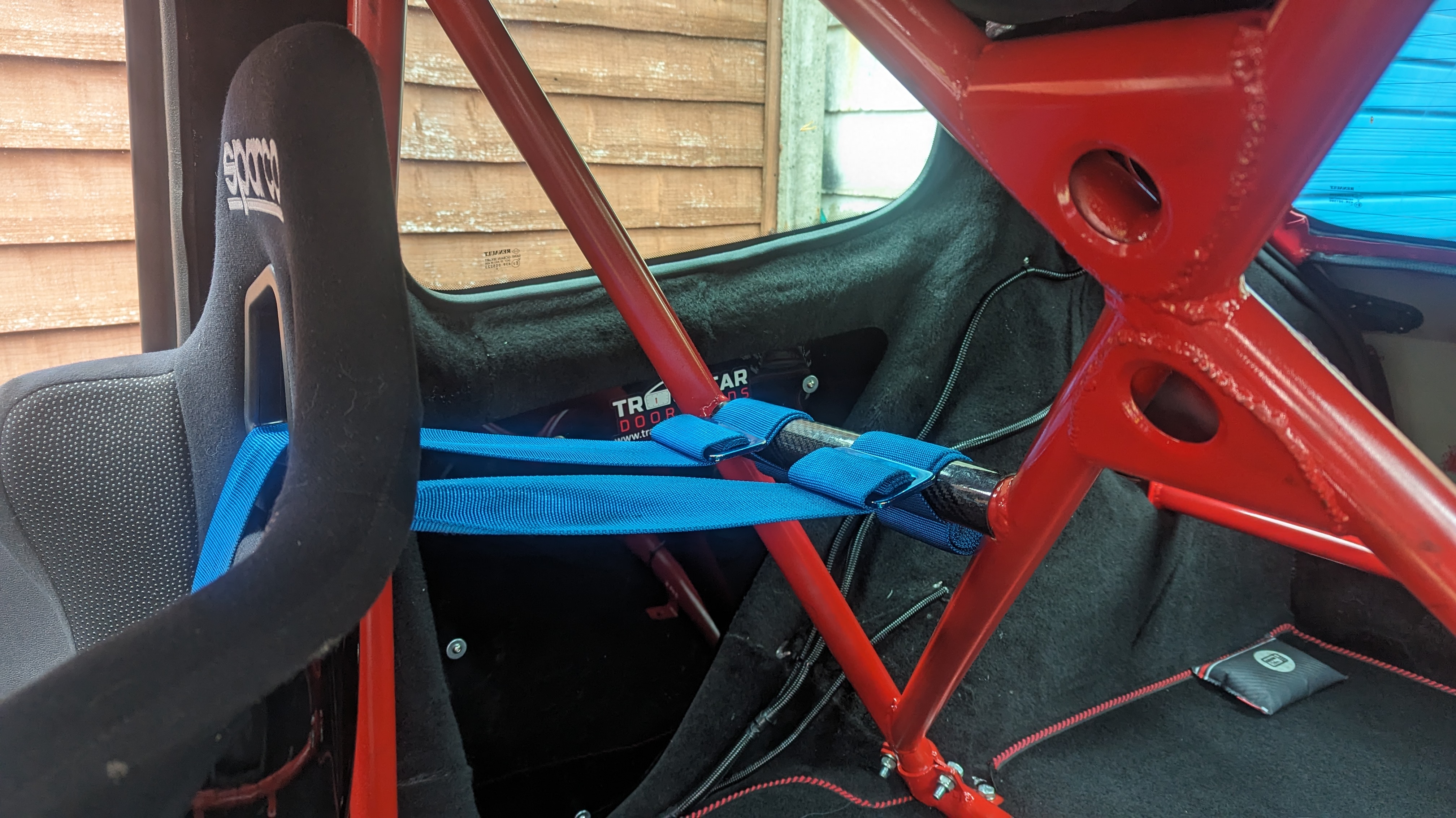

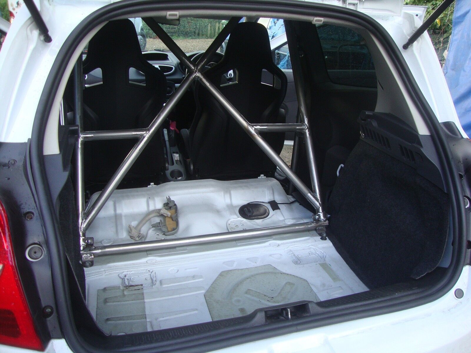

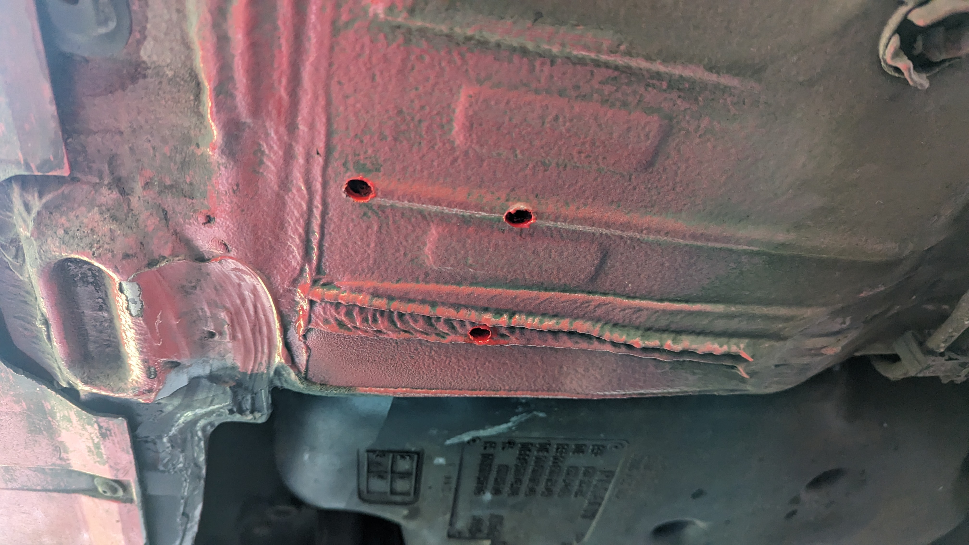

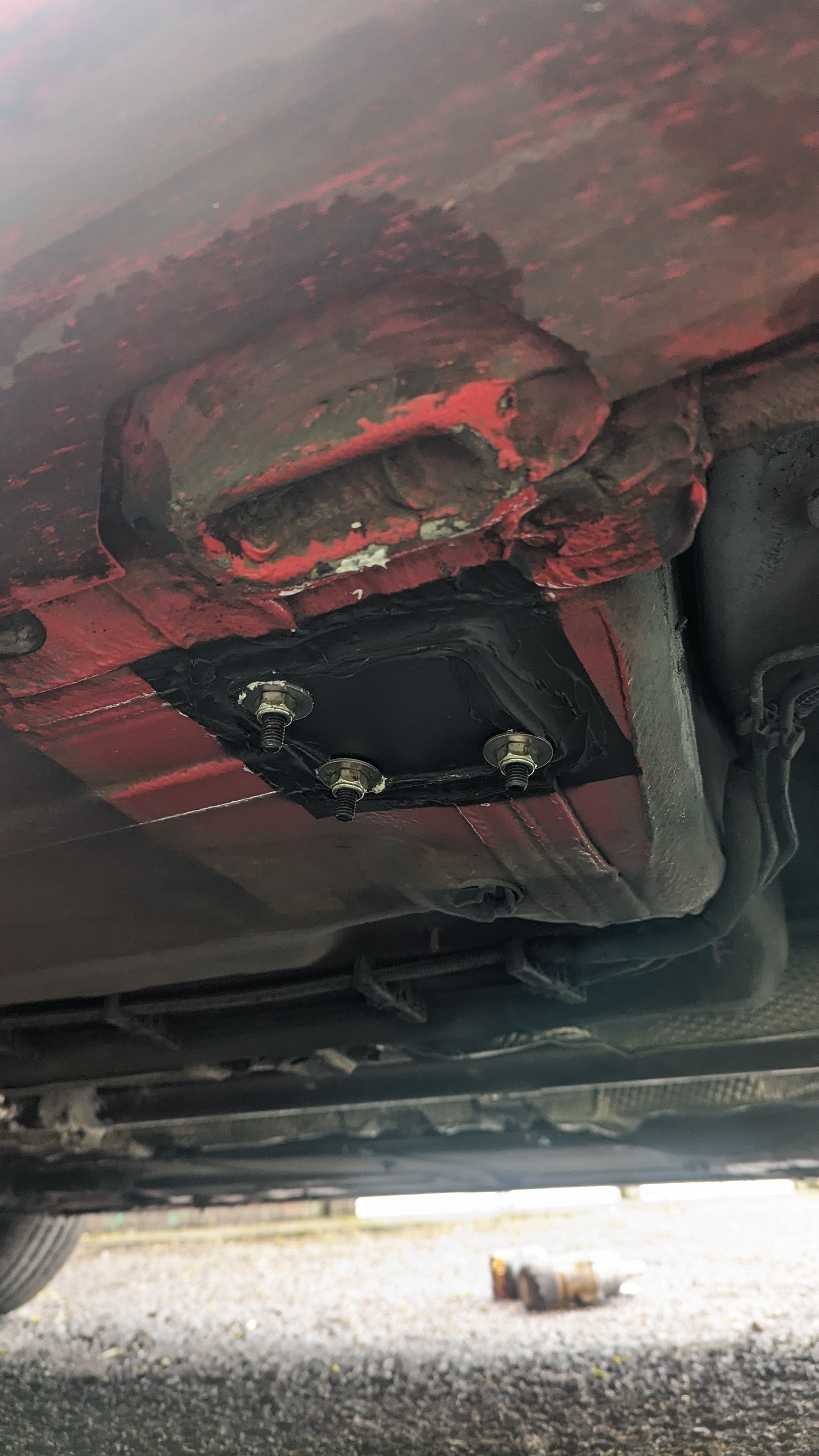

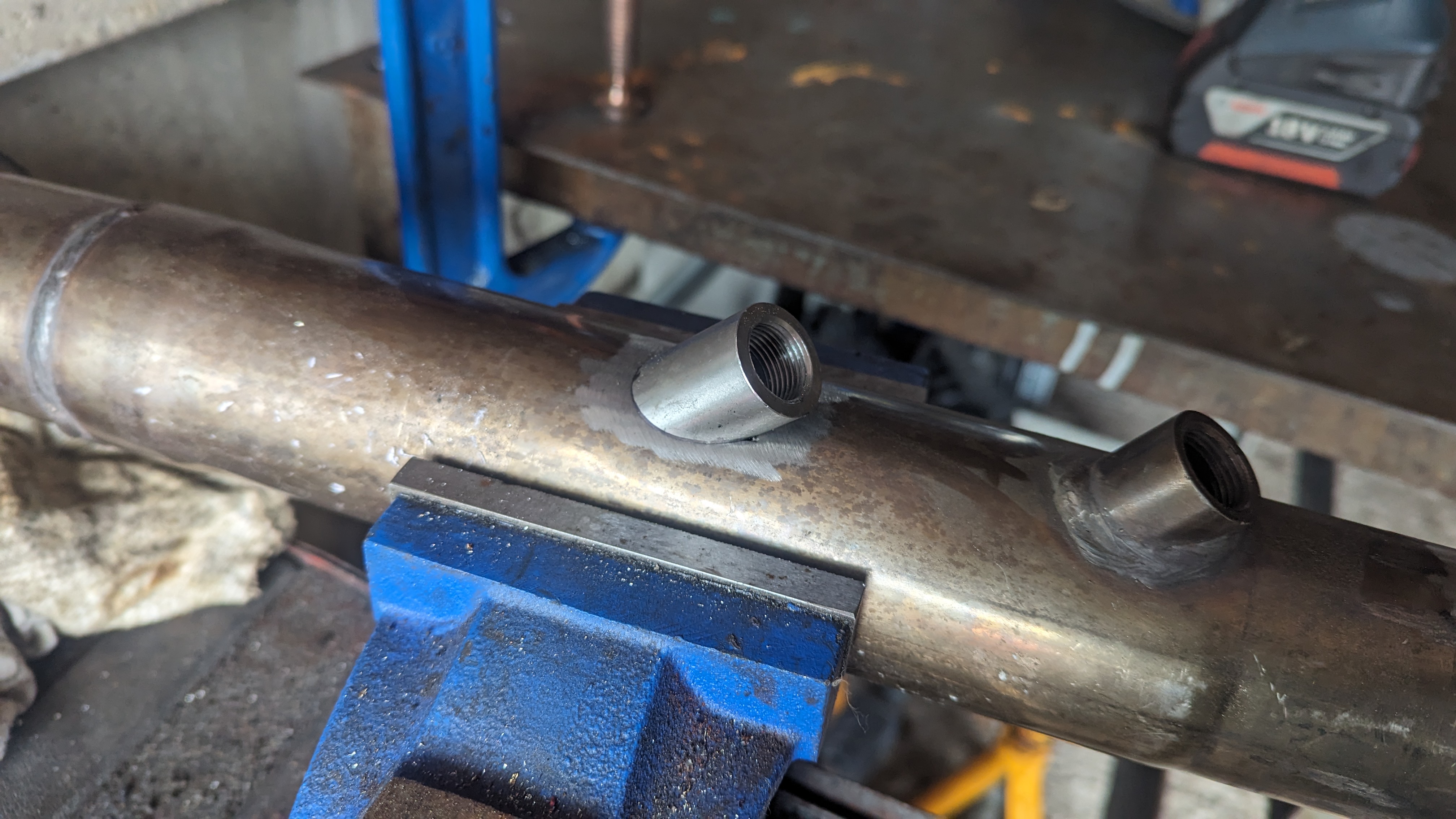

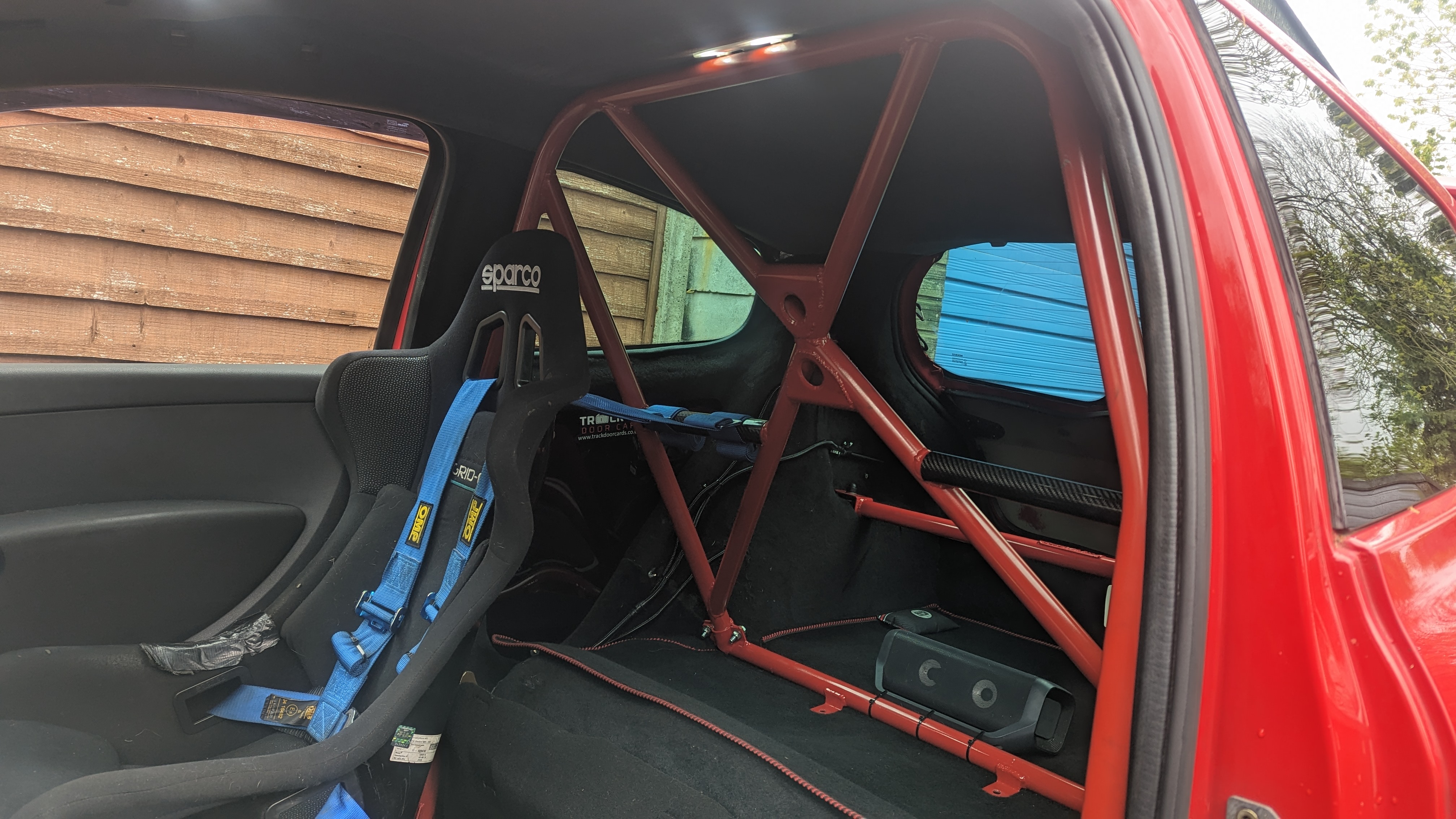

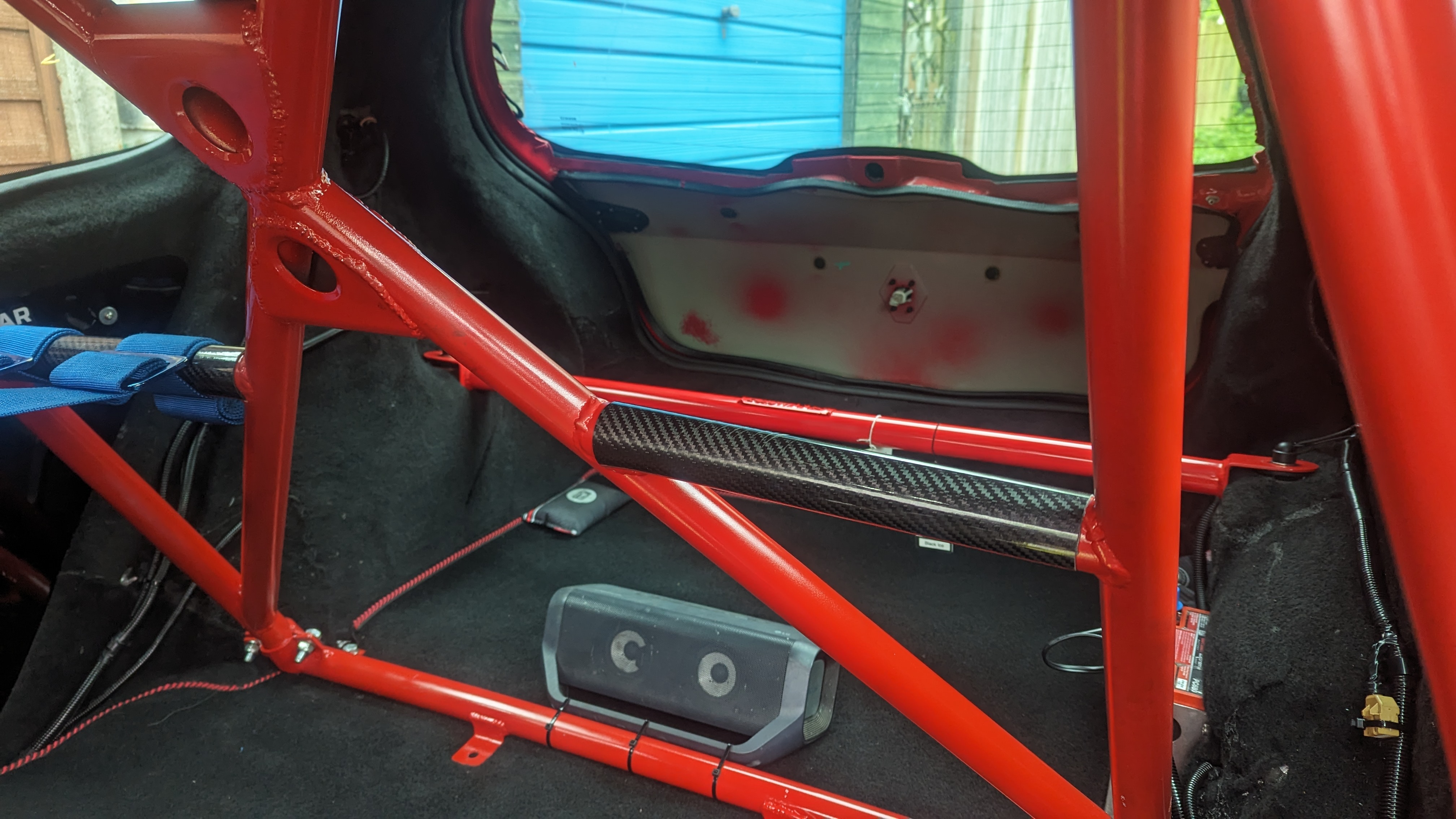

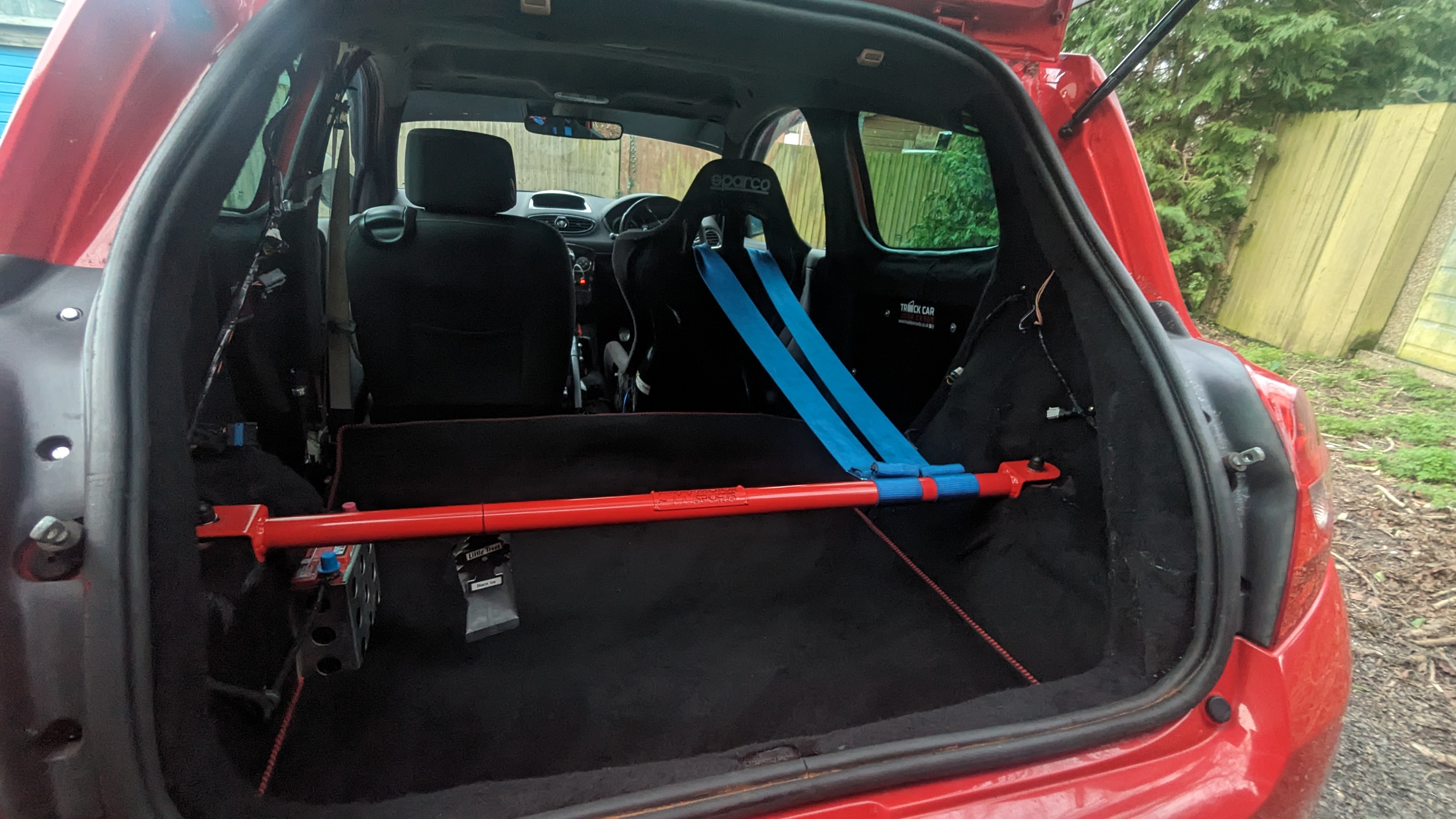

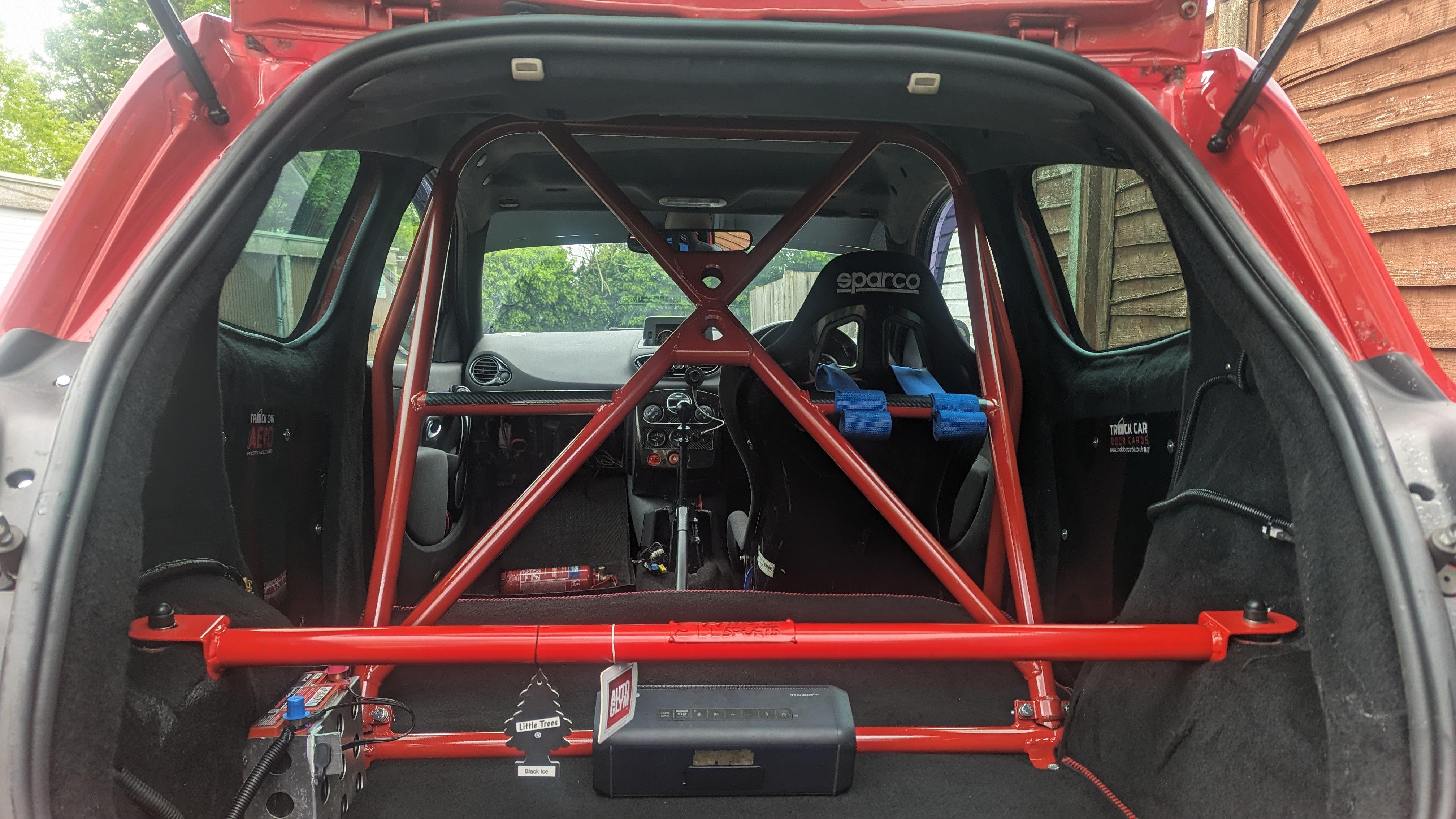

Was looking to get a cage for a while,few nice ones around but couldn't justify spending 600£+ for only a half cage,so found one on ebay for half the price that I've painted myself and welded some guessets just because they look cool:

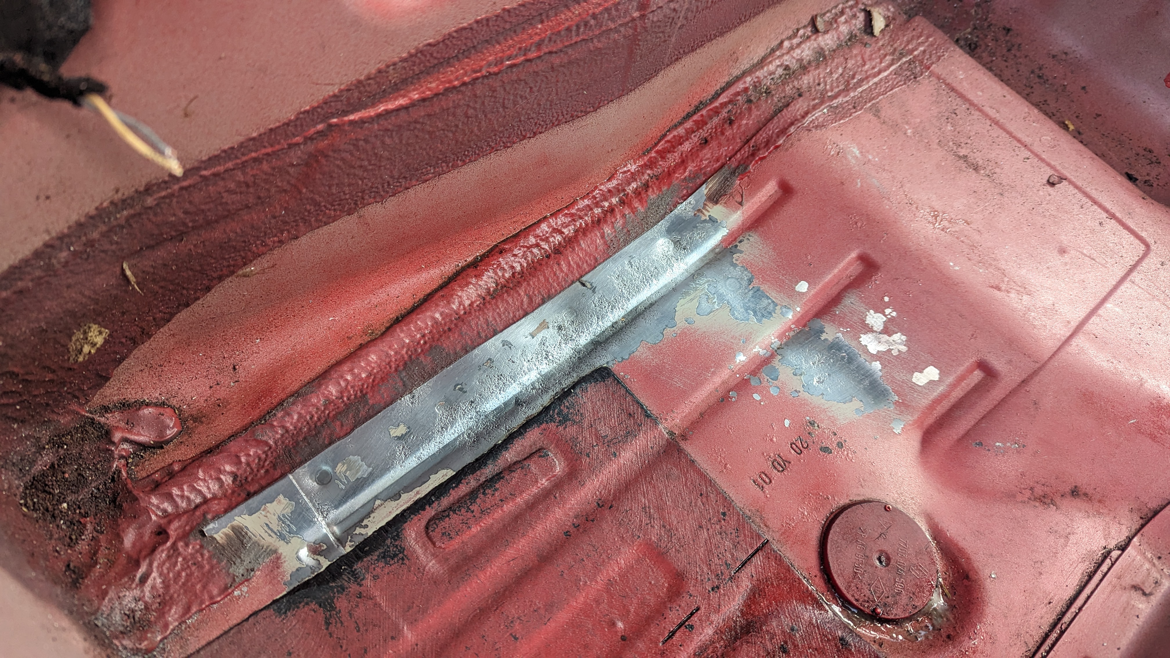

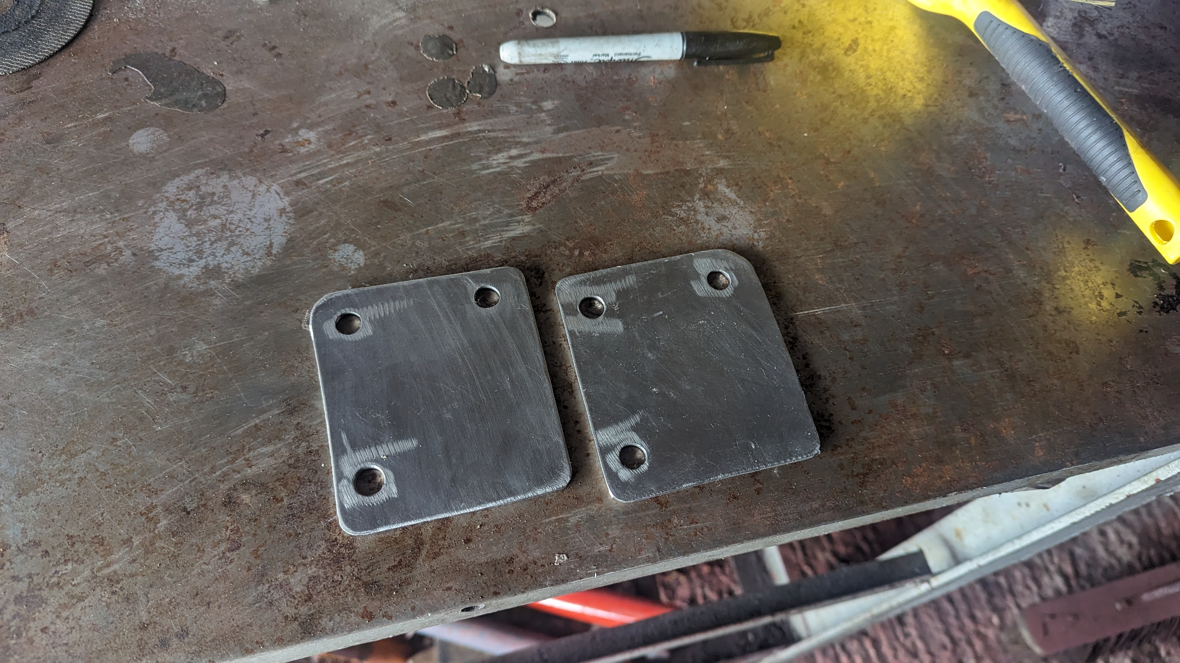

Had to make 3mm plates to fit the cage,the floor is quite filmsy in that spot I have found lol:

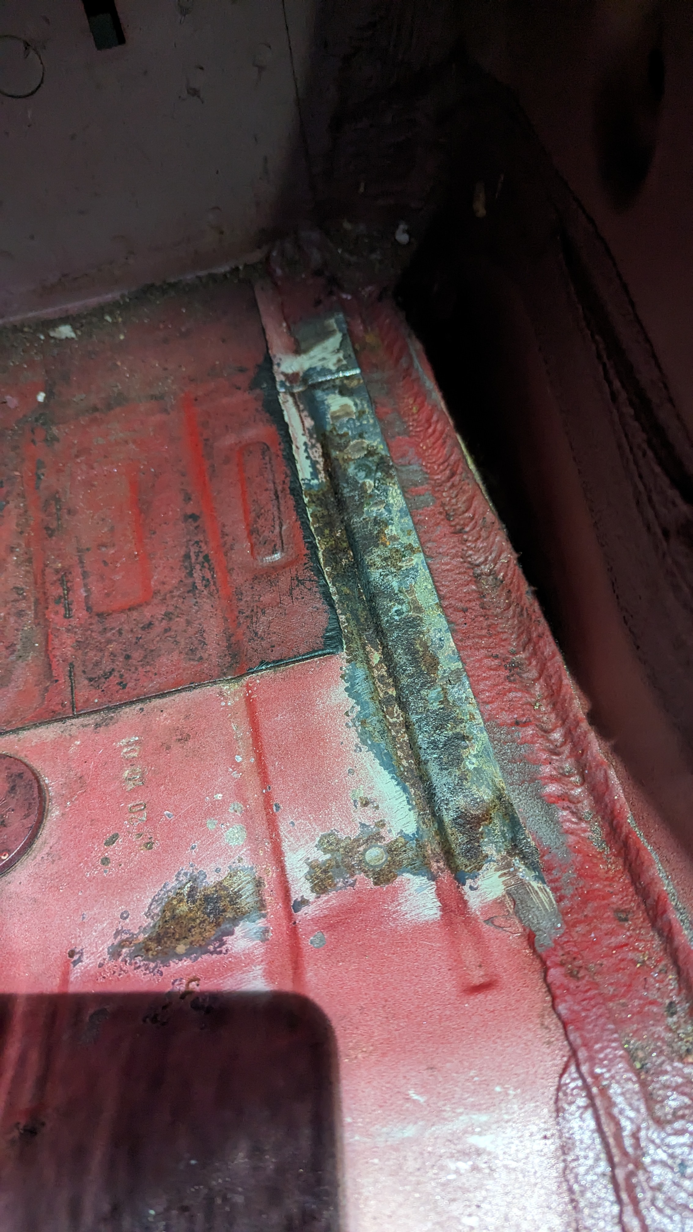

been primed,seam sealed and used U-Pol guard:
Took me a bit to find the correct orientation to fit the cage,even took the passenger door off,so a few marks and scratches happened that will need touch up soon.
Fitted some carbon covers I had spare to protect the paint a bit from the belts.
have ordered some SW direct to floor mounts to fit a passenger seat.

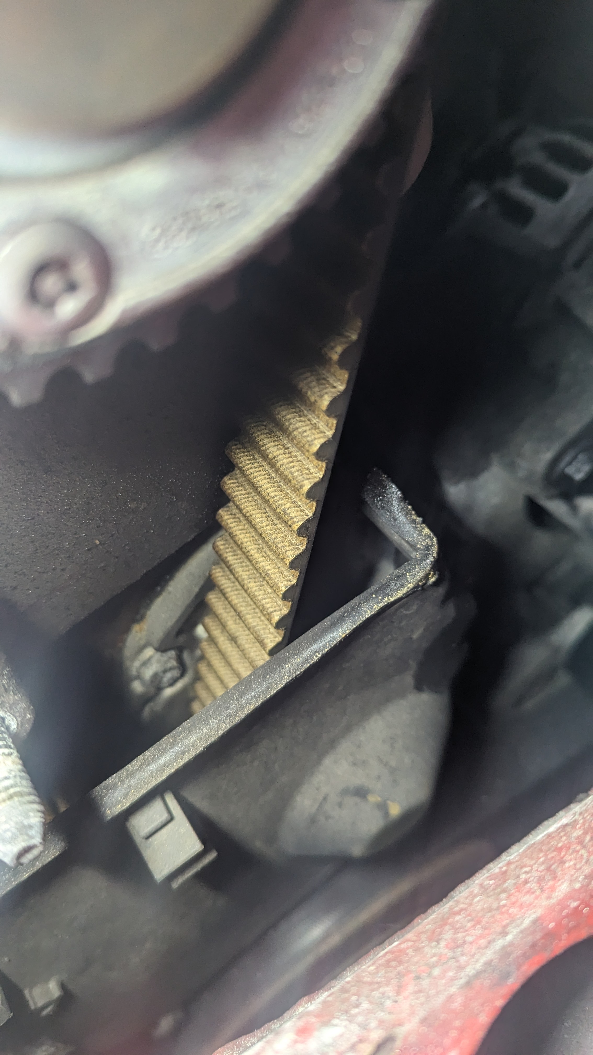

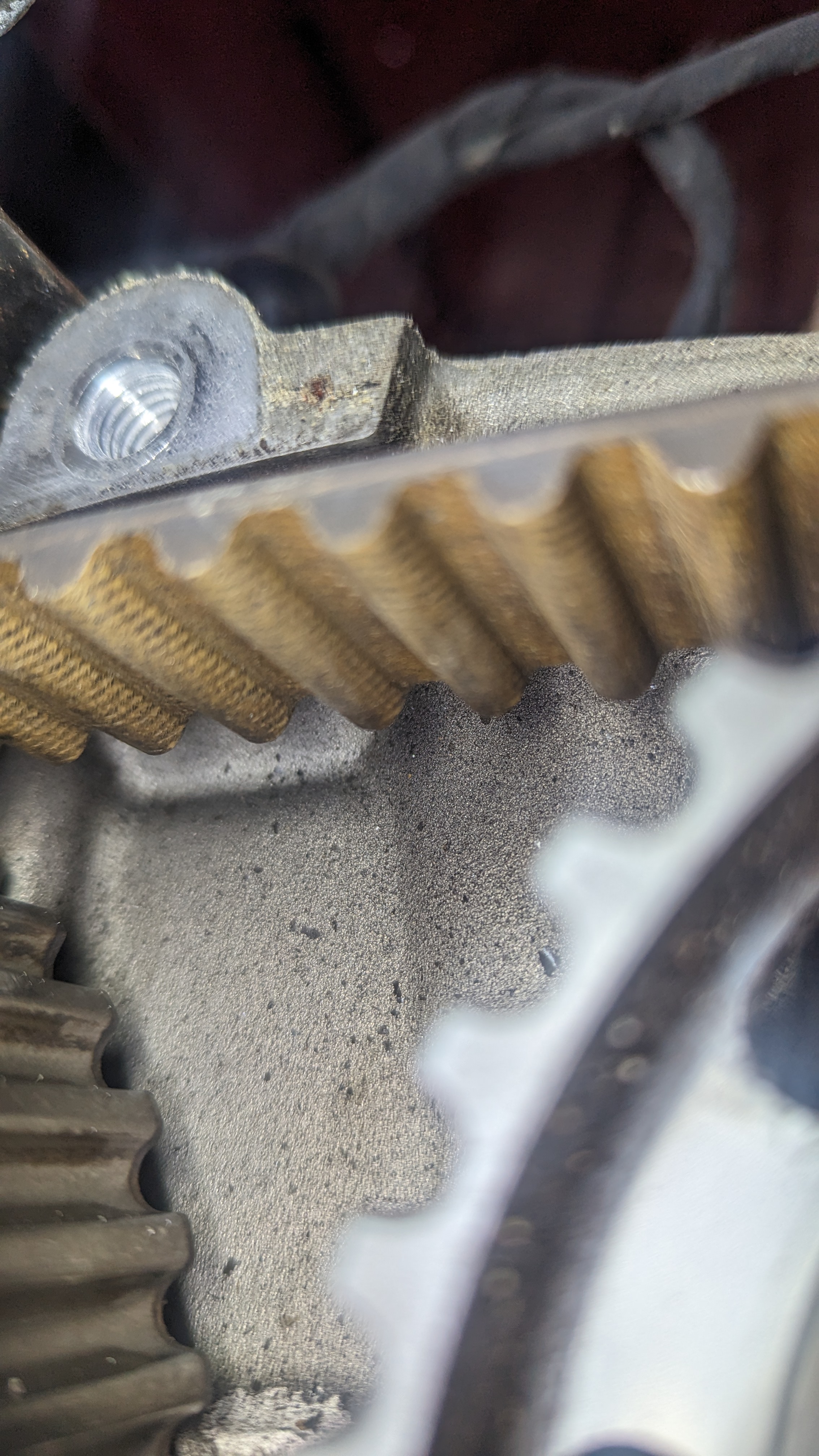

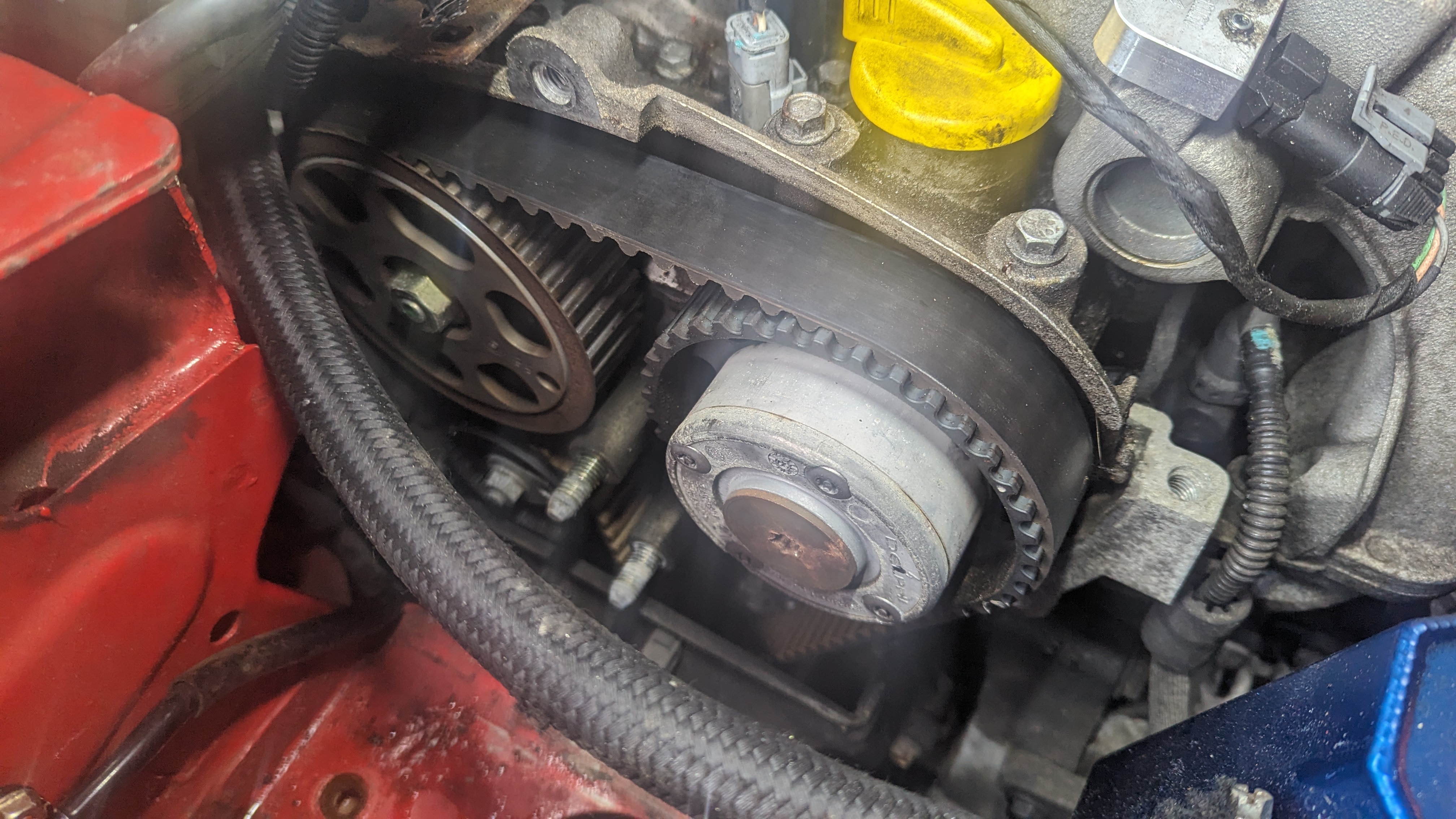

I really need to do a cambelt now,it's been done at 71k and sitting now at 93k but then saw the mot history and that was in 2015
so it's 4 years overdue,just waiting to buy some Piper cams first,i did take the cover off and the belt looks alright to be fair:
