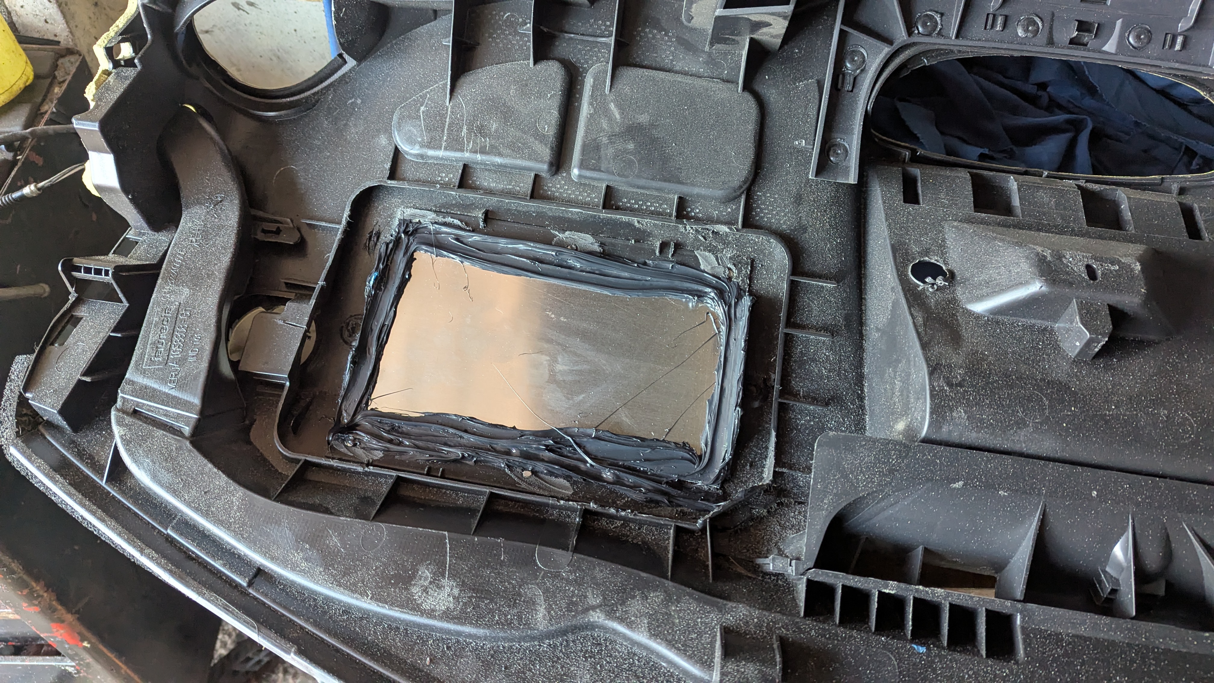

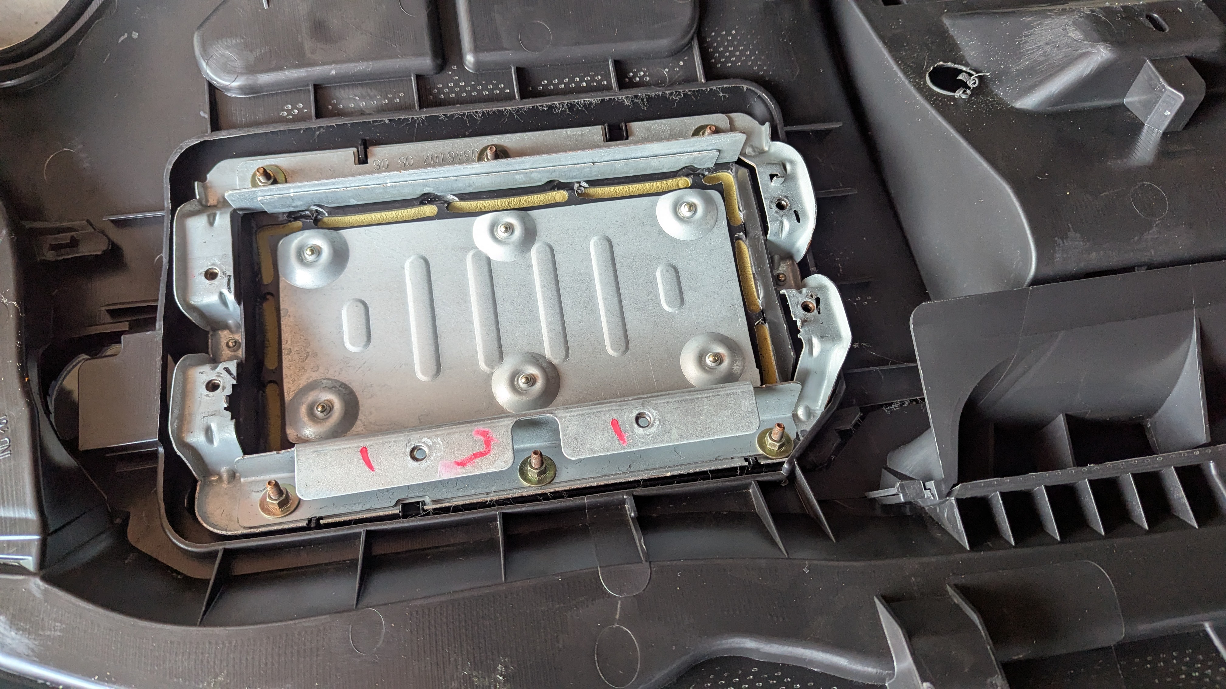

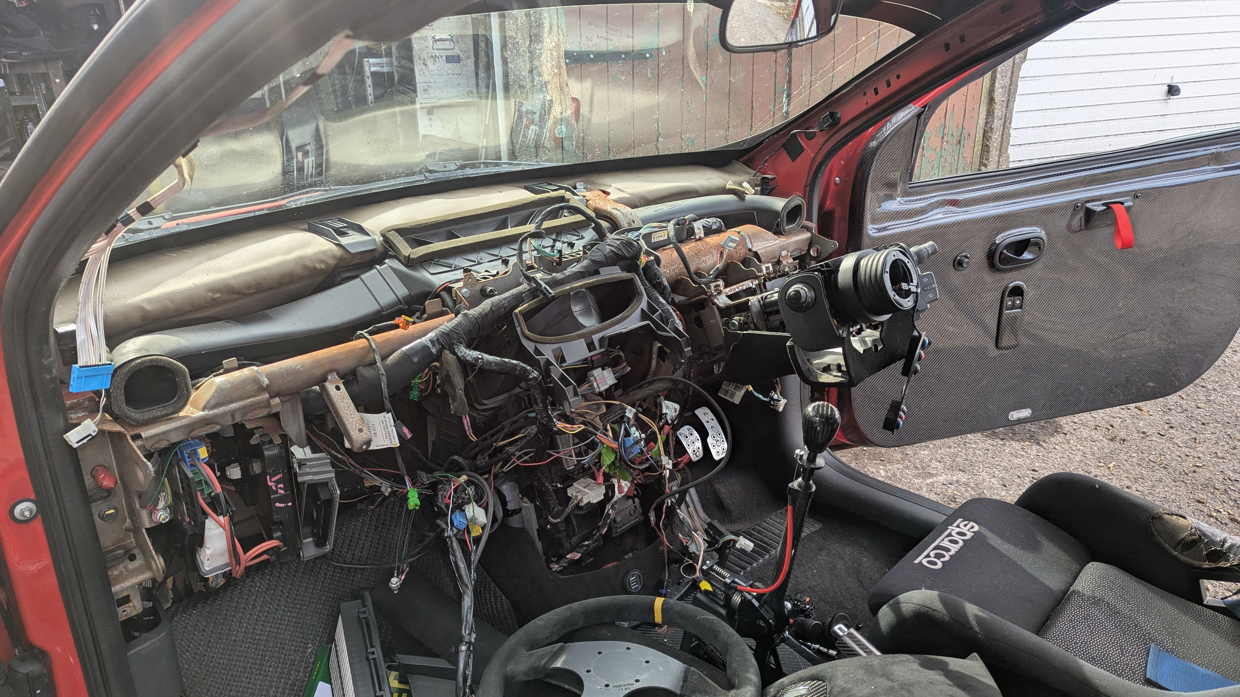

Got the dash out to lighten it a bit and do some work,removed the passenger airbag and with the help of some speed holes got it down to 6,7kg from the original 11,5kg (this is the bare dash with no vents trims etc) so saved 4,8kg or 42% which is quite good:
the dash skin weighs 940 grams:

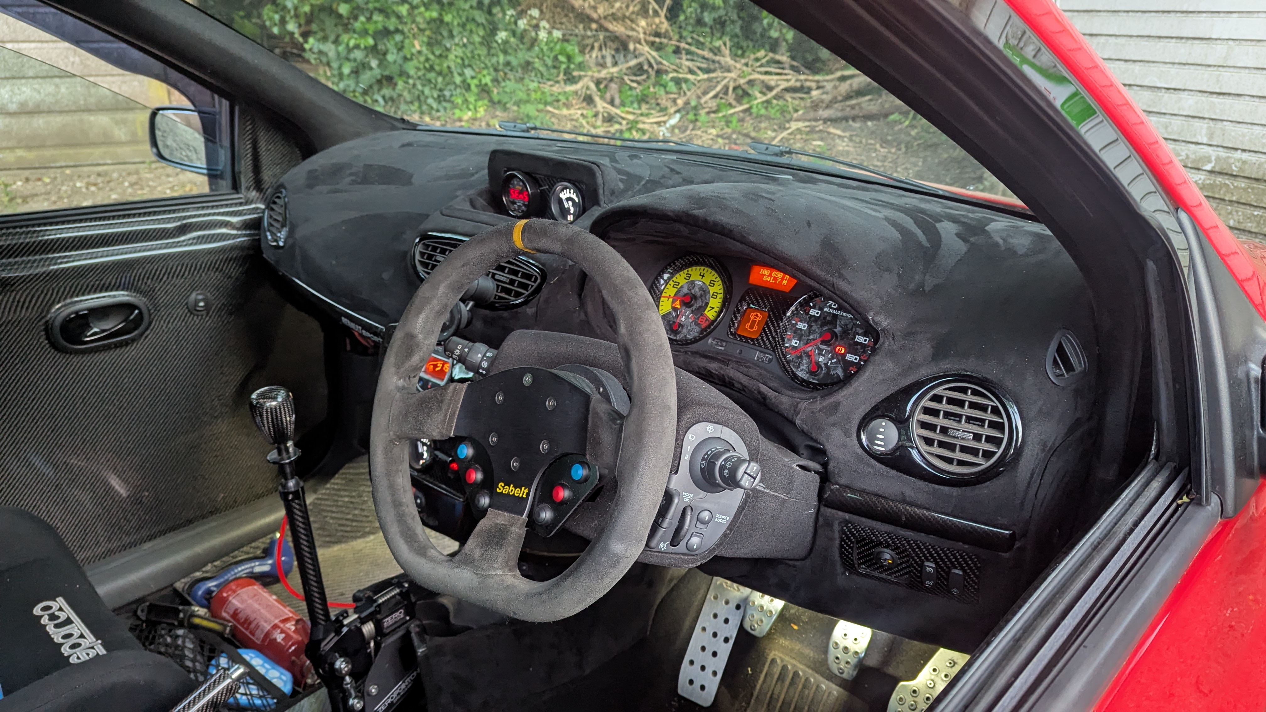

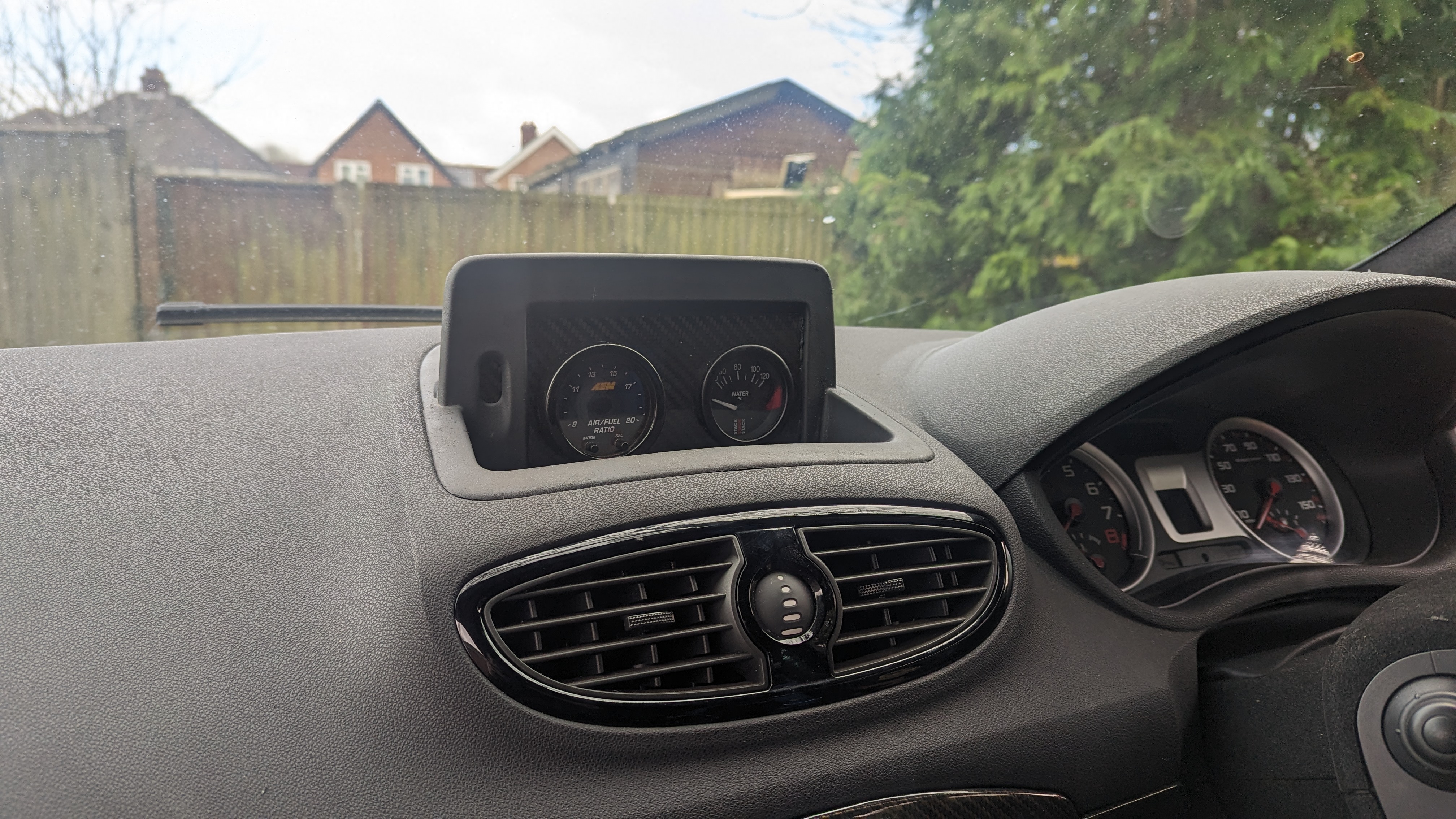

I had bought and fitted this aftermarket mount for the gauges but fitment was worse than the original as it has no clips and being one piece its harder to retrim with my limited skill so just went back to the oem one I had before.
The problem with the oem was that it is way too tall and obstructs the view which was the reason why I went with the aftermarket option,so I have cut it and shortened it as much as I could and it's a lot better,from the driver view it's just in line with the end of the dashboard and doesn't poke out like before:

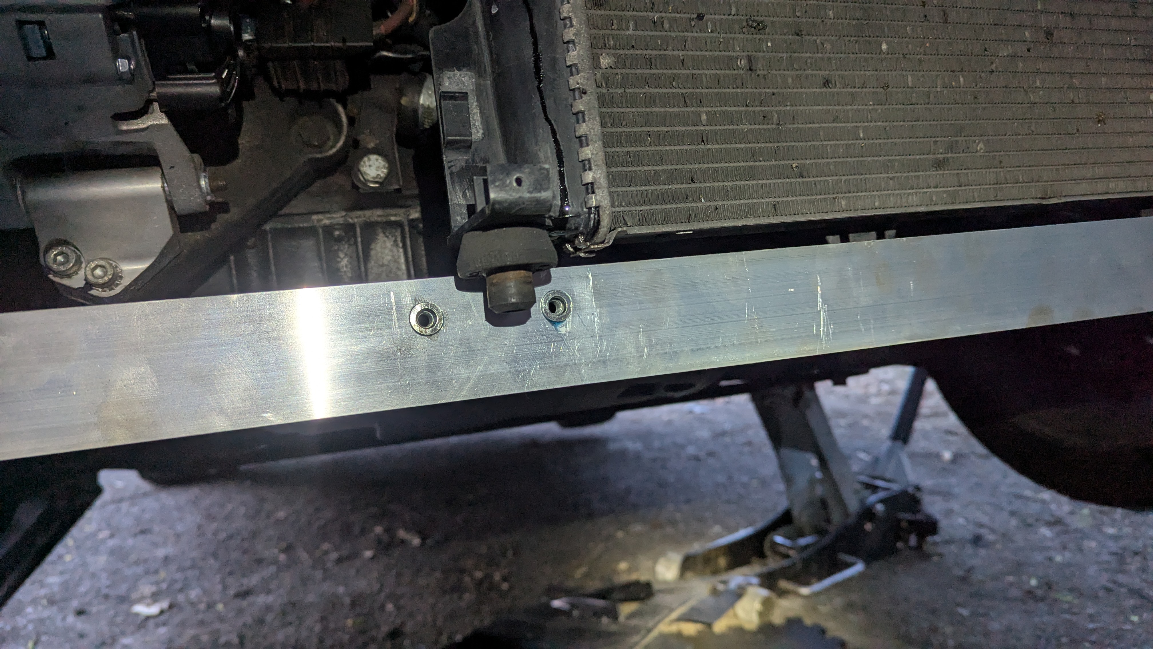

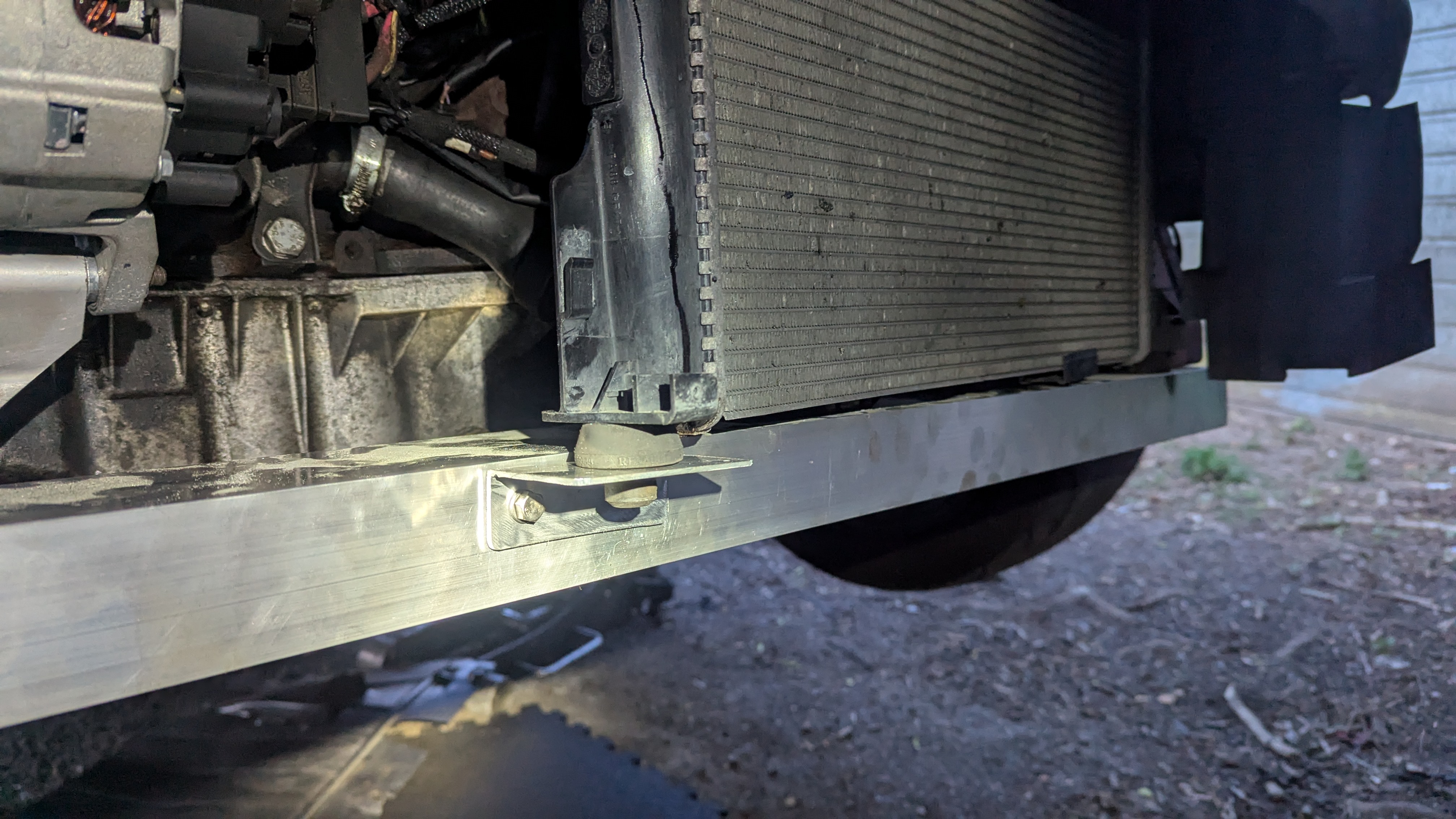

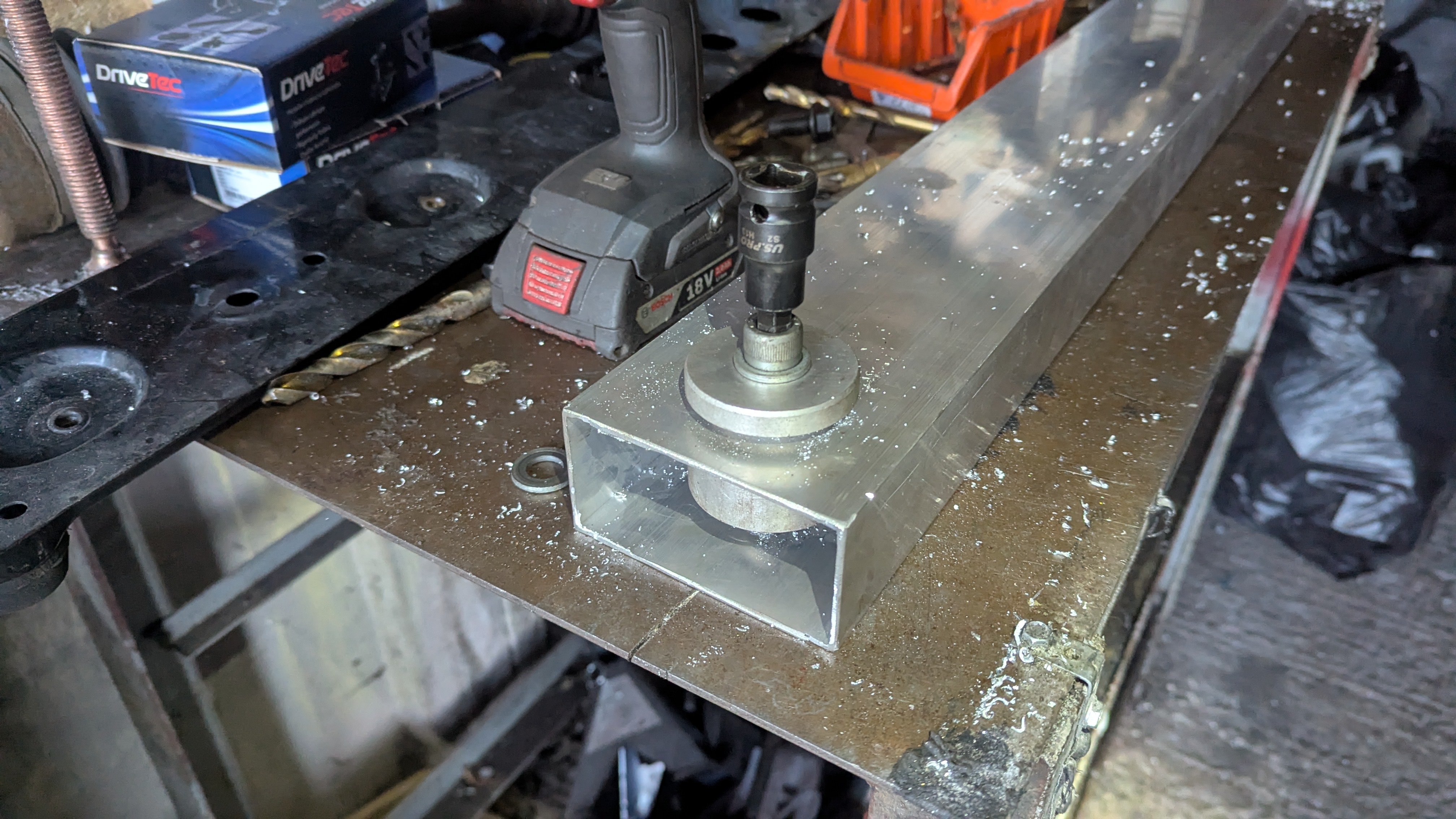

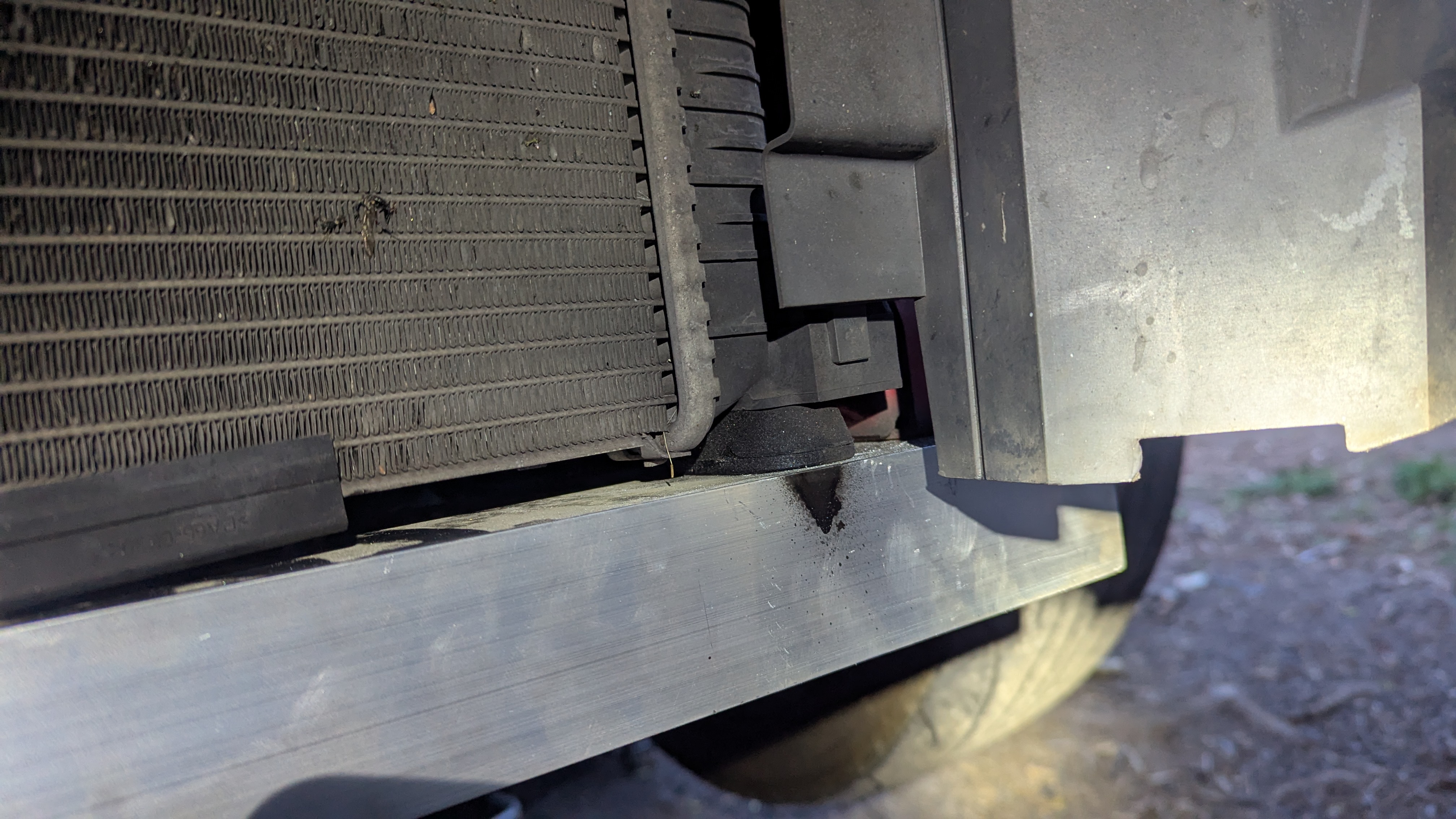

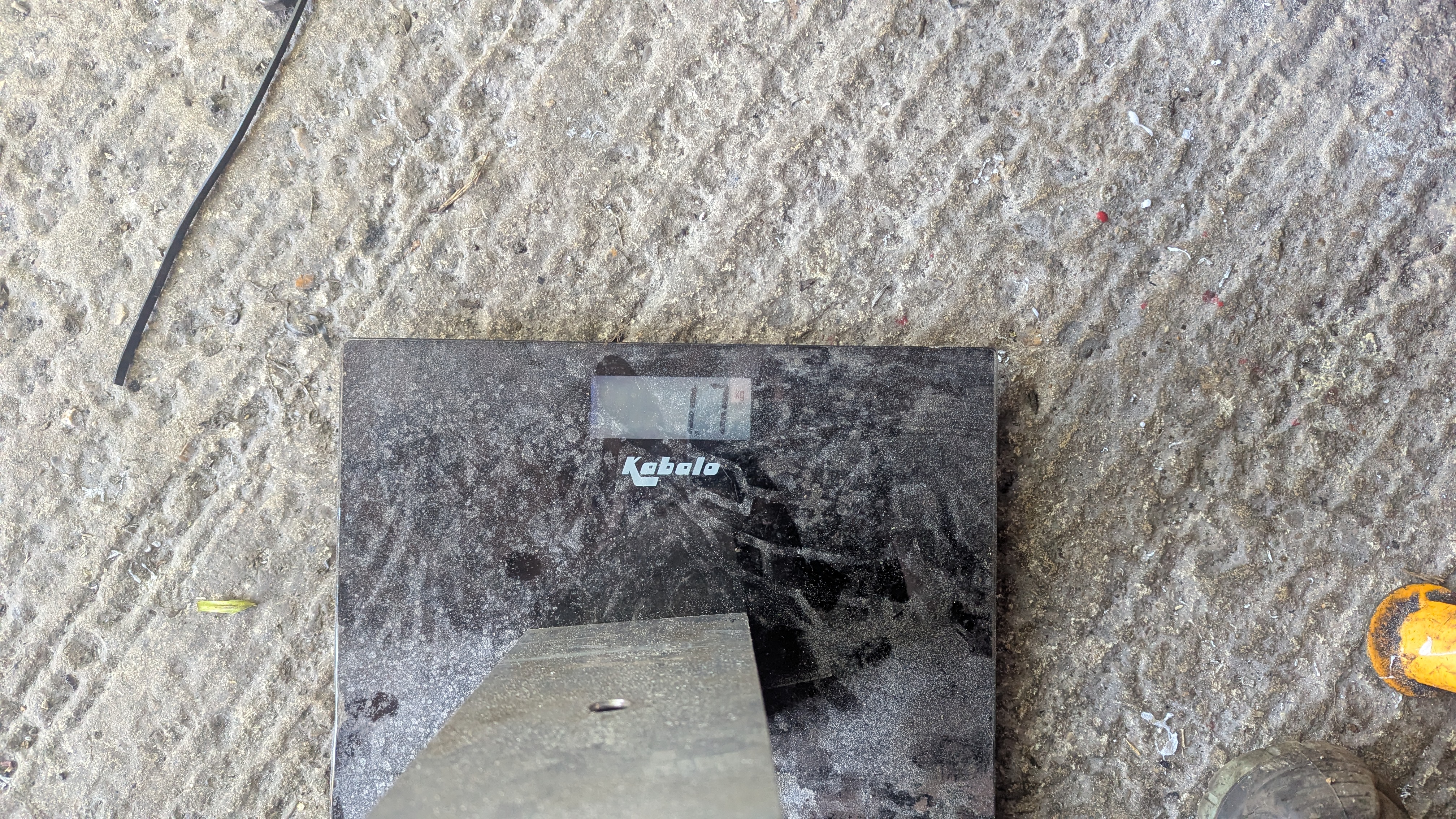

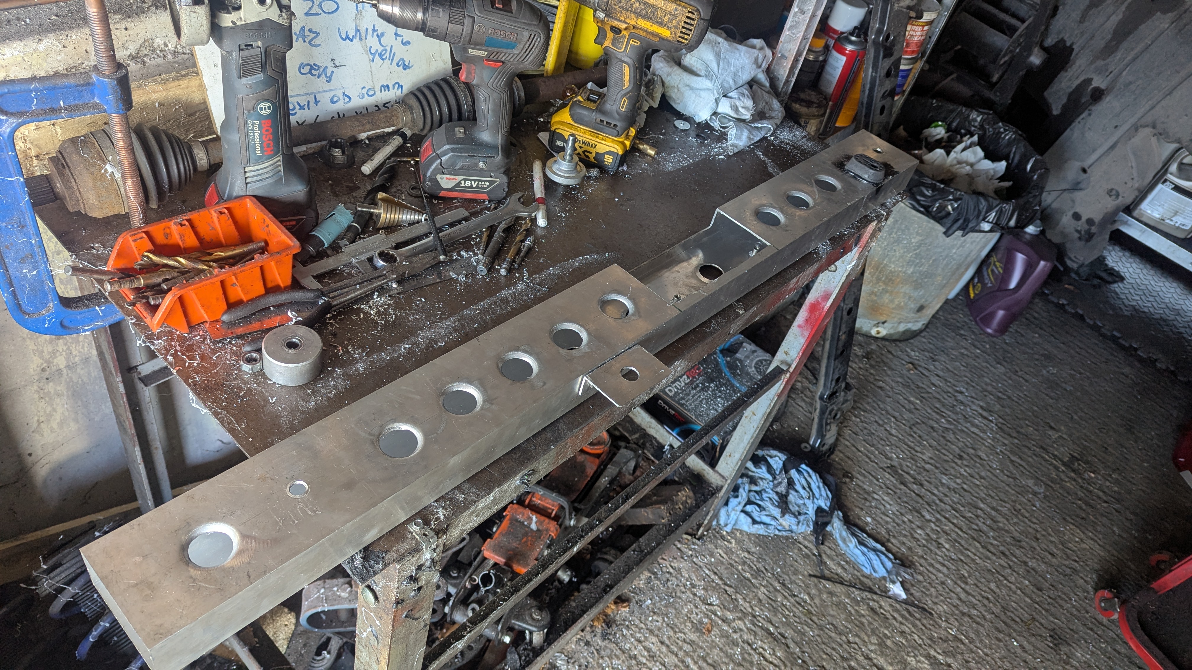

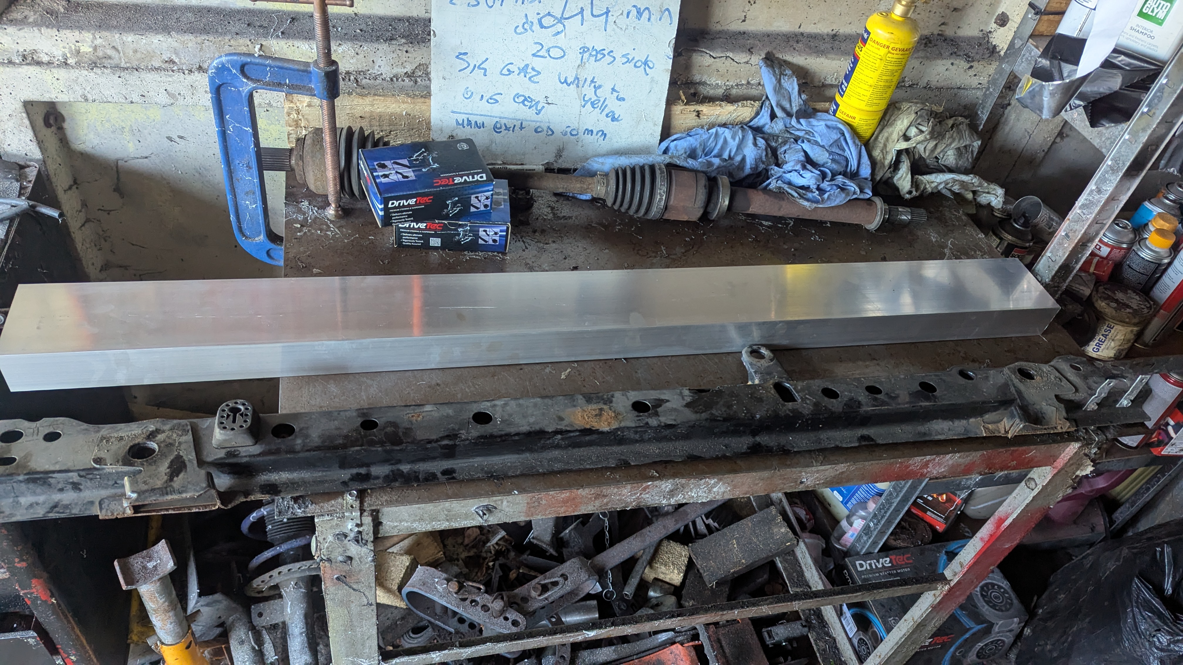

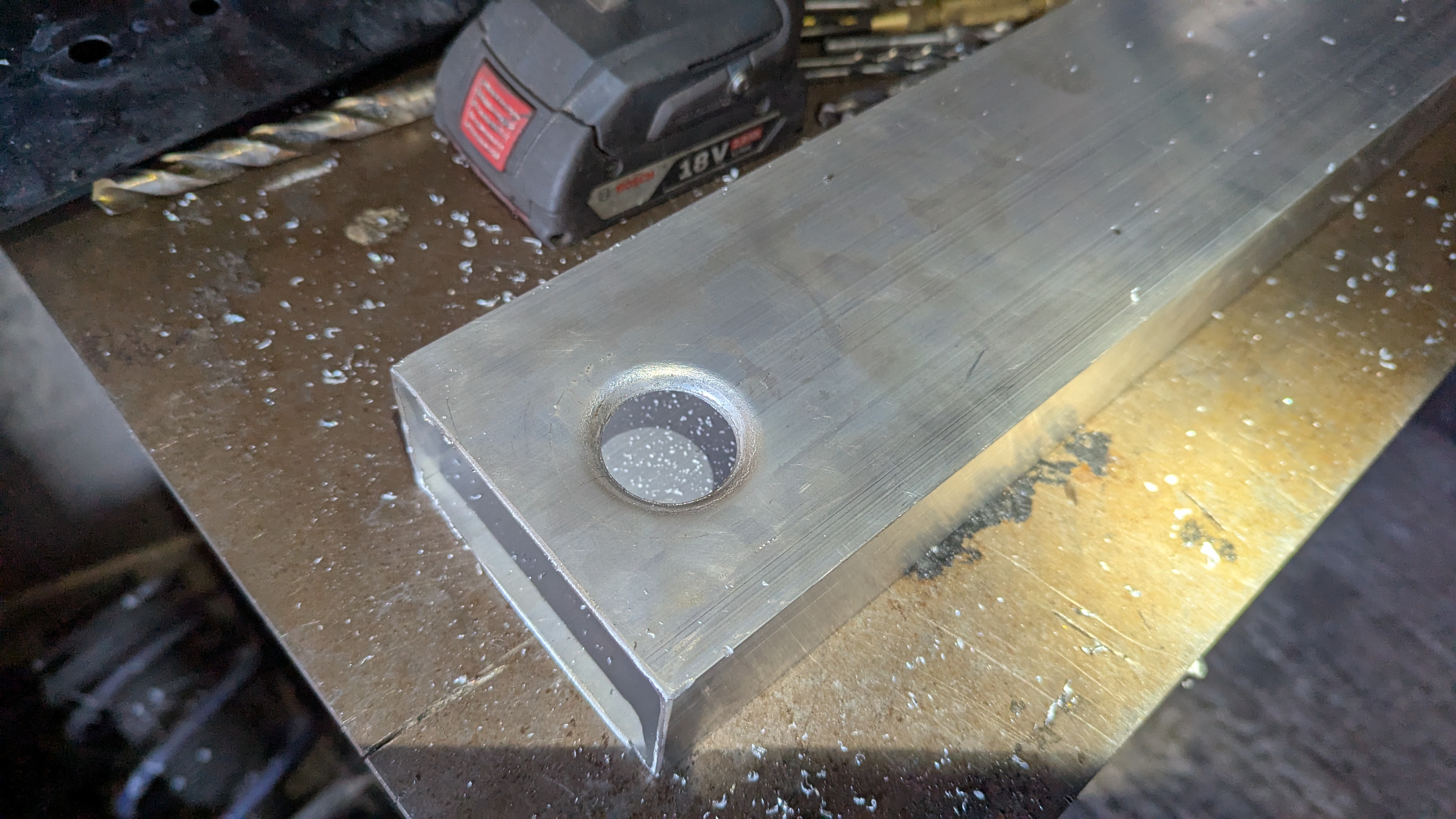

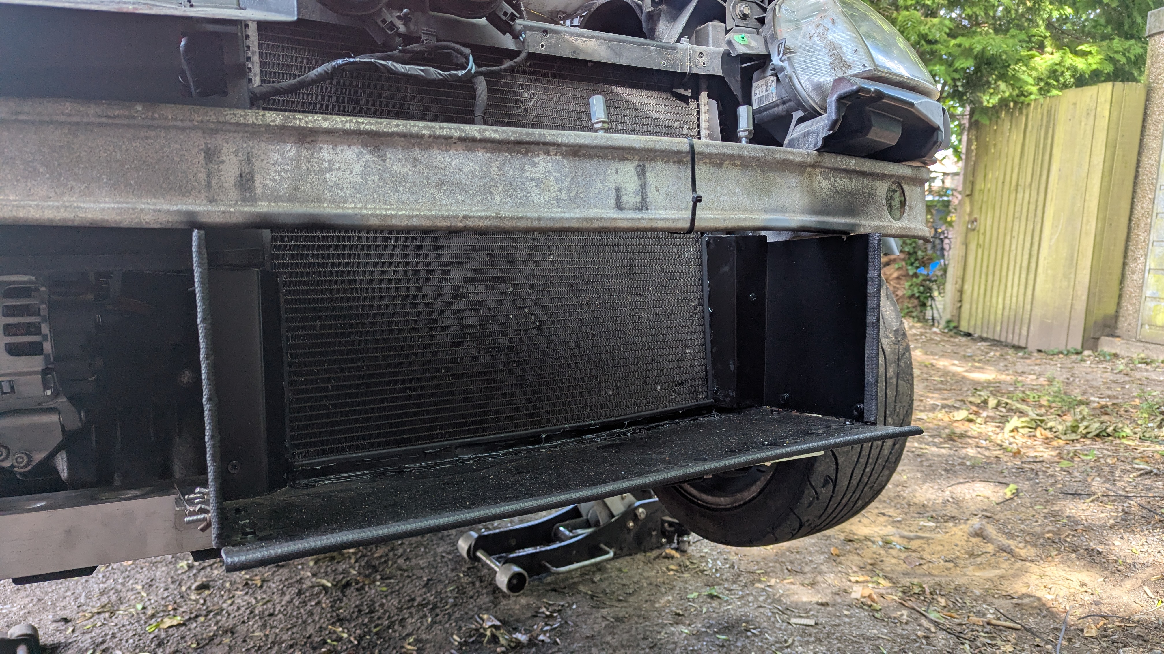

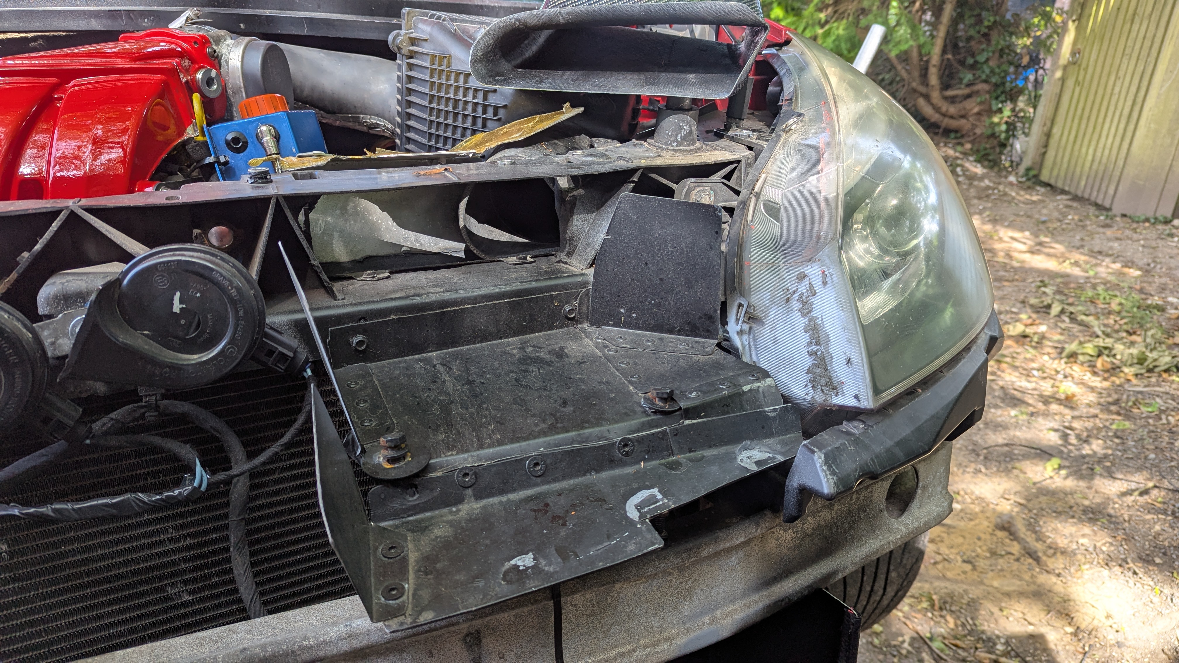

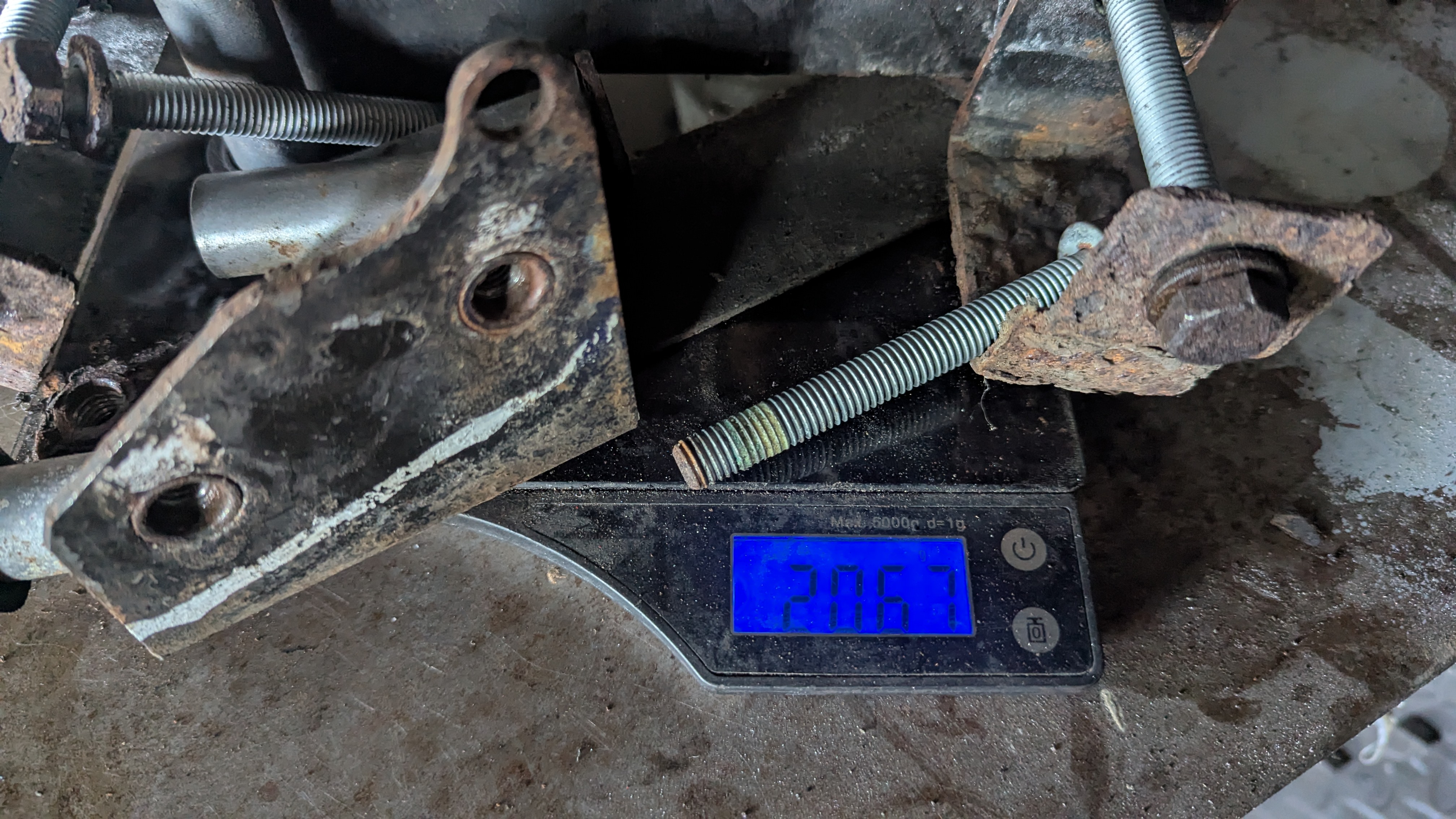

The original radiator support was getting rusty again and wanted to shed some weight with an ali box section so got one to modify:

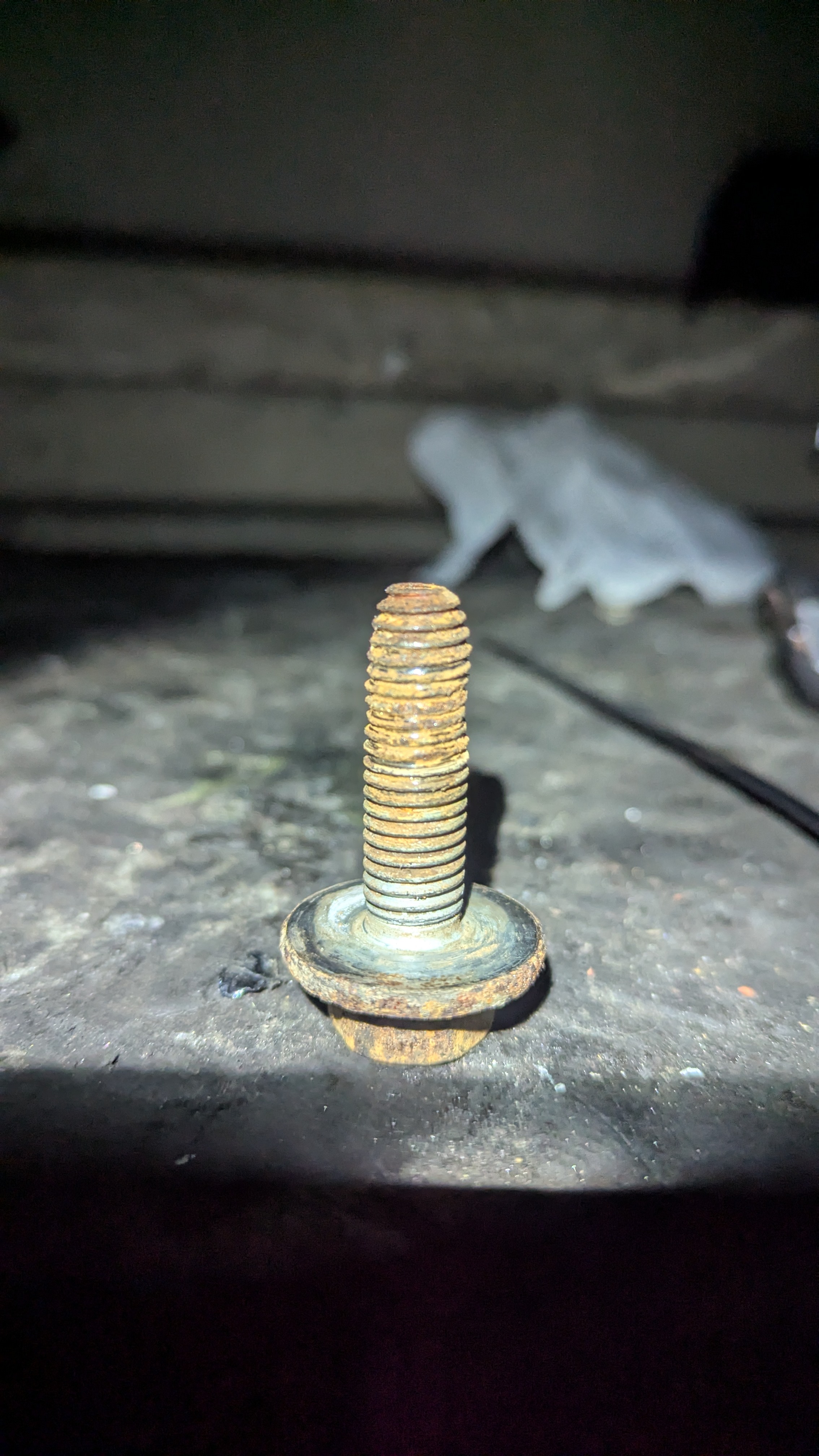

The two fixing bolts were mauled for some reason so replaced with new ones.

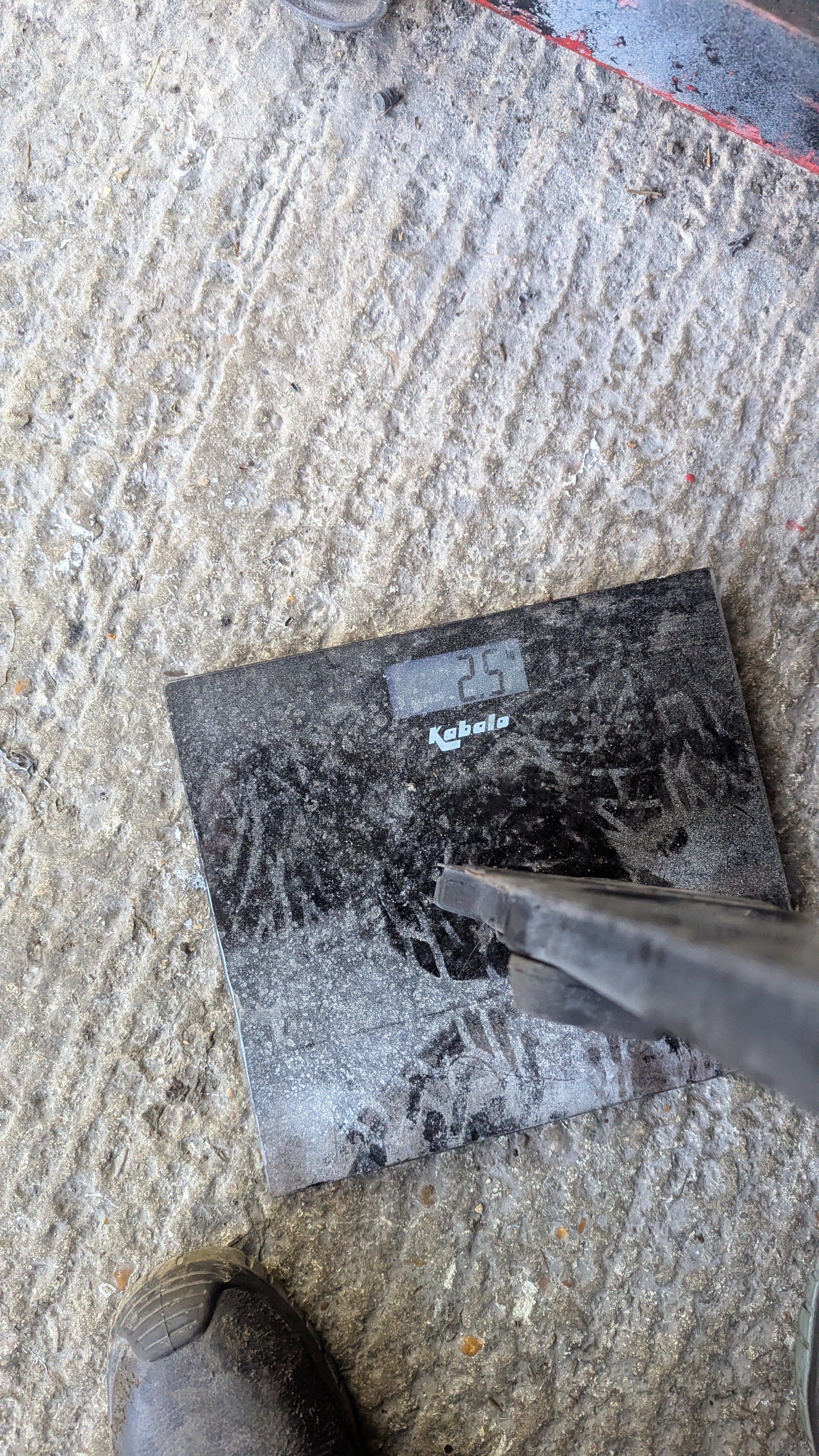

Saved a massive 800 grams,the original was 2.5kg (legs were already cut):

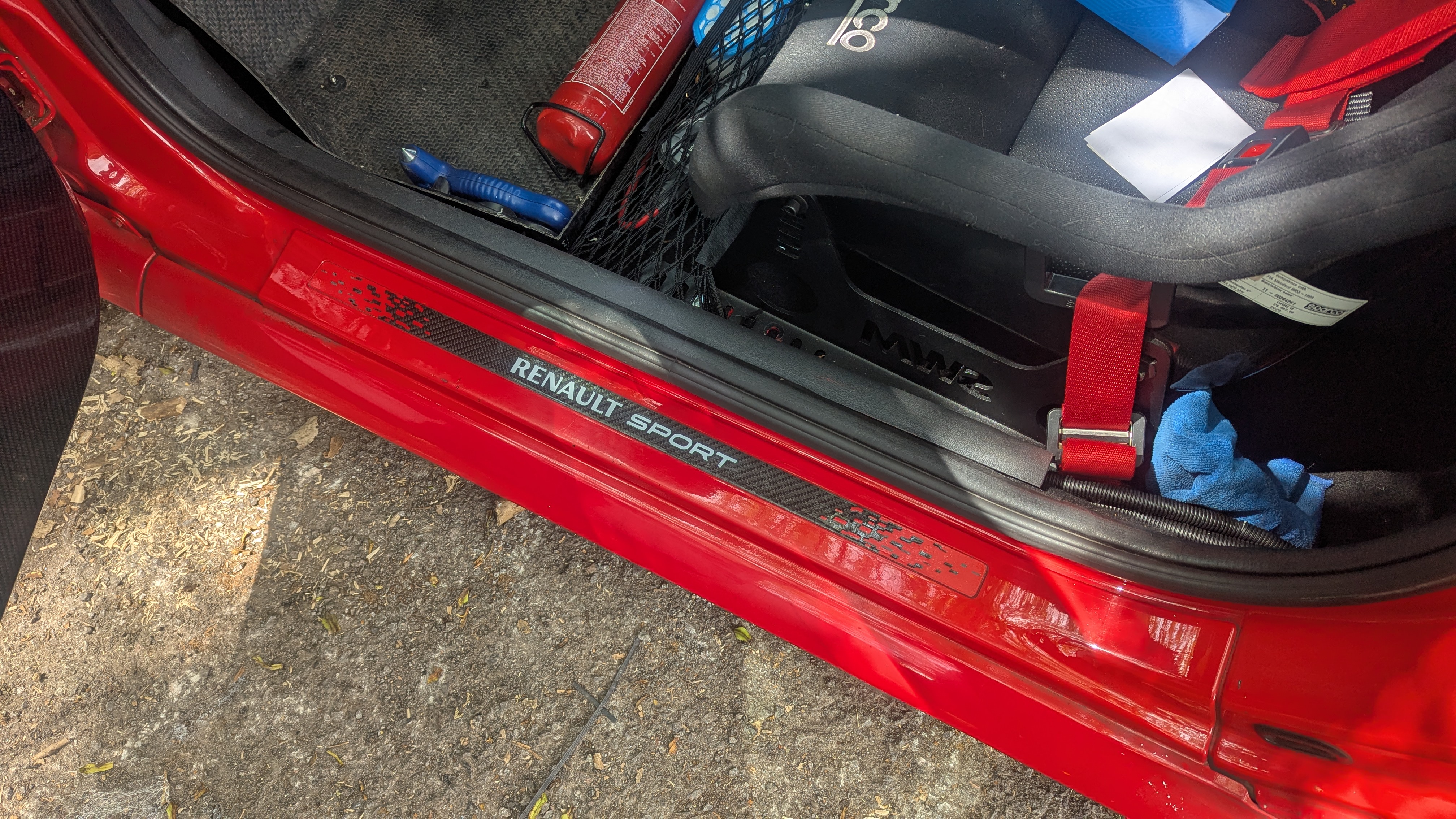

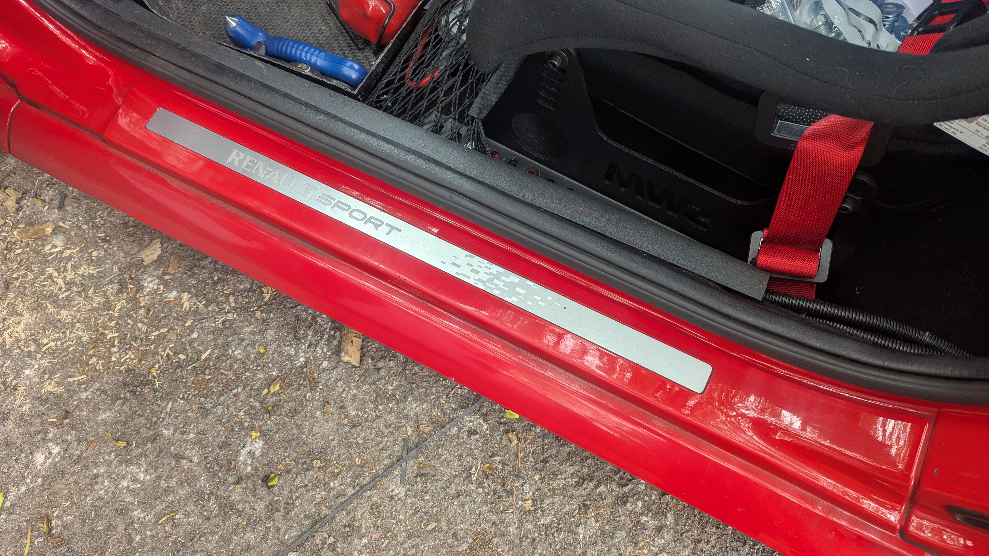

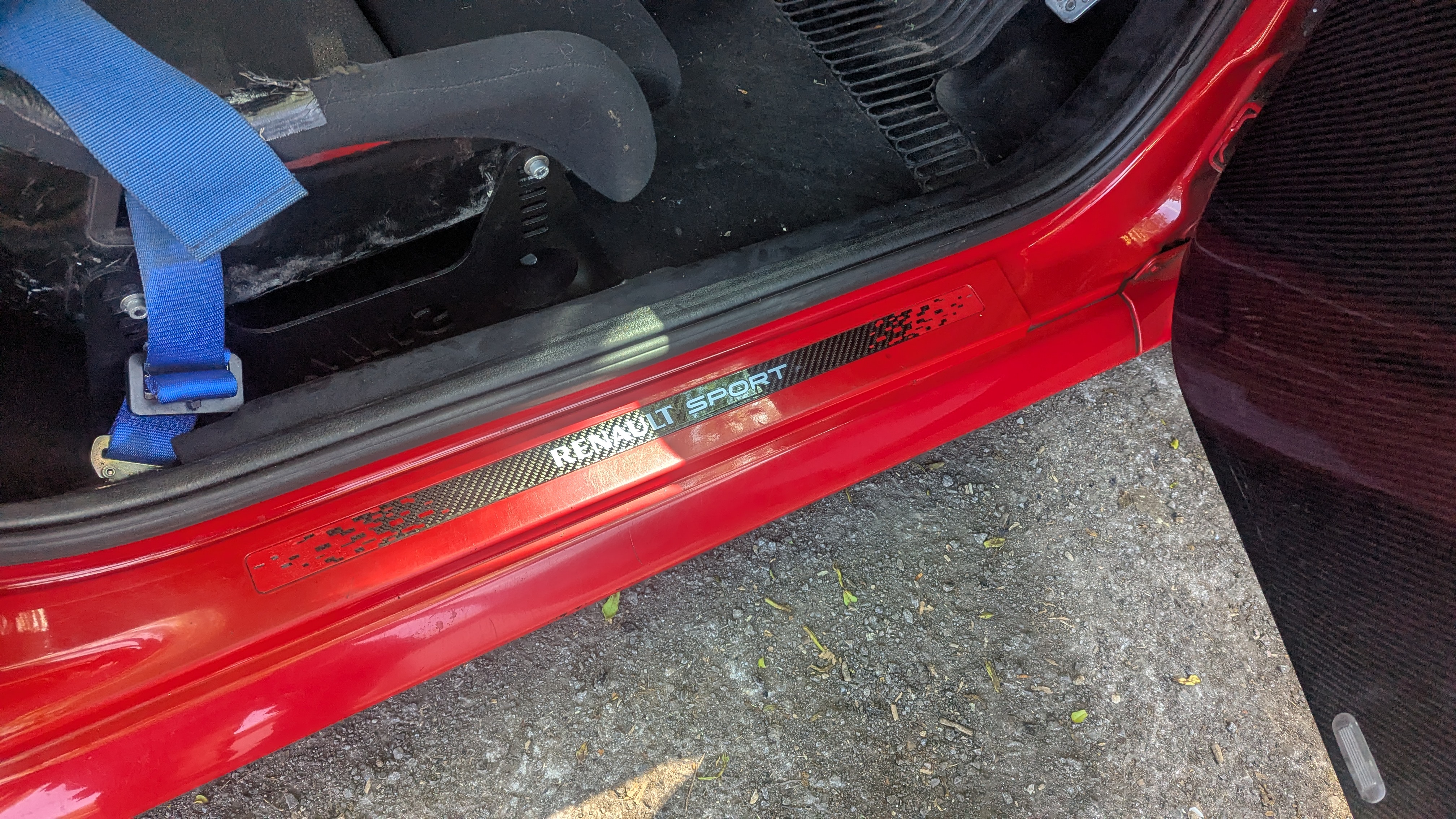

Also got some custom sill trims from a guy off instagram from France:

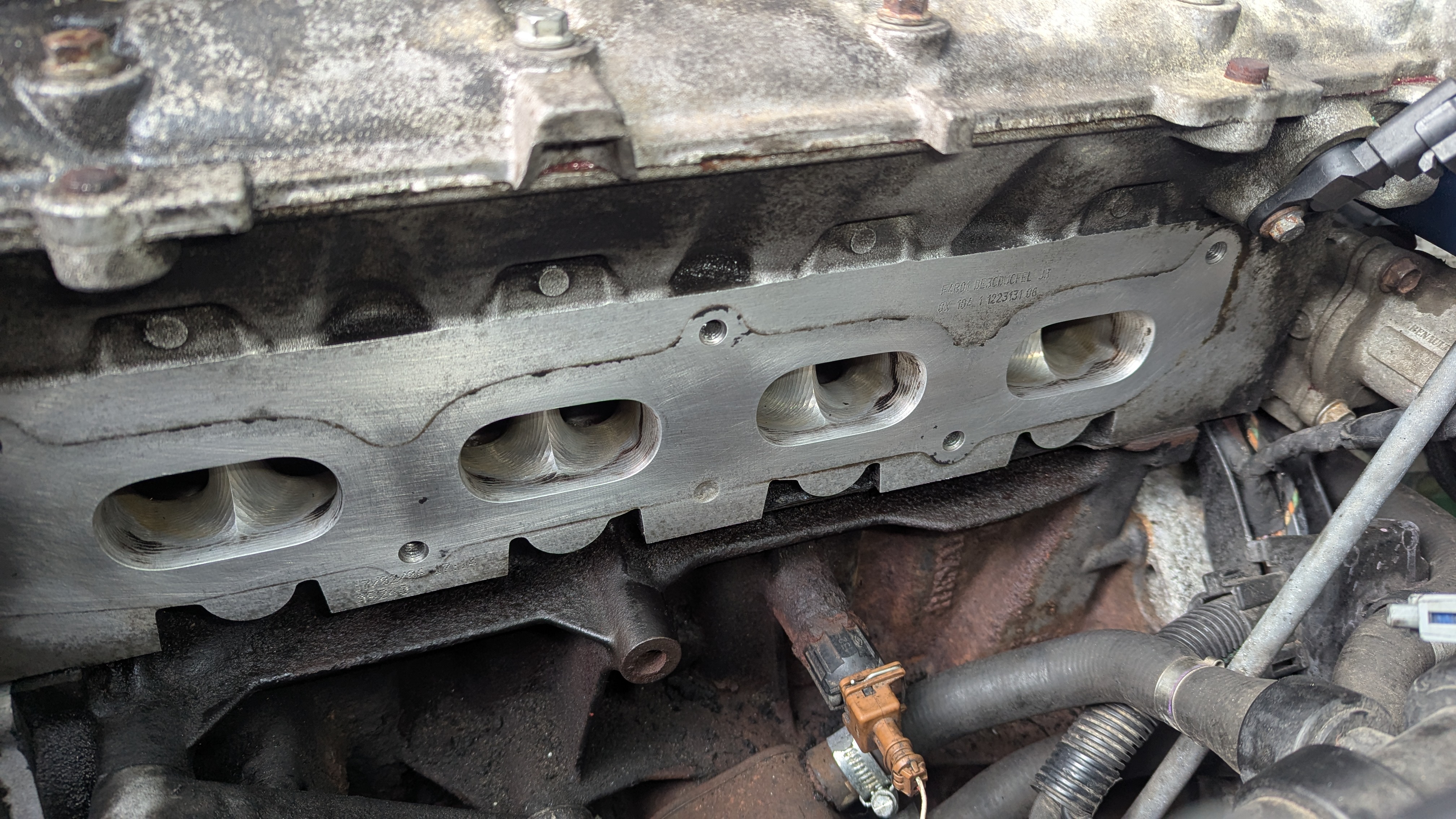

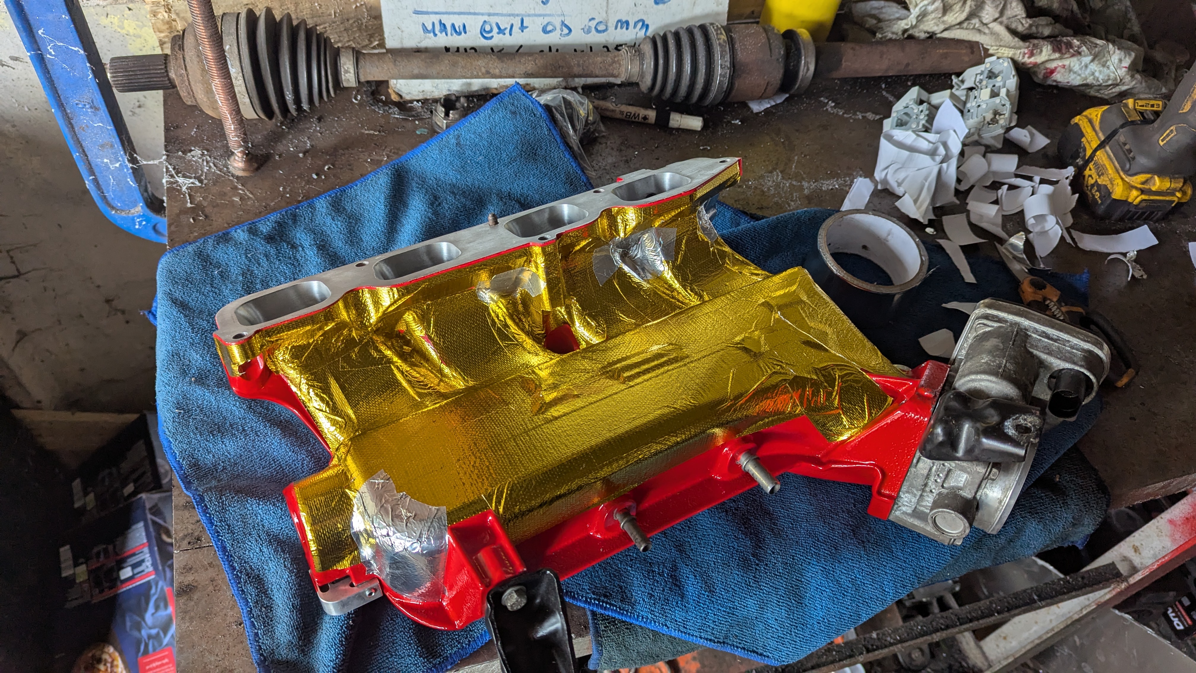

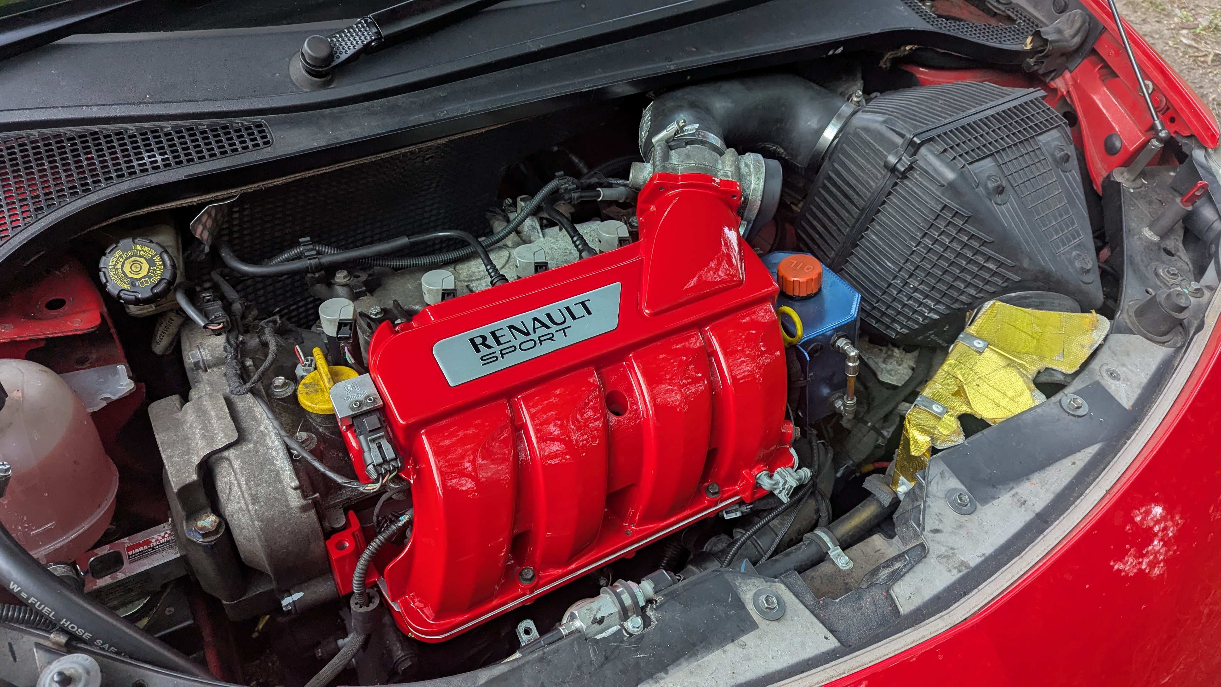

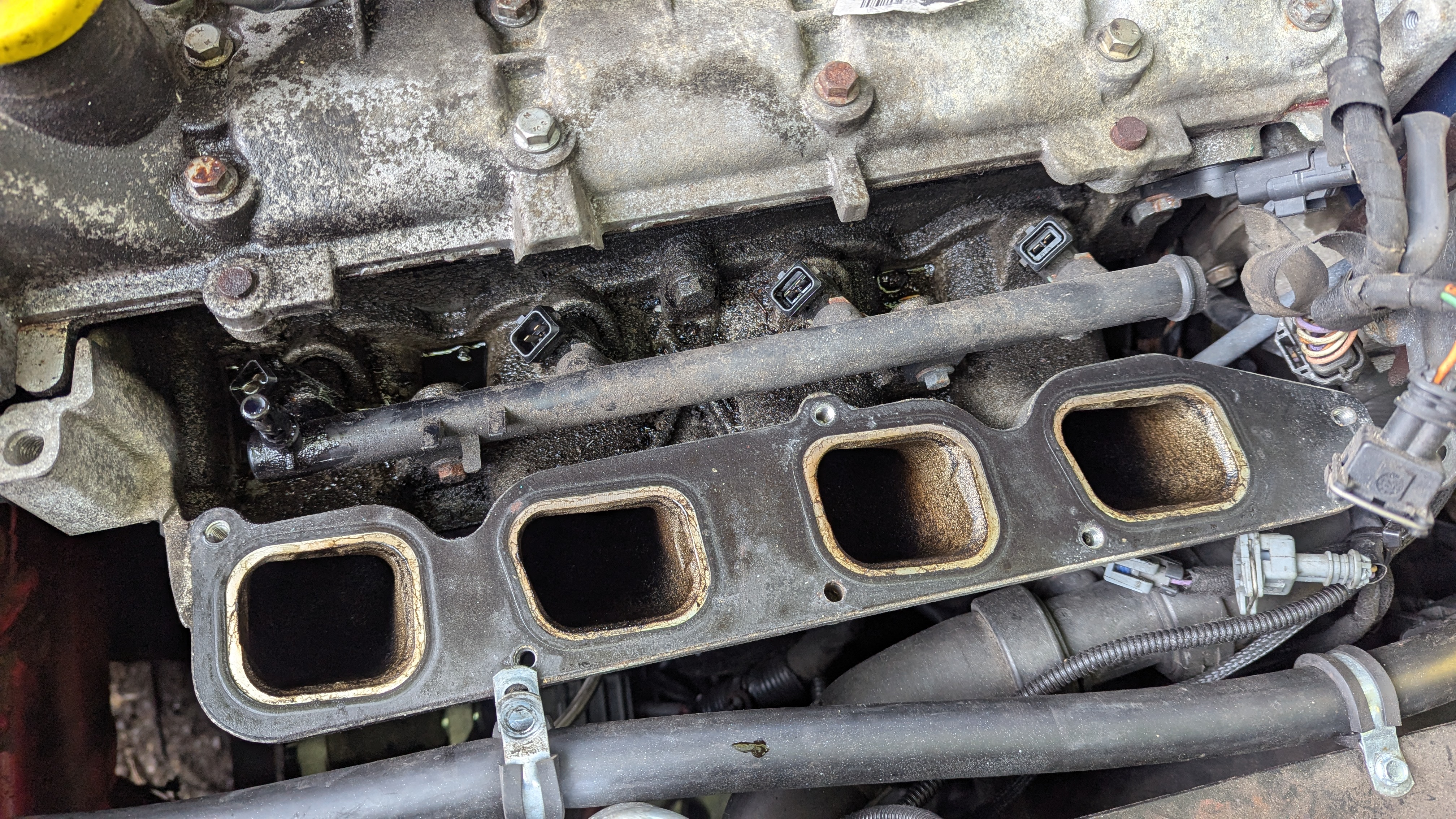

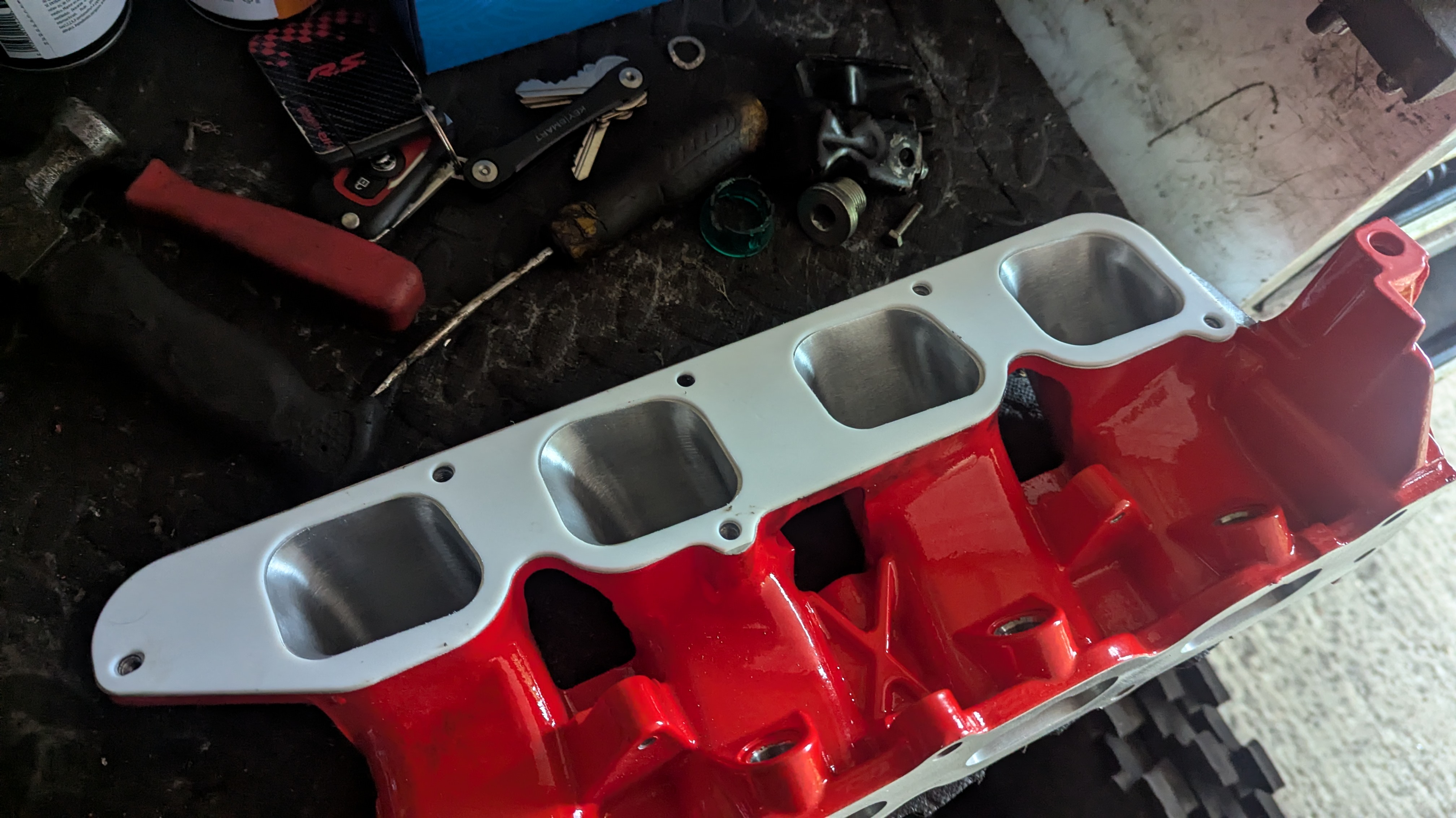

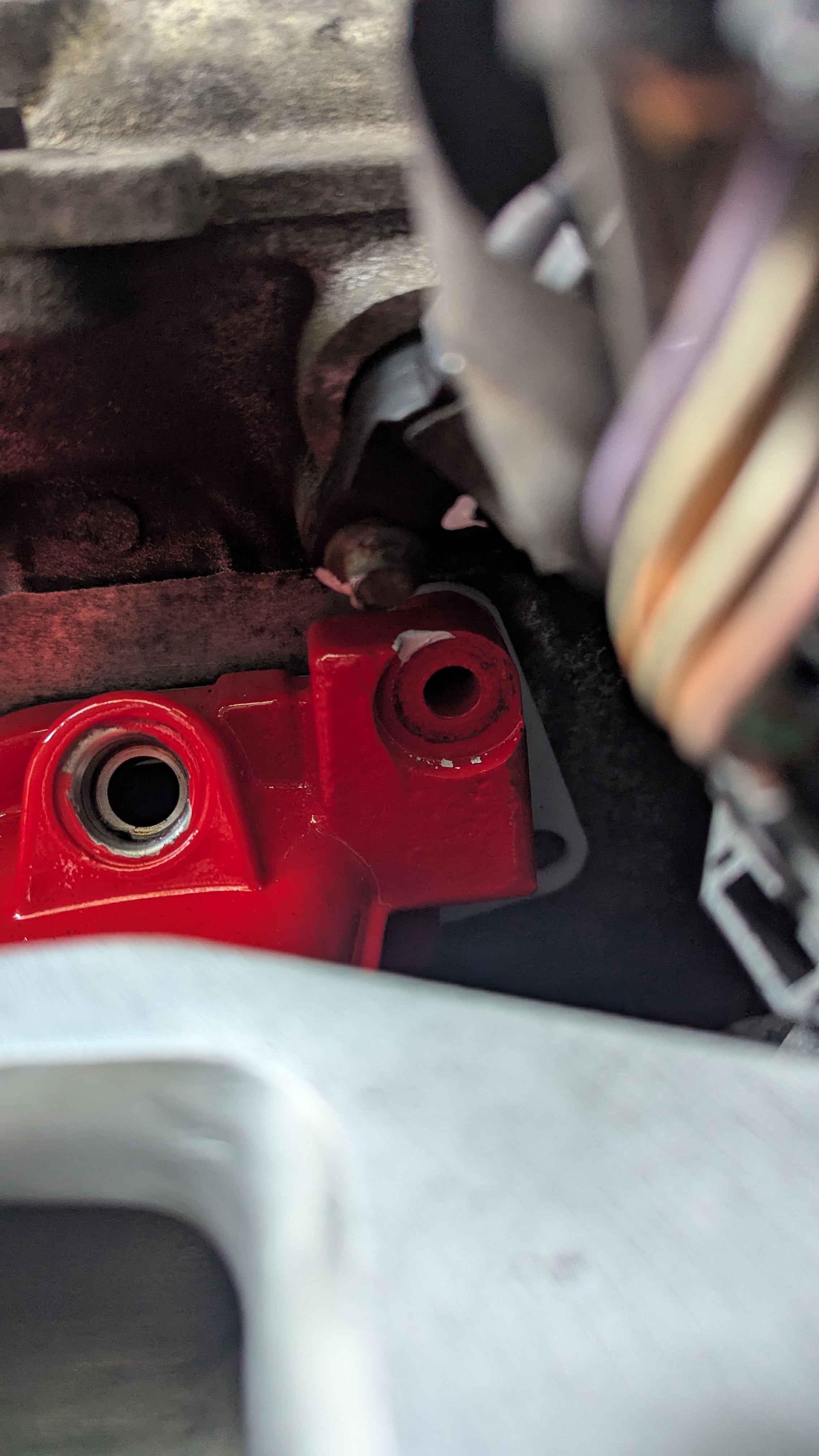

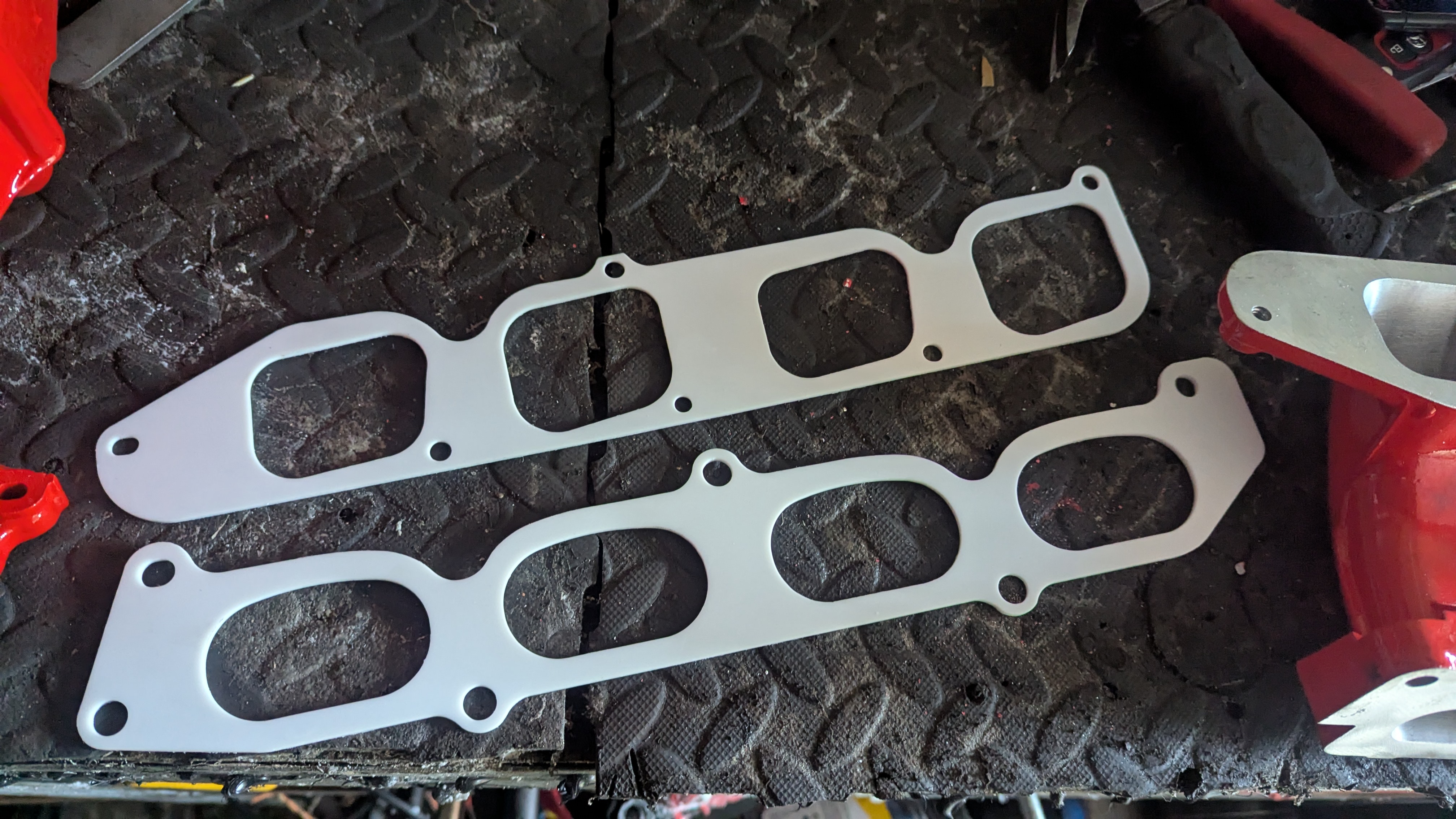

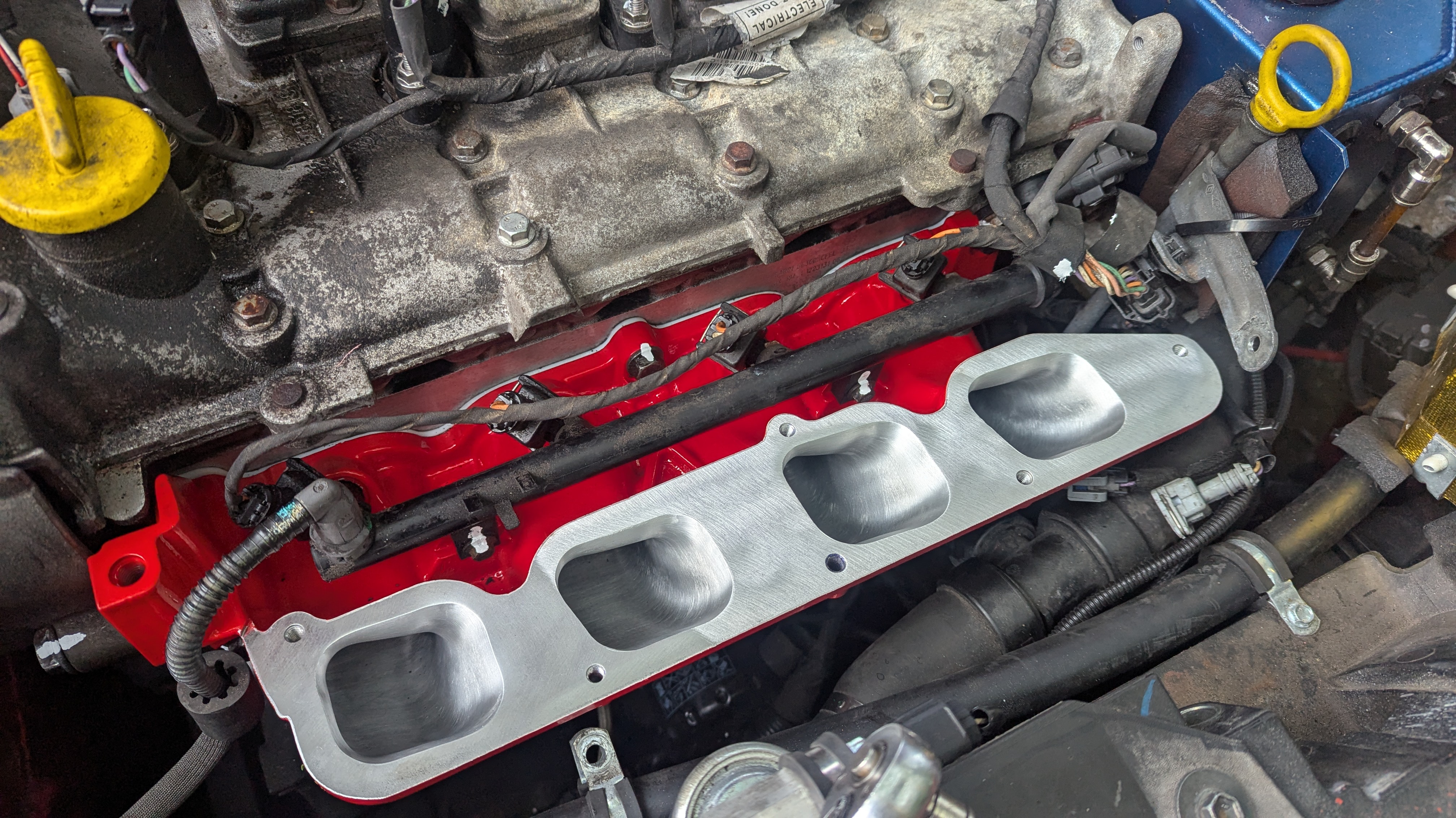

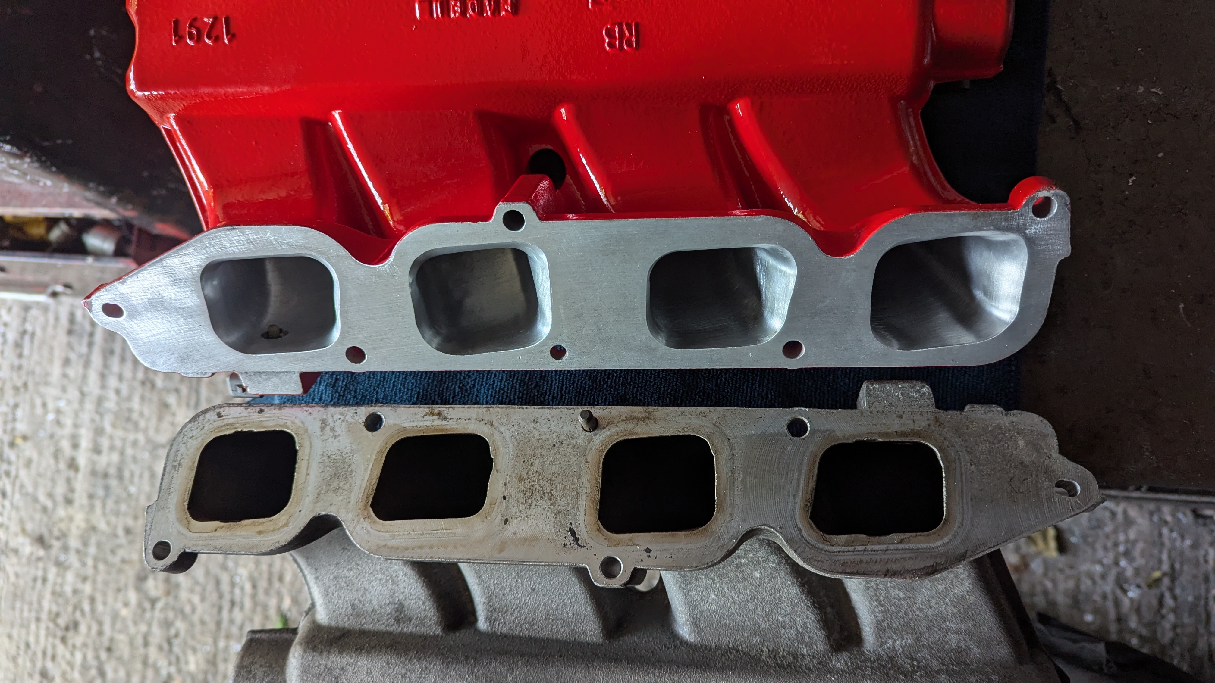

Bought a spare lower and upper intake to get ported/polished and powder coated,the gasket is pretty much the same size as the intake now:
Went with PTFE gasket to try limit heat soak,I thought the description was interesting:
"For every 3.3 °C rise in intake temperature, air density drops by 1%. - An intake temperature drop of around 10 degrees C is expected when using these gaskets on a road driven engine, which is good for around 3 percent power increase."
I didn't know how beatifully machined our cylinder head already is lol:
The first time I fitted the gasket the wrong way around,what a cock!
Also have used heat reflective tape on the back hoping it will do something good lol.
I bought some yellow trims from the same chap. The lacquer on the first set he sent me was a bit thin and got damaged in transit. He is a pleasure to deal with as he apologised and I am just waiting for a second set to arrive.
Your trims look great in red.
Reactions: VeiRoNv2
Yes I was only able to find out from another member on here which gave me his name on Insta,was it you? That was much appreciated as I had been looking for the past year for some custom trims,I was impressed with the qualty considering they are handmade,it's never easy to find people like this as they never seem to do much advertising lol.
Thanks although I wouldn't use any of these diy flock kits as it's a pain to get a uniform coating and companies that can do the flocking for you are pretty expensive, that's why I went with the stretch material.
Reactions: Don Hogg
I see, what kind of stretch material is that? Also, are you still running the b-pillar covers? Im planning to take out the roof lining but a bit hesitant about how it will look without covers for a-pillars and b-pillars with all the wiring etc?
It is a faux suede material but since then i think i found a better one which is 4 way strecth and should be easier to fit,only downside is it has a foam backing so once it's glued you can't reposition or it will tear the foam off.
I dont have the B plastic pillars anymore,only the A pillars are left,as I also removed the original seat belts,to cover everything I have used an adhesive carpet like material for vans.

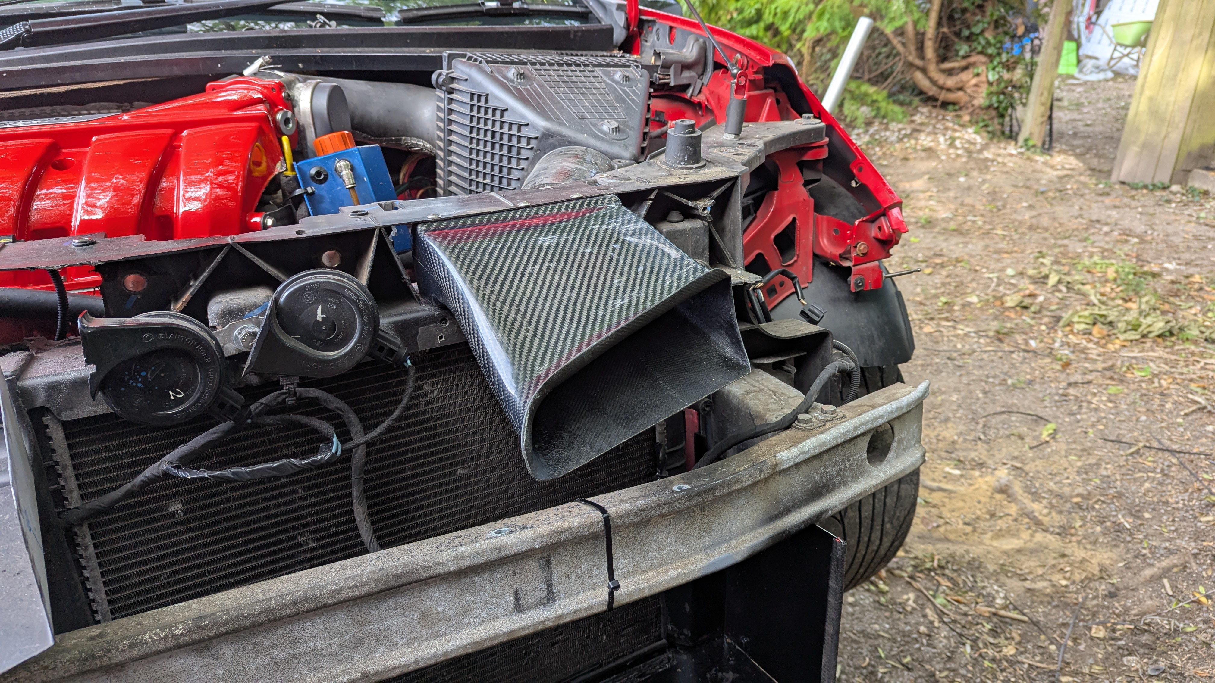

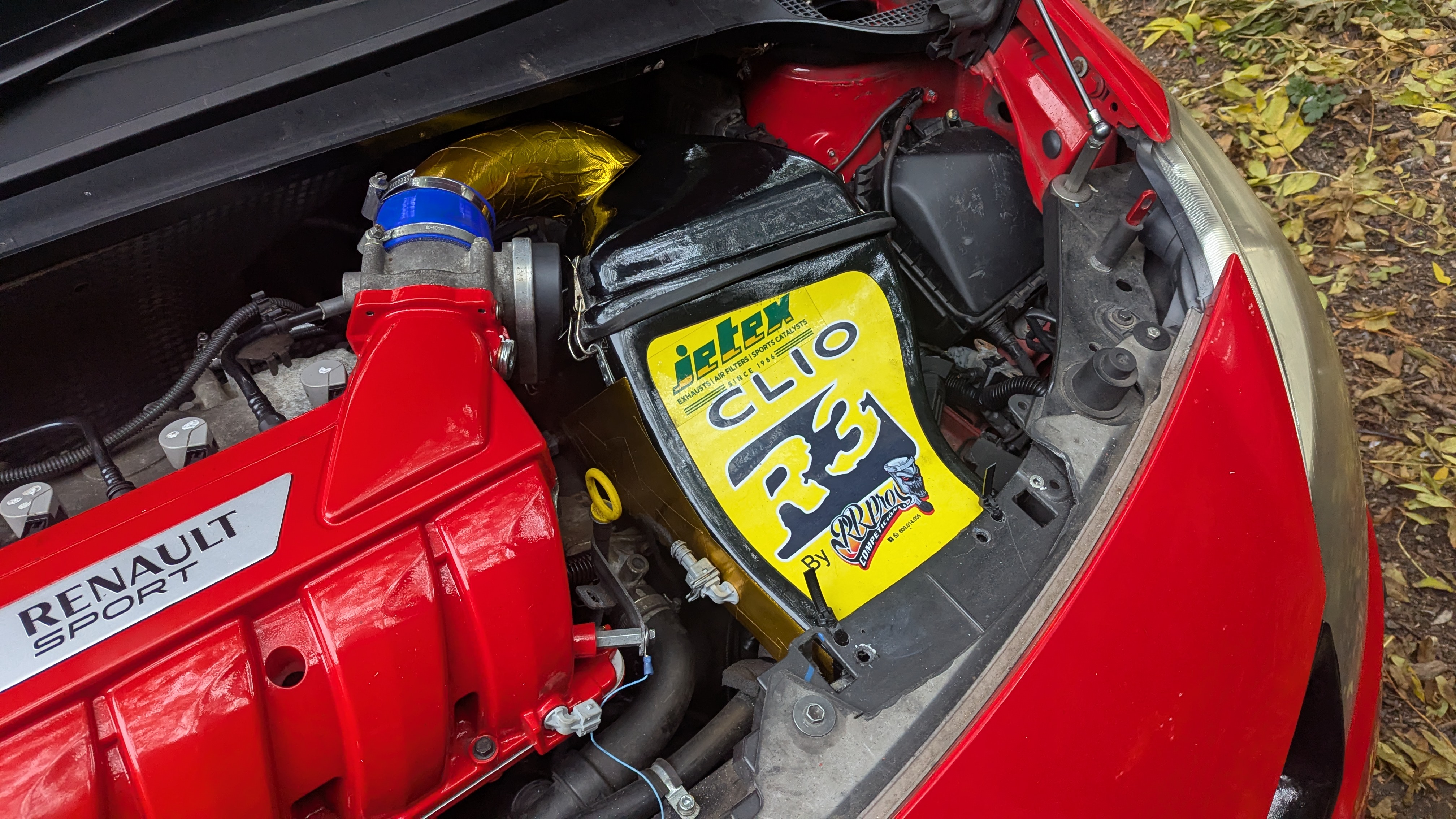

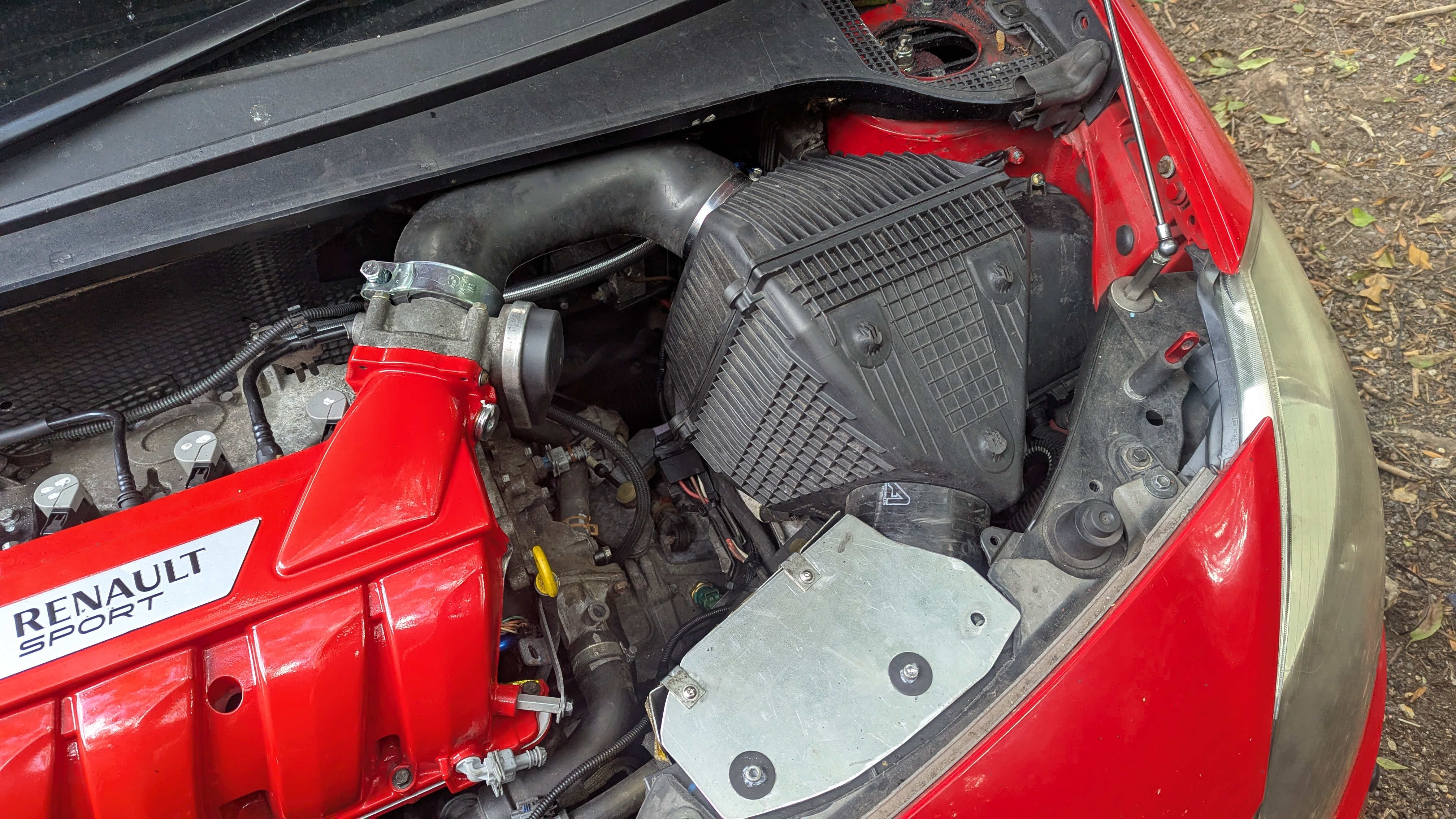

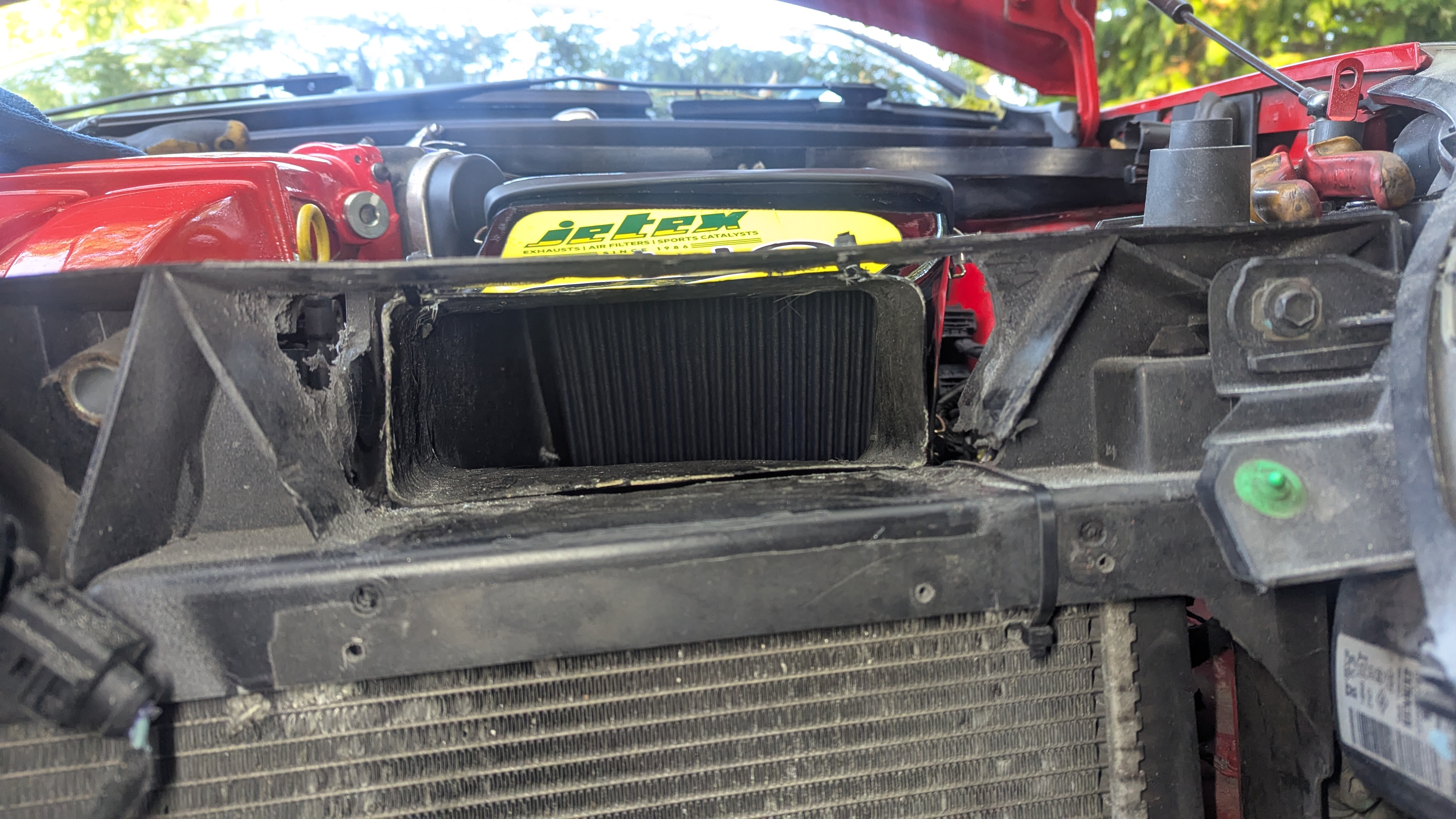

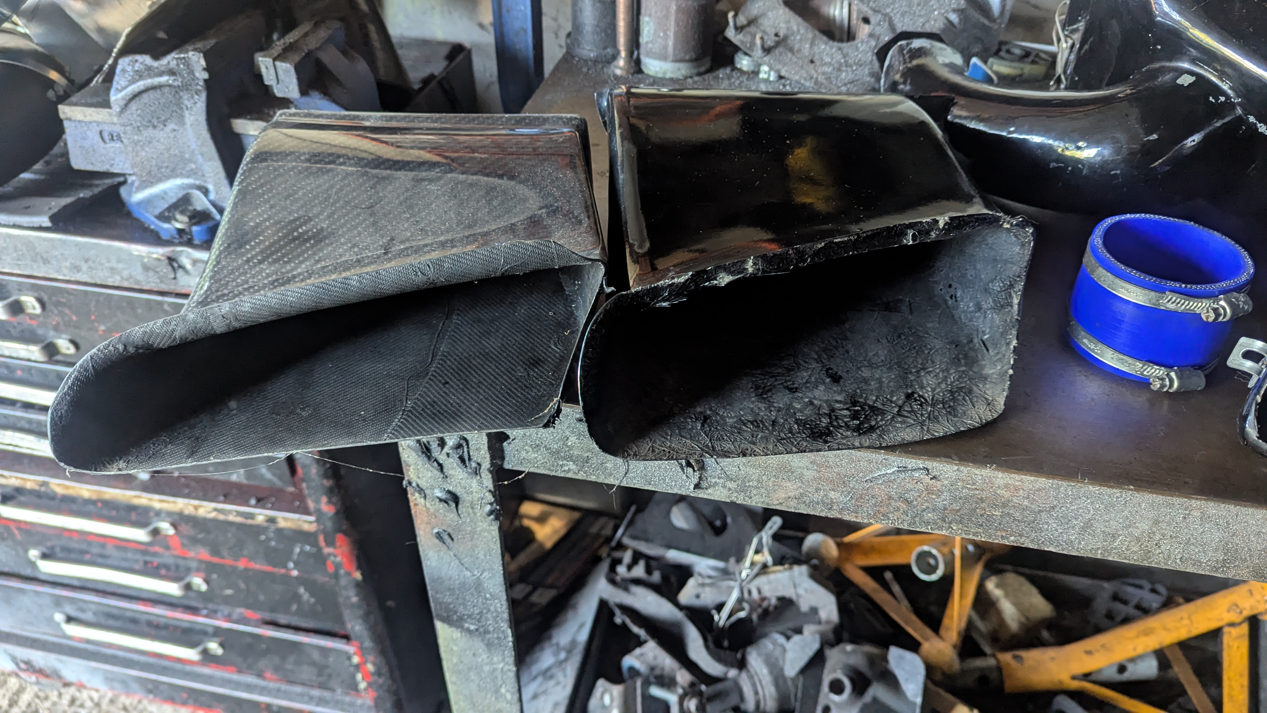

Got a proper air duct for the V6 airbox,before:

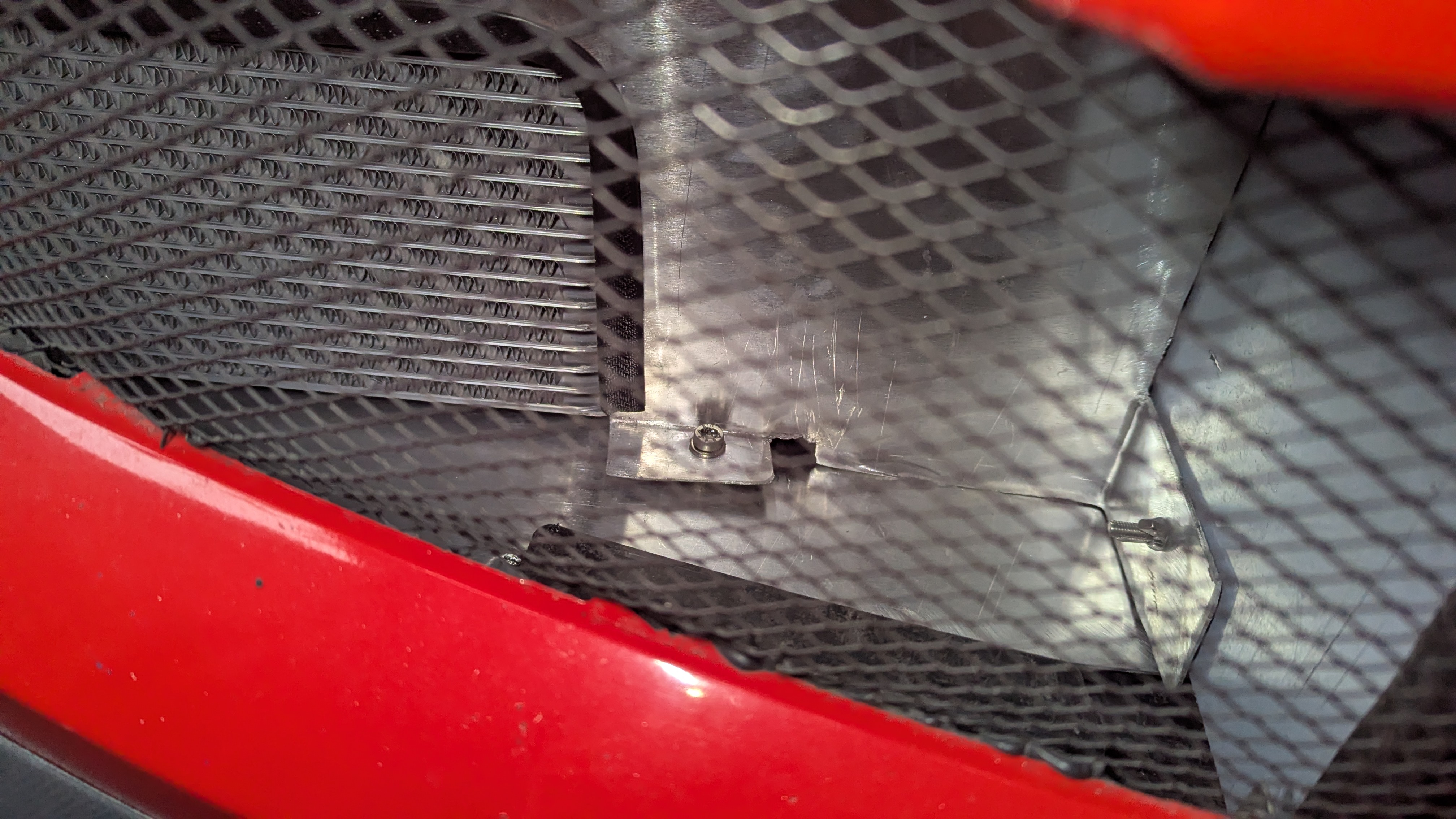

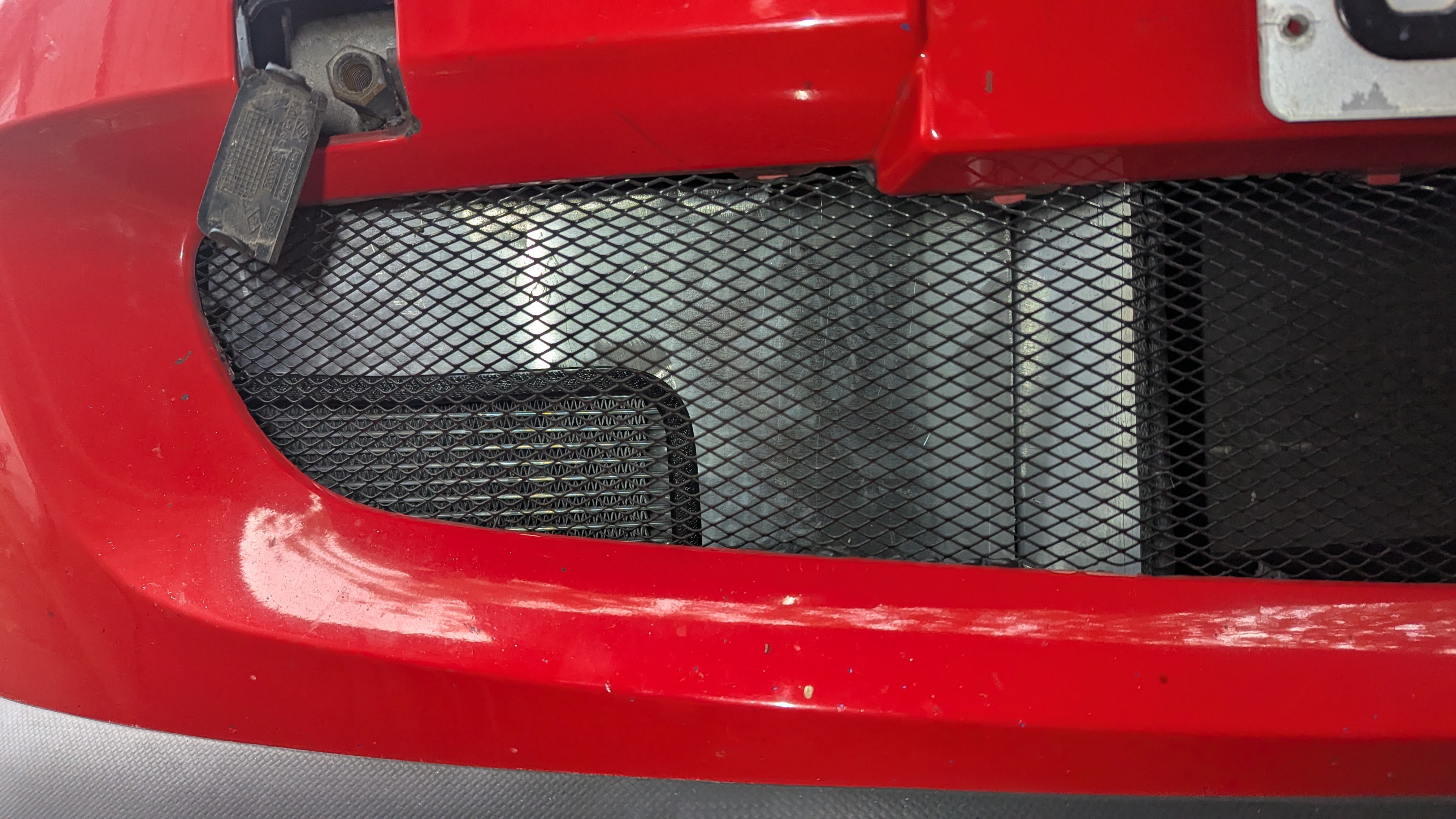

I have used some ali sheet to direct air towards the radiator properly:

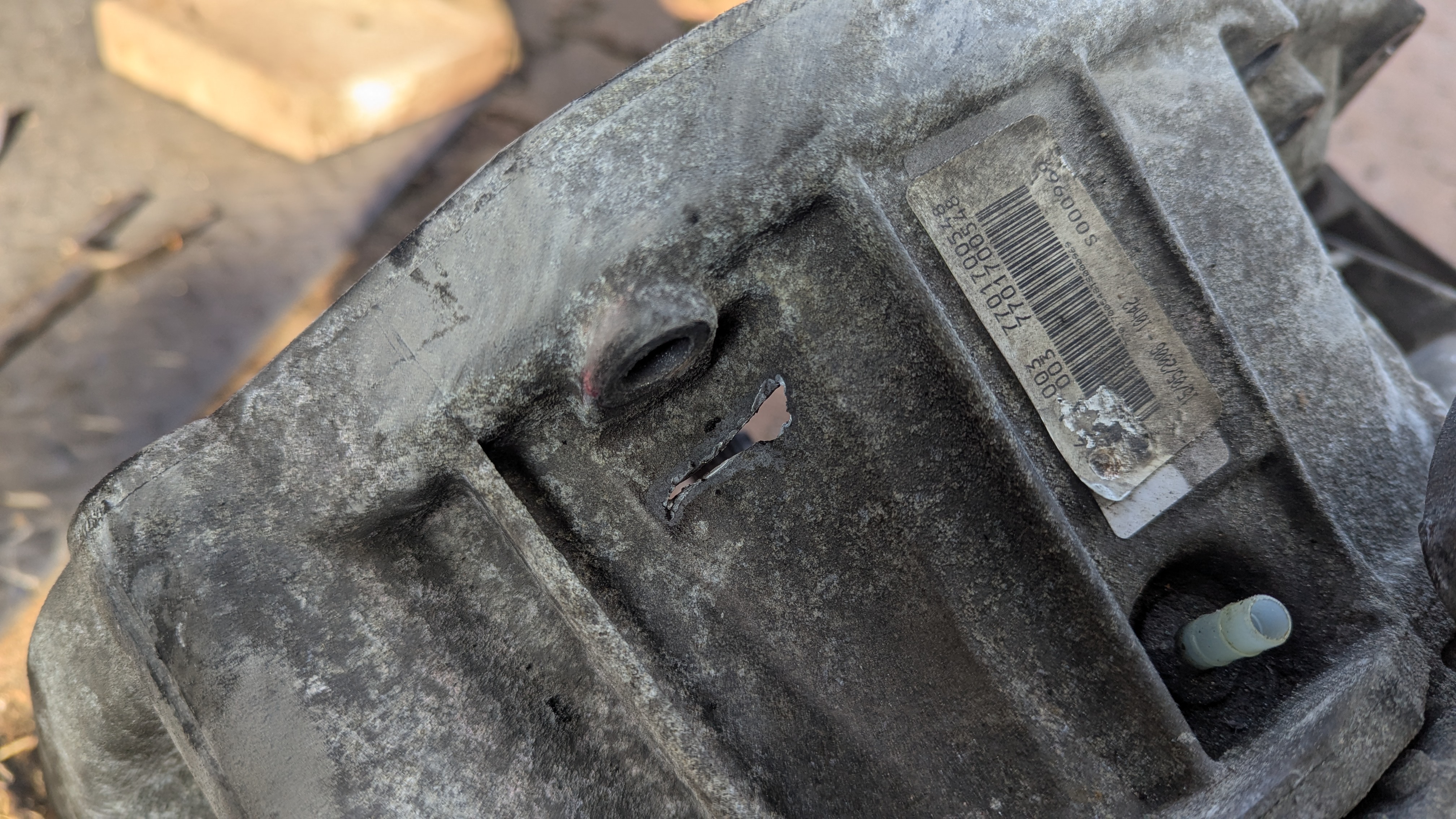

Following day I could hear something that came loose on the gearbox side,I had a suspicion what had happened that I hoped wasn't true.

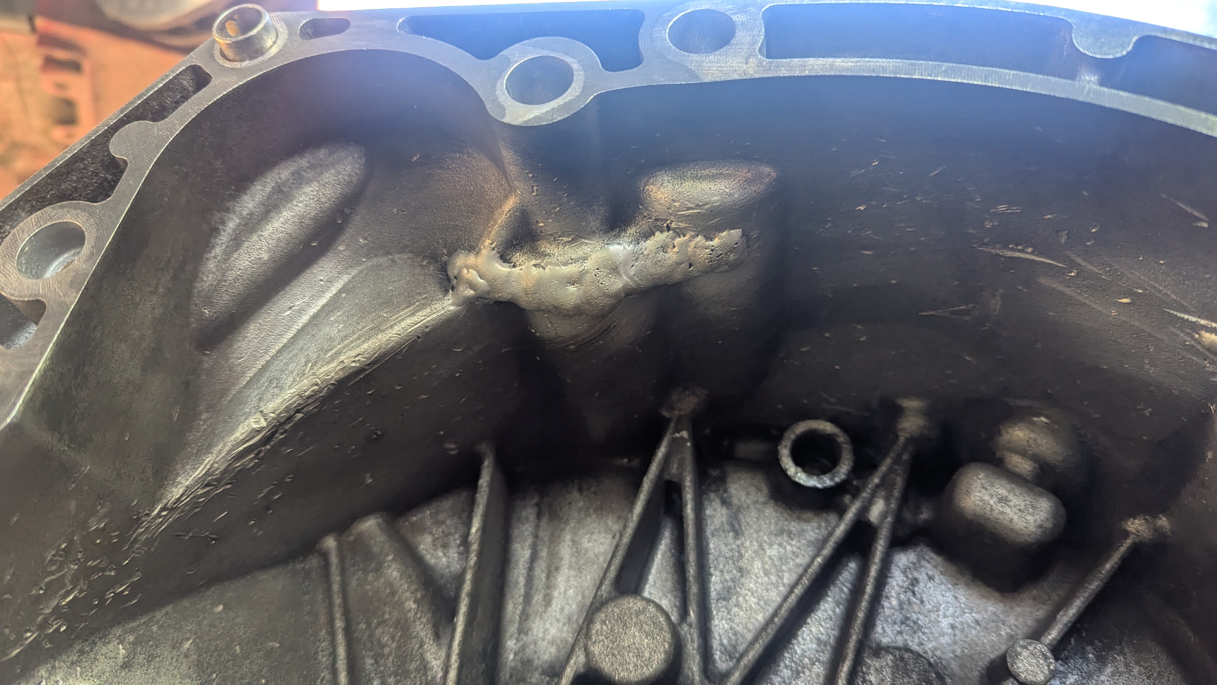

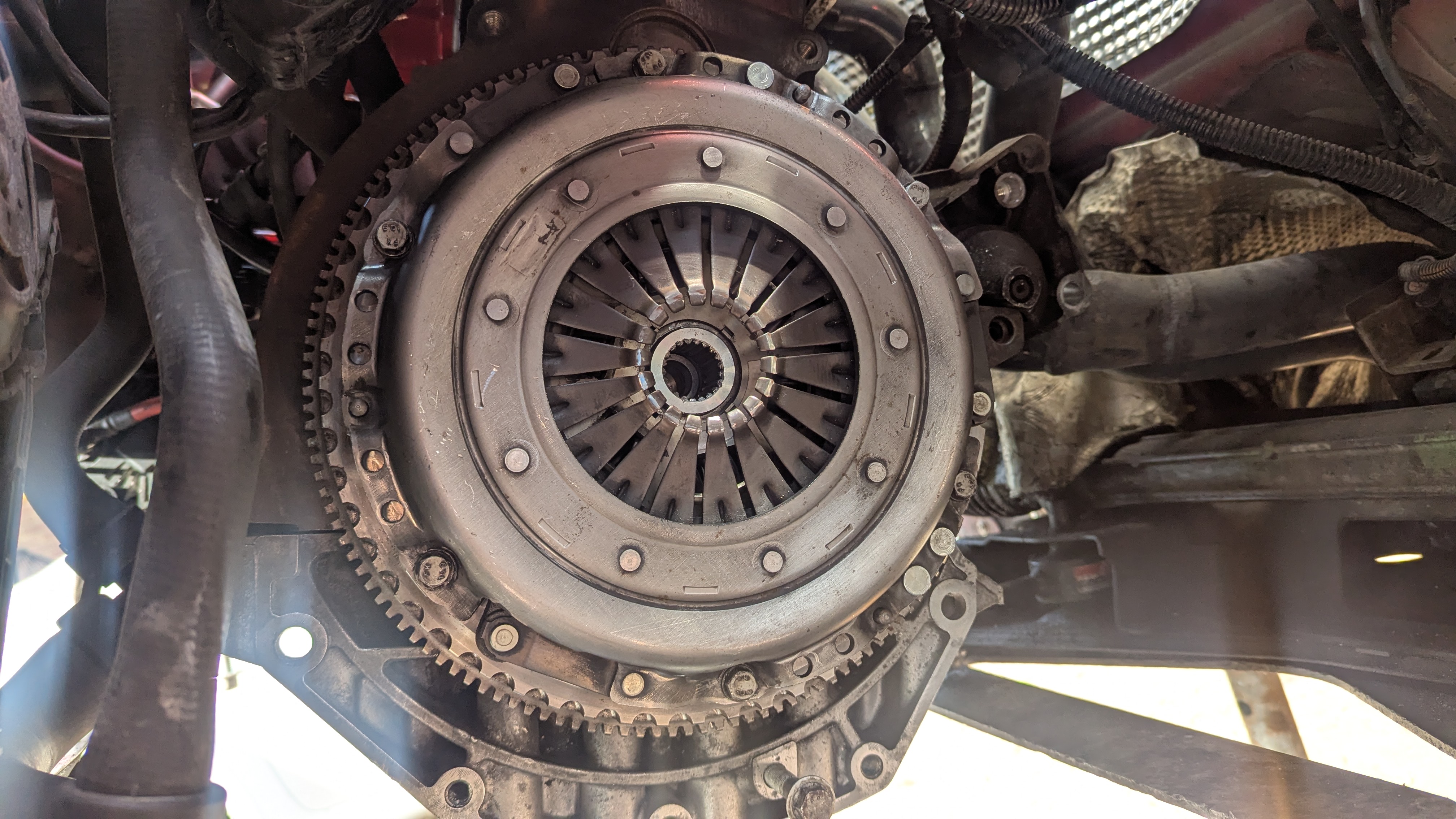

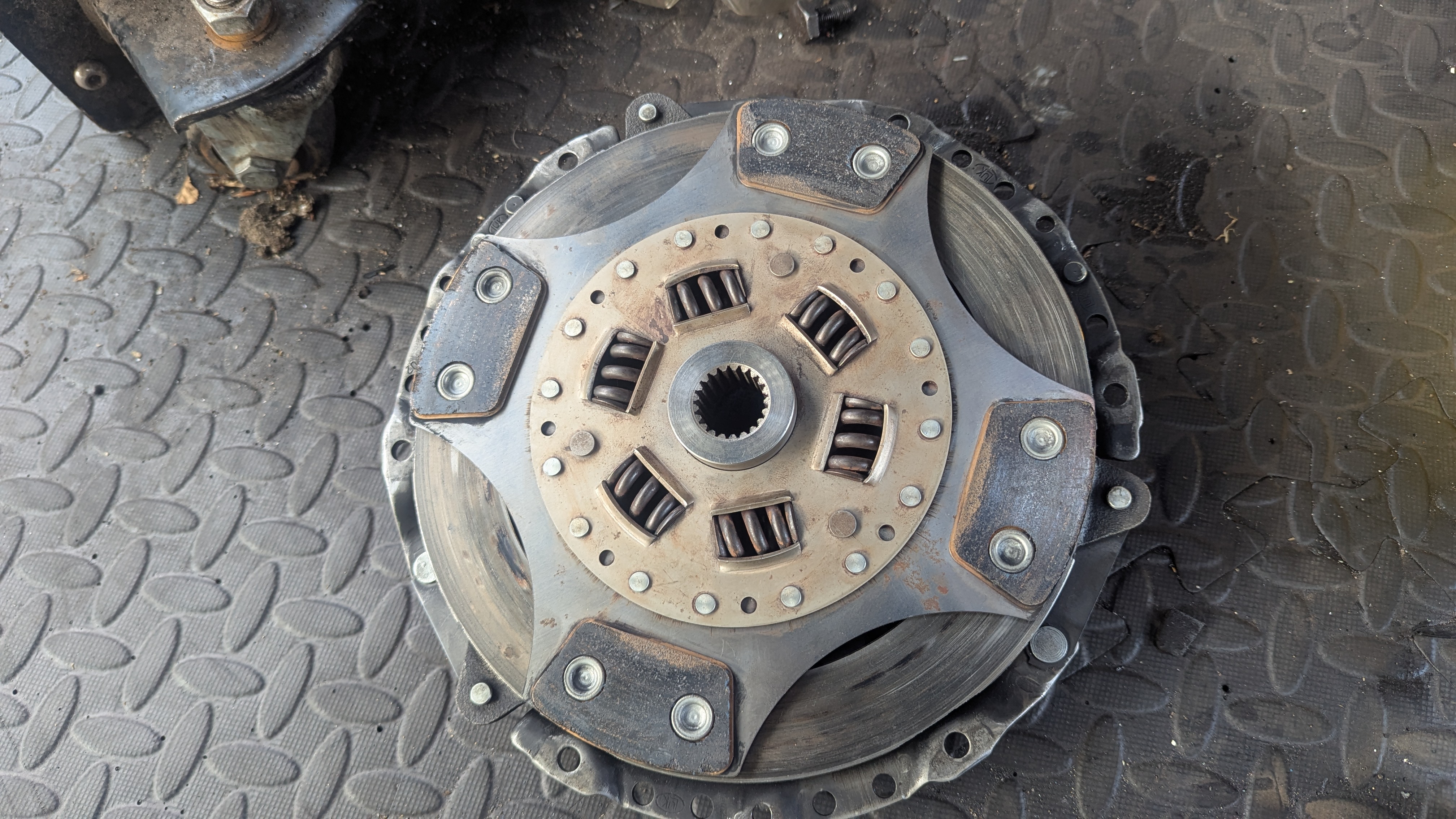

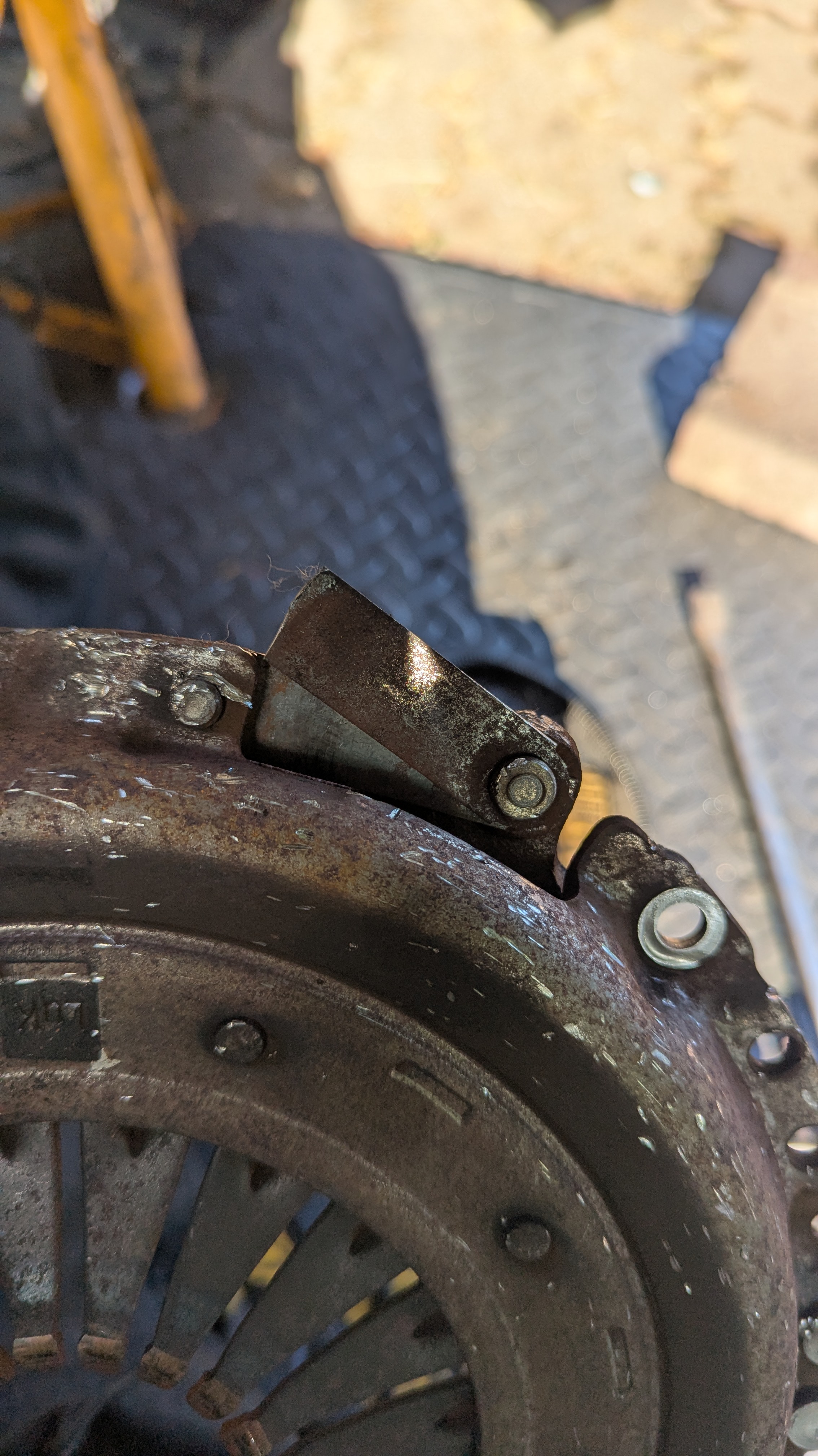

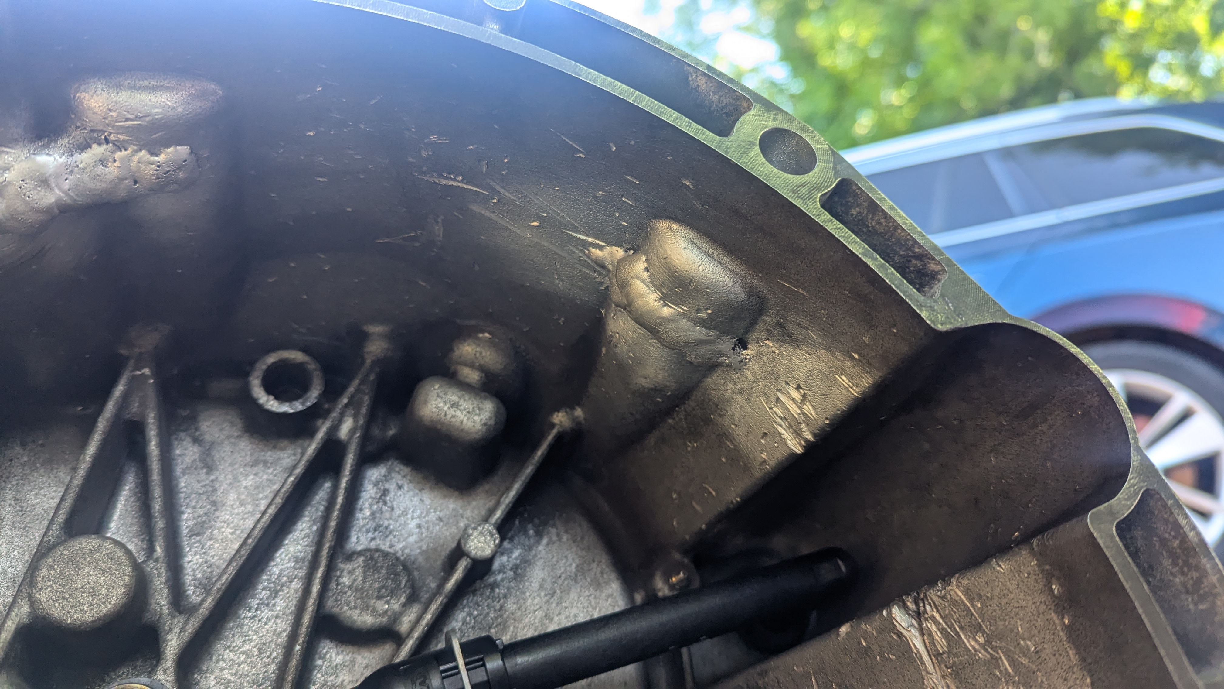

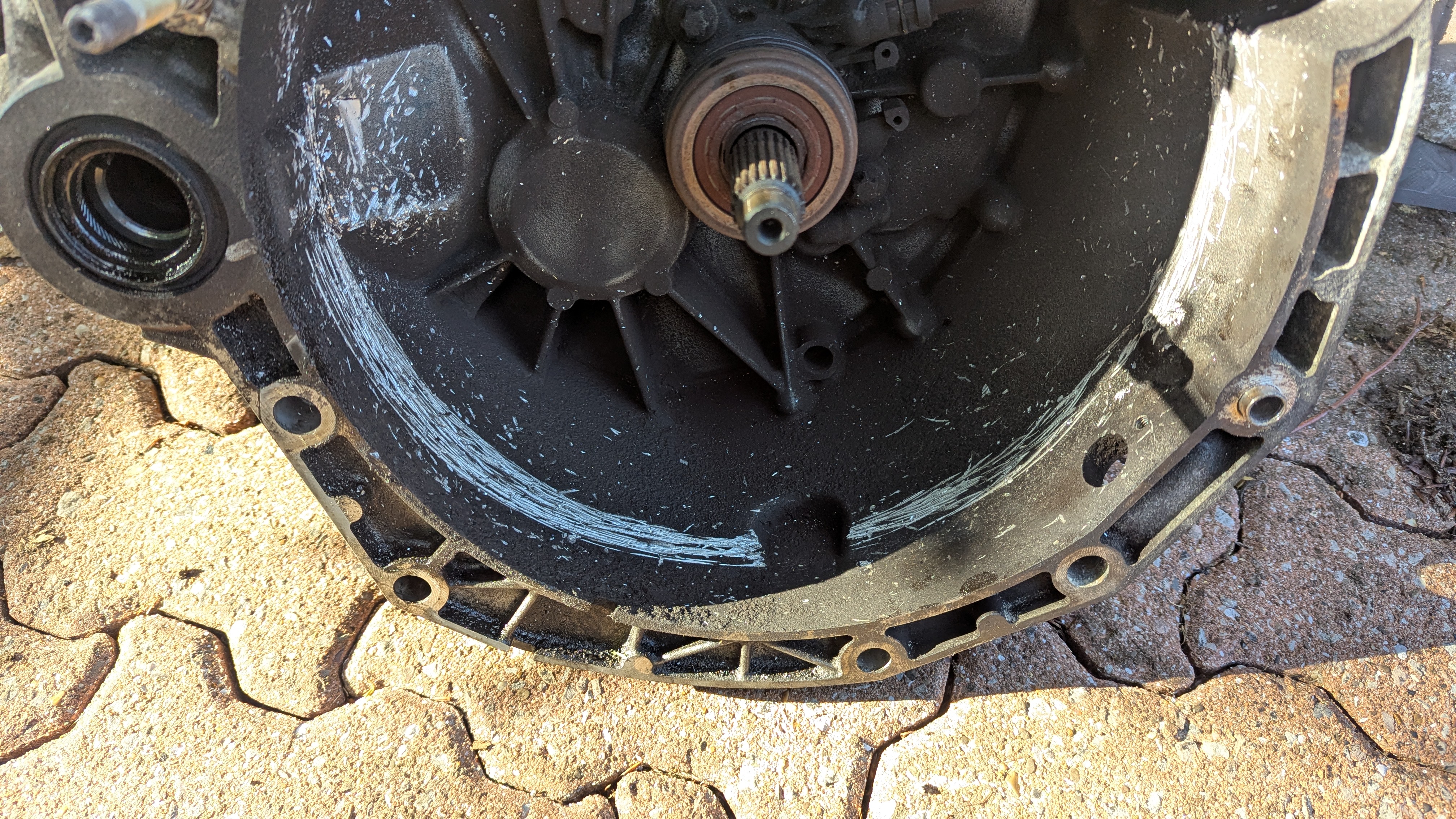

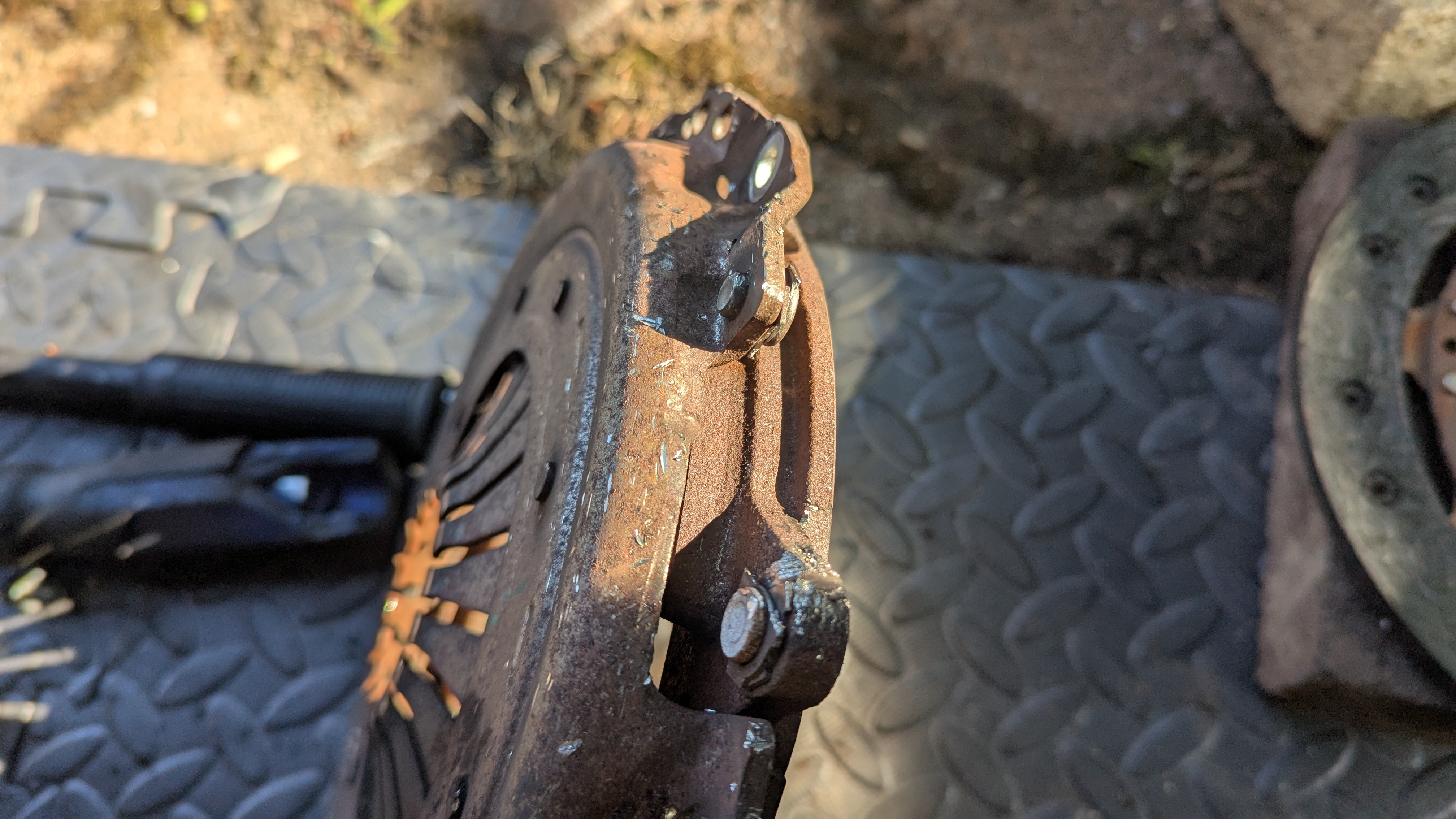

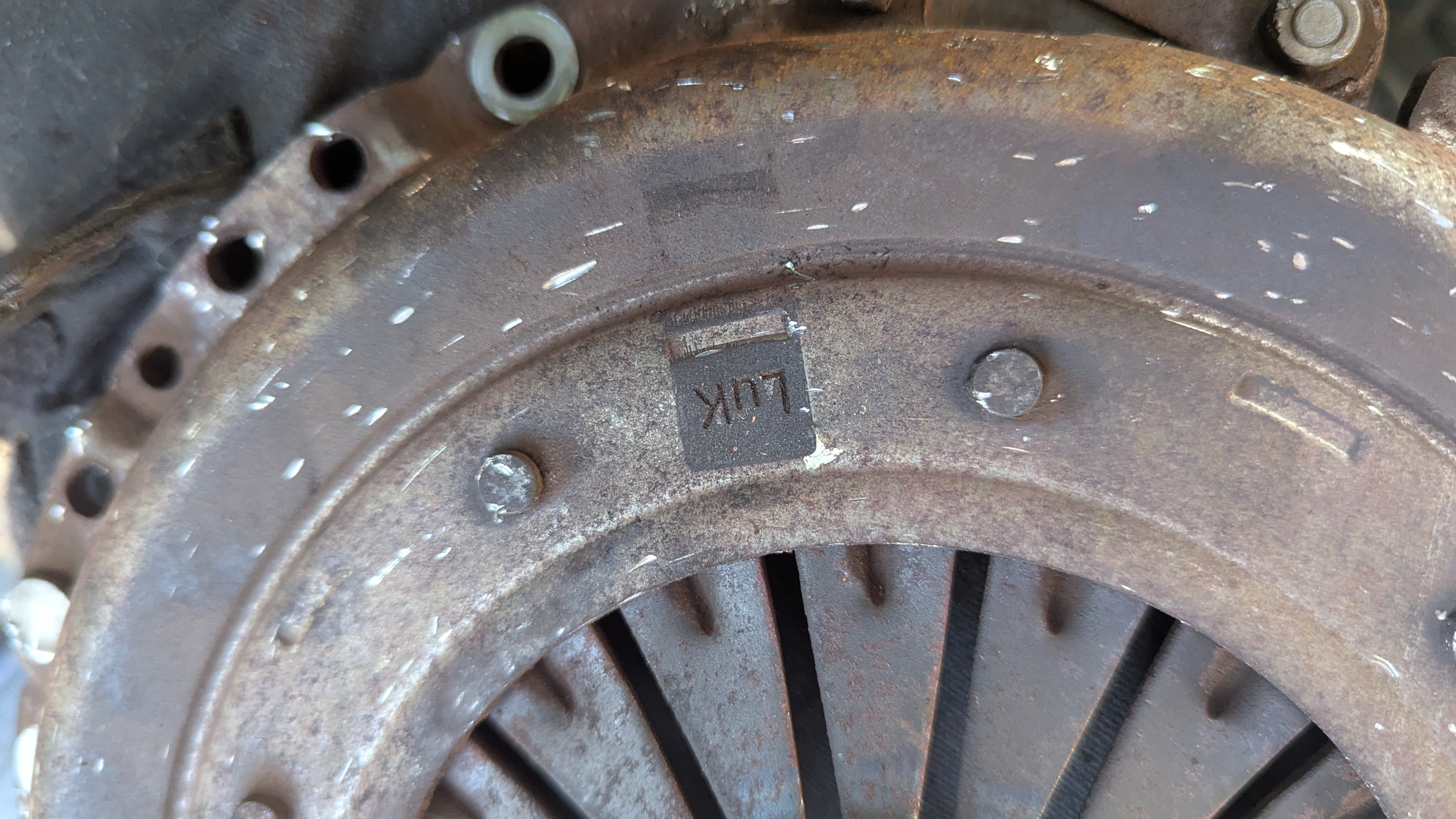

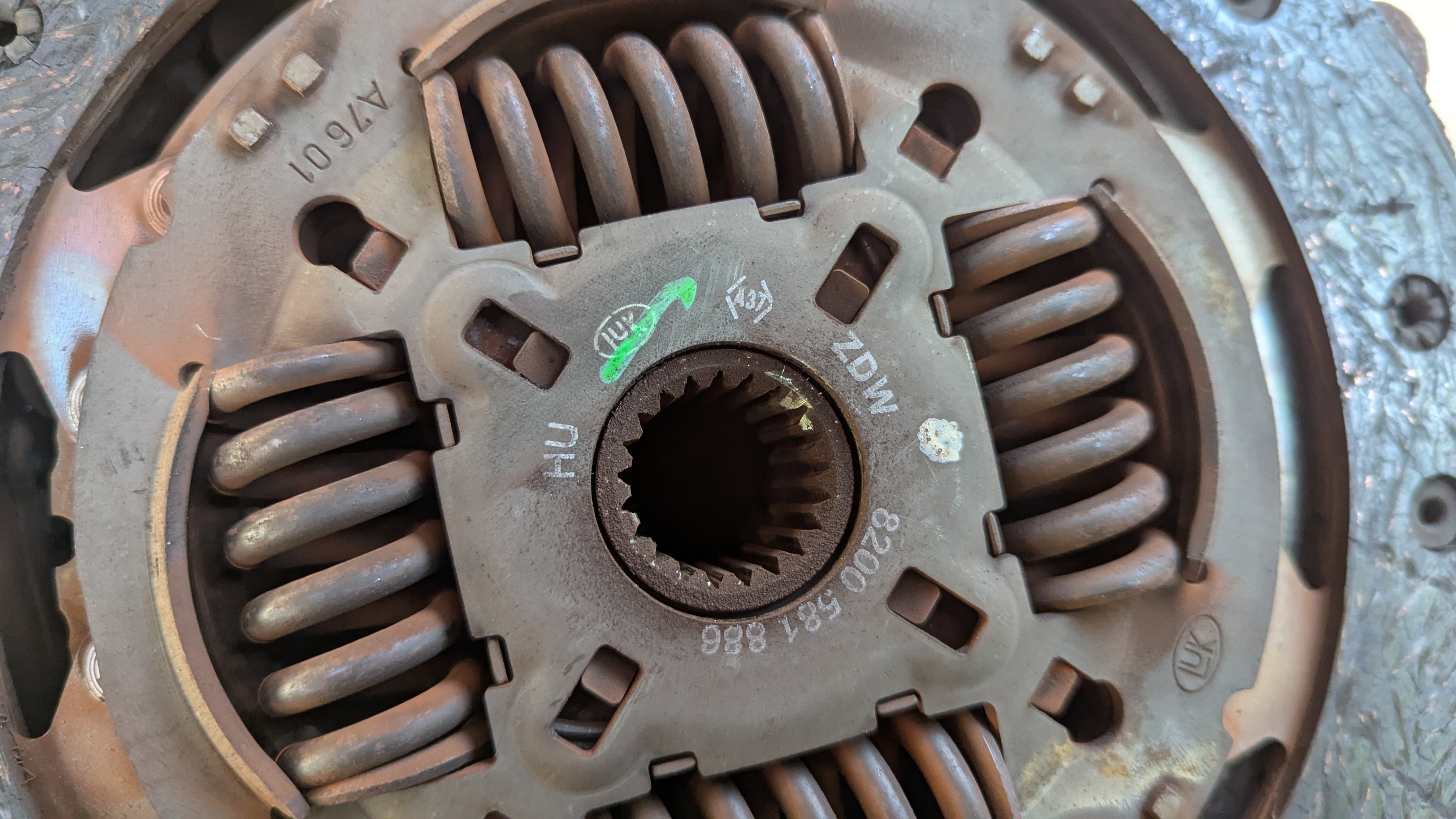

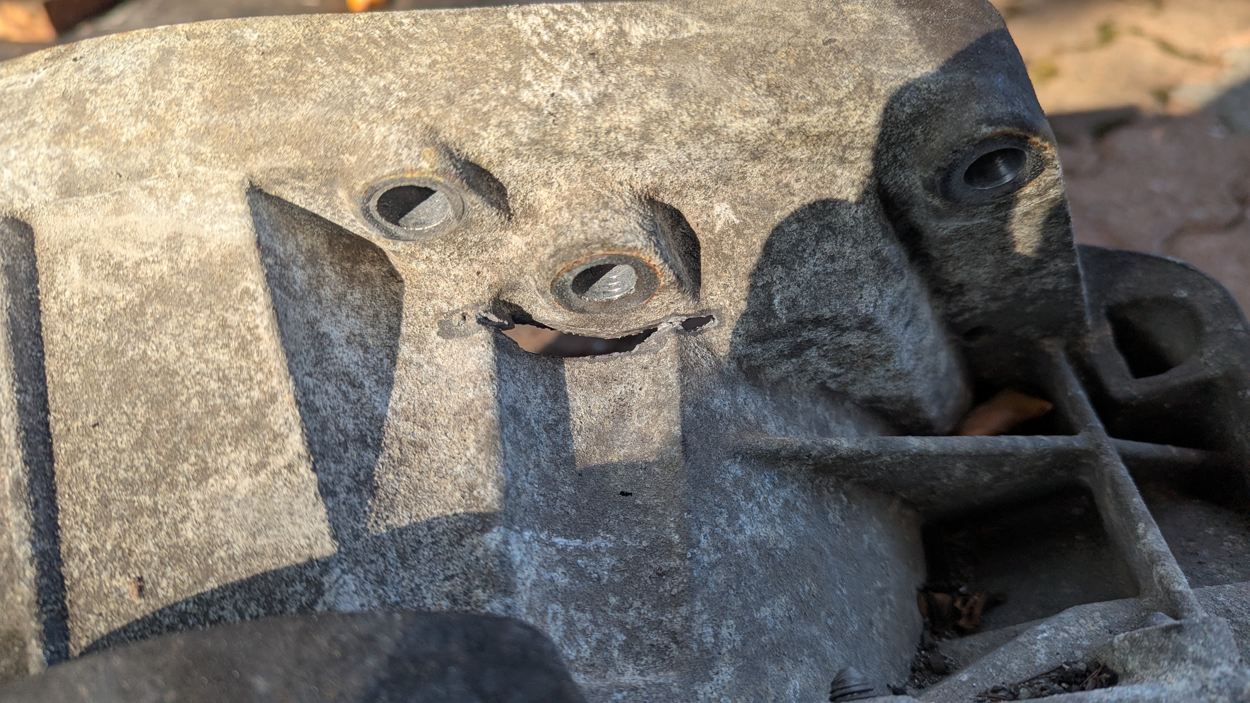

Clutch straps shat themselves and damaged the gearbox too so that's a good job.

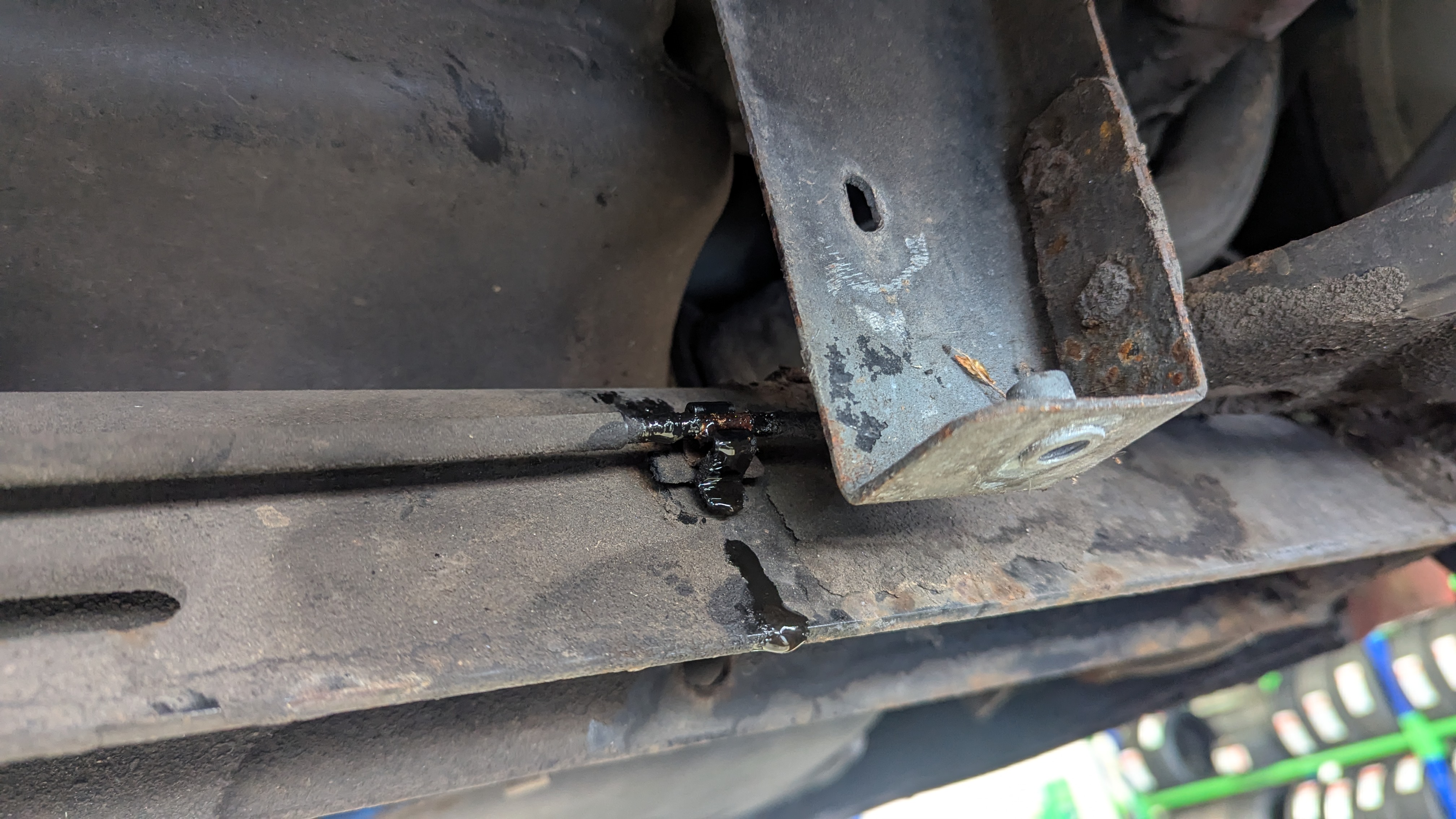

Does anyone know how I can repair these or anyone that can do TIG i can refer to? I'm afraid it will just start cracking all over the place if I fit it back like this.
Old unit looks to be an LuK one which I dont think its the Genuine Renault and will stay far away from.
Reactions: Don Hogg and Onrus
That is not reassuring at all. :worried:
This is a genuine one from Frogjam,I can see Valeo and LuK on the clutch but nothing on the plate so I don't really know if even to get a Genuine one or not.
Got the gearbox welded from a hot rod shop nearby,i think they done a pretty good job and only charged 70£,it's welded on the other side as well but need to get a picture:

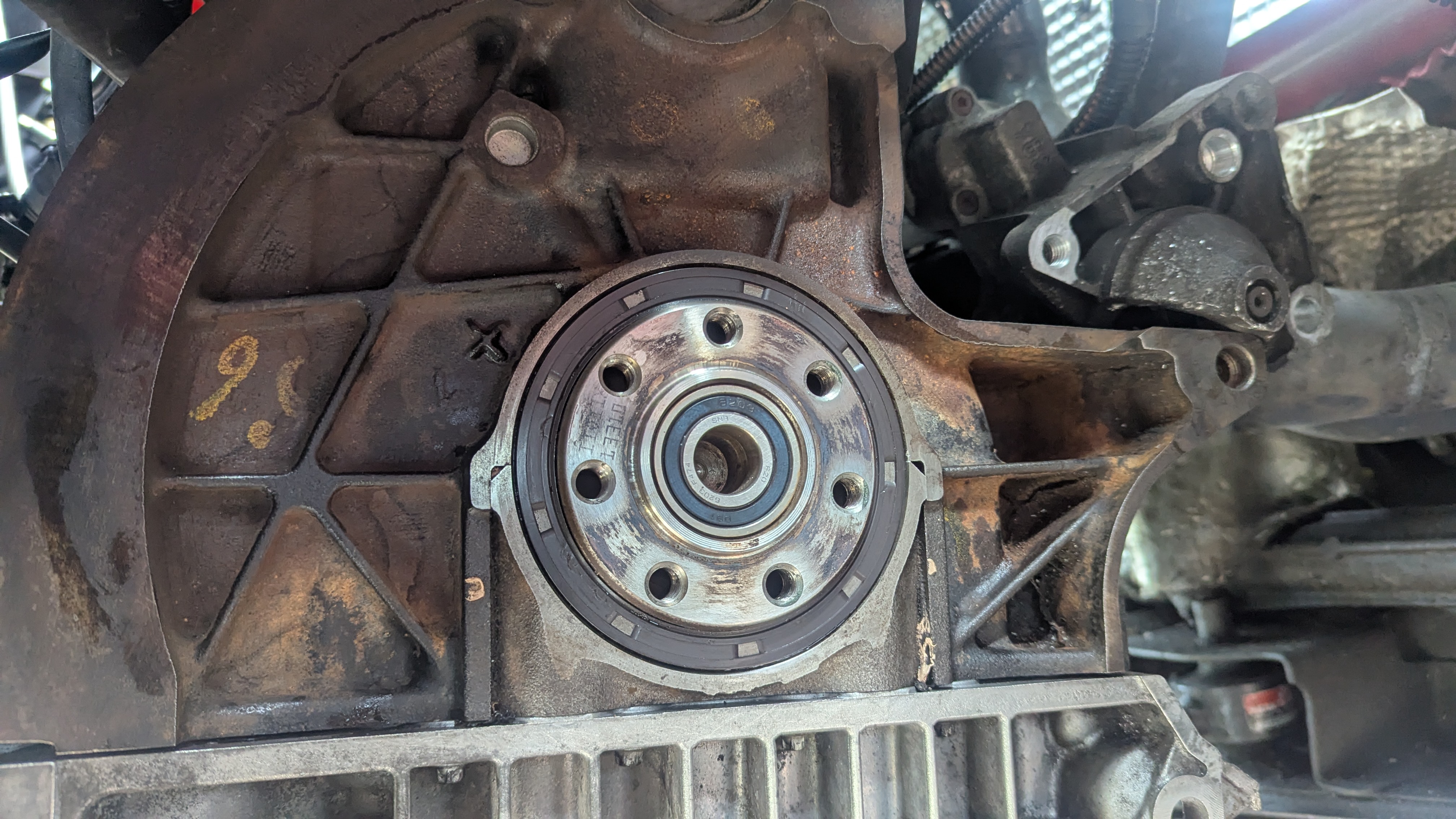

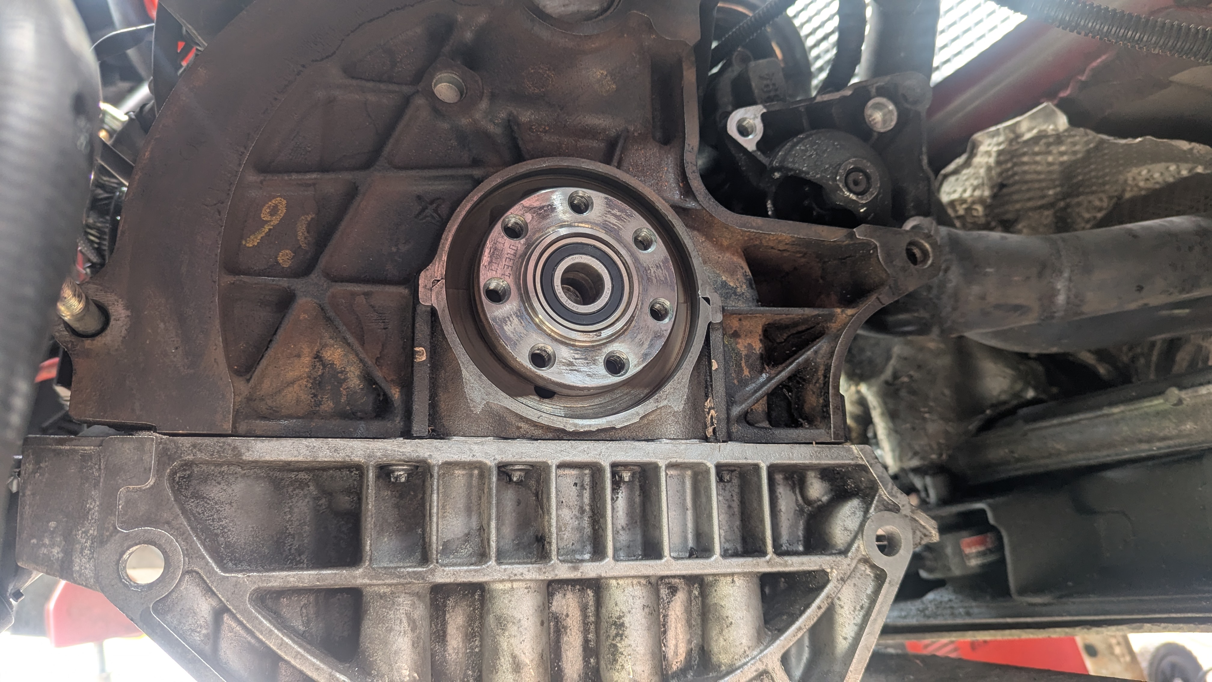

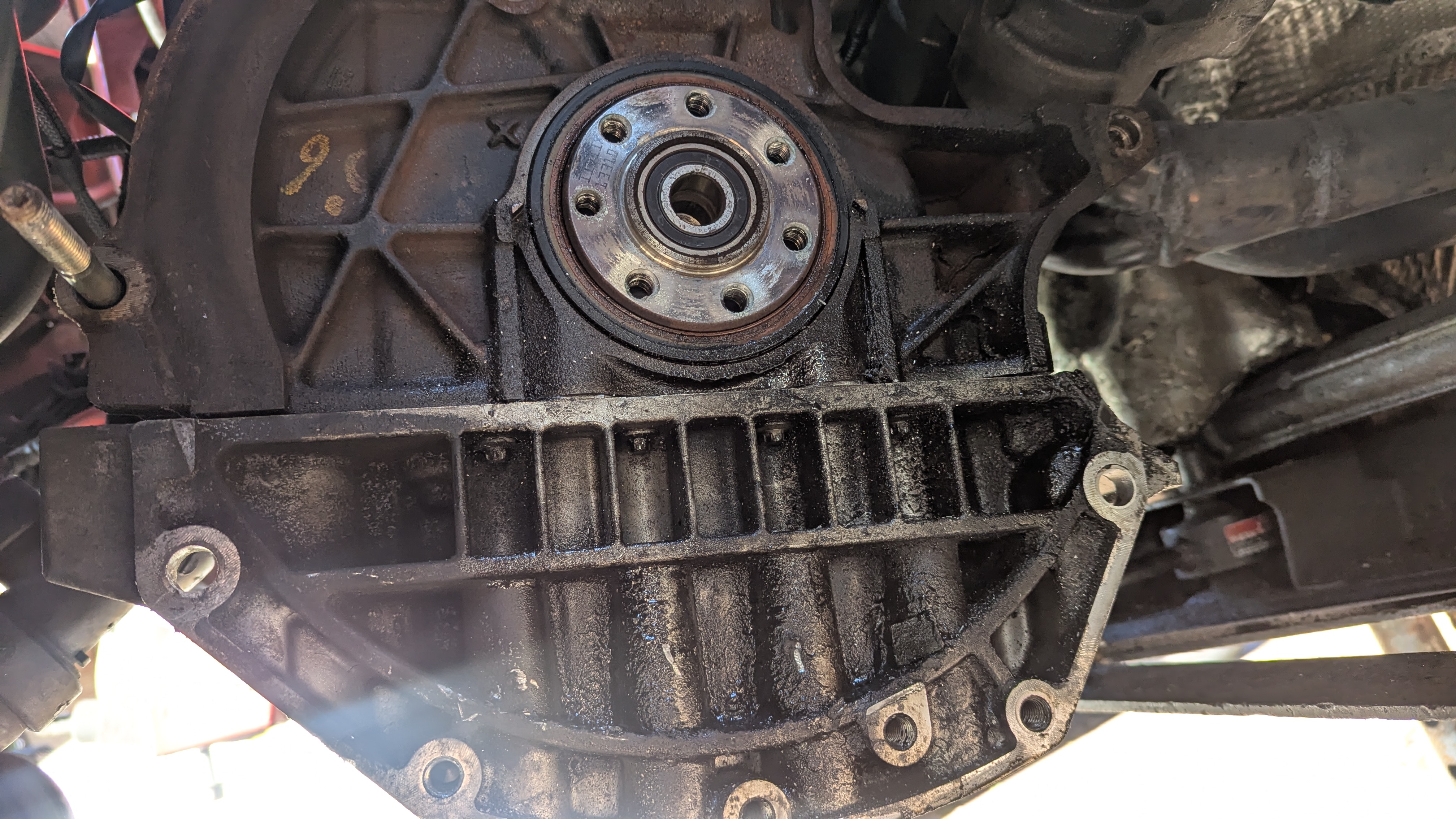

While the box was off I replaced the crankshaft seal,hard to tell if it was leaking from just the sump or the seal too but cleaned up everything first:
The outer shaft support bearing was spinning all nicely so I didn't change it.

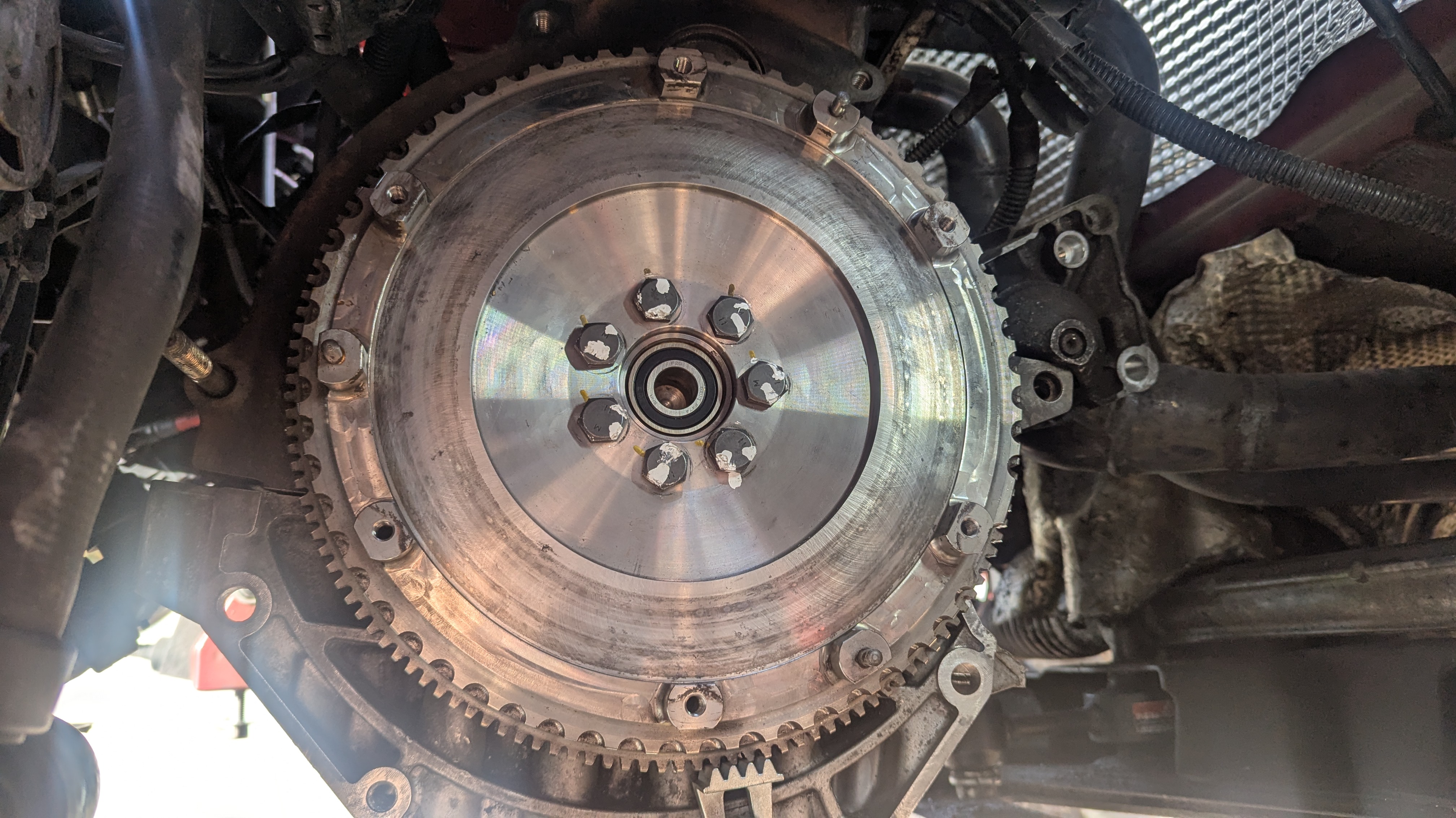

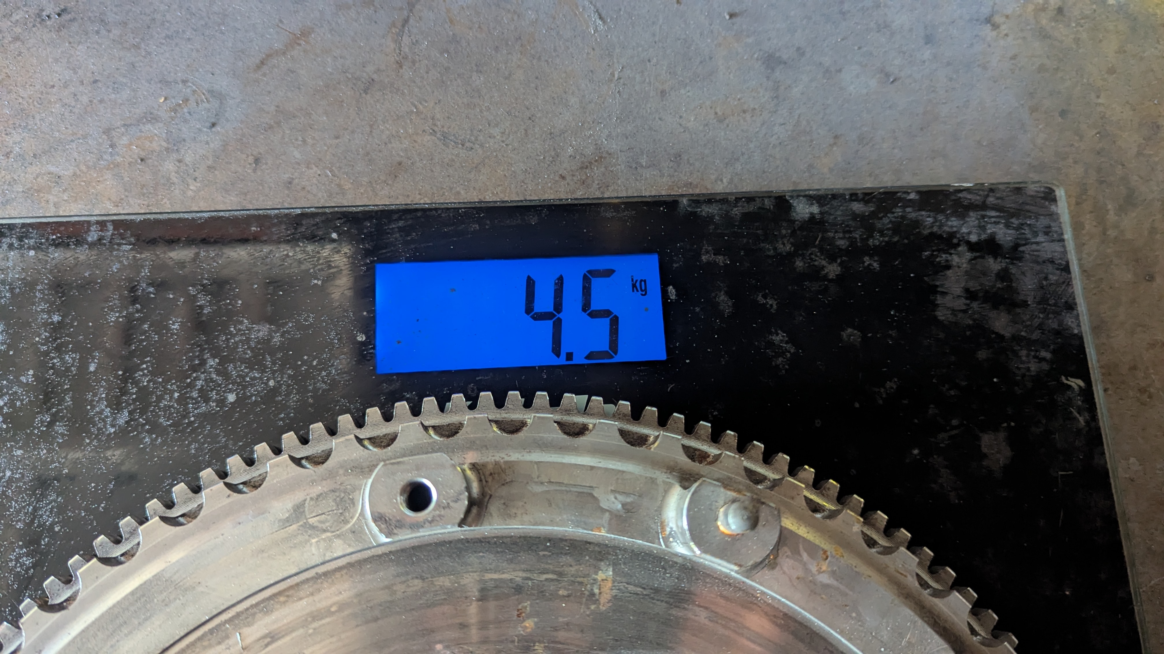

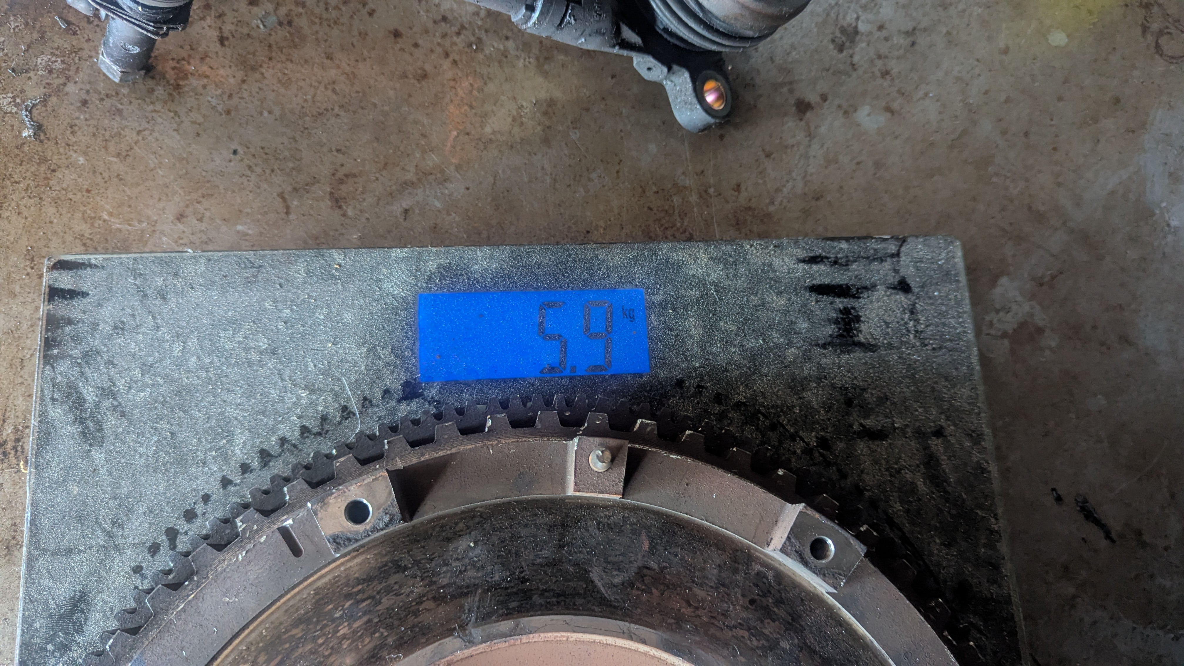

Lightened flywheel weight (-1,4 kg):
Original:

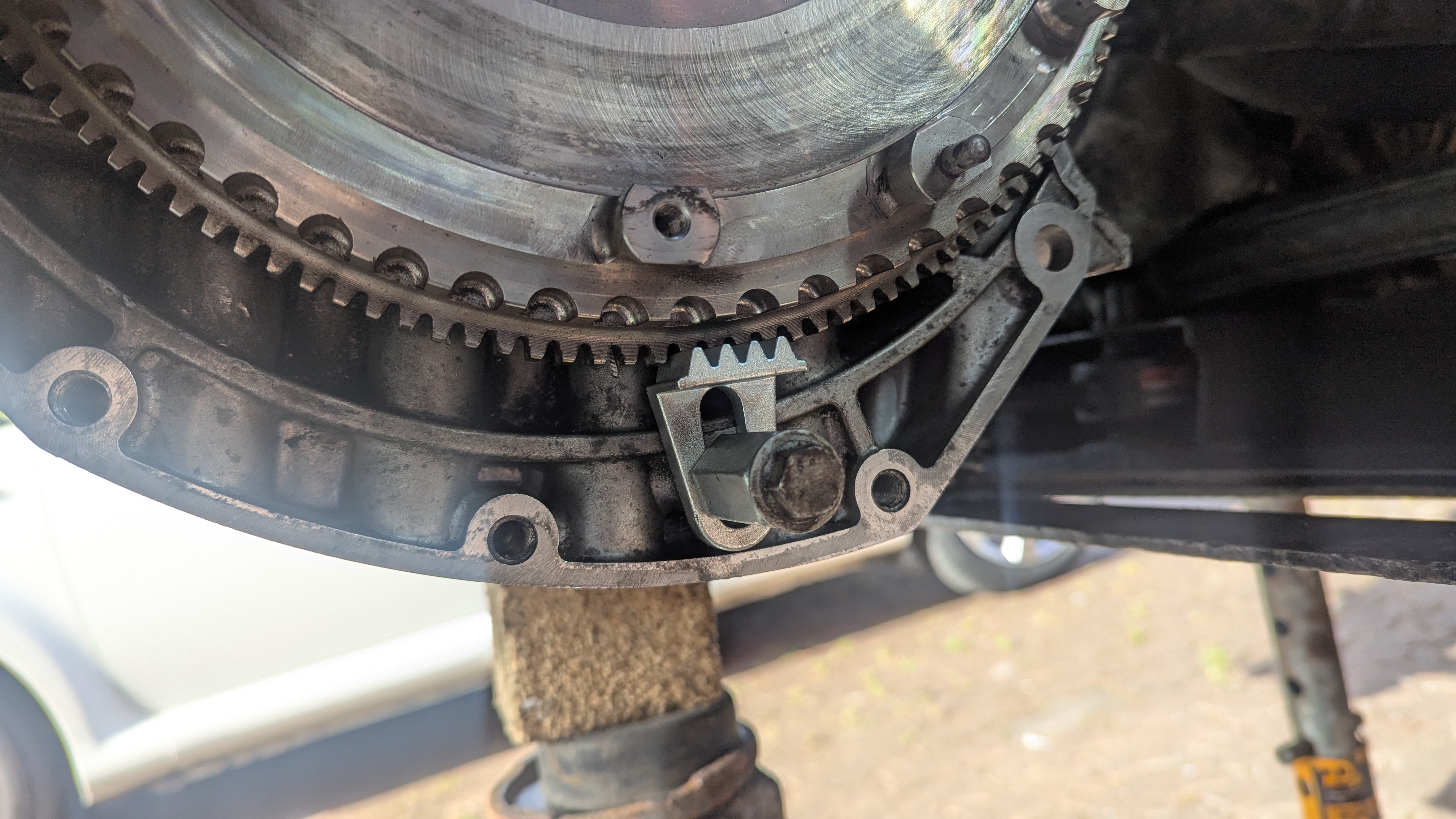

What a pain in the butt to stretch torque the flywheel bolts,luckly this holder helped a lot:

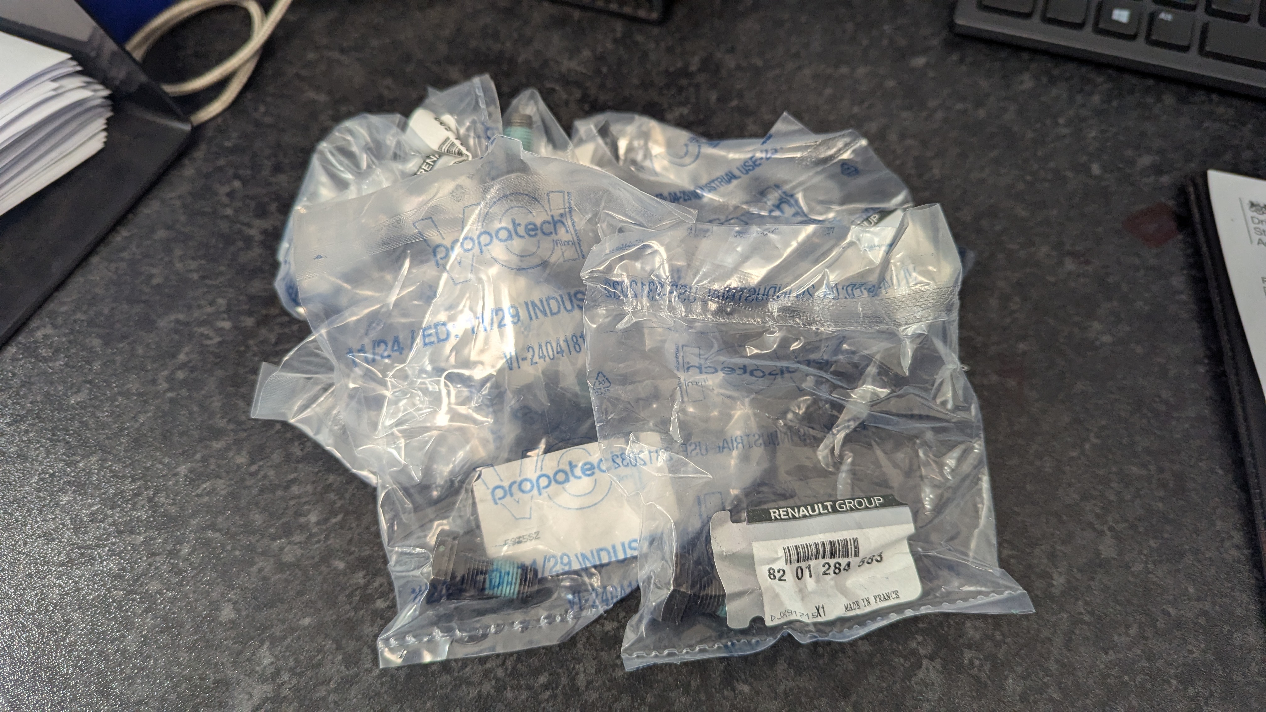

All new flywheel bolts were fitted:

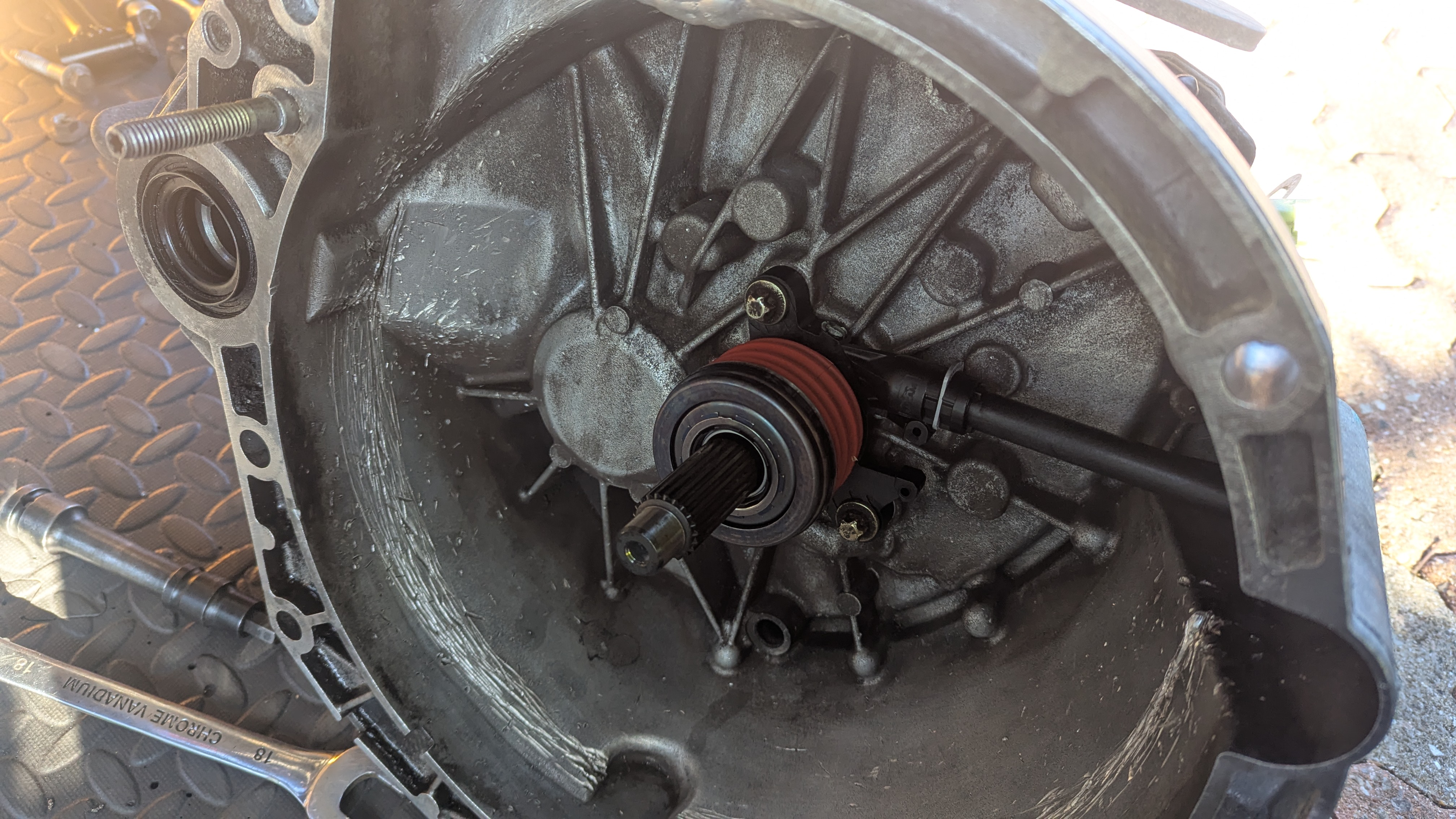

New genuine release bearing:

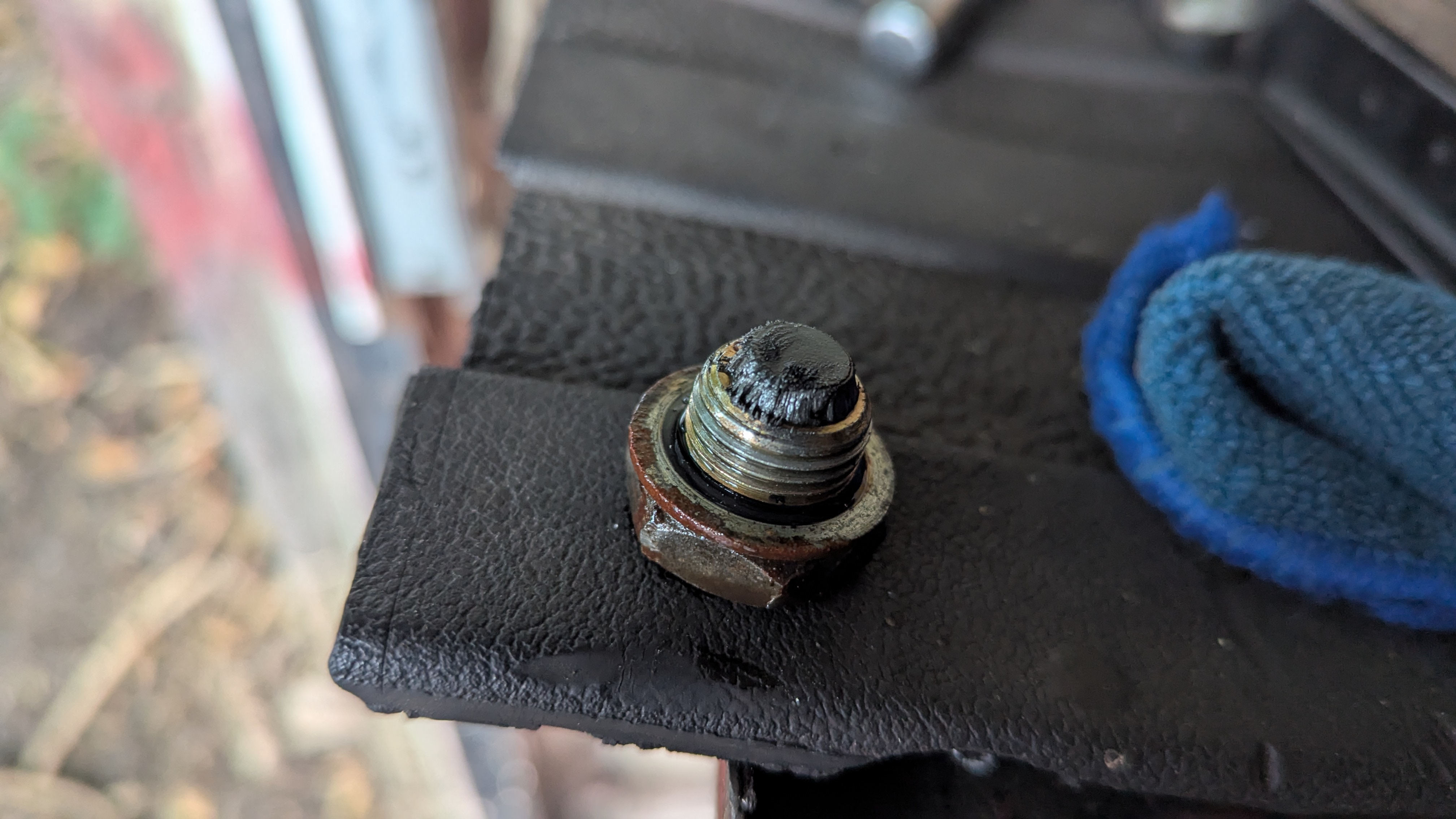

Renewed the almost two year old gearbox fluid where I also fitted the magnetic drain plug at the same time,a bit of swarf but I don't think it's anything to worry about:

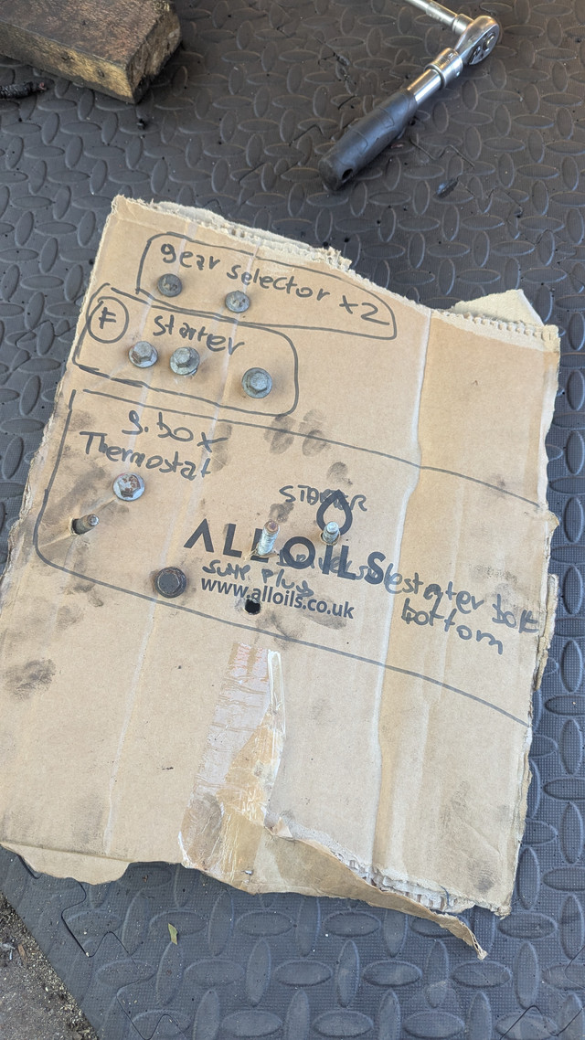

Piece of carboard helped to remember where all the bolts went since it was over several days:

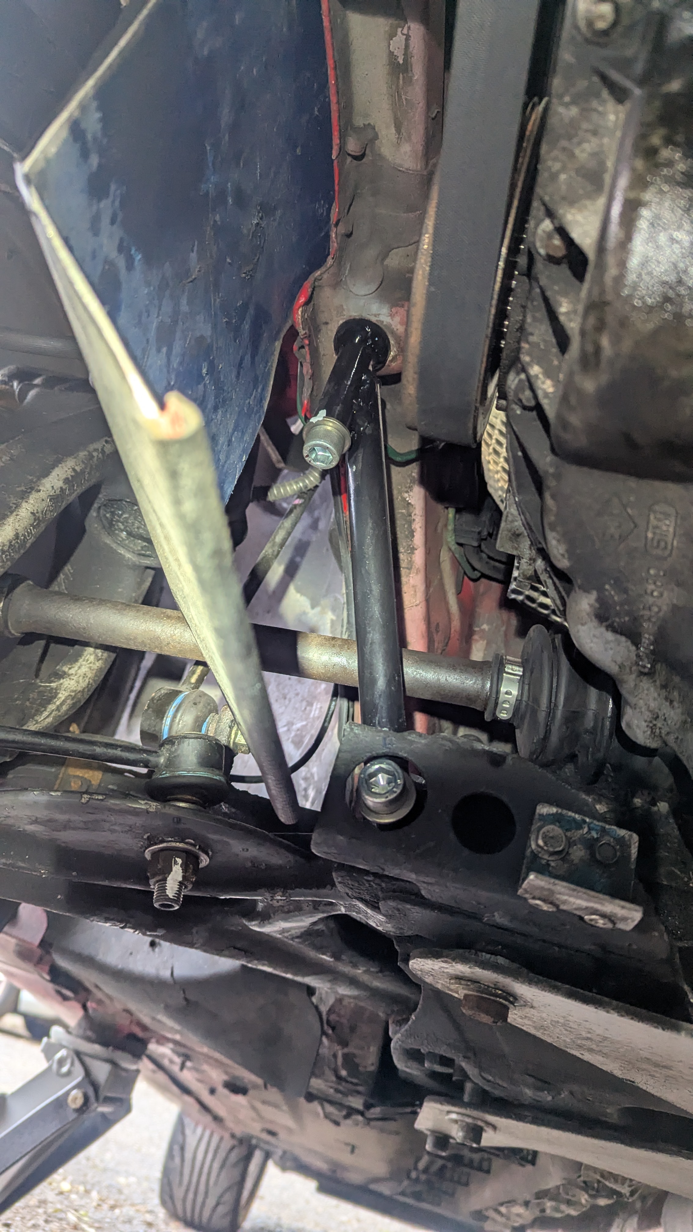

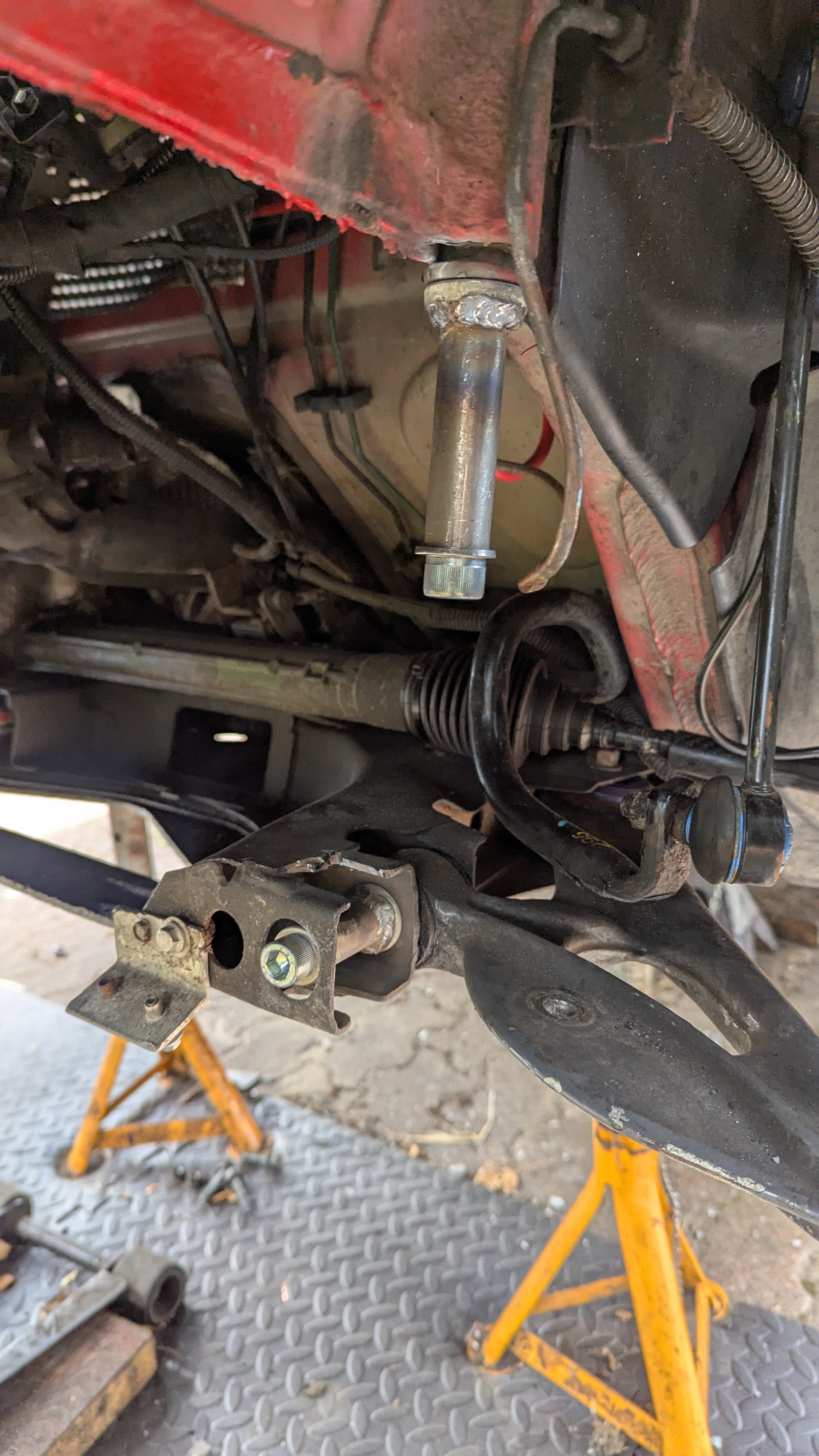

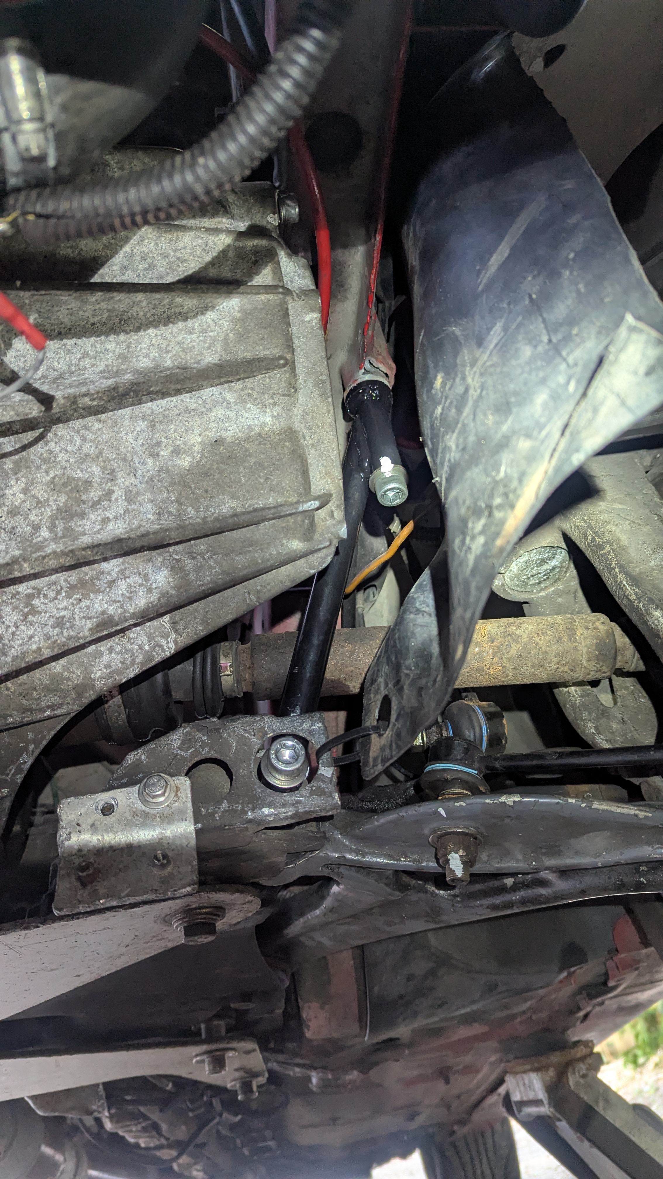

While everything was off I made my own solid subframe front mounts:

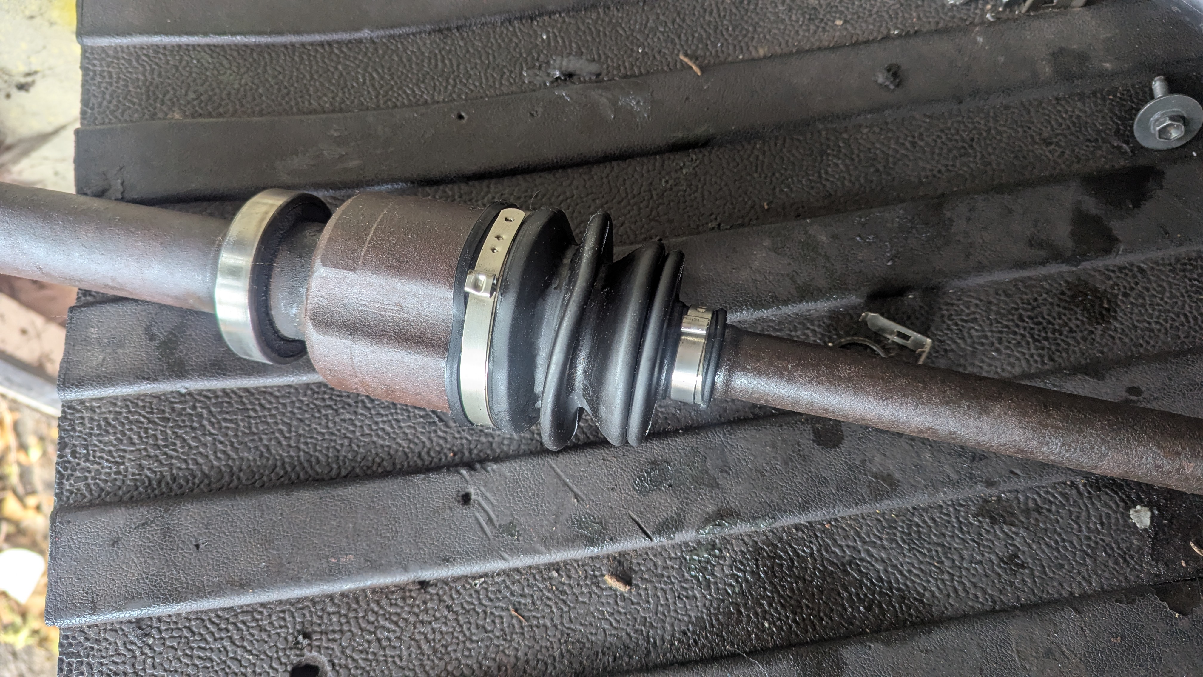

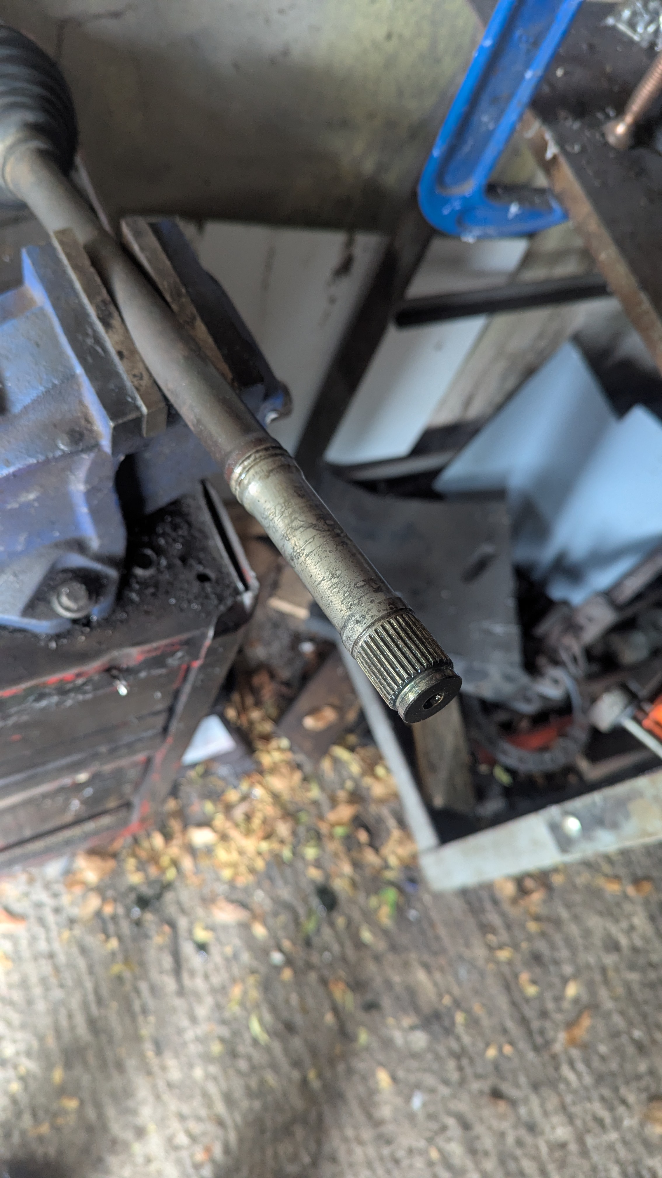

The driver side inner cv boot had a few pin holes and was leaking so fitted a new one while I was there,luckily all thats holding the joint is the boot and a small circlip so it can be split making the job a lot easier:

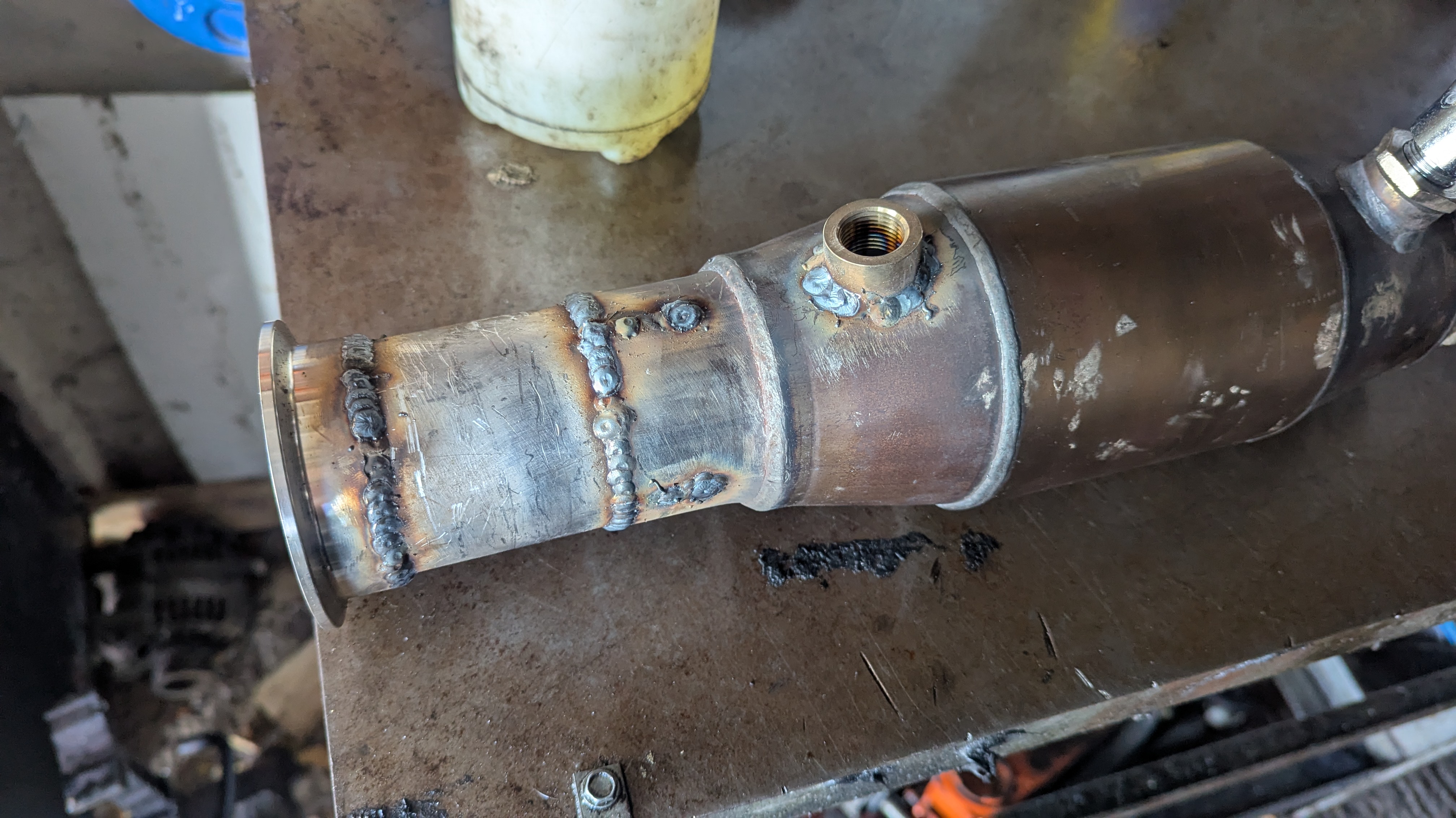

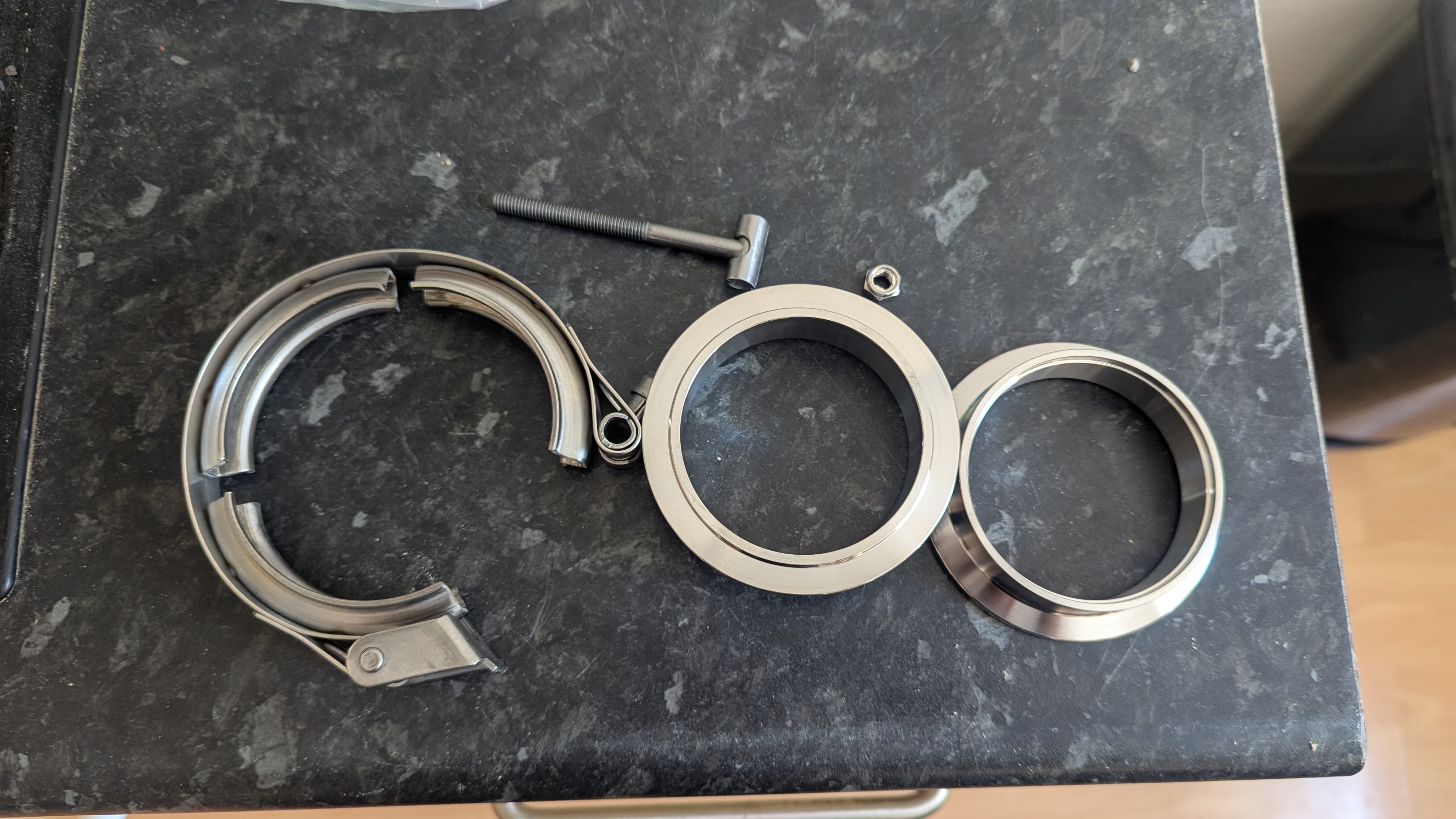

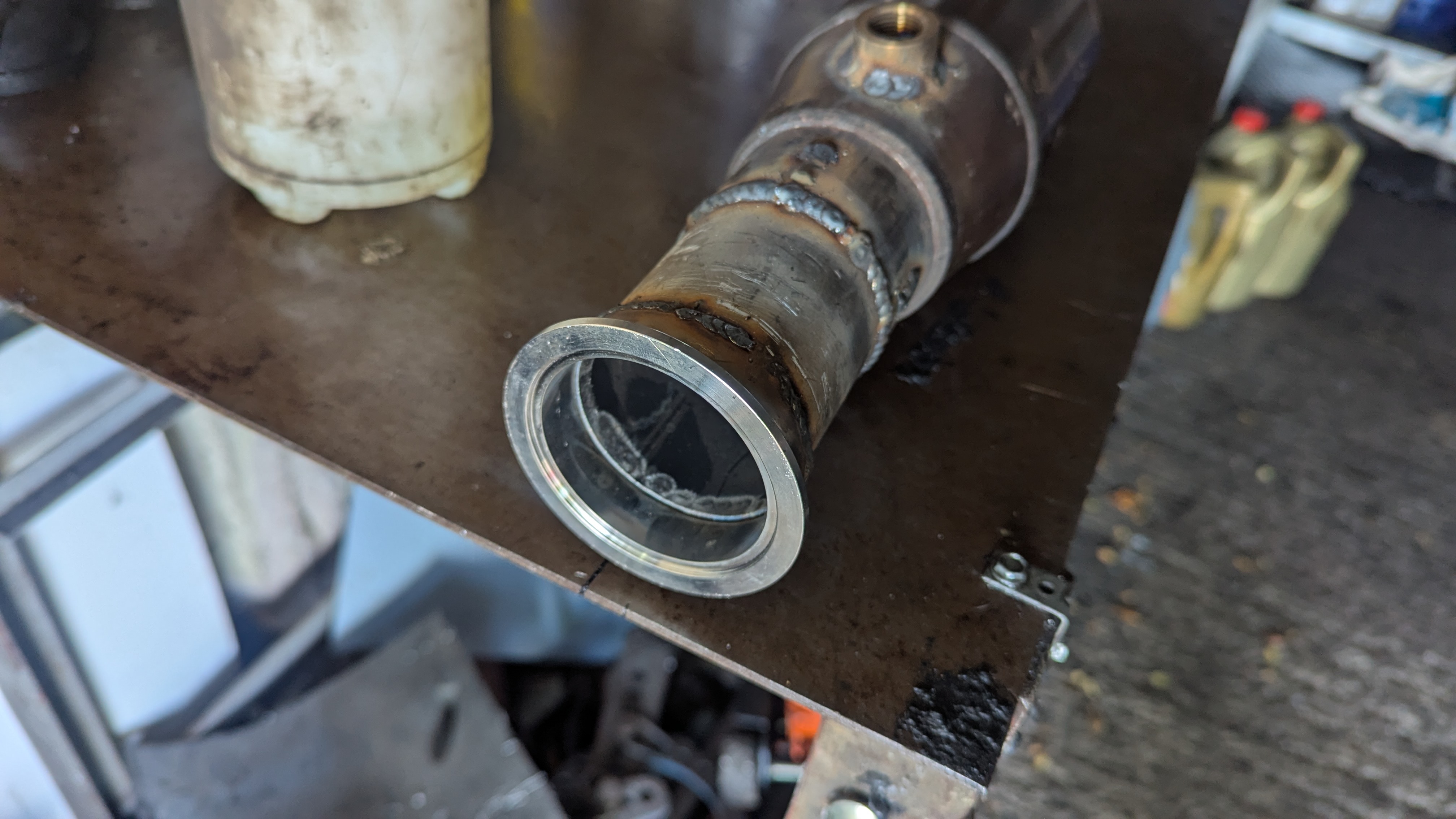

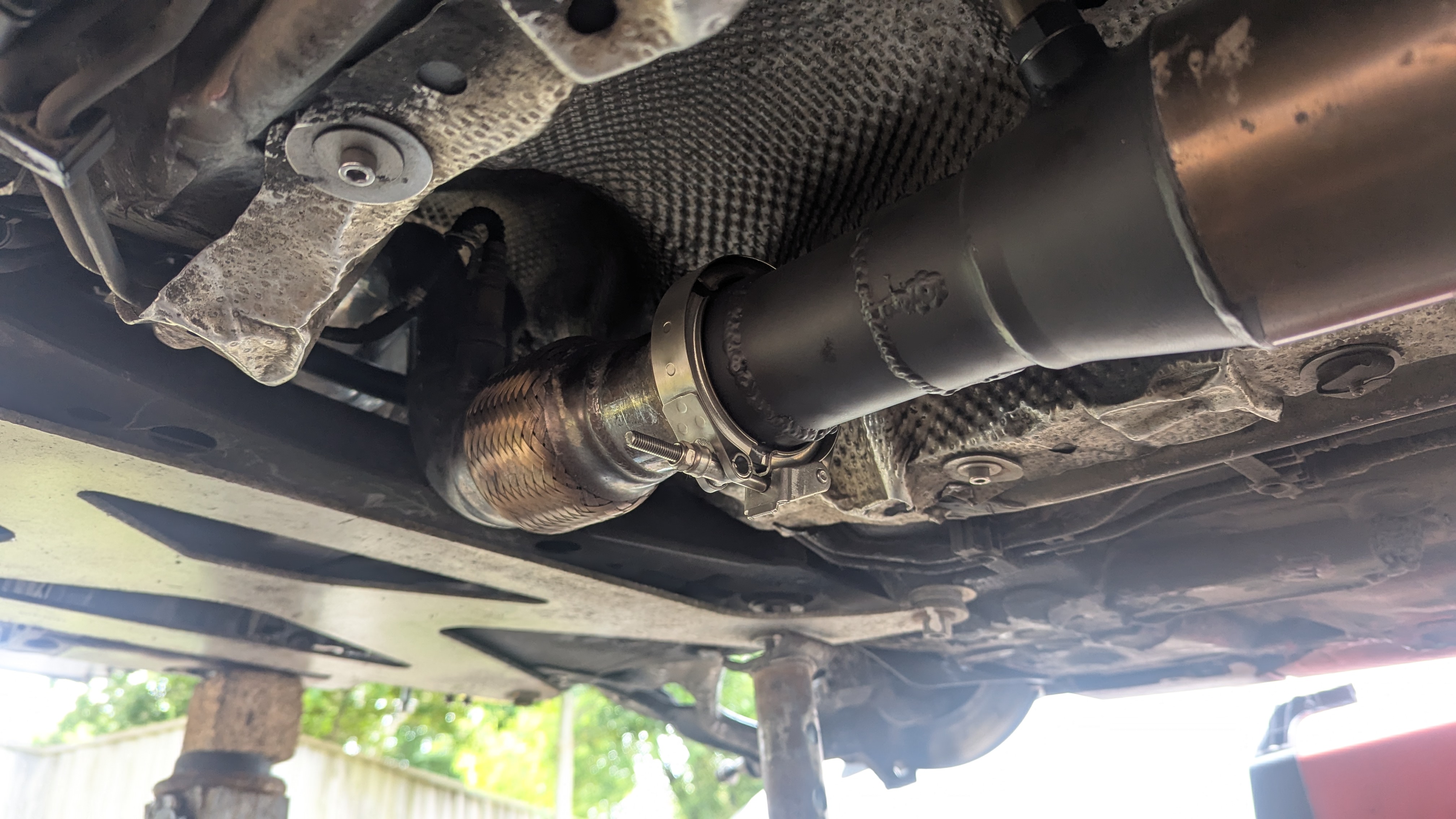

Also welded a boss for the wideband sensor on the sports cat (before the "filter") and welded a quick release clamp,a lot easier to take off and no paste needed as it all clamps it together nicely.

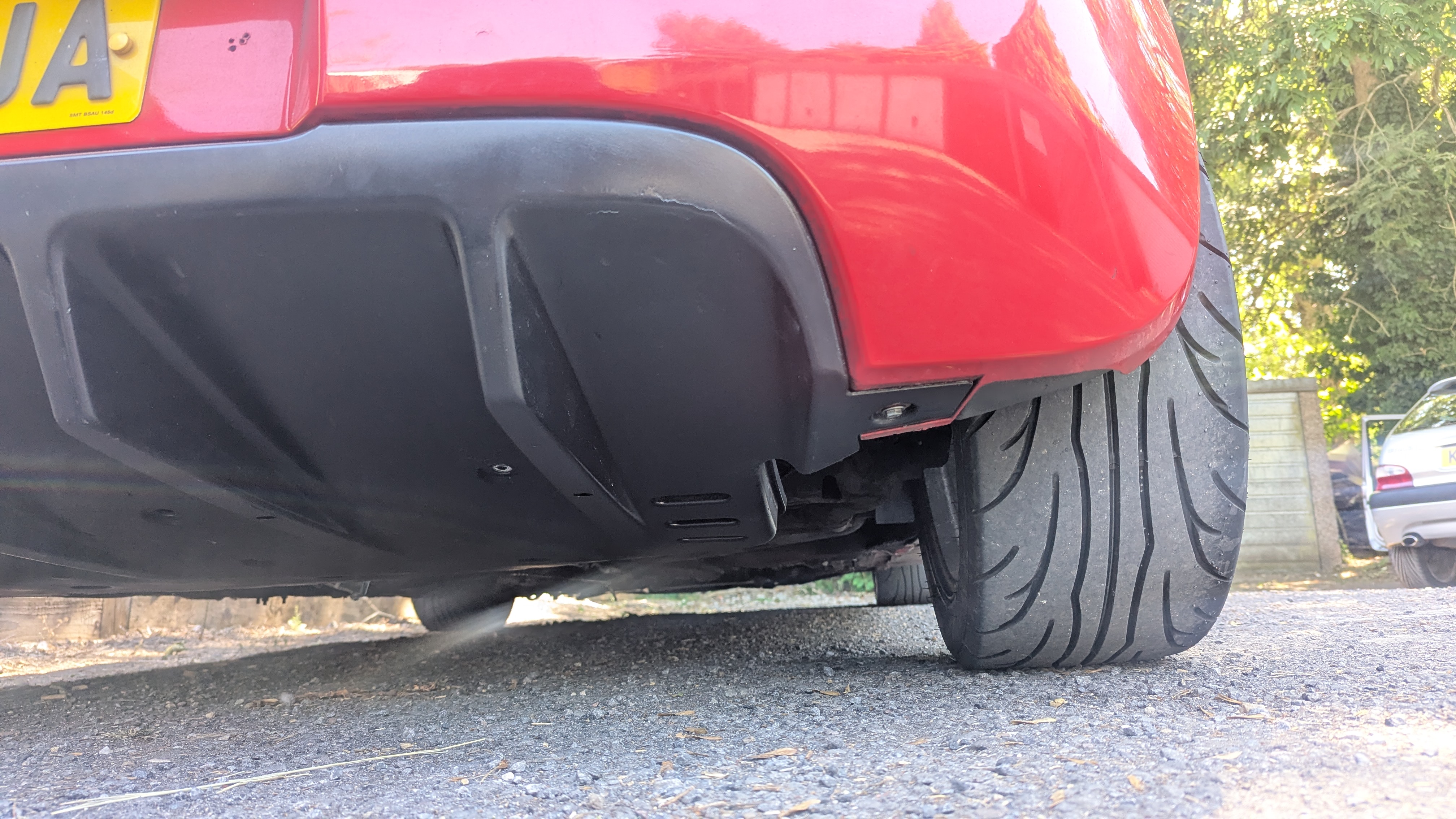

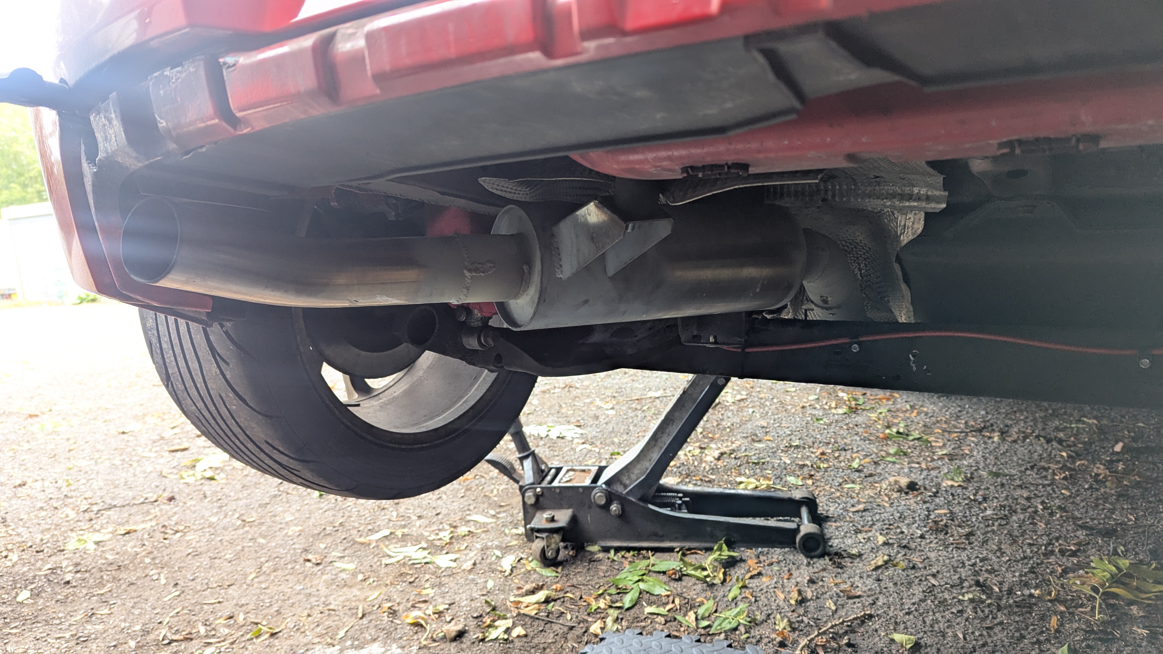

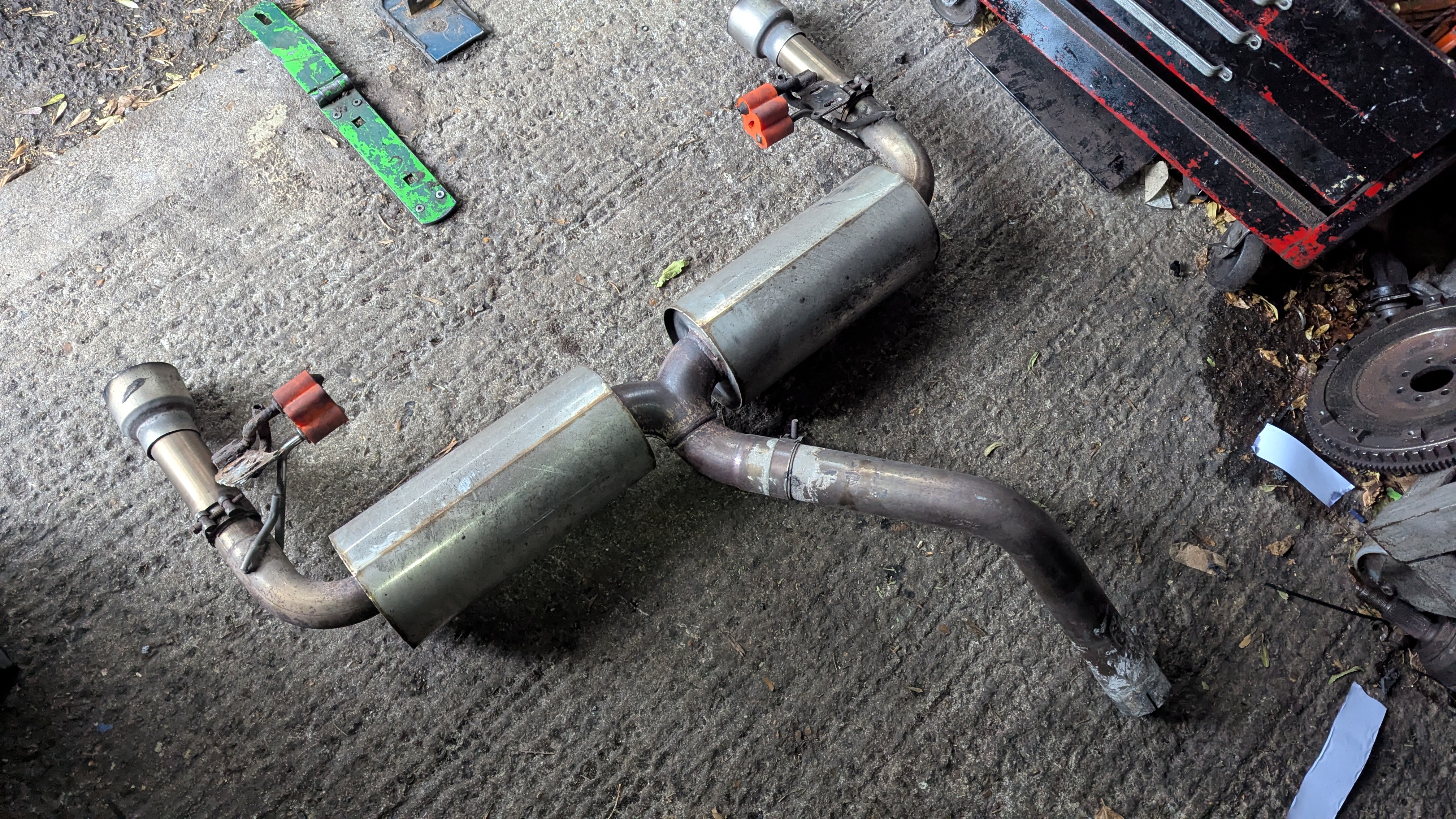

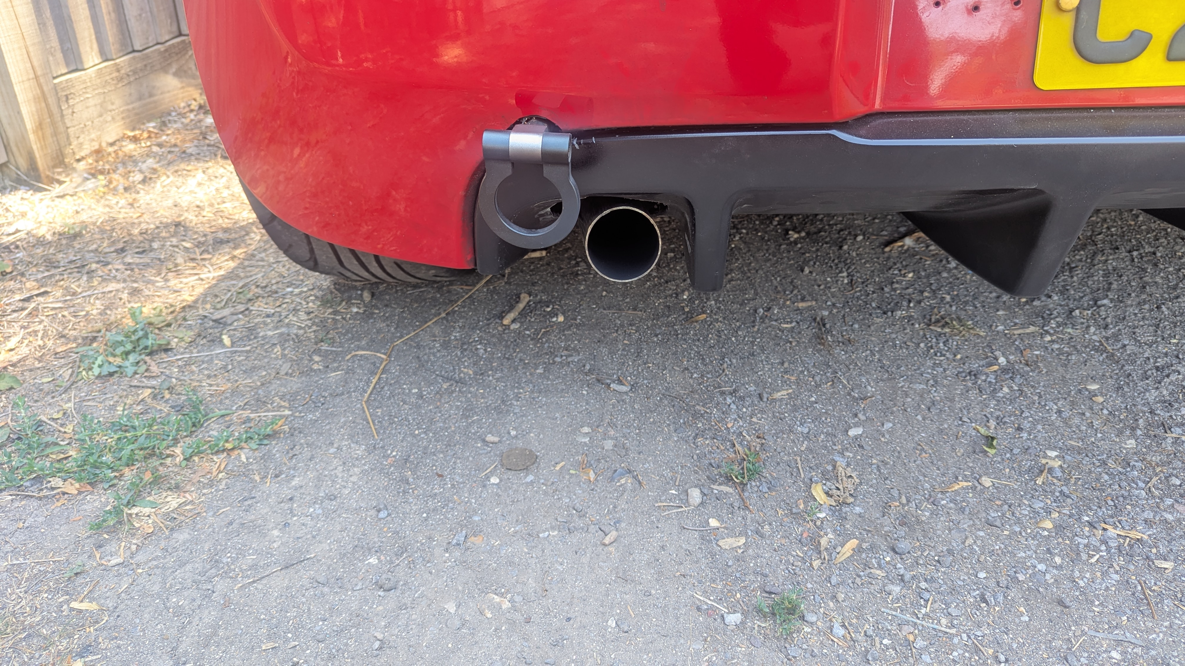

Few things to update,removed the Scorpion rear silencer and went single exit,lighter and bit louder and much better deeper sound rather than being raspy:
I made a quick video on how it sounds:
Used fiberglass to cover the other exit.
Old exhaust.
Removed all old exhaust mounts and bolts;
Single silencer is 6,40 kg lighter overall.

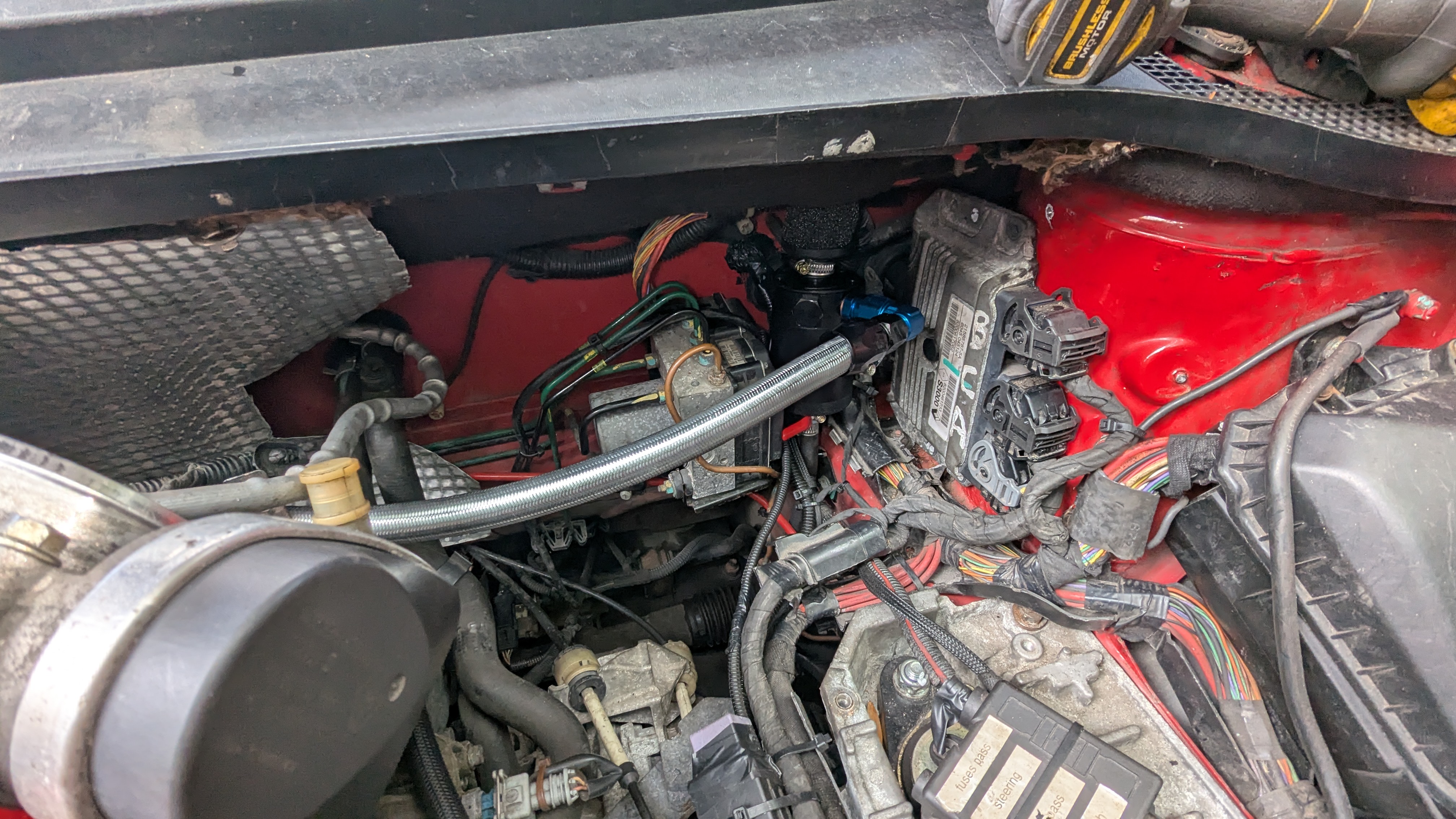

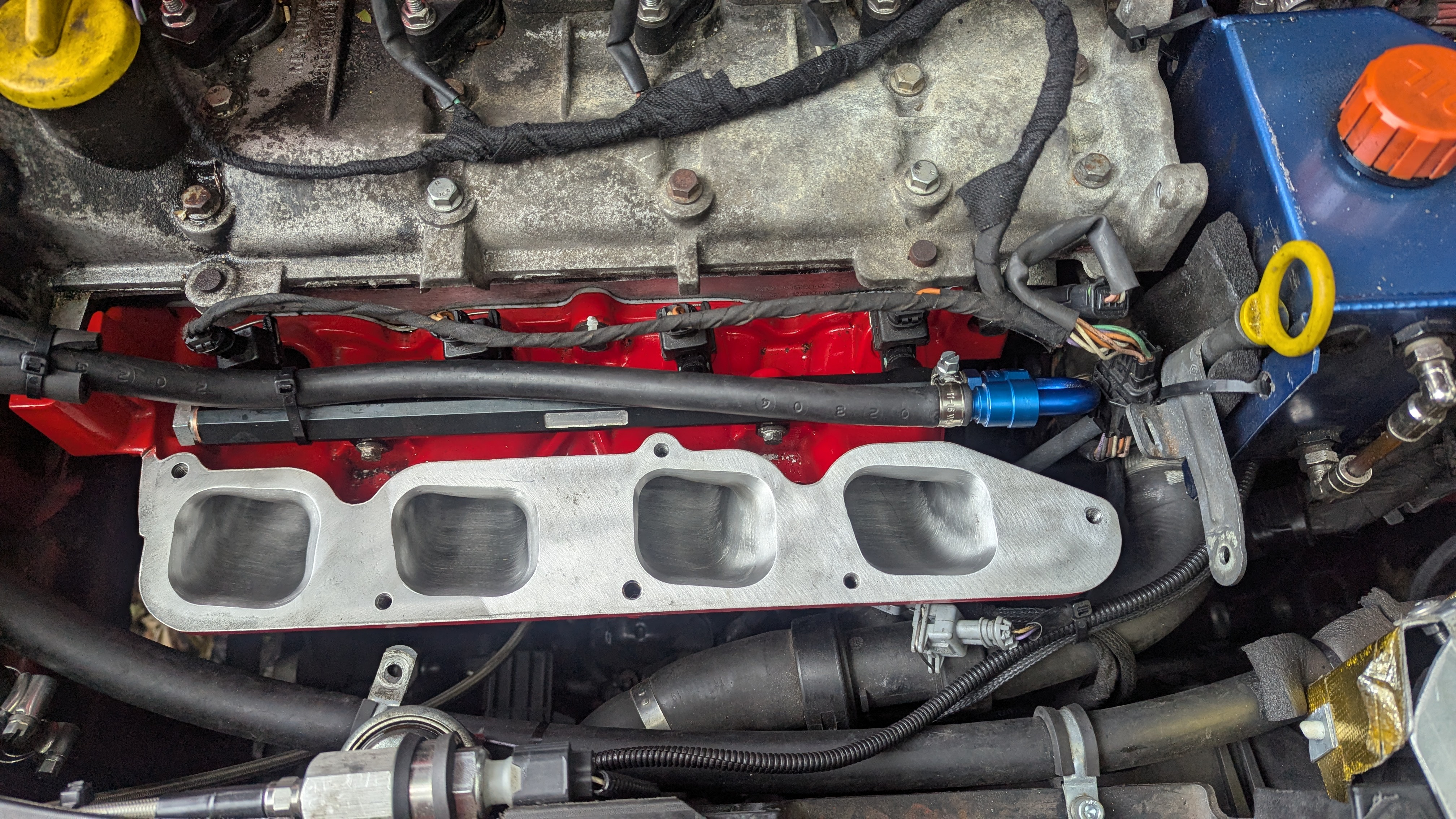

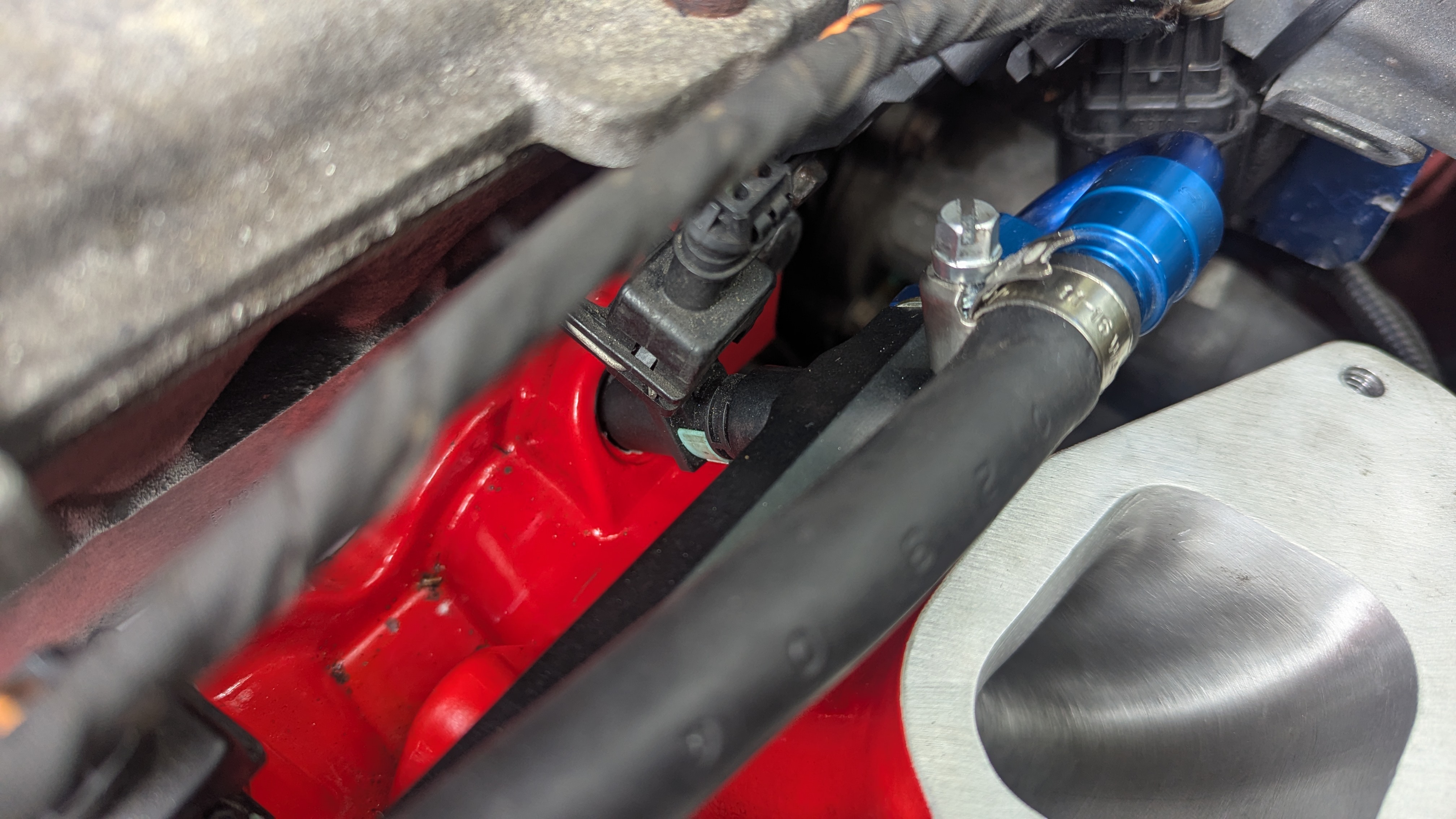

Got a Jenvey billet injector rail fitted (not finished),this one doesn't have the clips on the injectors to secure it to the rail like the oem plastic does,I can't see this being a problem,with the 2 fixing bolts that secure the rail to the intake I can't see the injectors going anywhere.

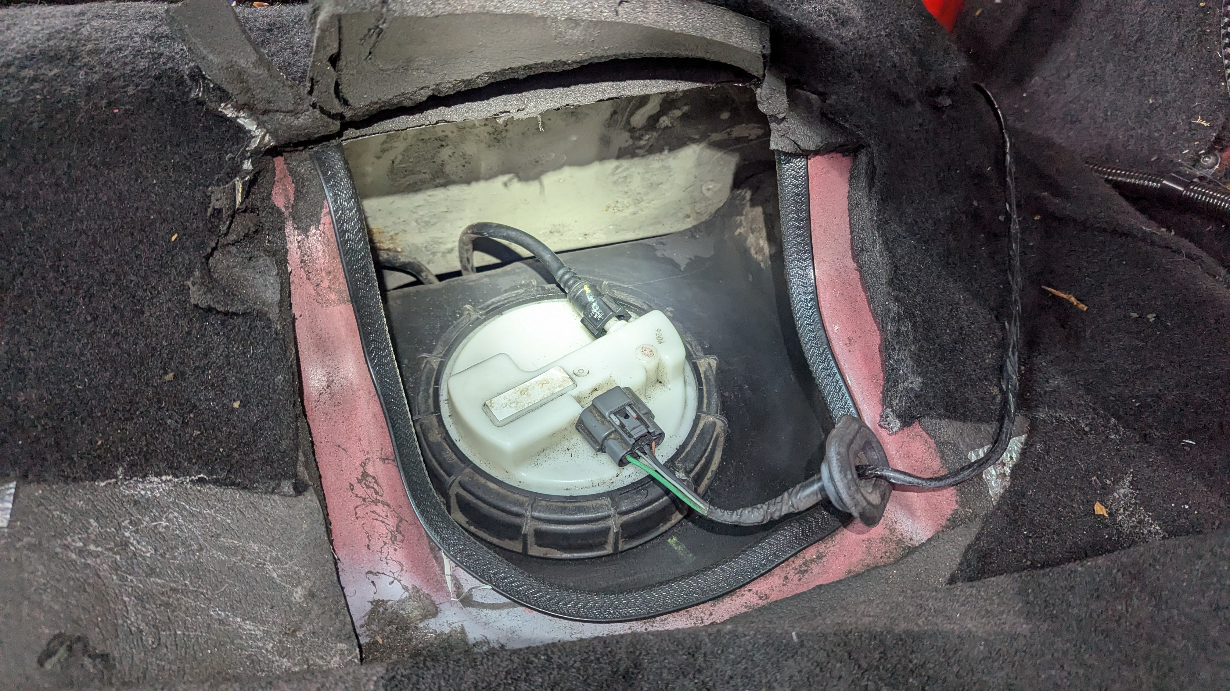

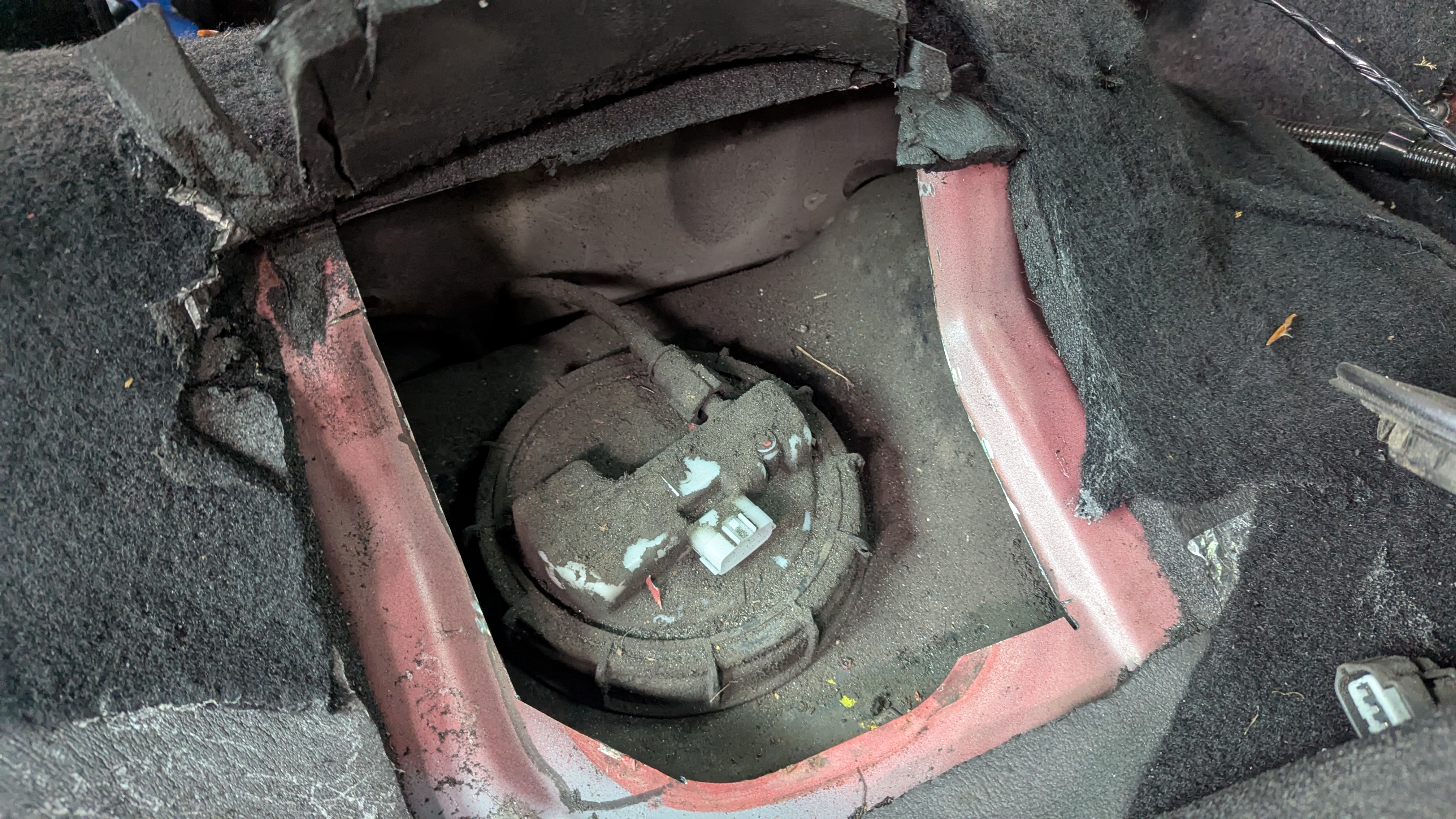

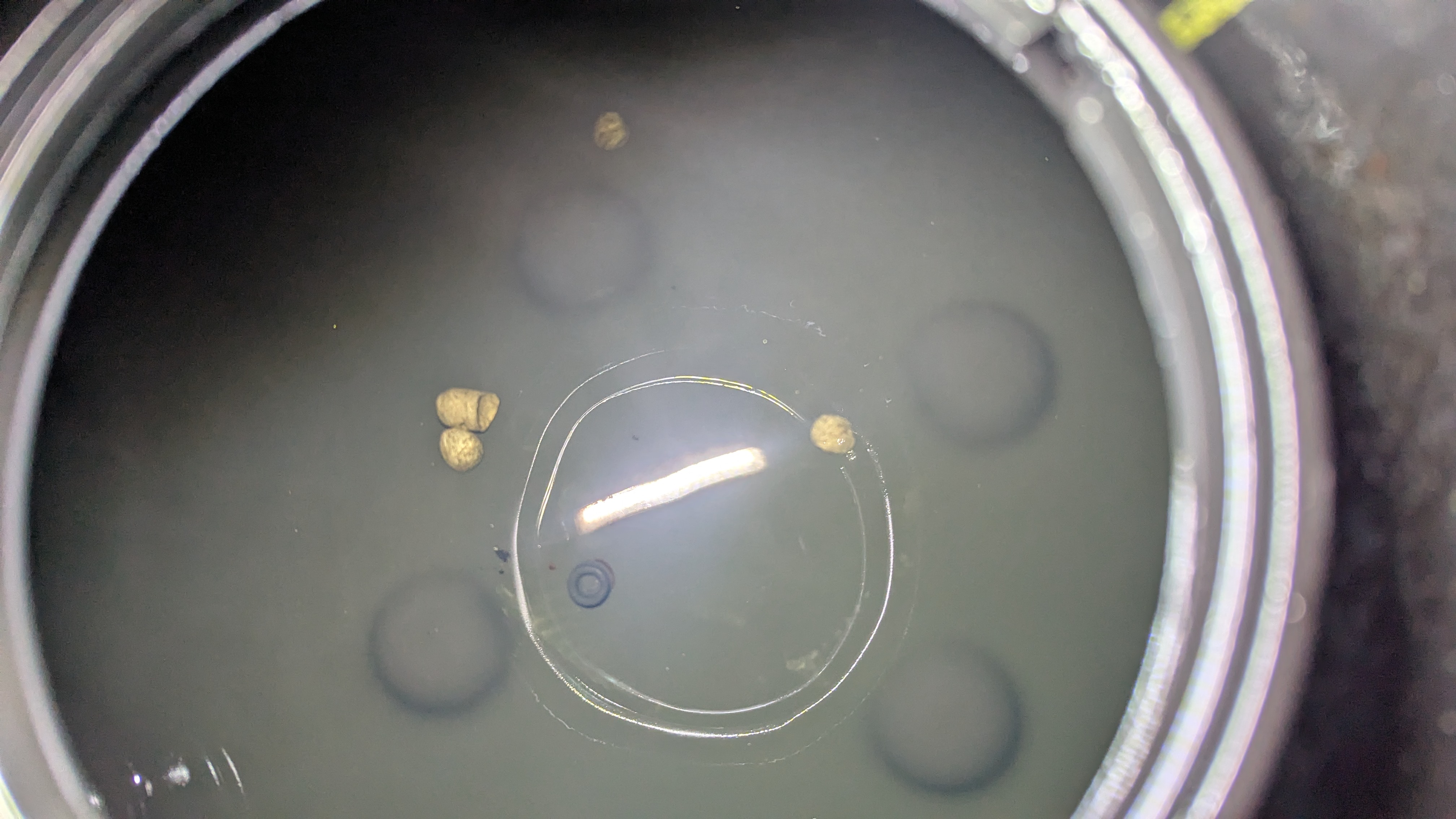

Got a used fuel pump to try and fix an ongoing issue and found a nice surprise inside the tank,sadly no improvement.
Glad I cleared the old fuel from the "new pump" before starting the engine.

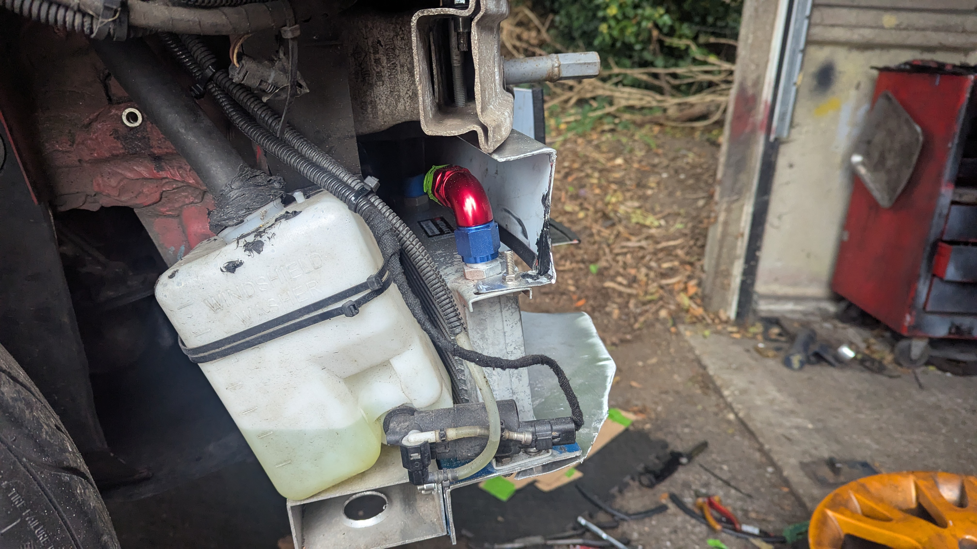

Moved the catch tank to the back near the bulkhead,so much room for activities now.

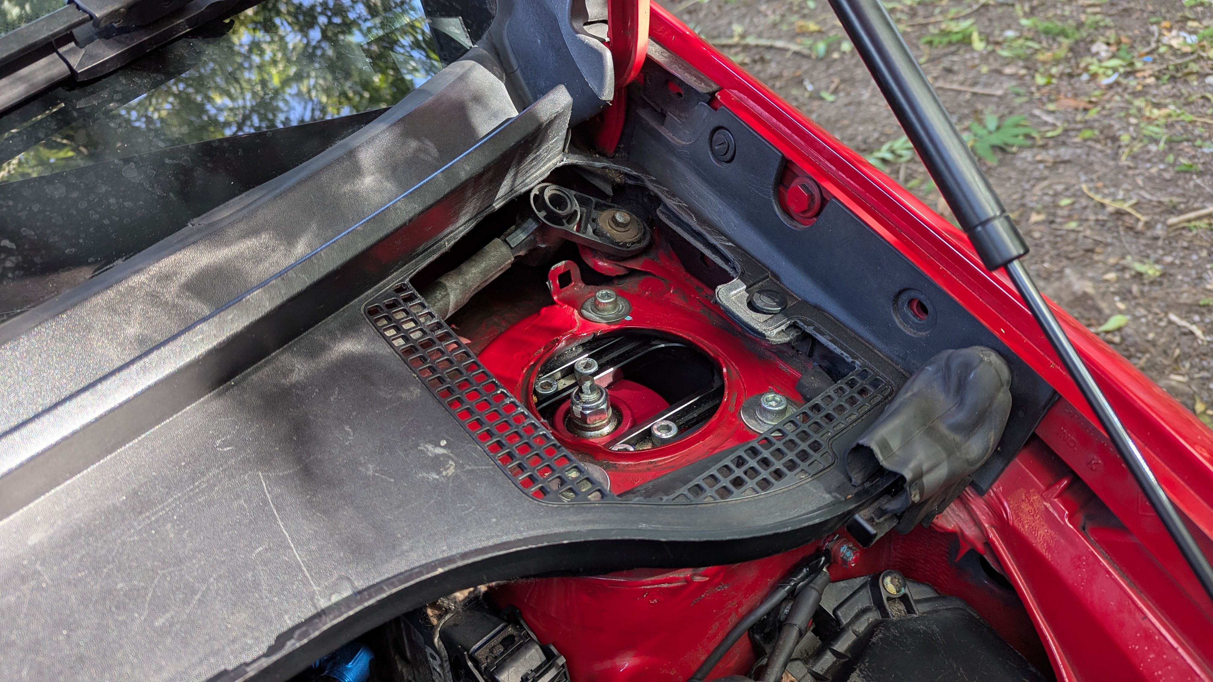

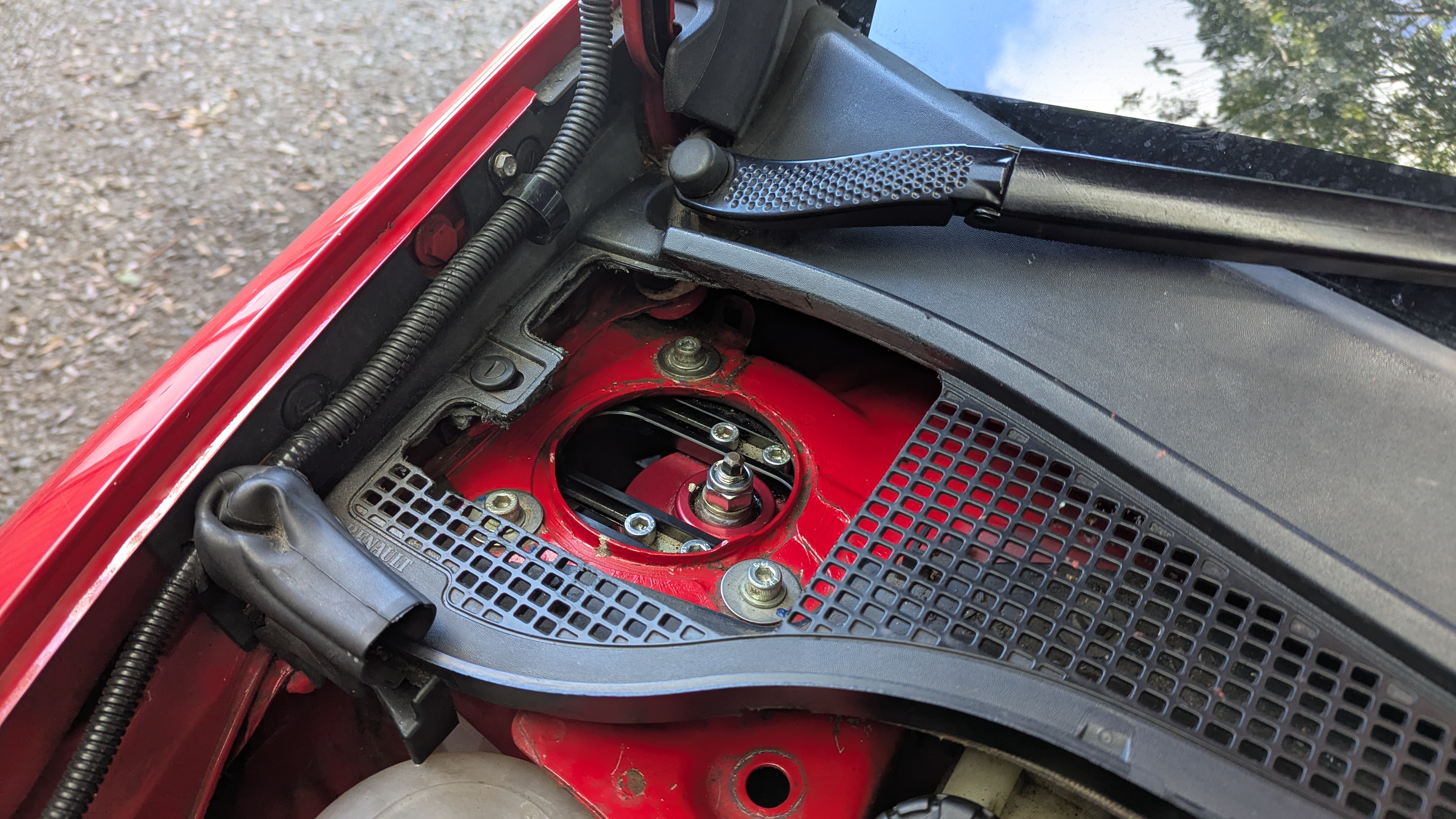

Made the cuts outs for the coilovers on the scuttle a bit tidier.

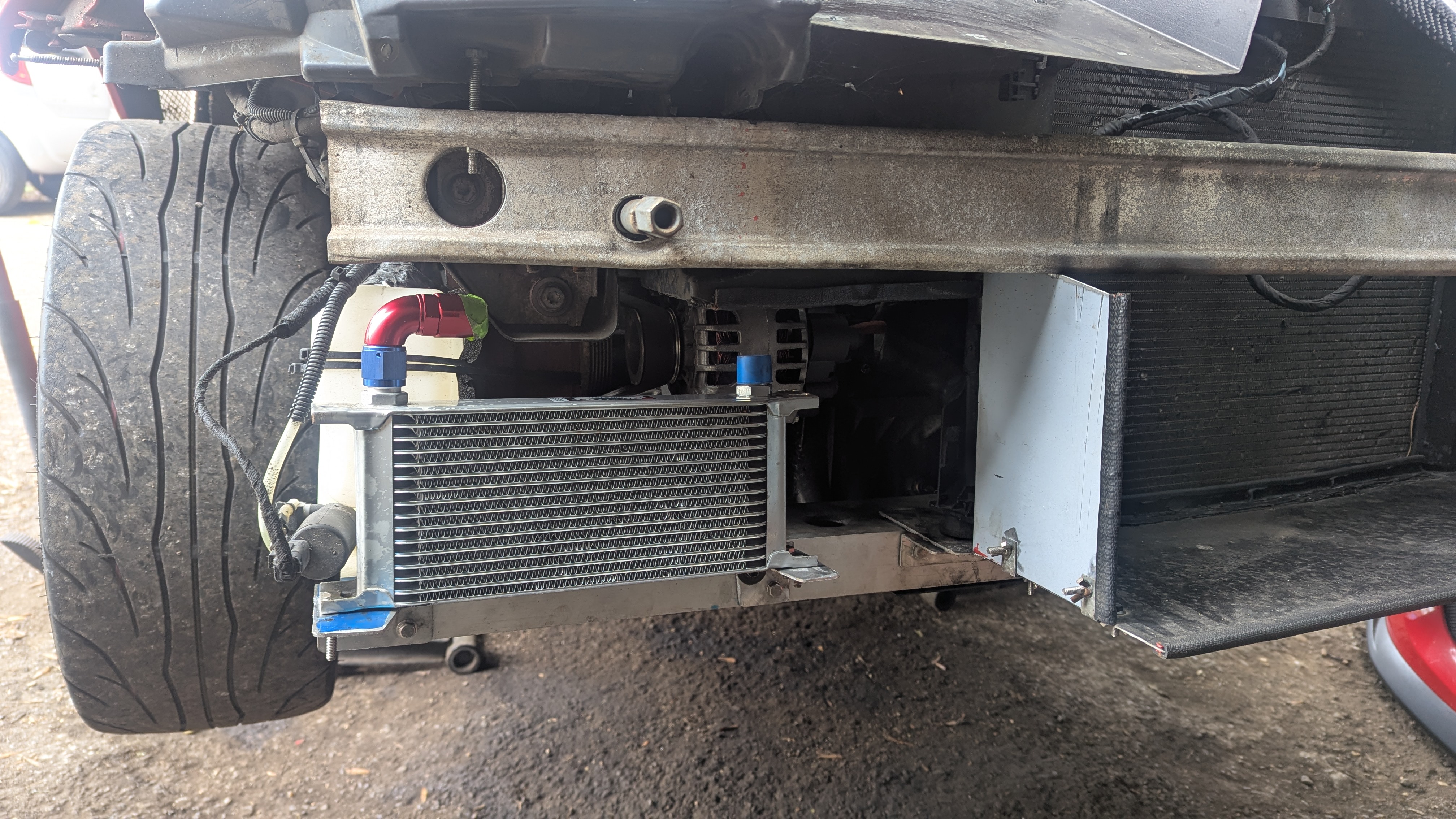

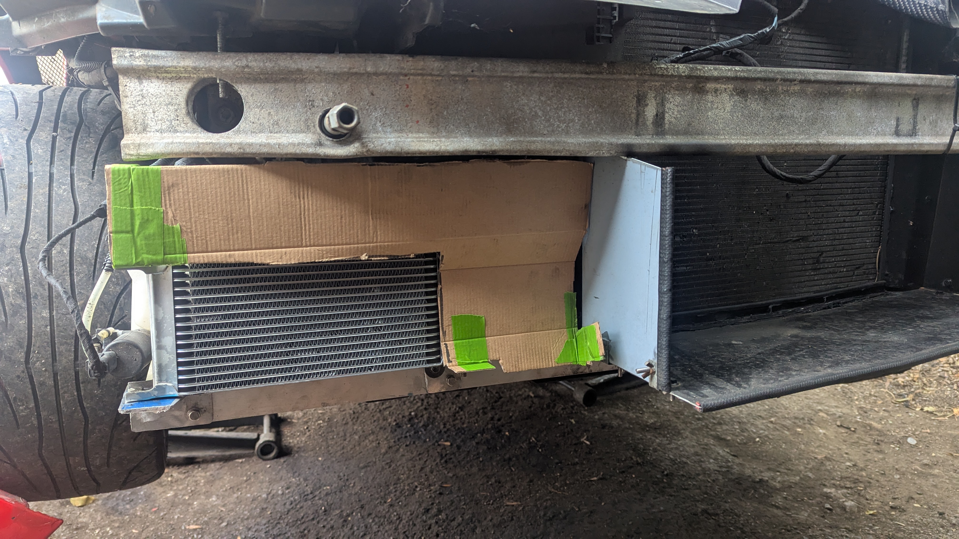

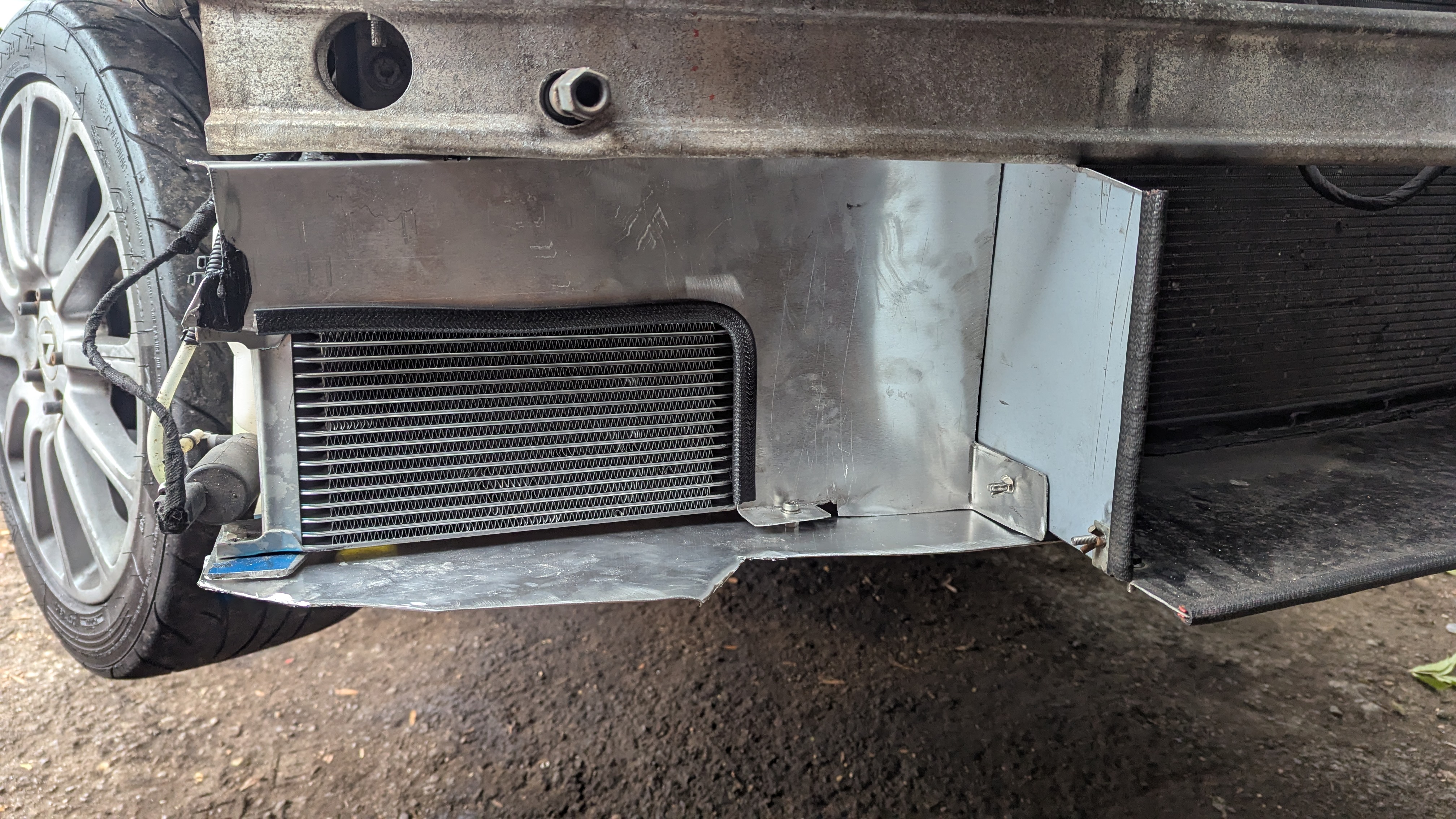

Starting oil cooler install.
