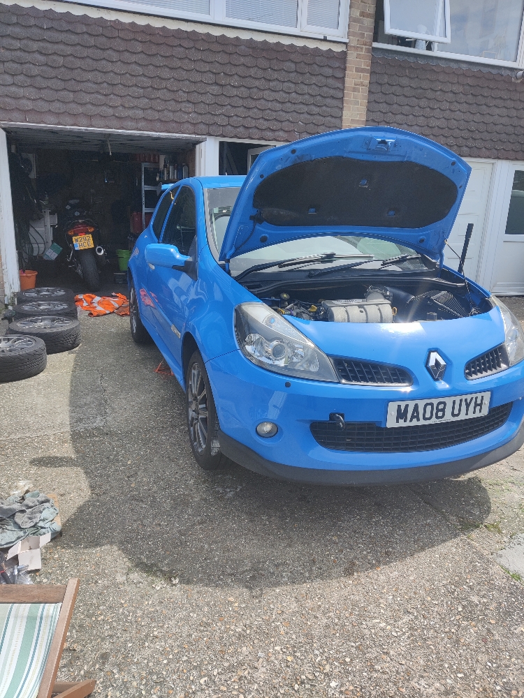

Yesterday I turned a spanner for the first time in ages on the car haha. Quick oil and filter change & swapped my stock wheels with the Goodyear's on to the car. Reason being is I have a new job & the Clio will be returning to daily duties for a little while & I figured I may aswell put some normal road tyres on and I wouldn't want to risk curbing the protracks as I'd cry [emoji23]looks a bit hovercraft like now, but oh well. Keen to see what these Goodyear's are like as I've had them since December and not tested

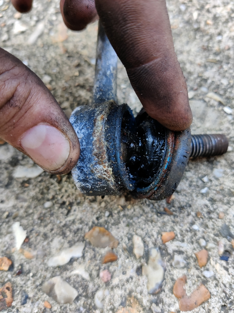

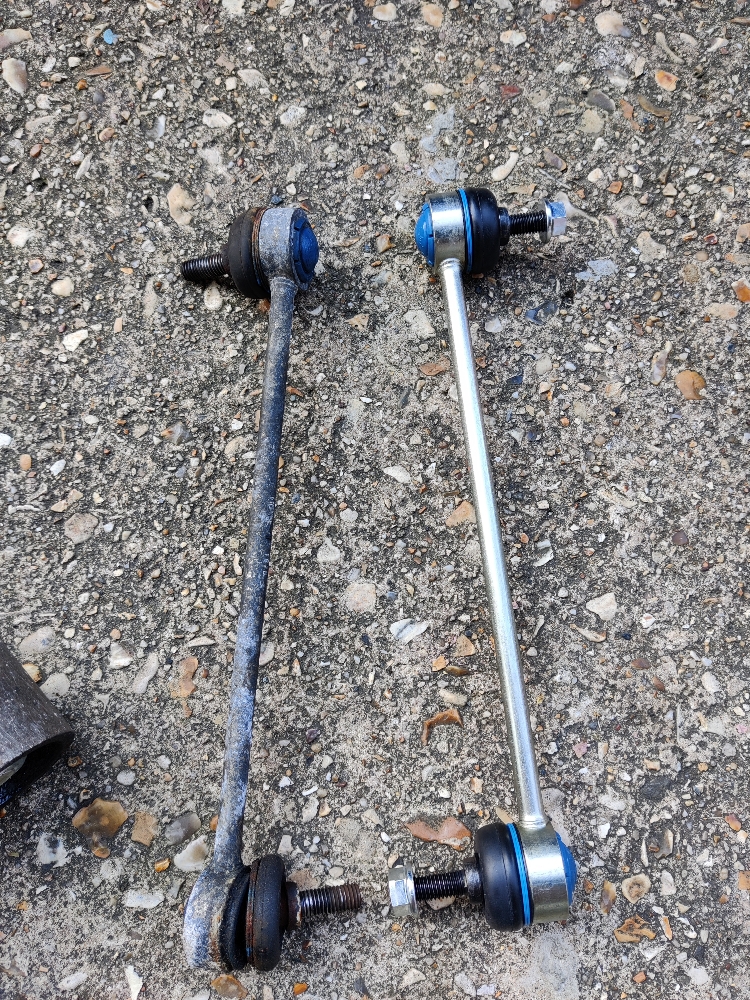

Did a little more maintenance on the car yesterday, changed out my drop links as it's MOT time next weekend. The boot on my RH side one has been pretty chewed up for a while but I've just not been able to do it. No knocking or anything and the ball joints were still actually solid but I thought I'd do it anyway as I'm sure a boot is a fail?
I was surprised at how corroded they looked, same with my bilsteins considering they all looked so clean for ages. I couldn't really work out how they looked so sorry so quickly.
One thing however, changing the drop links with the pure Motorsport top mounts is a pain! I'm guessing the caster just brings the shock closer to the arch liner and there is 0 room to squeeze the ball joint behind it. I ended up just slackening off the 3 bolts holding the top mount to the body as I was faffing around too much trying to get it in [emoji23]. So unnecessary but went straight in afterward. I was tempted to cut the length of the threads down but thought I best not

They’re a right pain. There’s a big lump on the arch liner exactly where you need the access to remove.
I chopped a rectangle out of my liner
Reactions: lewishunter98
Yeah exactly that. My old ones I was not fussed about so I just hammered them out and that did the trick. But getting back in obviously is a different matter. Is it just with the additional camber & caster you've noticed it? I swear they weren't that difficult previously
The bottom nut is a pain to get off too, as again, right where you want to be there's either wishbones/ or track rod arms/subframe/arch... I just chucked a spanner on the bottom one and again, hit it with a hammer [emoji23] Impact makes light work of the top nut though
Put a jack under the lower arm and jack it up, that should give you some more room, also try turning the wheels
