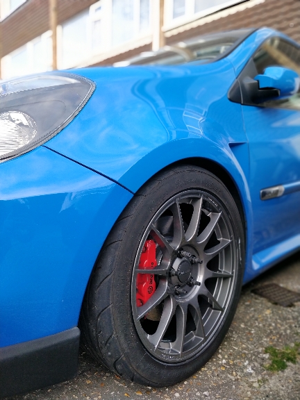

With the lighter wheels & the lighter crank pulley the car feels so much more urgent especially in the lower revs? There's a fair weight saving with all I've done anyway recently so especially rotational mass it just feels much better
First time I've actually driven the car in about 2/3 weeks though. Still need to get my geo done and I'm not wanting to burn through the tyres
My service light popped up today which obviously isn't actually due considering I did an oil/coolant change etc in December & now just done one a month ago with the sump gasket and all the other bits. Struggling to reset it for some reason but I'll figure it out
But no update is complete without atleast one photo so have another photo of the wheels[emoji7]

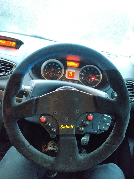

Not much of an update but with my MOT booked in for the 30th July I figured I'd sort out my horn panel & also Bedford booked for 28th August I wanted cruise control back
Bought myself a volantech panel..
Simple to wire in, but I had an issue of the horn not working. After a bit of research it turned out it was looking likely to be the two pins behind the wiper stalk being bent. All I did was pull them towards me a bit (carefully) and put it back together and it worked spot on :smile:
