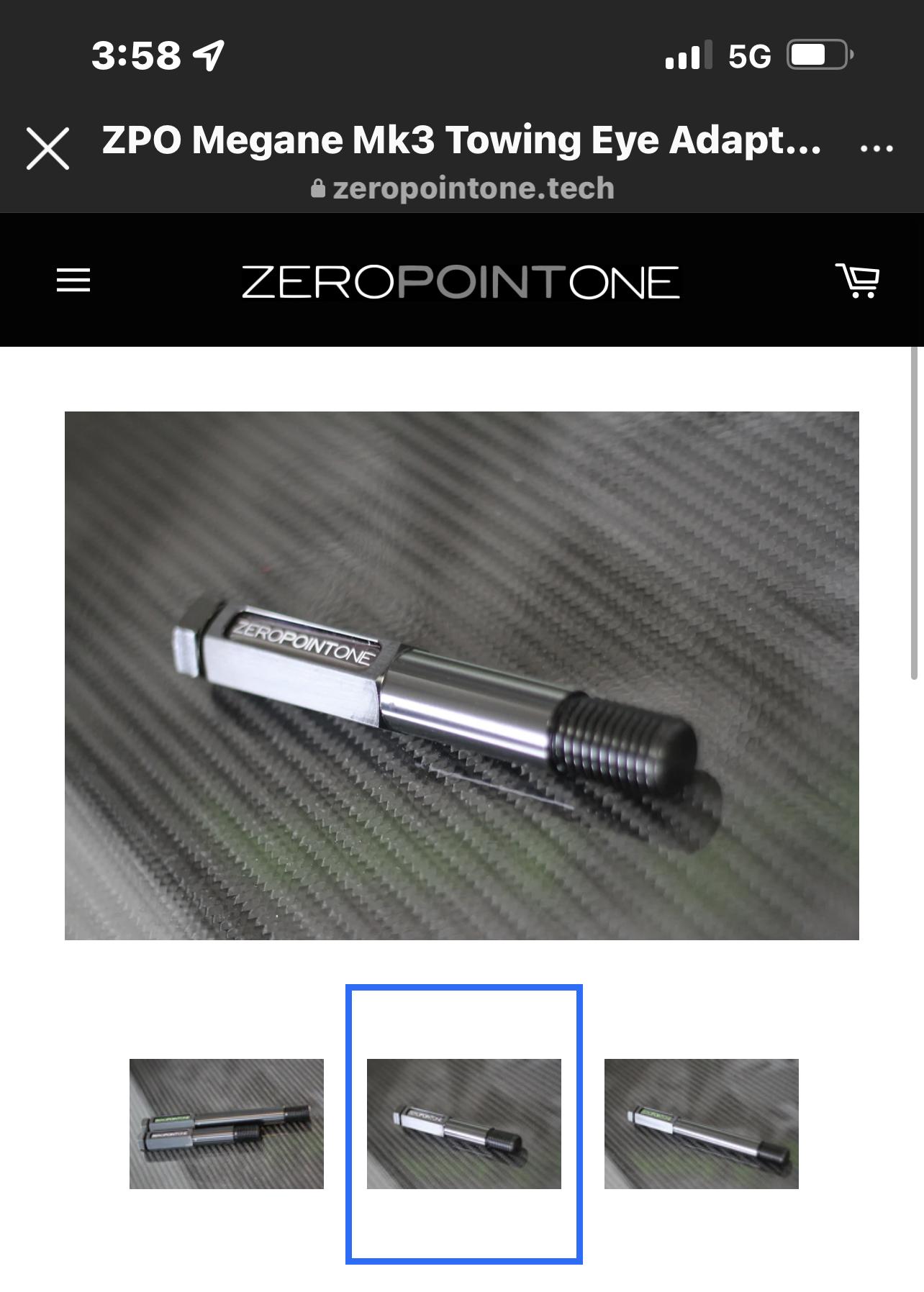

What mounting kit did you use for the tow strap as was to do mine like that with the cover on do it looks neat [emoji1362]

Yeah basically shortened the stud that was there then got the grinder to the cover.

This is the tow strap adapter I was going to buy did you use something like this or just a treaded bar ?
I have a ZPO tow strap adaptor with a TRS tow strap. We had to drill out the hole on the tow strap as it was not big enough.
With a trimmed cover the tow strap can either hang out or be tucked away.
