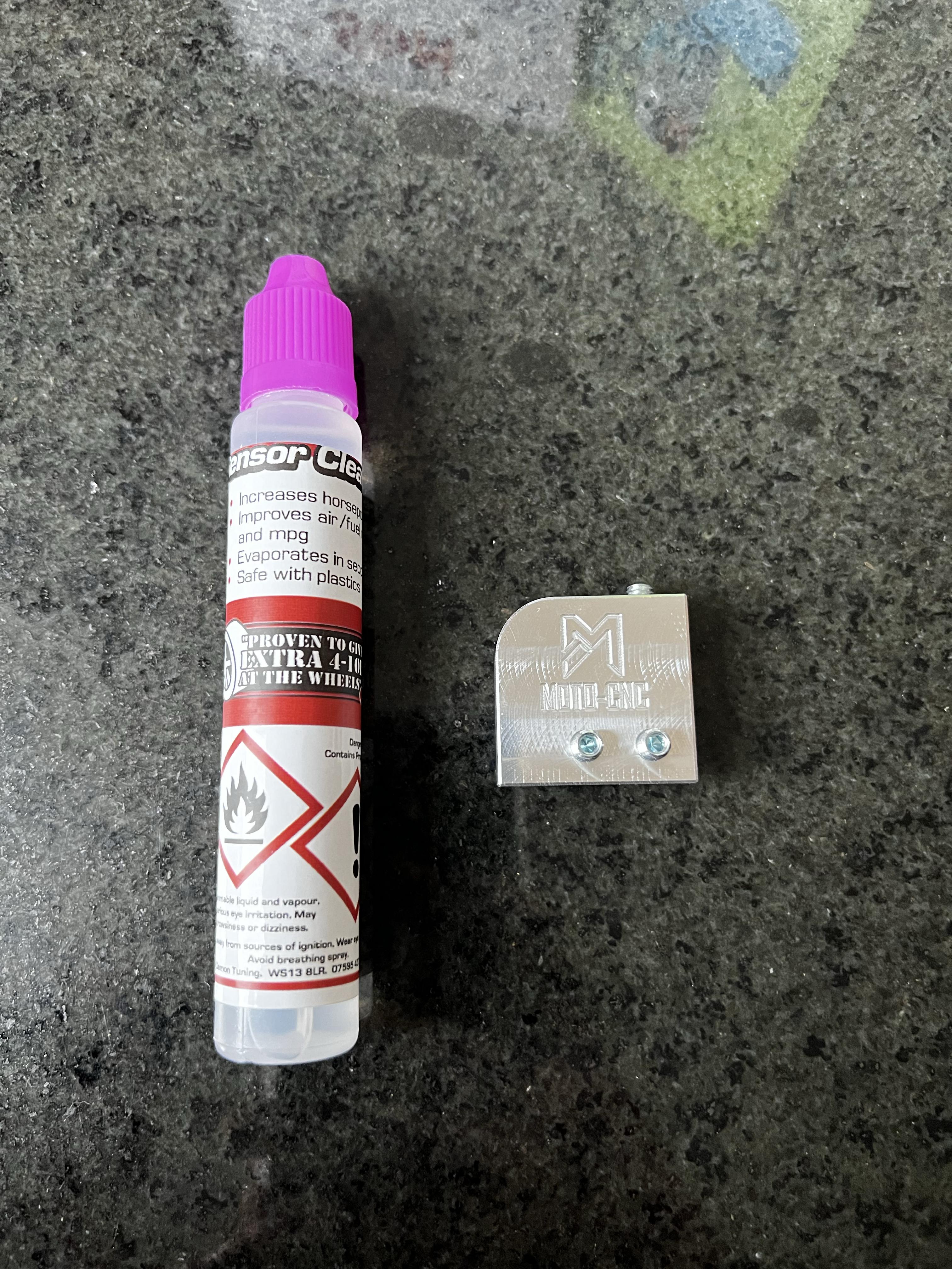

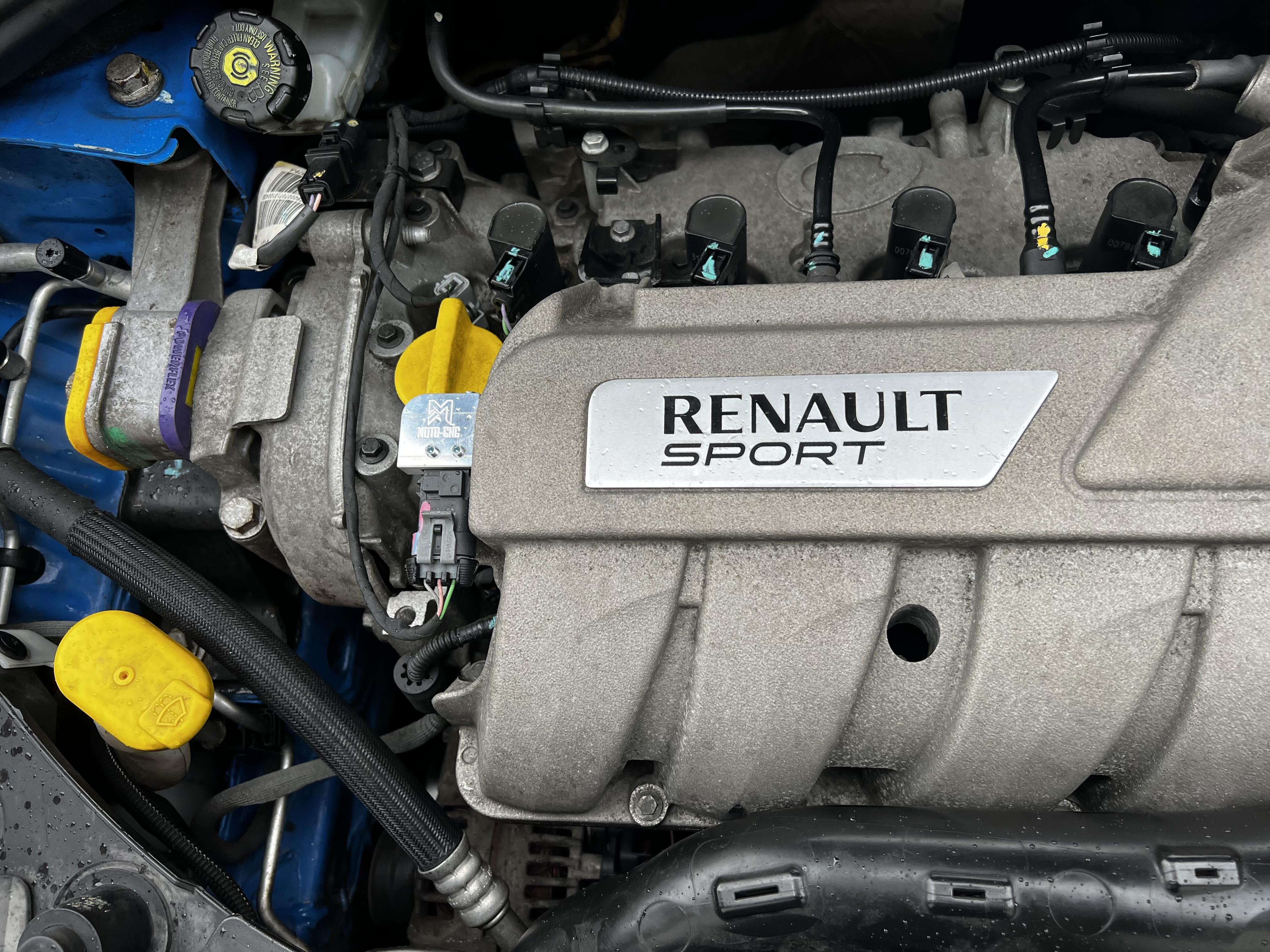

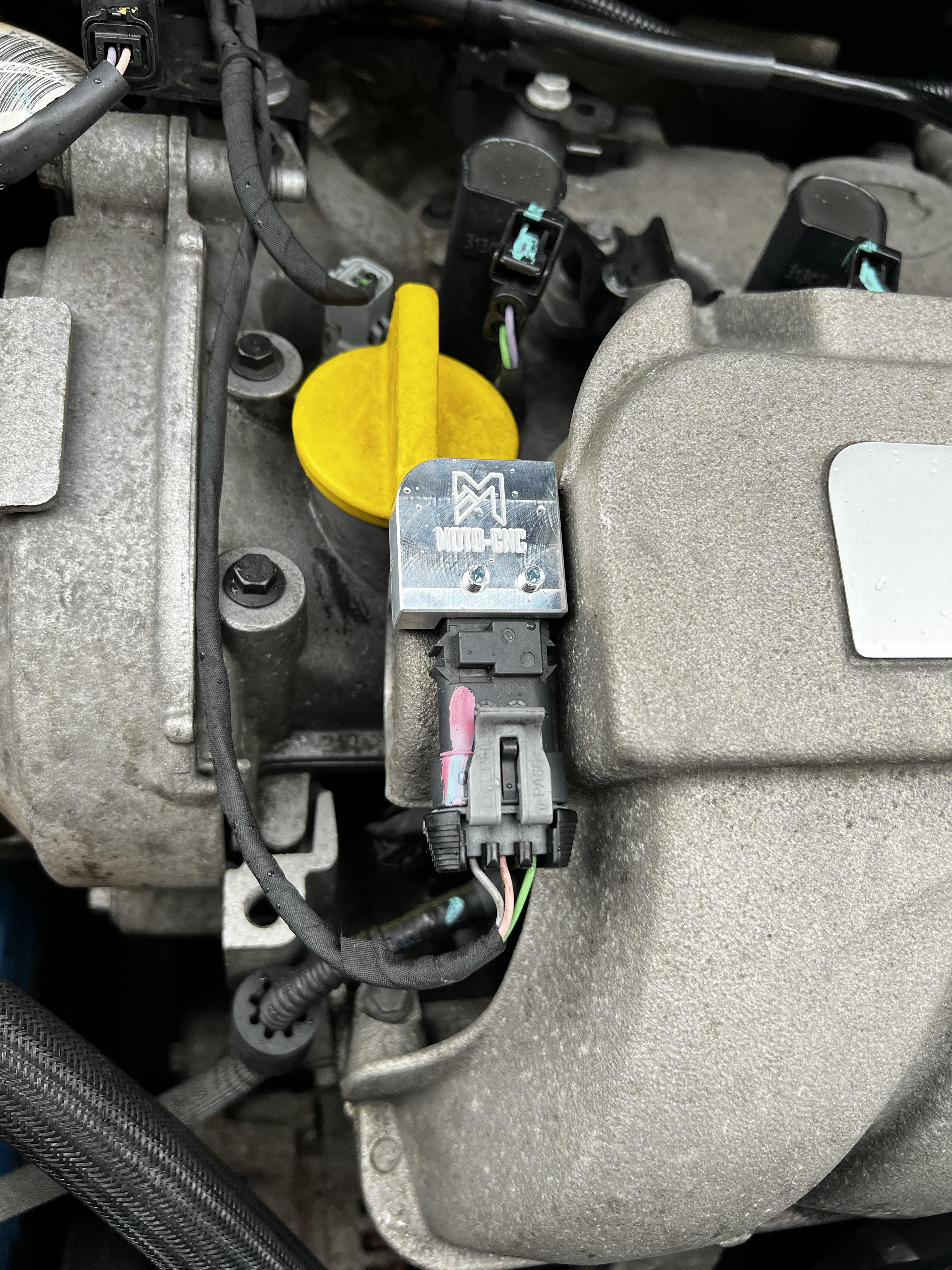

Bought one of these Moto cnc billet map sensor holders and some sensor cleaner as wanted to get rid of the cable ties that was around the map sensor lol
The map sensor cleaner might work it might not but though I would give it a go
Anyways after it was all cleaned out got to fitting the map sensor holder and its a nice fit to be fair

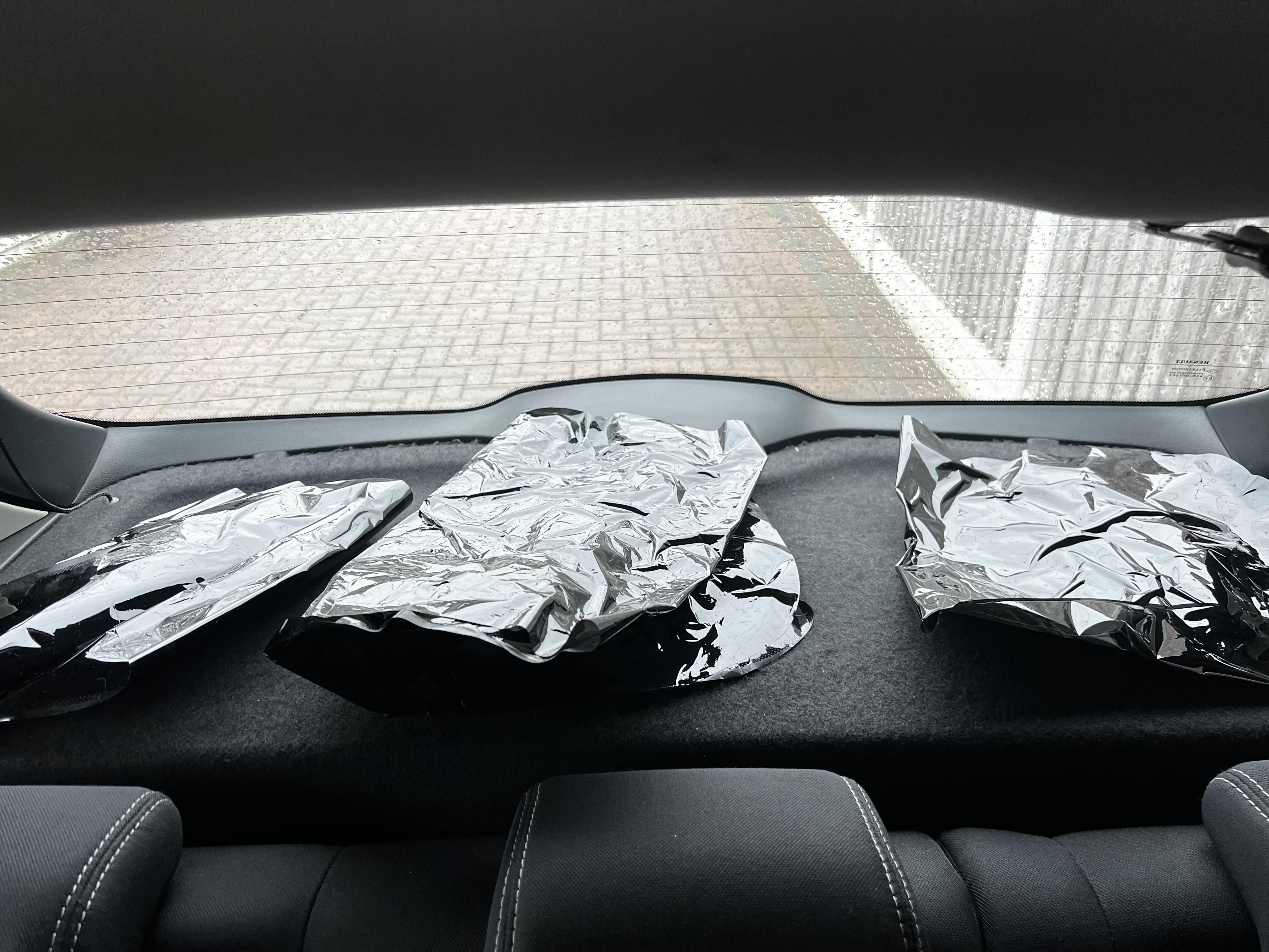

After that was all done I decided to get the good old heat gun out and remove the tints form the windows as never really been a fan of tinted windows and it definitely gives the car a cleaner look now they are removed
For anyone looking to remove window tints the easy way is a heat gun managed to remove all 3 tints without them ripping or leaving any glue on the windows

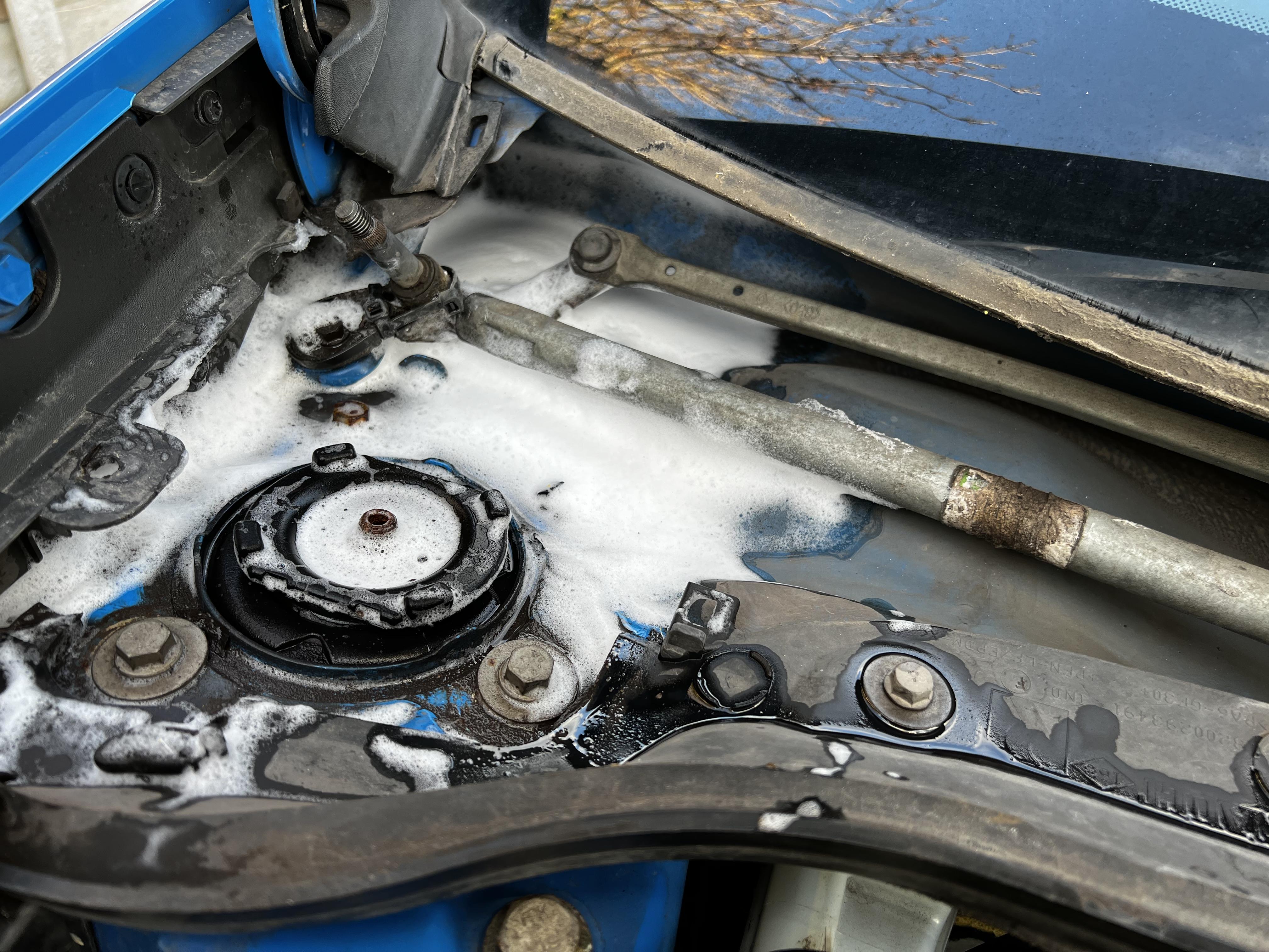

As the weather was nice ish today (not raining) treated the old girl to a wash along with my missus daily and a mates Meg 275 trophy

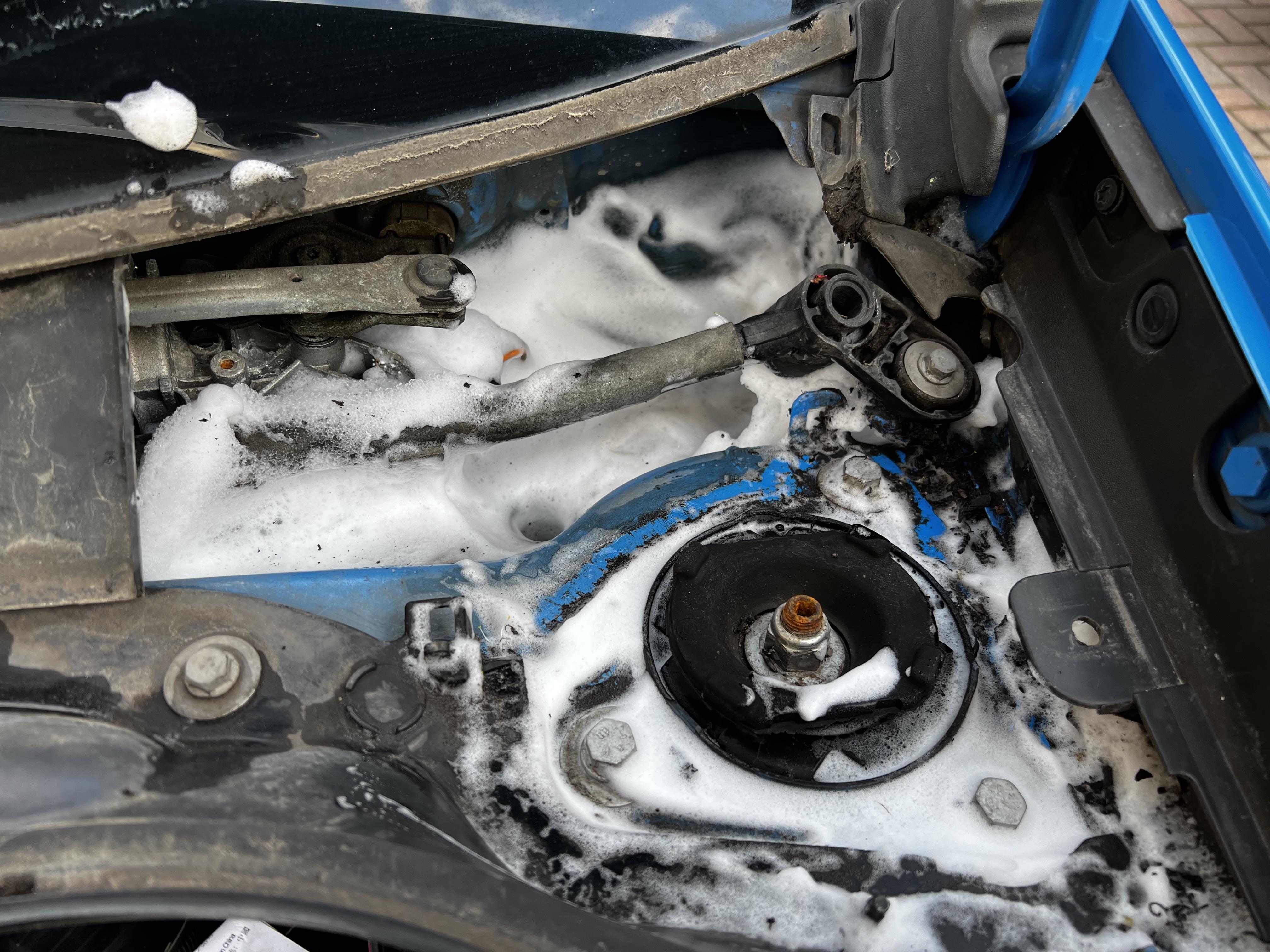

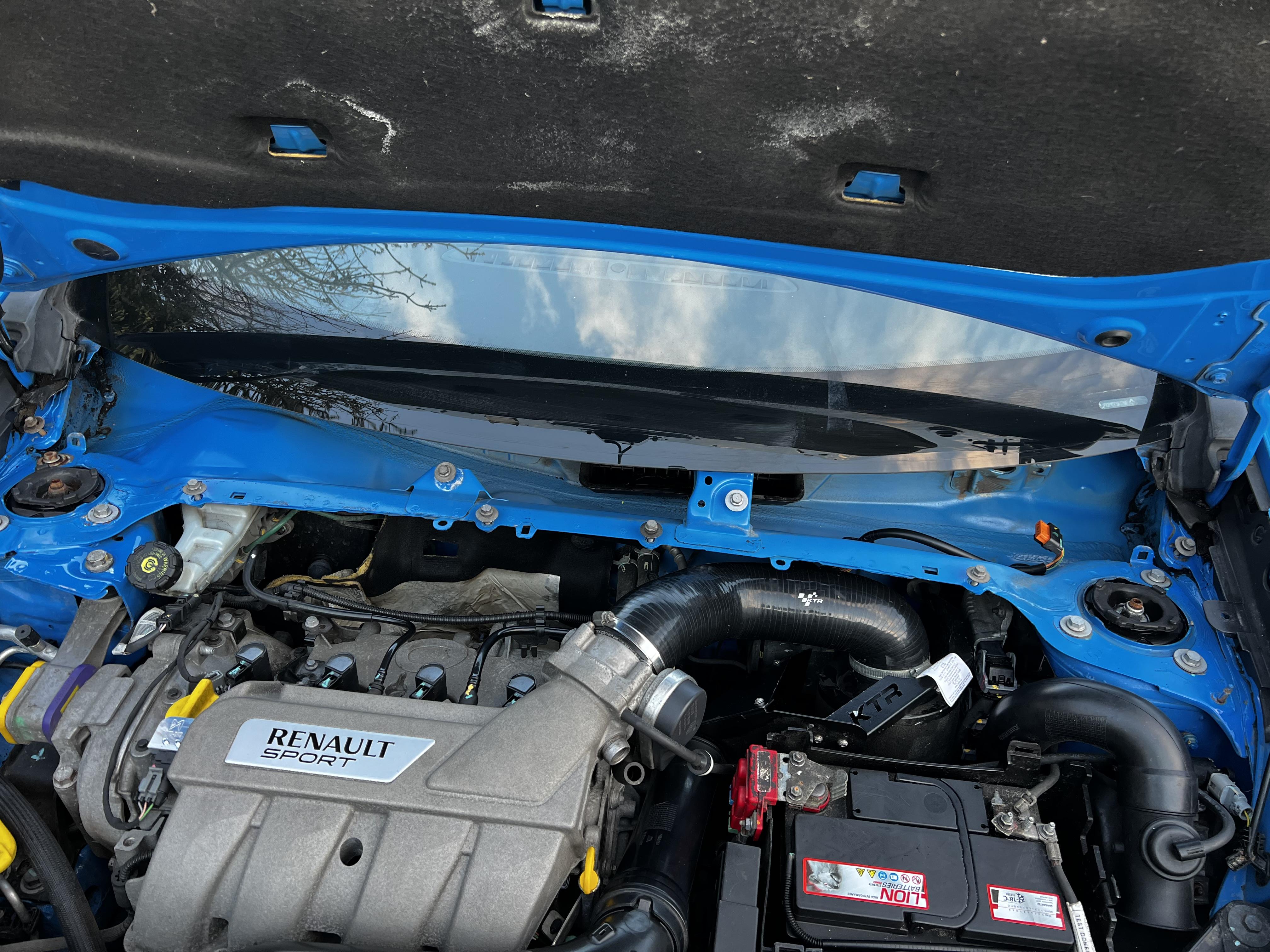

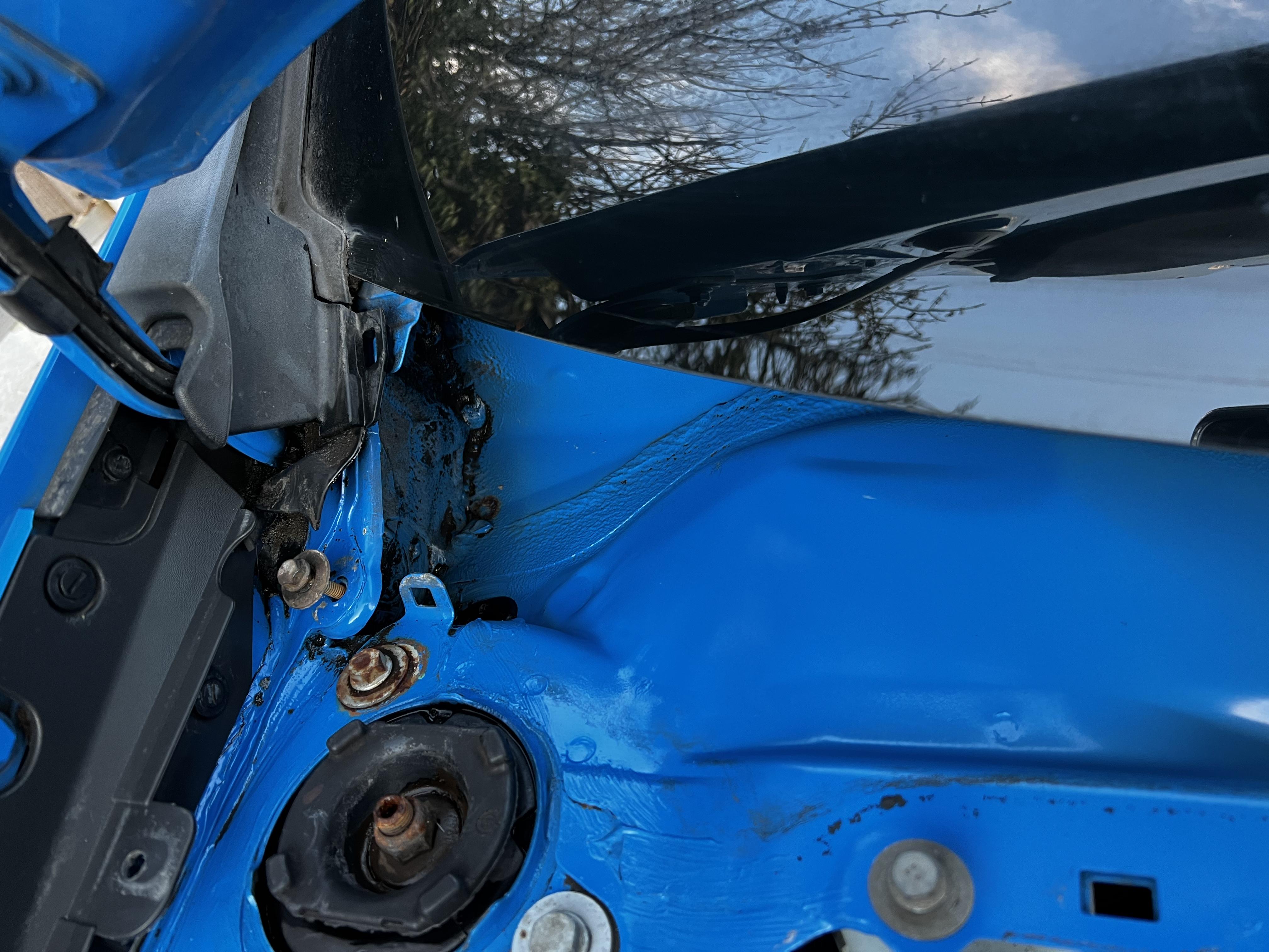

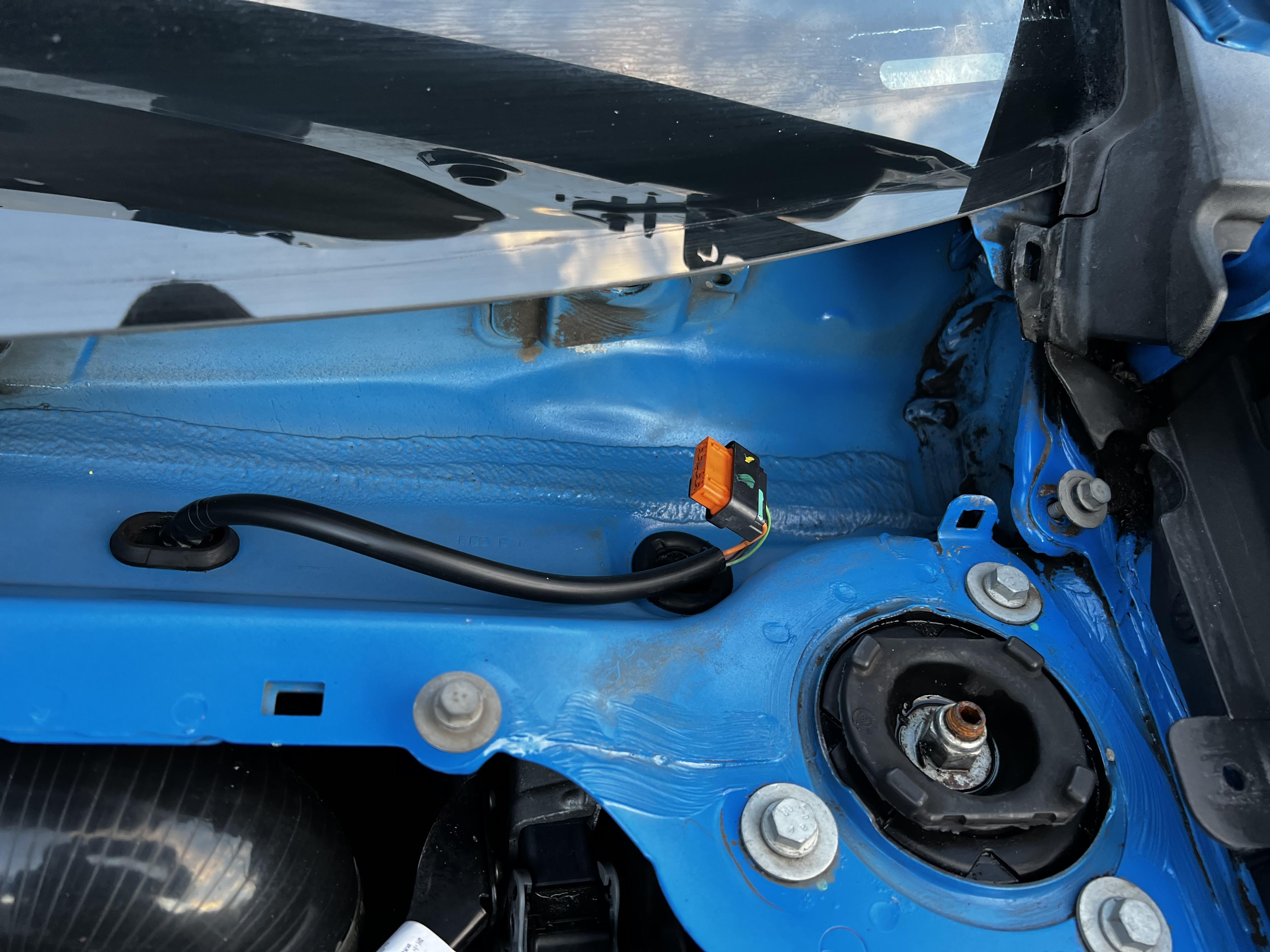

Only down side to this was after we was all done I moved the car and noticed the passenger foot well carpet was a bit wet the scuttle drains was obviously blocked a lot more then we first though so set about stripping all that out and they was blocked solid
So out come the 3/8 drive long extension and that worked a treat cleaned them out and all the water just flowed away nice and freely so after that decided to remove the wiper linkage and motor so I could give it a good clean

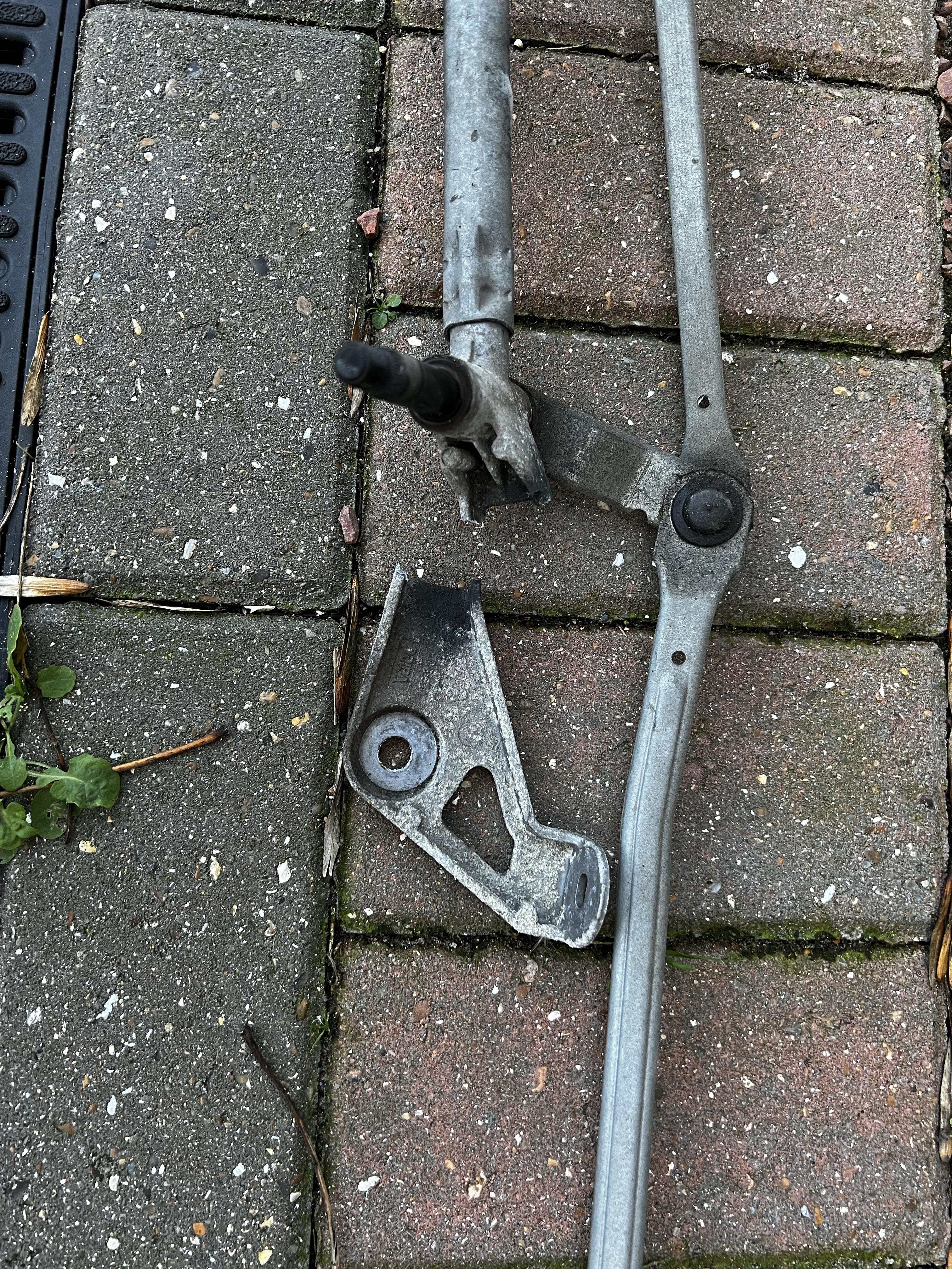

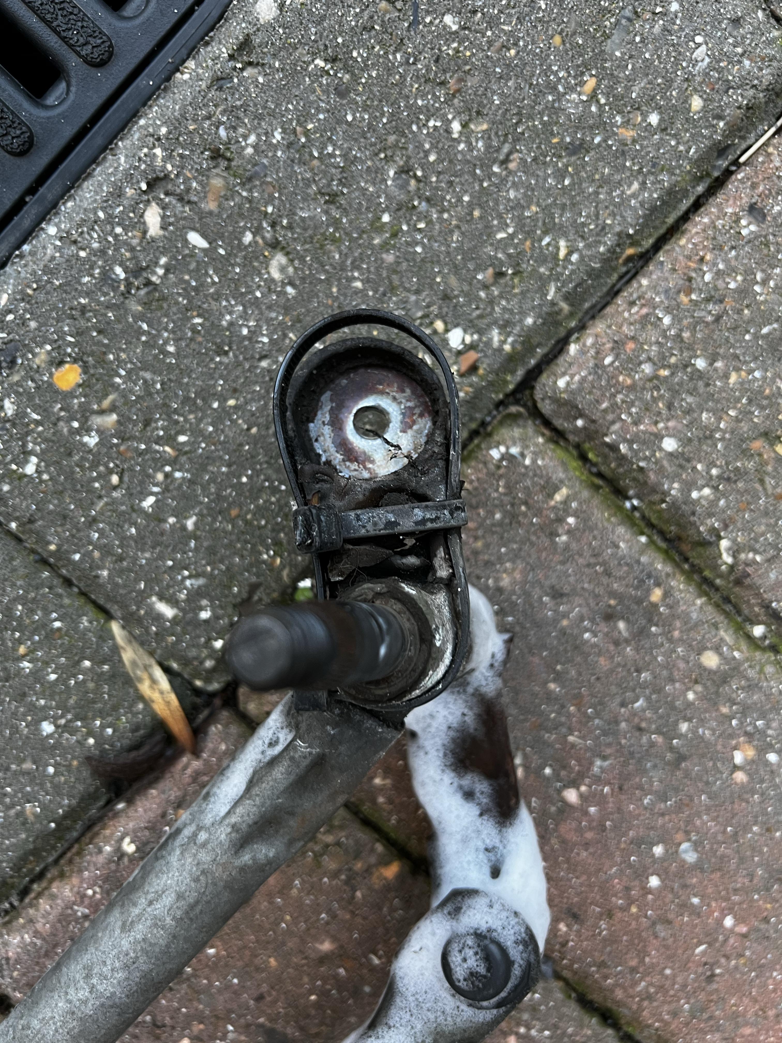

As I was removing it I notice that someone had broken the wiper linkage in the past and just used cable ties to try hold it in place
Good effort I guess
Going to order a new one in the morning as I don’t really fancy putting it back in with cable ties lol

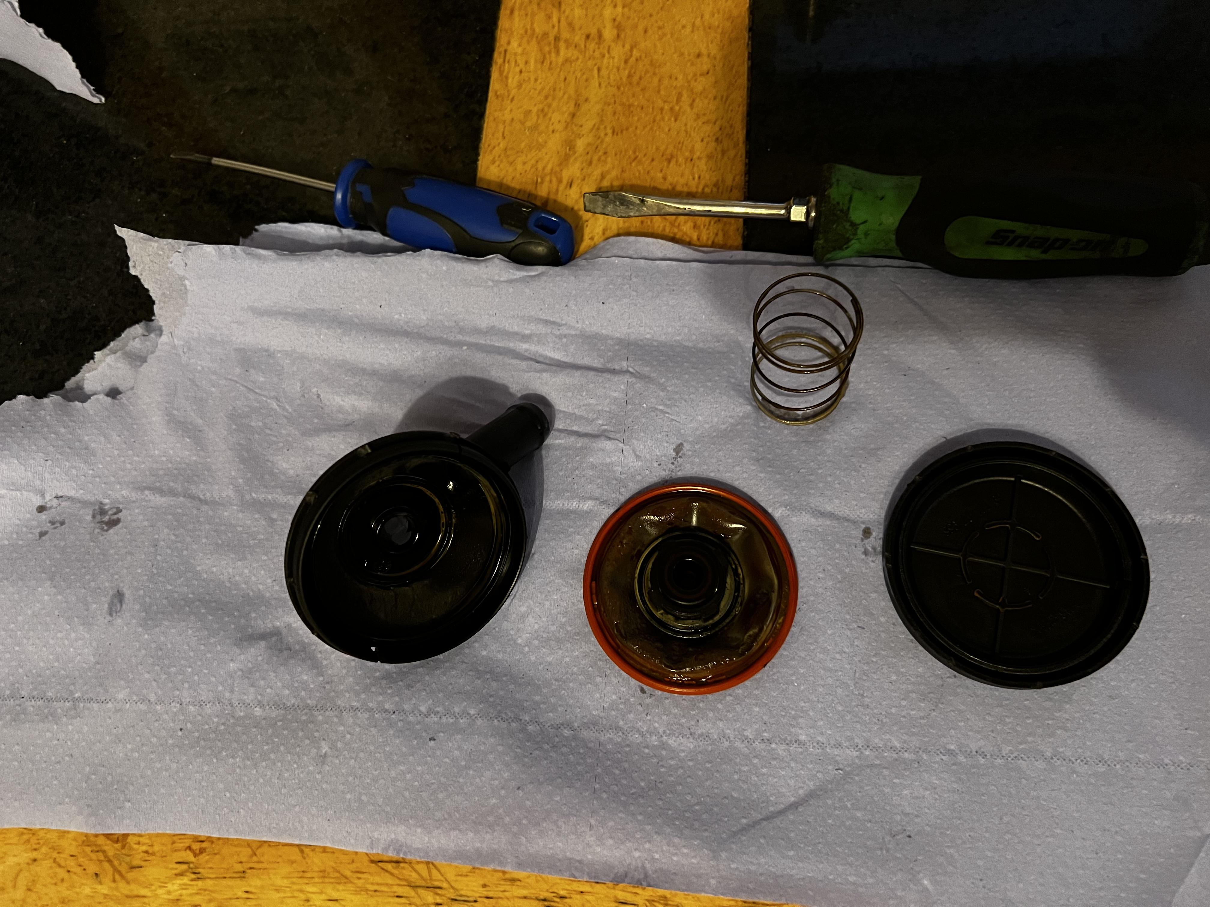

And the last thing for today was to remove the pcv valve and give that a Clean out after seeing [mention]Dystant [/mention] how to Guide that made it nice and easy and it was not that bad inside which was nice to see

When my wiper linkage seized I bought a used linkage from eBay - but it turned up seized. I think that a genuine new linkage is really expensive. I searched for a few weeks and then managed to get a non-genuine linkage for about £45 from eBay. I was warned that the splines on the non-genuine linkage may be softer and not last as long - but for the price I was happy.
Reactions: Jakkehoop
Jakkehoop
Yea been looking tonight a genuine one is very expensive
That was my worry about buying a 2nd unit found a few aftermarket units that clam 5 years warranty so might give that a try see how it goes
Jakkehoop
So managed to pick up a new genuine wiper linkage at a good price so that is all fitted and working perfectly

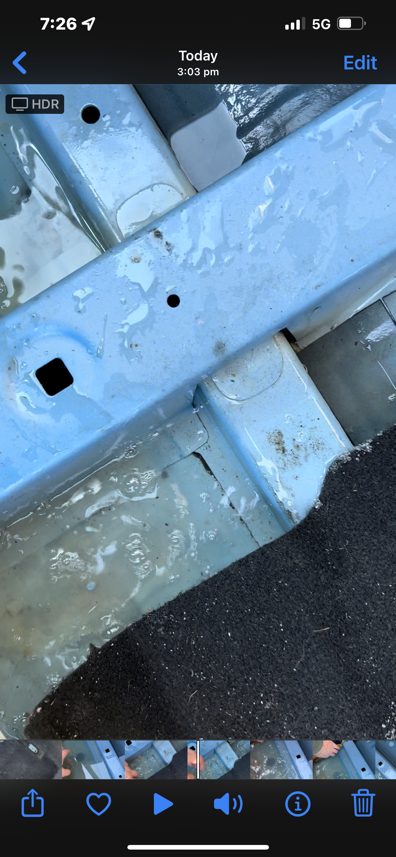

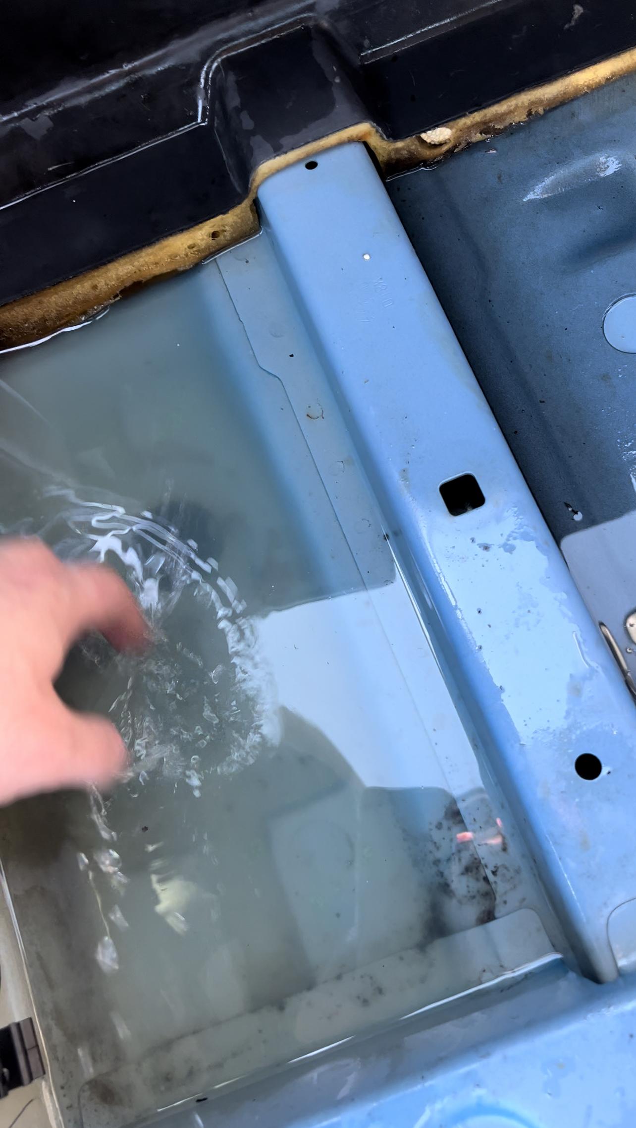

As I said in my last post I noticed the passenger side carpet was a bit damp so though I would check it out
All I have to say on that is I'm glad I did
Had to screenshot form the video as I don’t know how to upload the video
So stripped out the front of the car and mopped up 99% of the water and will get the dehumidifier in there tomorrow and leave that running for a few day to draw out any more moisture fingers crossed it dry's it all up

Nice little puddle there! Did you find out where it was coming from?
Was debating buying some goldfish and having a little pond
Well from how blocked the scuttle drains was and how much water was just sitting up there I’m 99.9% sure it was them causing the problem they are all cleaned out now and water flows away lovely so now time to dry the inside and see of it happens again fingers crossed it don't

I feel your pain I discovered a puddle in the same place and all the yellow foam was absolutely soaking, after I dried it out and thought it was all fixed the leak was actually from the door seal and it happened all over again,

My scuttle was just mucky in the end no blocked, the problem on mine was the weather strip on the outside had a gap and the where the door card had been removed and put back on the membrane was not put back so water dripped through the screwheads onto the passenger footwell.

I would check the pollen filter as the water would have to go down through the fan assembly intake in the scuttle bay, you have a main loom connector on the passenger sill and across the floor to the fuel pump under the front face area of the back seat. Take out the carpets don't cut the foam it will be designed not to go moldy just expose it and the cars blow heater feet setting and time will dry it lift out the carpets and the other floor foams to track the source of the water unless you know how it got in. The white 200 car from Belfast had a leak it was down the wing mirrors onto the door speaker out the bottom of the door card into the car or the scuttle blockage even the cleaning process caused it as its a lot of water.

Another tip: if you want to know if it’s been leaking for a while is to check all the unpainted steel parts in the car for rust eg. Brackets behind dash and handbrake mechanism under the plastic cladding. Might have been leaking like that for a while.

Thank you dude We had a look and lucky nothing seams to be rusty just a bit dusty so it don’t look like it’s been a long term thing
