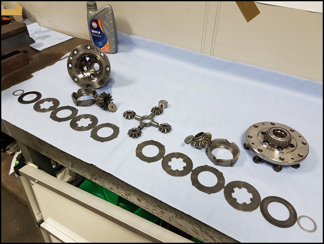

Just to add the gripper is available with different preloads as shown below I’d be tempted by setting ‘B’ as a compromise less clonking but still good performance talk to Alex he’s sorted someone recently10C23BAB-1819-4926-80F5-0D3562C4A7E5.png

Considering we have the ‘race’ setting, they really aren’t all that bad in terms of noise. You only hear pulling out of 90 degree junctions really.
I was expecting horrific noises and feedback through the wheel having previously driven my mates car with a 3J.
So far as longevity goes, I can’t answer that…. But if a Kaaz can put up with years of abuse from the Pinderwagon, a Gripper can certainly put up with 200ish bhp in a Clio doing a dozen trackdays a year:

The way I look at it, is my box will need synchros before the diff needs maintenance.

Haha yeah I was thinking that about the boxes on these, the synchros will die before the diff needs rework.
