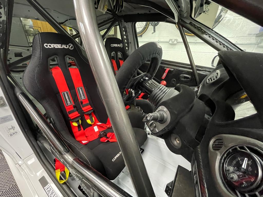

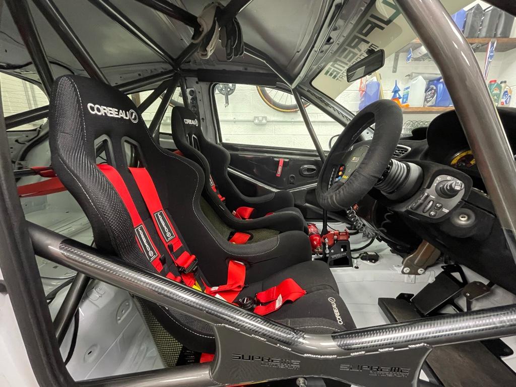

Some interior shots:

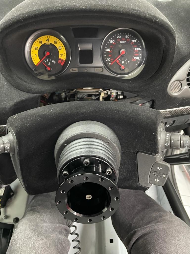

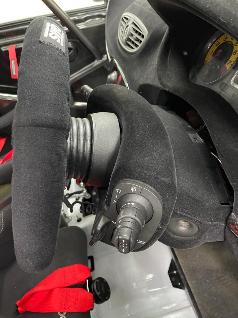

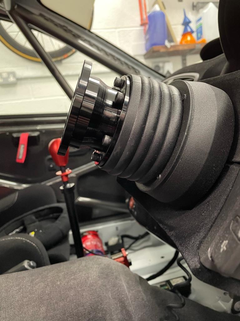

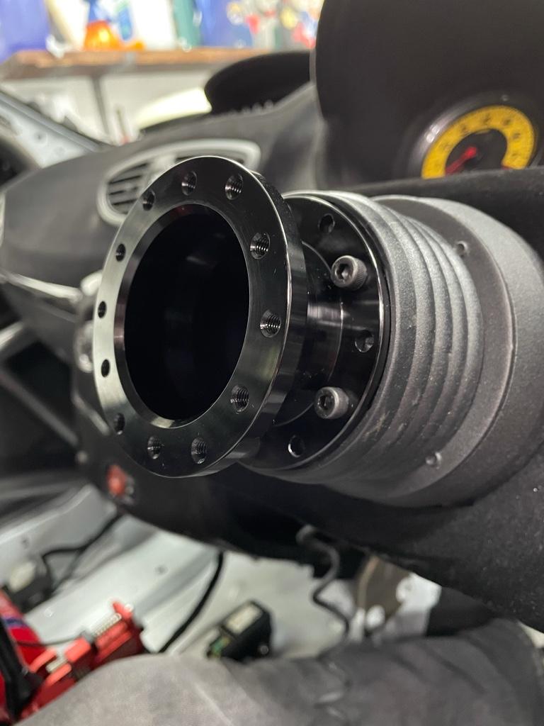

Because my car is the base model cup I don’t have forward/back adjustment on the steering wheel, only up/down. Now I’m happy with the seating position in terms of pedal position, the wheel is a bit too far away when strapped into the 6 point harness.

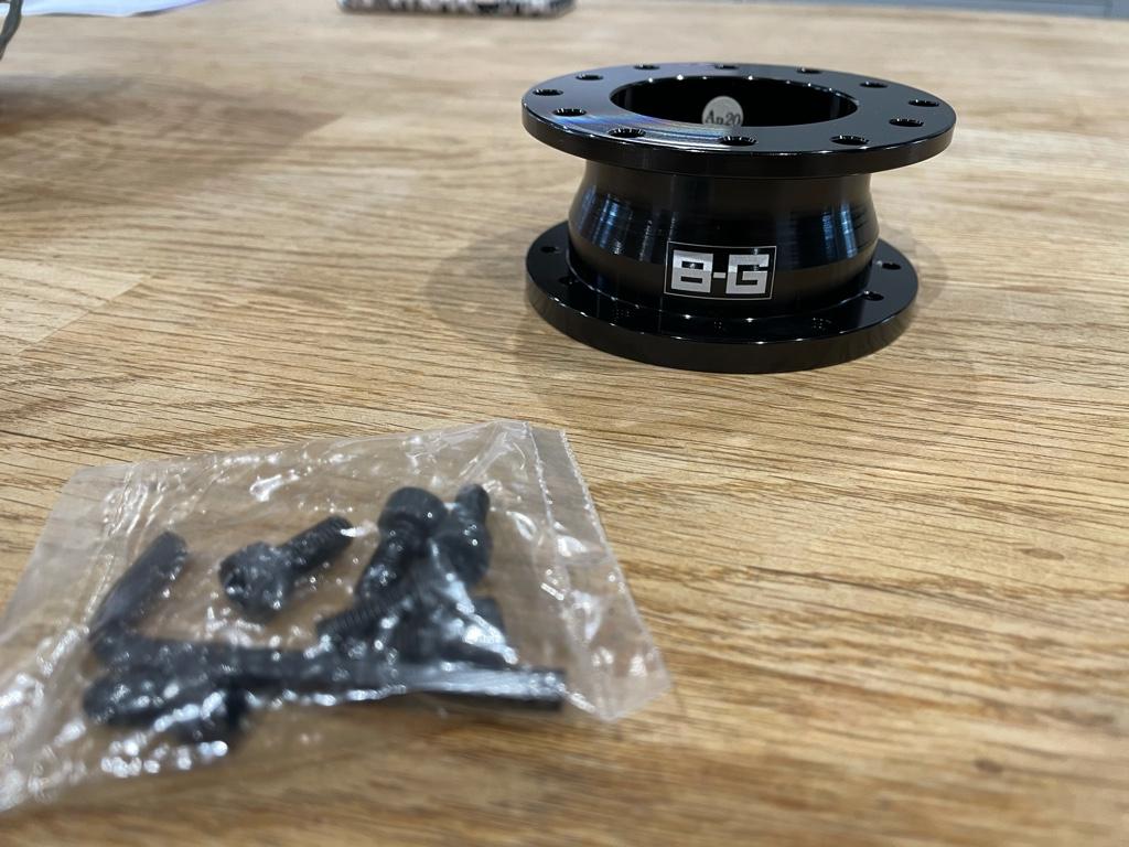

My steering wheel spacer arrived today, I went for 40mm. It’s a nice bit of kit and anodised black, comes with the required Allen bolts.
This is the spacer:
This was the original wheel position:
Wheel and button panel off, spacer fitted:
Wheel back on:
Much better. Just need to get if 10-20mm lower which is the next task.

That sits so well doesn't it you must be chuffed to bits! Same here with the steering wheel position, what make is that spacer? and who makes the carbon centre console?
The steering wheel spacer is made by BG Racing, and they have a few depths to choose from between 10mm and 100mm+

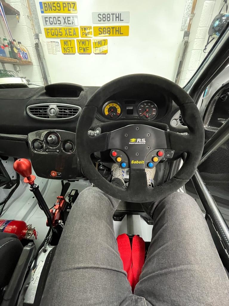

Did a bit more prep work to the car today, last weekend I lowered the steering column using another 5mm spacer washer(s) to get it as low as I can safely.
I also replaced the 40mm steering wheel spacer with an 80mm spacer and now the driving position is probably as good as I’m going to get it:

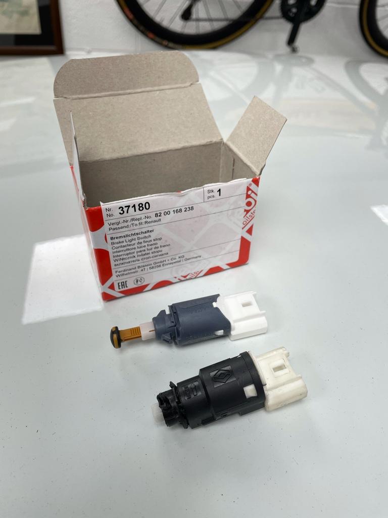

In the process of removing and replacing the lower dash under the steering column I must have dislodged the brake light switch as I noticed that my brake lights were staying on permanently. I managed to retrieve the switch but I must have snapped off the plunger somehow. Looked for ages including in the hoover bag but I just couldn’t find it!
I ended up having to buy a new one, part number 82 00 168 238 in case anyone needs one in future. You can see the missing plunger in the old switch. It’s a bit tough to get to it with a car with a full cage and bucket seats, I ended up upside down in the driver footwell but all sorted now.

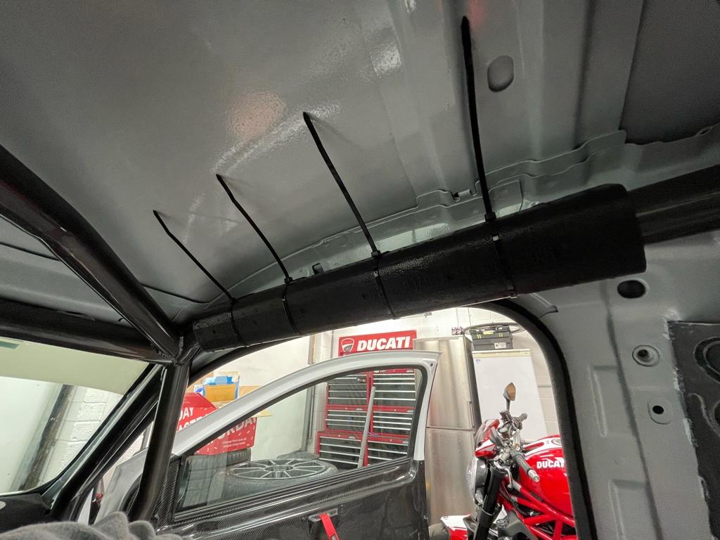

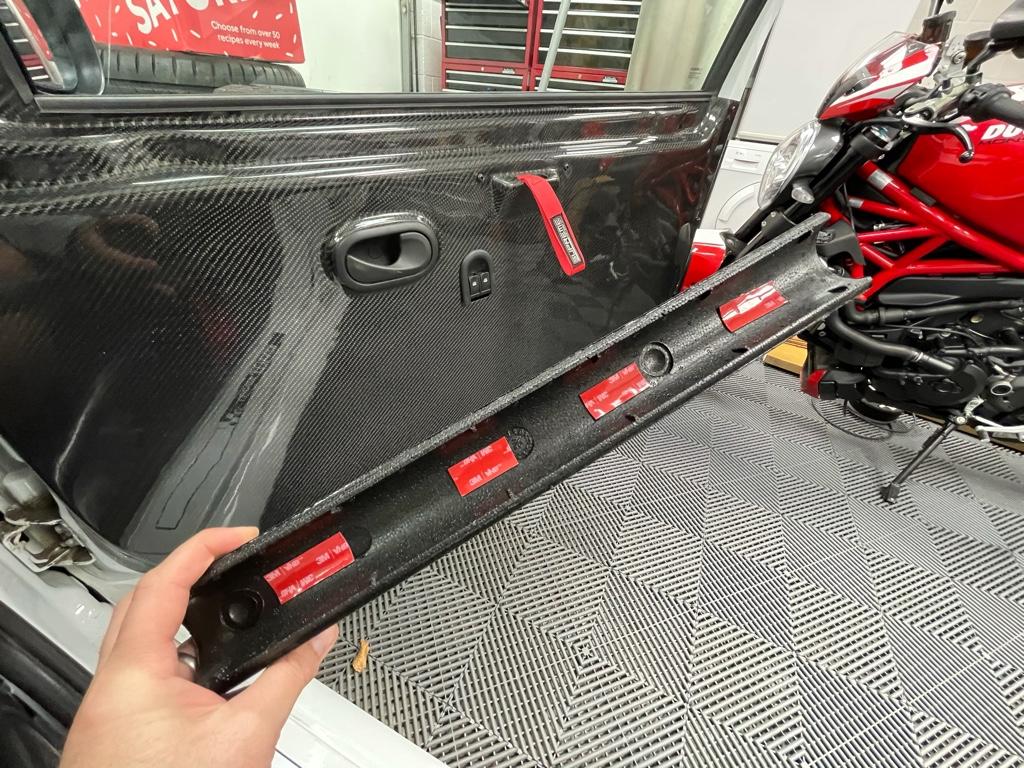

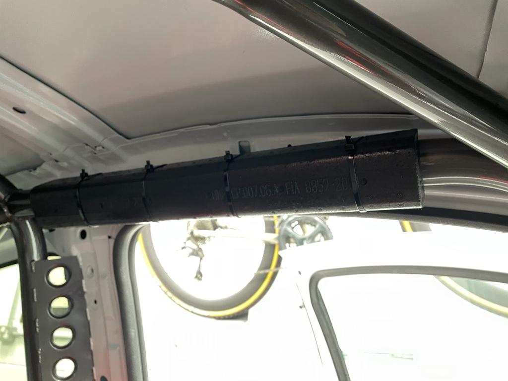

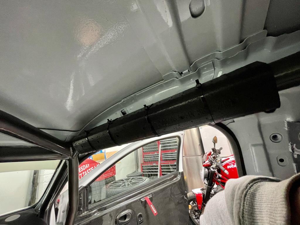

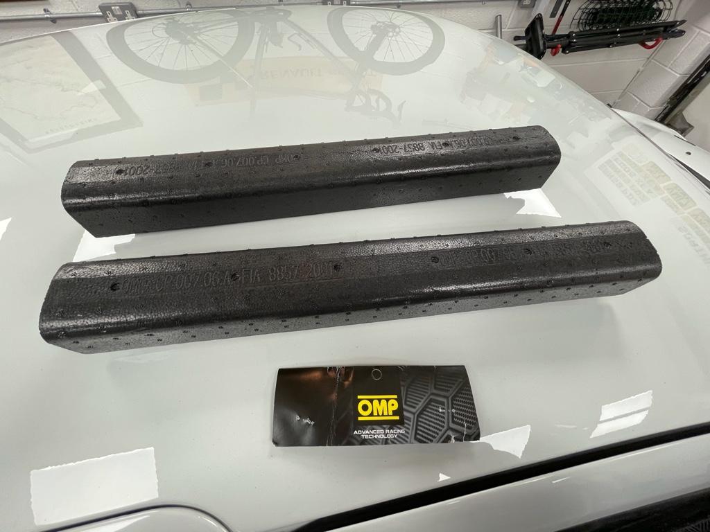

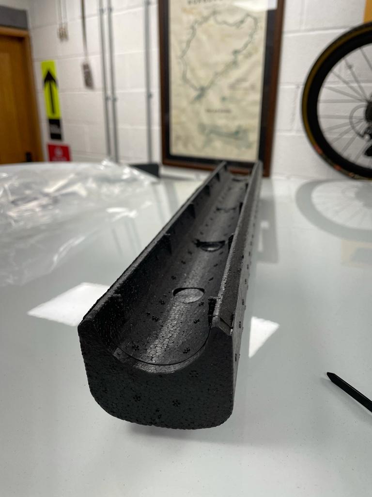

One of the things Nurburgring marshalls look out for in caged cars is padding around the head area. Most people seem to use pipe lagging, instead I bought a couple of these FIA approved OMP pads. They’re a bit expensive for what is effectively just shaped polystyrene (£26 each) but they do fit perfectly and look better than foam lagging in my opinion.
A bit of double sided tape and they click into place onto the roll bar tubing. Probably didn’t need the additional zip ties but put some on anyway.

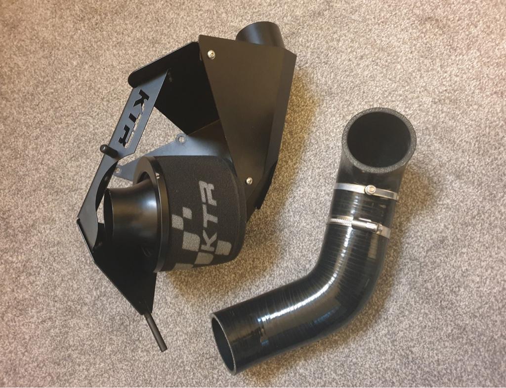

I also bought the KTR induction kit from the classifieds and fitted that this afternoon instead of the OEM airbox.
It’s pretty loud inside the cabin now with the exhaust, induction and stripped interior!
