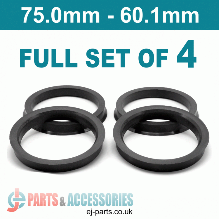

Can anyone tell me what size spigot rings I will need for my 17" Oz Ultraleggeras? I need to sort out these wheels as they have been sitting around since last year.
This week I have acquired some spigot rings and shiny new wheel bolts for the Ultraleggeras.
