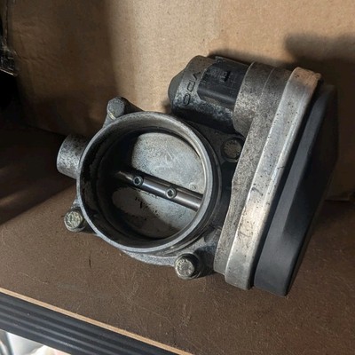

You won’t be able to tell visually if it’s ok, it could be electronic internals throwing a wobbly. Swap it with a known good one to rule it out. It’s an easy job. One electrical connector, four bolts, 5 minutes.
I would have to buy one :/ no idea what sort of price they are, if they are cheap it would do no harm to have a spare anyway. Will look them up. Wasn’t sure if a visual check was enough or not.
I suppose you dont have another diagnostic to scan for codes?
I only have CLiP. I’m trying to work out how to use it atm lol. I got a bit further playing with it plugged into my Megane this morning. Its a pain that the Clio lives at my parents house atm, so I can’t just go out and check the Clio :worried:.
On the day another guy had a generic scanner and it saw nothing other than “multiple misfire”.
