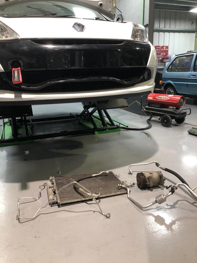

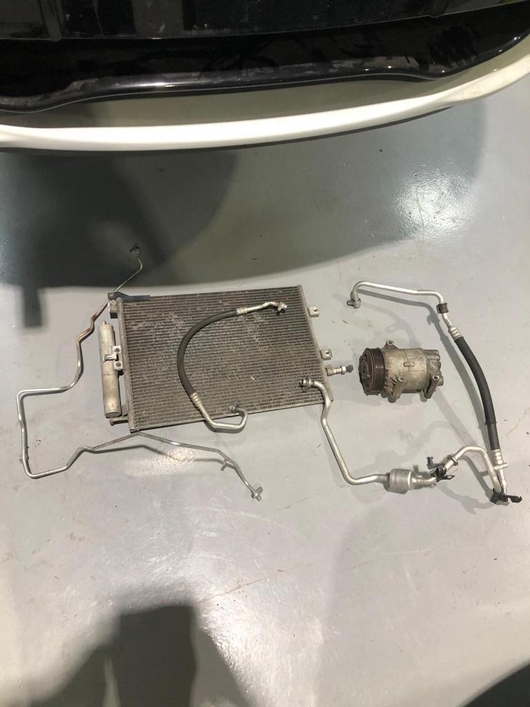

I said the same thing to Matt, and it's not the radiator it's the air conditioning condenser. I've kept A/C for now, if it fails I'll either replace it and regas it, or strip out the air con and fit a roof vent.
Just a heads up, my AC rad looked the same as yours. Did a track day at Snett in the summer and the coolant temps were through the roof as the fudged AC rad was blocking a lot of air from getting through to the rad, ruined my day as i could only do 3-4 laps at full tilt. For the sake of the cost of an AC delete kit i would rip that out ASAP, don't want it ruining any ring trips or track days.
If a job's worth doing... it's worth doing right (I really need to stop saying that because it costs me too much money) :think:
X85 Cup Racer AC delete kit has been installed today by Supreme Motorsport. Now on the look out for a carbon roof scoop....
