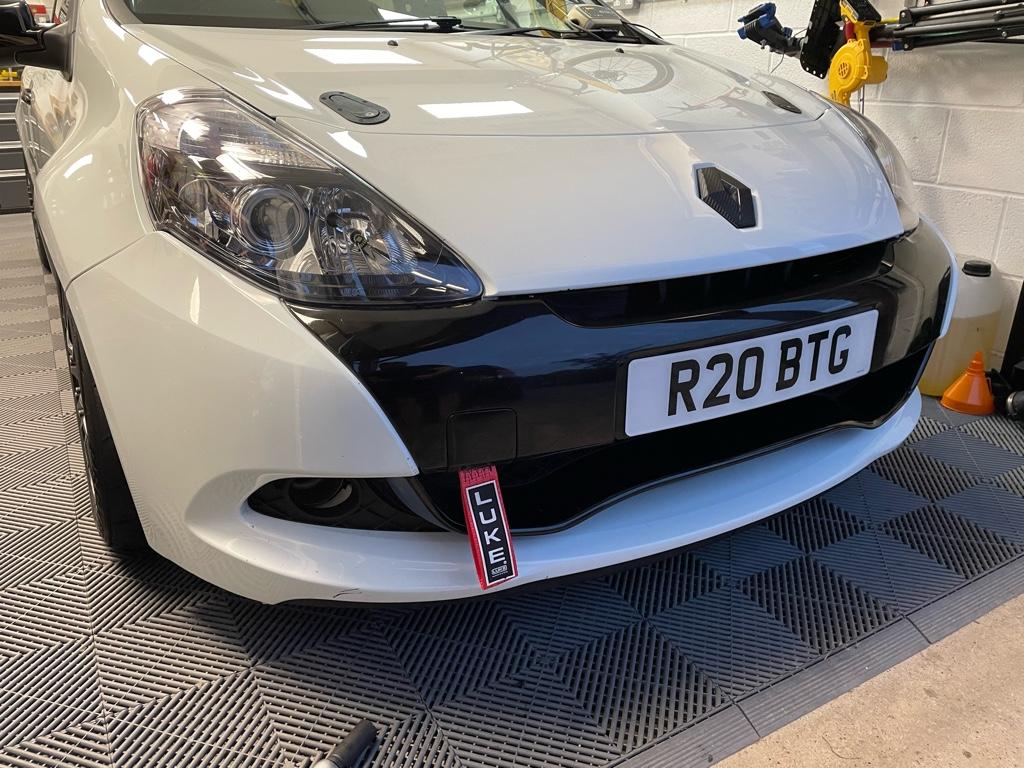

Tiny update, sorted the replacement tow strap. Corbeau had a sale on and I got a 22cm Luke strap delivered for a tenner. Can’t complain at that!
I put Loctite on the replacement bolt and trimmed a bit more of the tow bar cover with the Dremel to let the fabric tow strap sit neatly behind the cover. Hopefully this one will stay on!

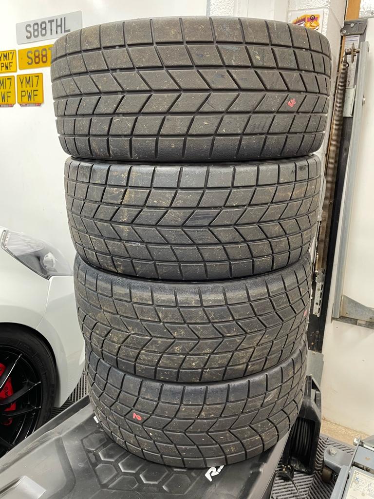

Bought them off my mate Nige (@pinderwagen) who needed road legal wet weather tyres for TF at the Nurburgring. Thought I’d give them a whirl as they were cheaper than the equivalent PS4.
The advice he gave is that they’re great in the wet but as soon as it starts to dry, come in and change to a more dry focused tyre as you’ll burn through these in no time. That’s where the PS4 might be easier as you can just leave them on as wet conditions turn to dry.
