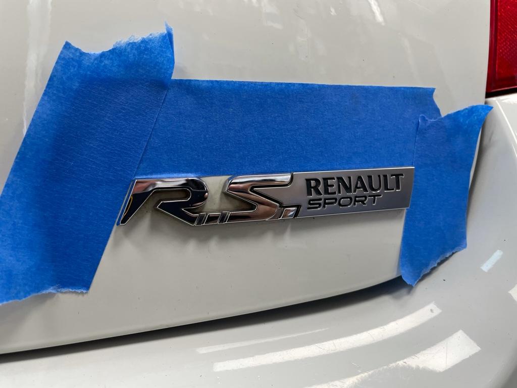

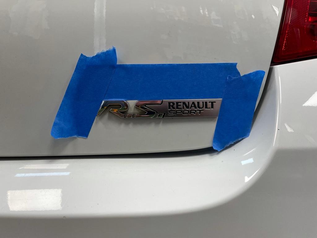

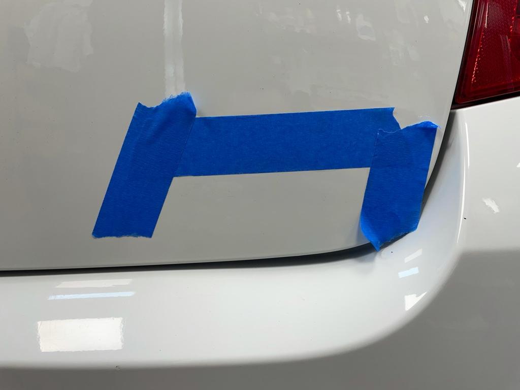

A productive afternoon today, first of all continuing the de-chroming mission by replacing the boot badge with one I bought from [mention]DS197 [/mention]
Template with masking tape:

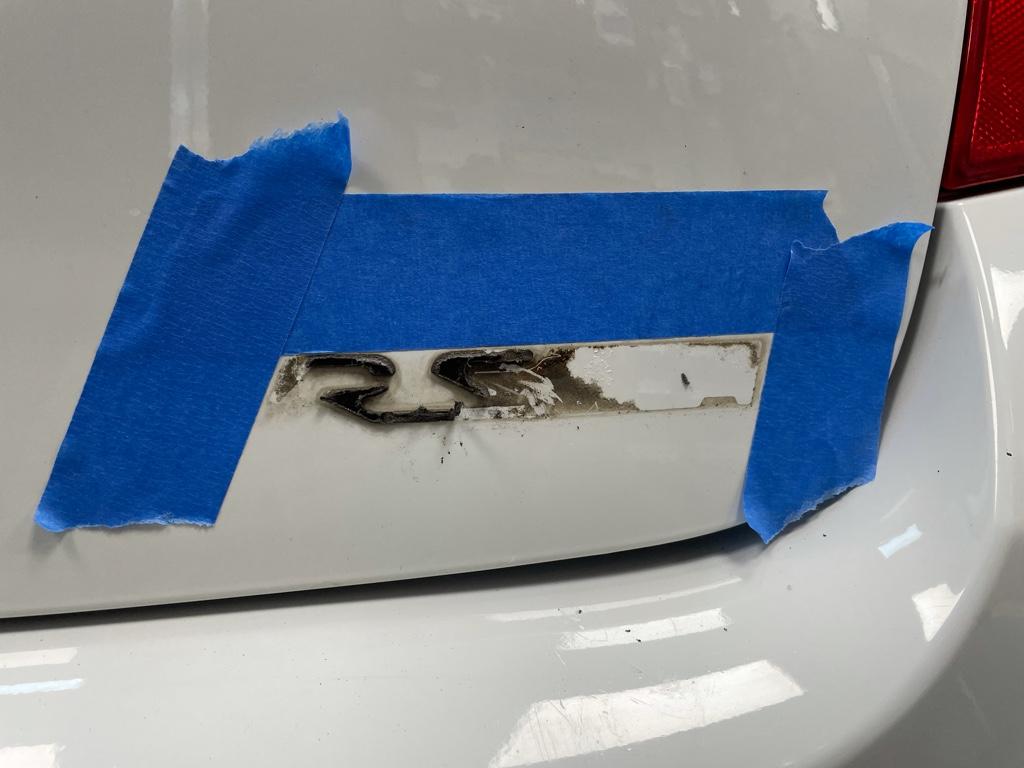

Peel off gently with some trim removal tools:

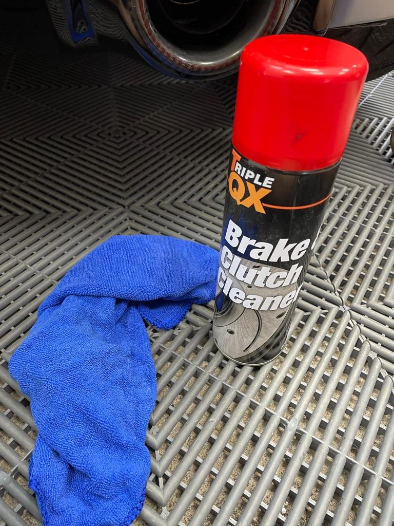

Clean up the old adhesive with brake and clutch cleaner and a micro fibre towel:

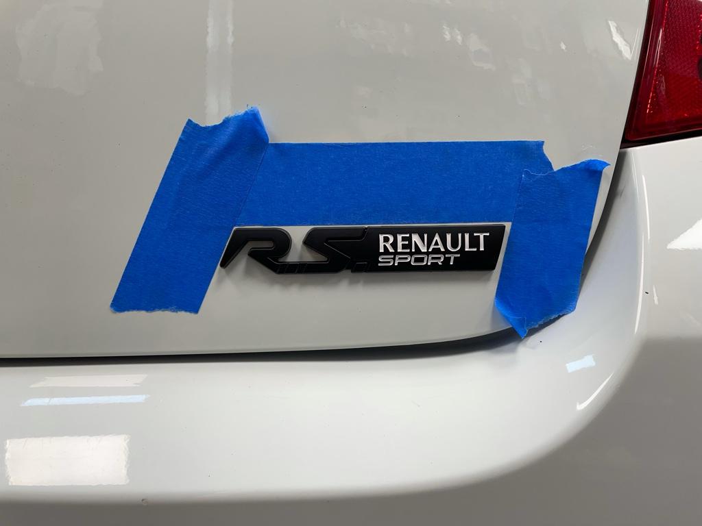

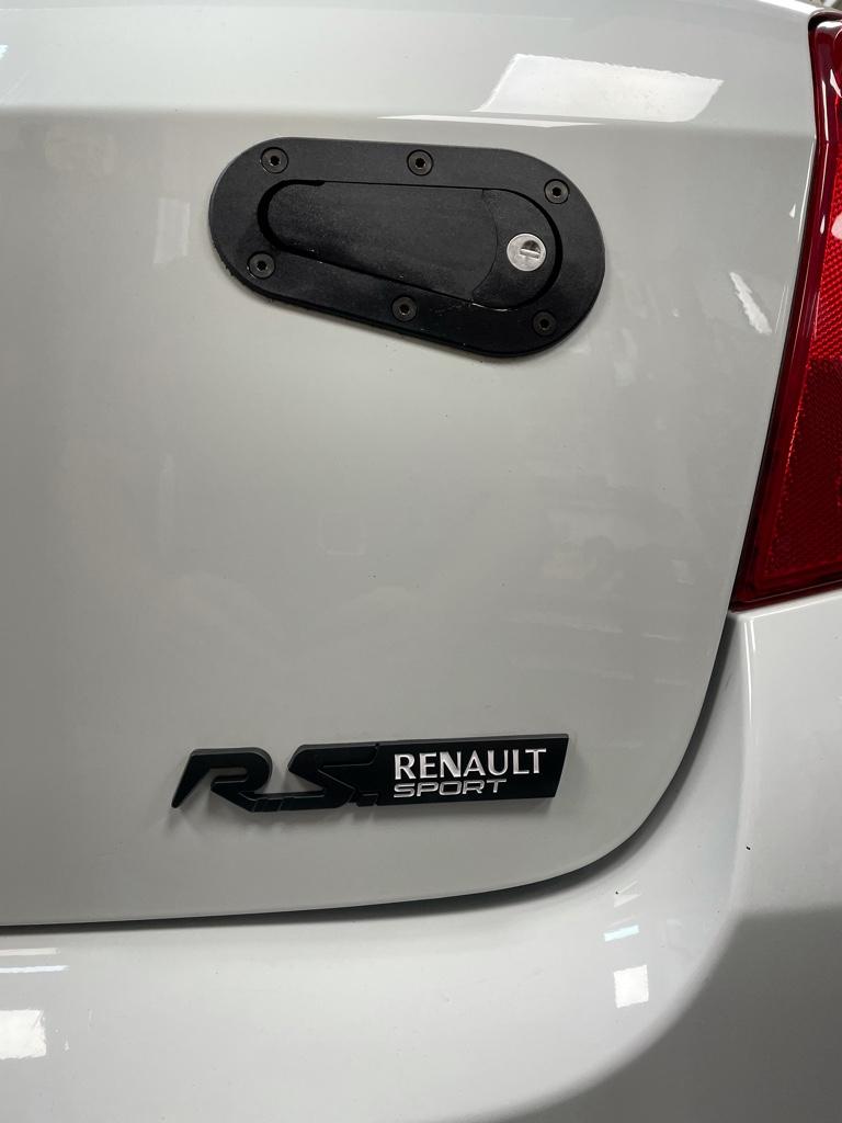

Replace with black badge:
Done, much better:

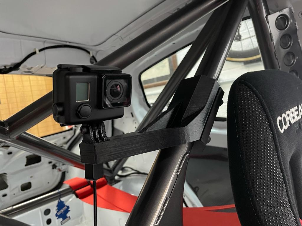

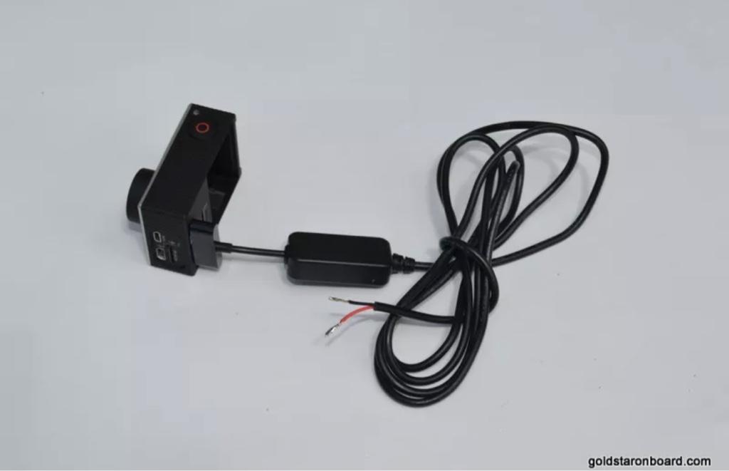

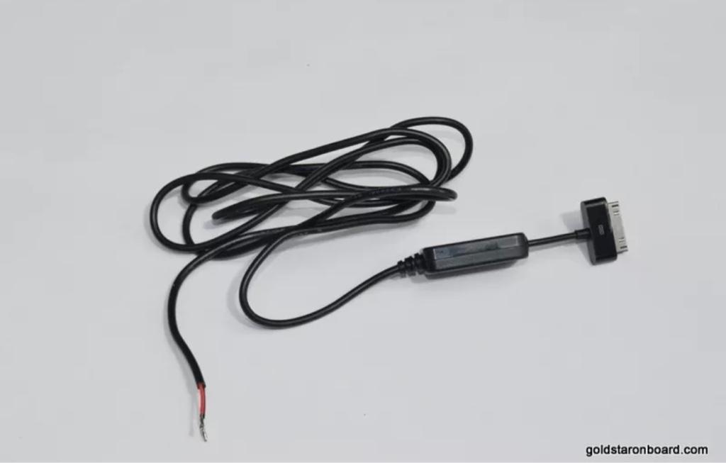

Then I set about sorting the in-car camera. I bought a hardwired battery eliminator kit for my GoPro:
This kit powers the GoPro with 12v from the car, no battery required. I took a switched live feed from behind the dashboard and connected it up with some black automotive twin core wire. The wiring runs down the cage, under the weather strip by the door, up the cage diagonal to the camera. It’s all neat and tidy just as I wanted it.

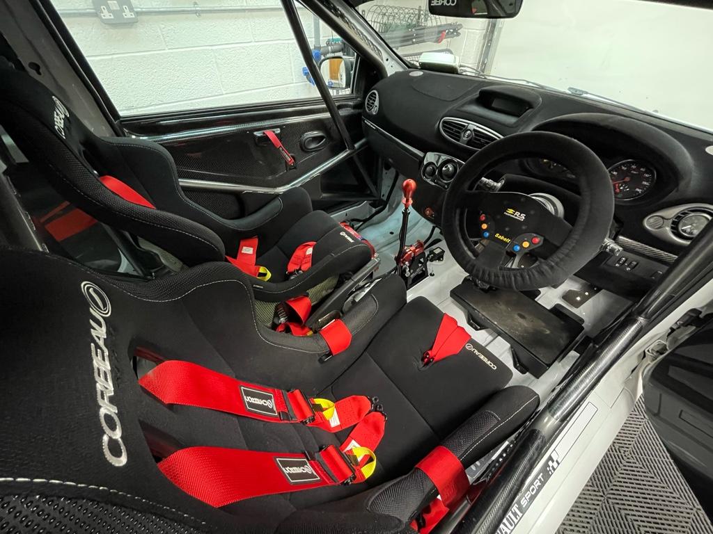

Then gave the interior a quick hoover:

I took the GoPro this time and mounted it onto @RSRowe 's 3D printed bracket. The mount is great, my old Hero 3 Silver is dogshit though, it doesn't handle exposure very intelligently like the newer GoPros do.
