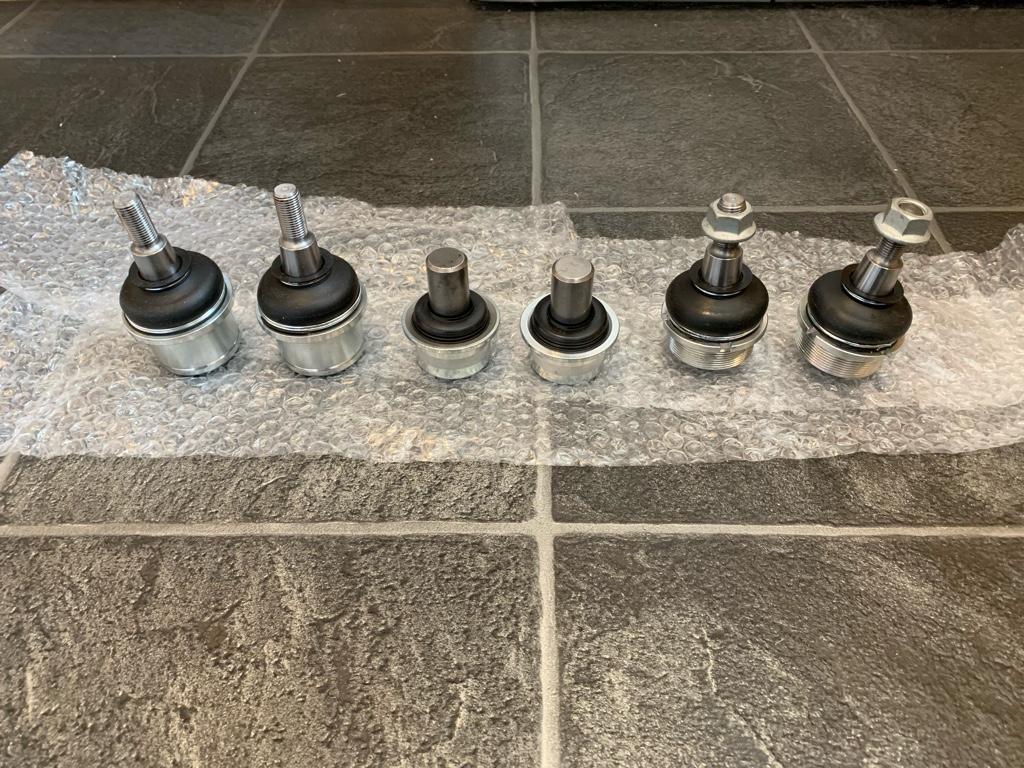

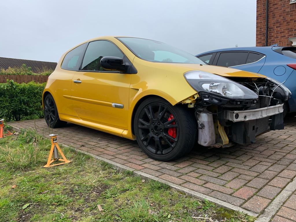

Well it’s time for an overdue coming out of lockdown update. The car is still sat on axle stands but almost back together now. Since the last update I’ve decided to strip the front end down and refresh things when the car wasn’t being used, this has sort of spiralled a bit. Original plan was to do the ball joints, so got some from Rene and got them done.

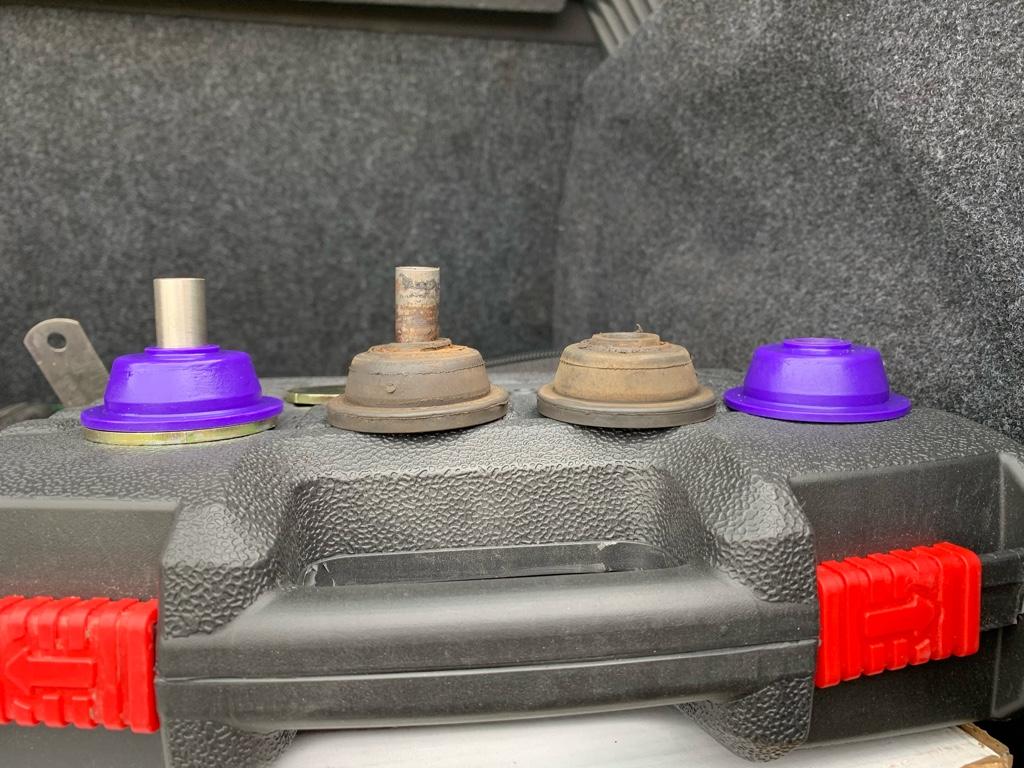

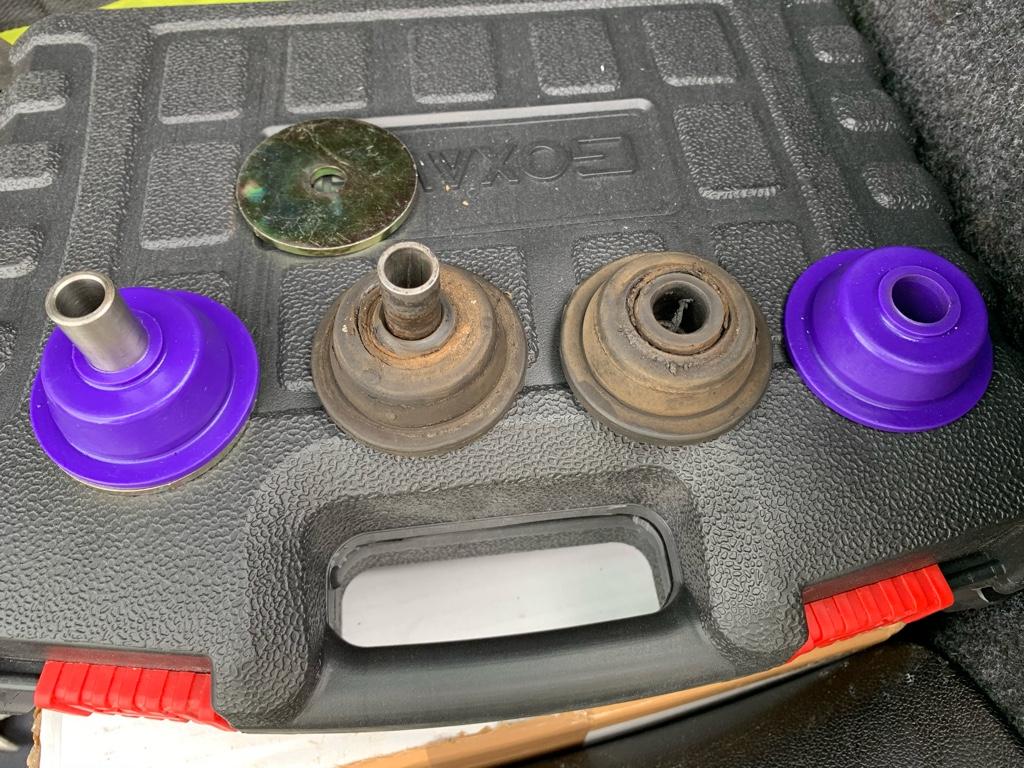

After this I decided it would be a shame not to replace the wishbone bushes, so Powerflex ones went in.
I then got thinking expensively and resisted right up until until k-tec sent out a 10% off voucher and then....

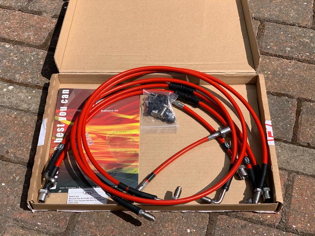

Also got some new Superpro drop links and anti rotation links to keep up with the refreshing theme. And a new 6 line kit from HEL as I fancied some shiny lines. Had a bit of a struggle with the rear axle long lines, couldn’t get them to fit without rubbing so HEL made me a custom line with a 45 degree end rather than the straight end they usually come with. They’re fitted with new RBF600.
I’ve been waiting to put it back together as I’ve been trying to get a solid subframe from Rentune but they’re snowed under with work so it’s all going back together now until they have one. As it stands now everything is fitted just need torqued up before it comes off the stands and aligned.

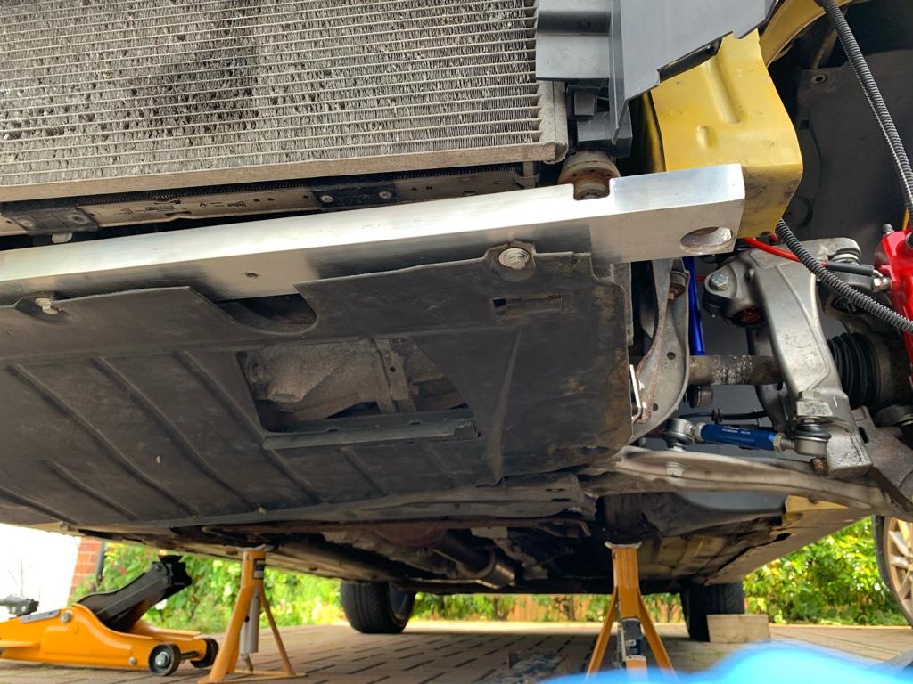

I’ve also started making a new rad support which I’m hoping to be able to keep using with the oem engine undertray, I’ll update this once it’s done.

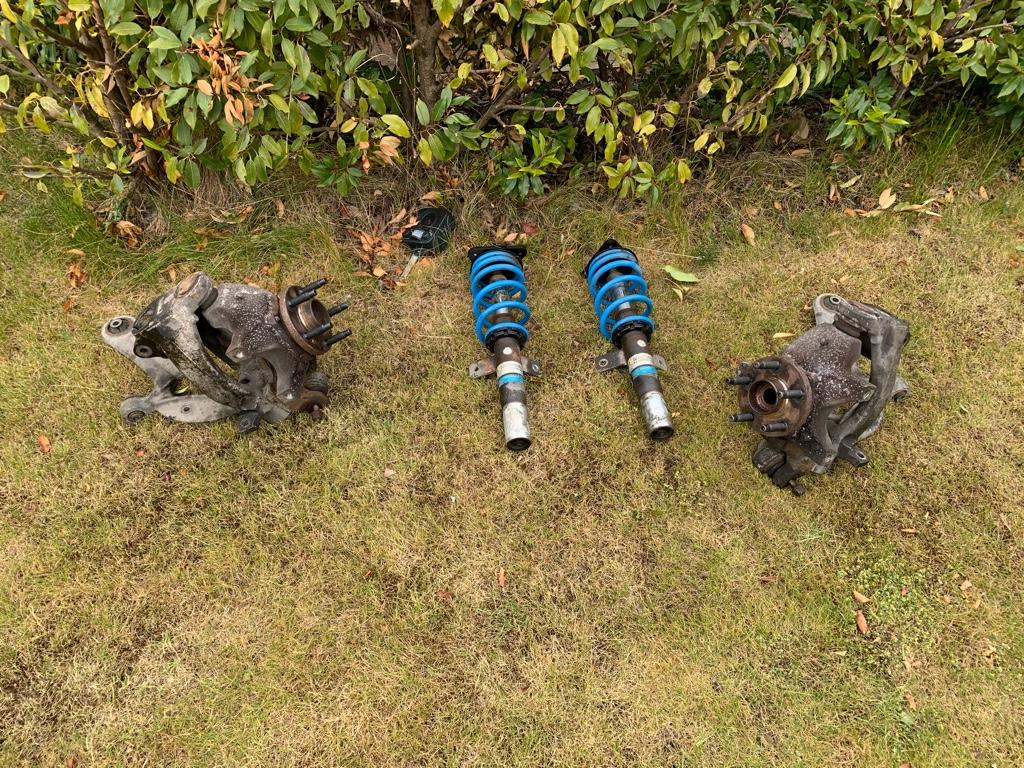

Thanks guys, can’t wait to try them properly. The springs are road biased 60/40nm. The car is back on the floor now - first time since March! Had a little issue with the coilovers, I didn’t realise the drop link collars were handed so the wheels were catching on them when you turned them - glad I checked clearances before driving, so stripped it all down again to swap them side to side [emoji2959]

Maybe HEL changed their kit recently as mine came with bent ends. View attachment 140849
Strange for them to change it. I would have said it might have been a mistake but I know someone else who’s got them recently and his were straight ends too. There was also someone else on a Facebook group who had the same issue not long after I did.

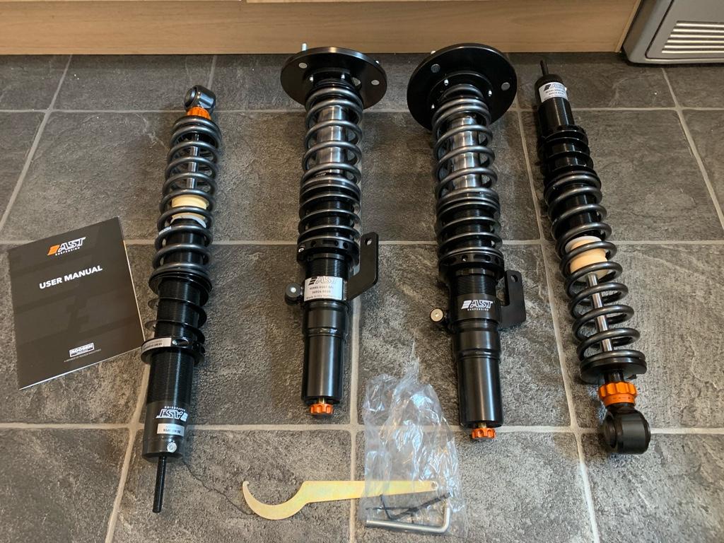

Well the car is fully back together for the first time since March and I’m well impressed with the AST’s definitely a big step up on b14’s. They cope so well with bumps, you can tell you’ve hit them but the car isn’t disturbed as much as it was with b14s. Raised the fronts a bit too as it was too low. Need to get alignment and corner weighting booked.

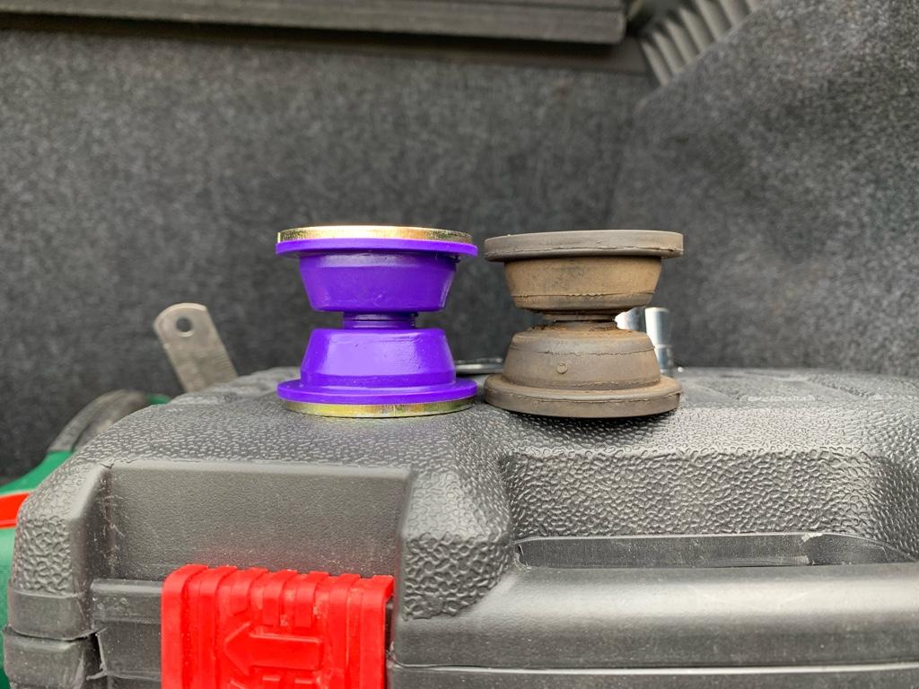

Also for those that are interested we now have powerflex bushes available for the rear dampers. I spoke with them and after a bit of measurement sending they realised the Clio mk2 bushes are the same as the mk3. So if anyone wants new rear bushes without buying a whole new damper, buy a mk2 bush. Only slight issue (but I don’t know if this was specific to the AST coilovers) is there isn’t enough thread engaged into the nylon part of top nut on the damper but some lower profile nyloc nuts will sort it.

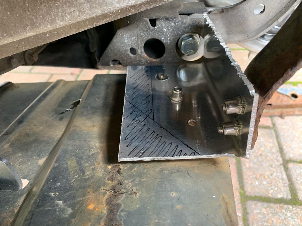

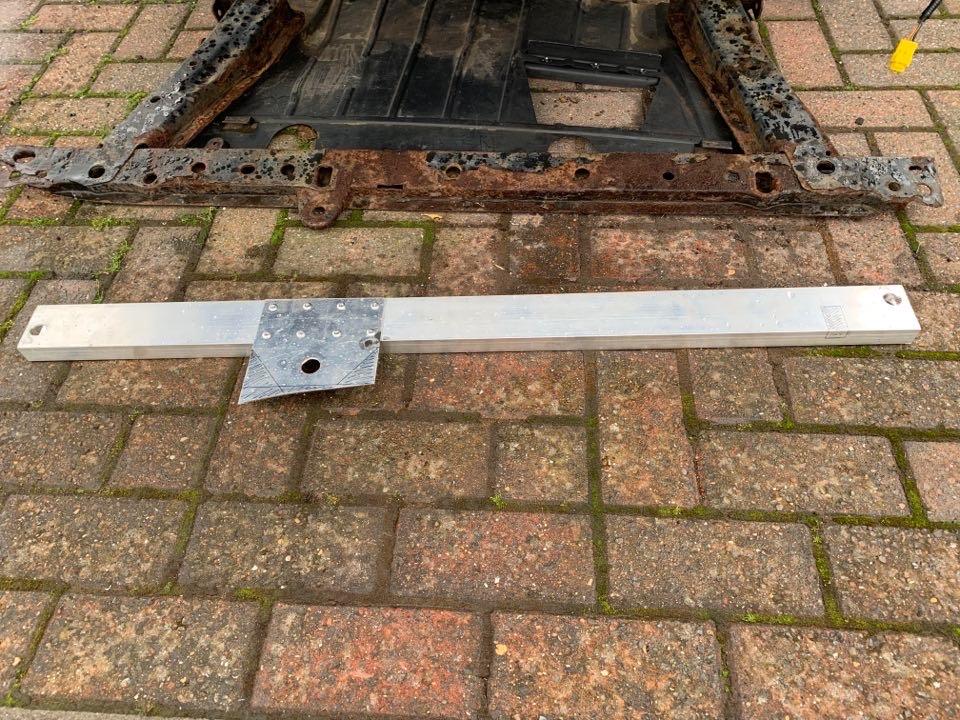

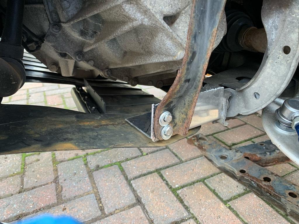

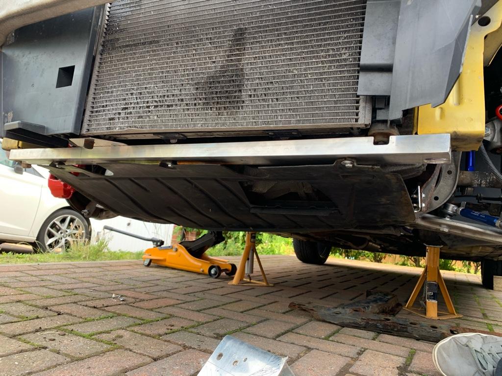

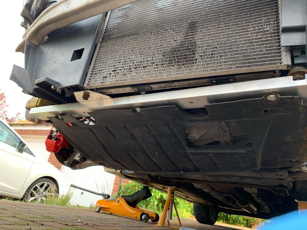

And I’ve almost finished my little fabrication project. Rad support front section made out of box section ally with a few bolt holes and rivnuts for the undertray. Rear sections for holding the. Back of the engine undertray almost finished just need a bit of excess metal removed and some edges tidied up. Pretty simple job if you’ve got some basic tools. Here’s some pics if anyone fancies copying.
