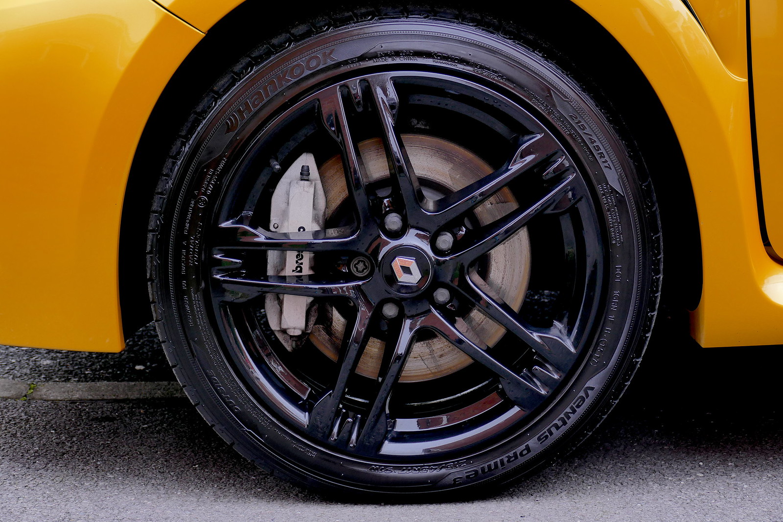

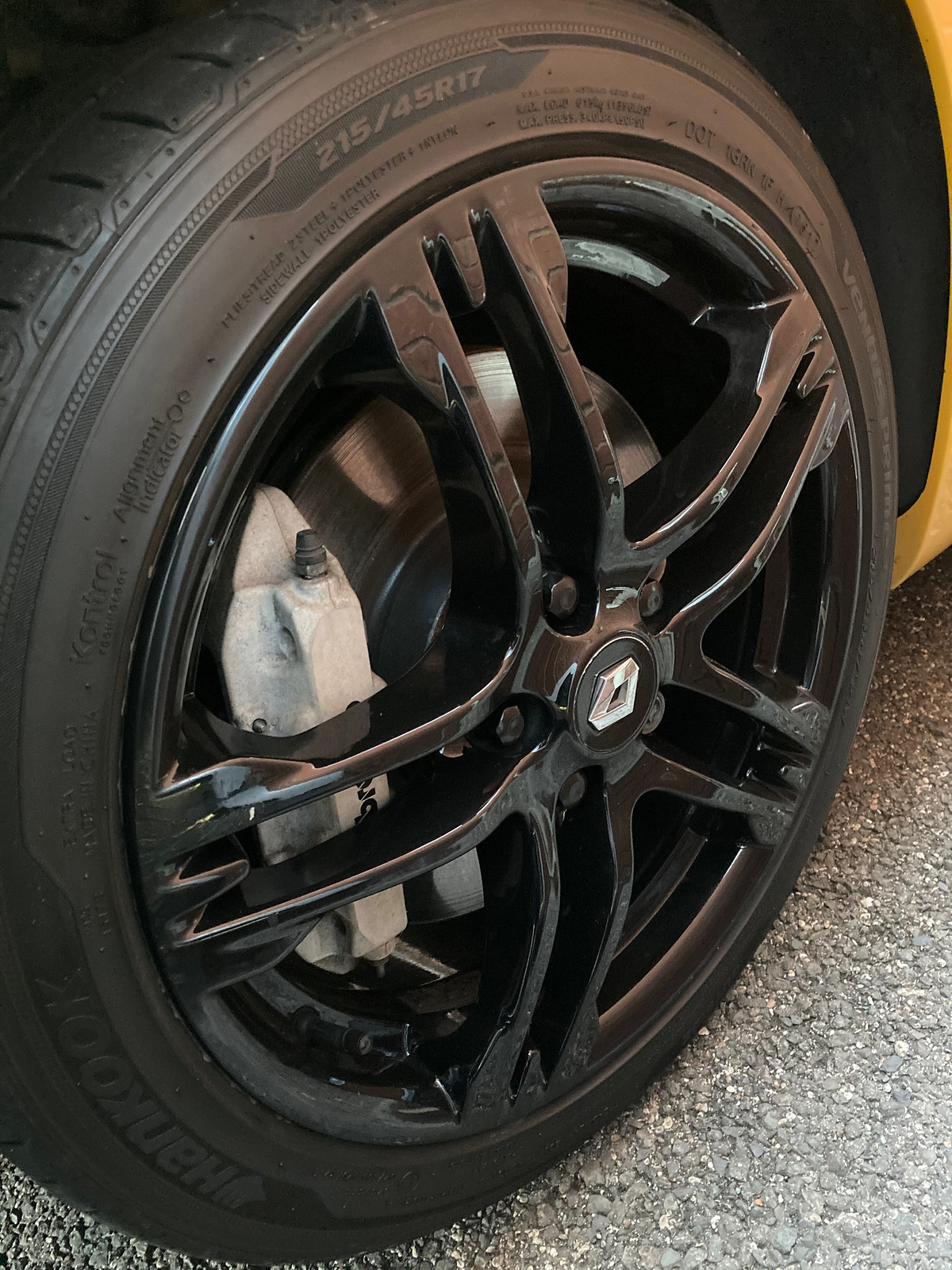

Just a little job I've been meaning to sort out for a while.
Tarnished wheel bolts!
Popped a couple of bolts out of each wheel at a time, degreased them, prepped with a sanding pad and cleaned with IPA.
3 coats of Hammerite satin black spray paint, then fit them at the end of the day :thumb:
A light coat of Optimoly TA to the threads before fitting, and I mean very light.
Torqued back up to 130Nm (140Nm seems awfully tight, and these bolts are identical to the ones on the Porsche and they're done up at 130Nm with Optimoly)

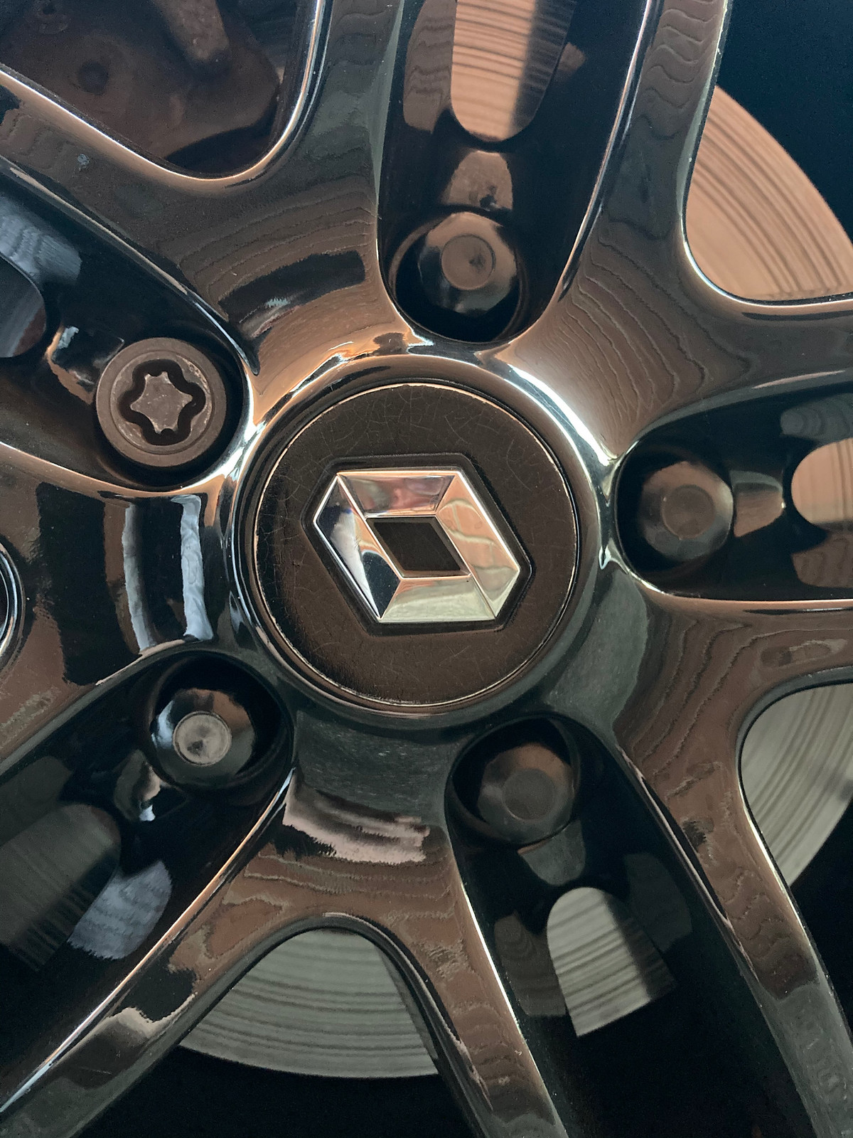

Pic below is A BIT CLOSE UP!! LOL :smile:
But you can see the 4 standard bolts have a nice black finish to them now
Black wheel nuts2 by *JMR*, on Flickr
Black wheel nuts1 by *JMR*, on Flickr
I haven't done the locking wheel nuts (and I only refit these back hand tight, a decent arm on the 1/2 ratchet will suffice, I'm scared of knackering the locking wheel nut key if they're on tooooo tight.
I will probably give these a waft over in the coming weeks.
Anyway - happy with them, wheels look much more presentable now, but has highlighted the fact that I need to re-paint (or replace) my centre caps.
I think the genuine Renault ones are matt finish though, not gloss?
And I'll have to take all the wheel bolts back out to get the wheels off to poke the centre caps out :unamused:
Looking good, next step black calipers with Liquid Yellow logos?
I'd like to clean up and repaint the calipers.
Probably just stay grey as they are, or tempted for red, but then it looks like I've got the Cup chassis, but I've not.
Thinking though, black calipers would look stealth particularly behind the all gloss black wheels :sunglasses:

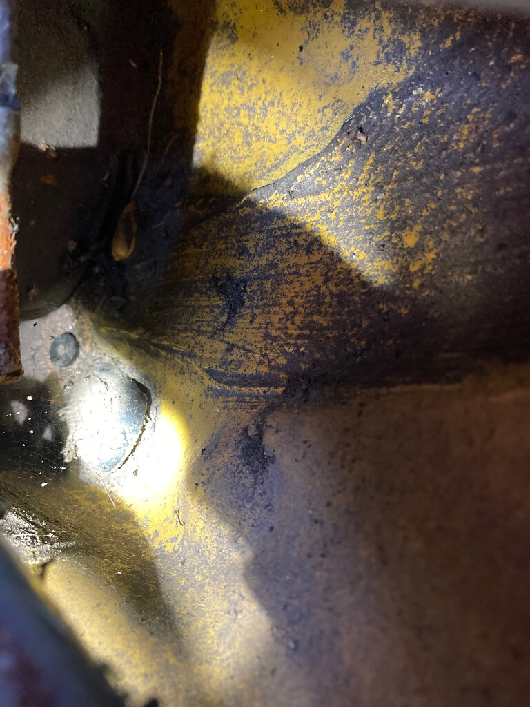

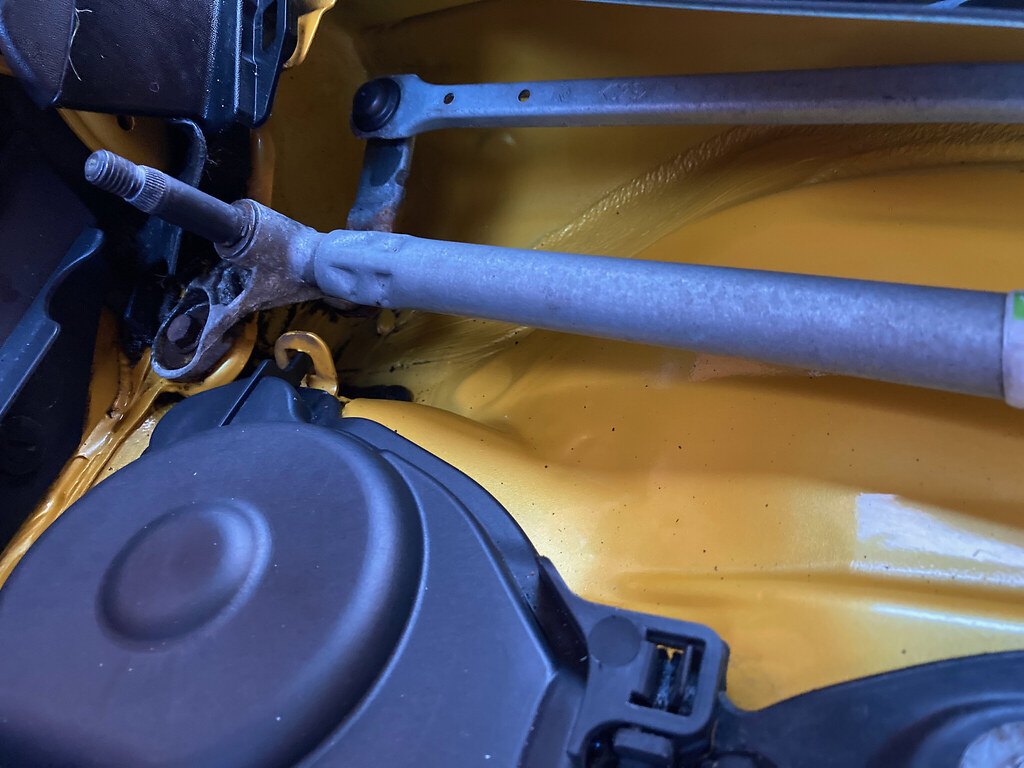

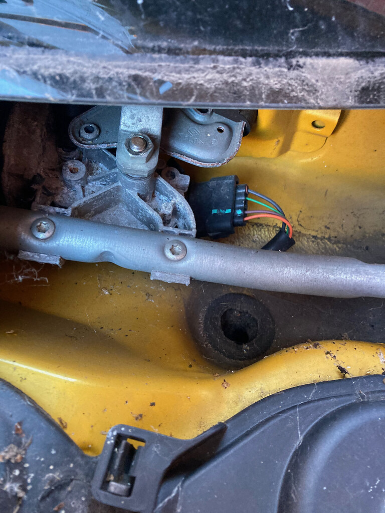

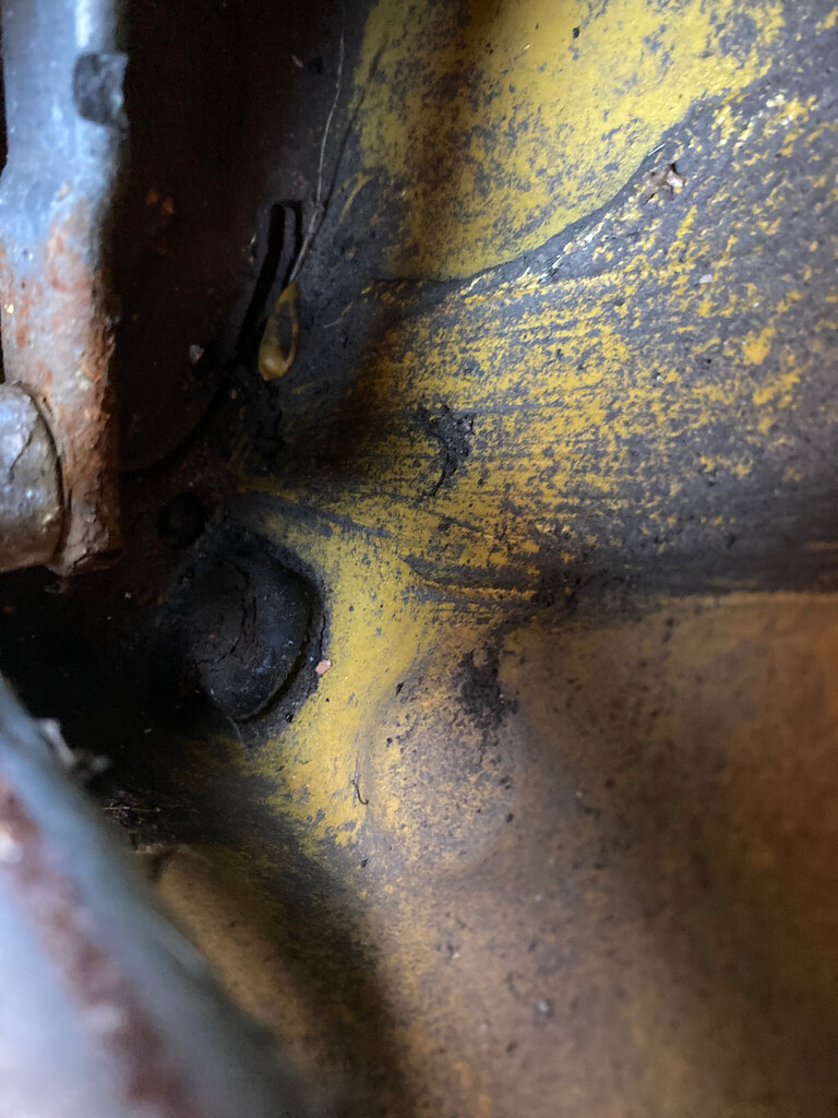

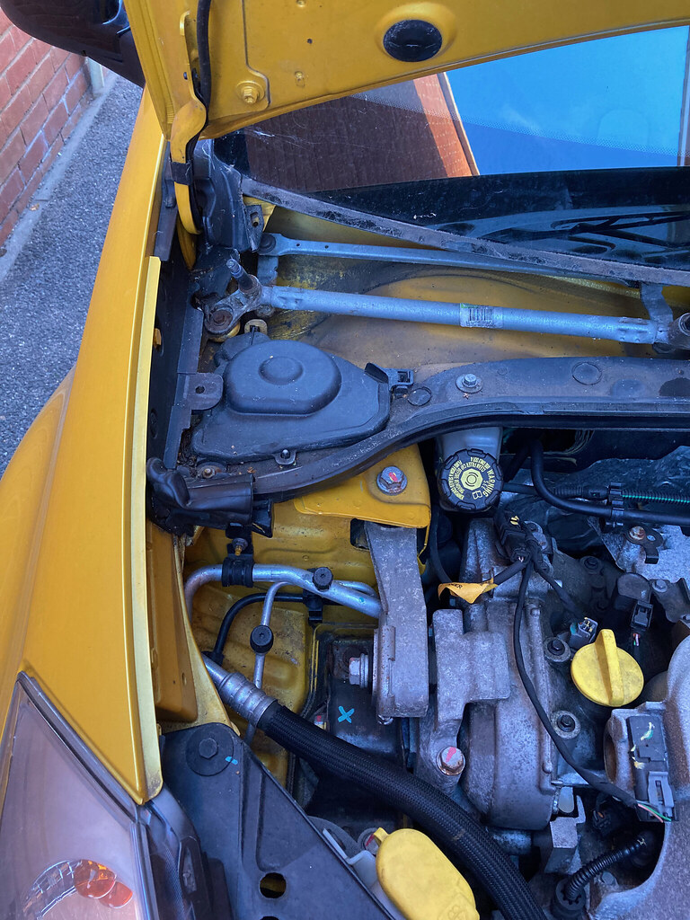

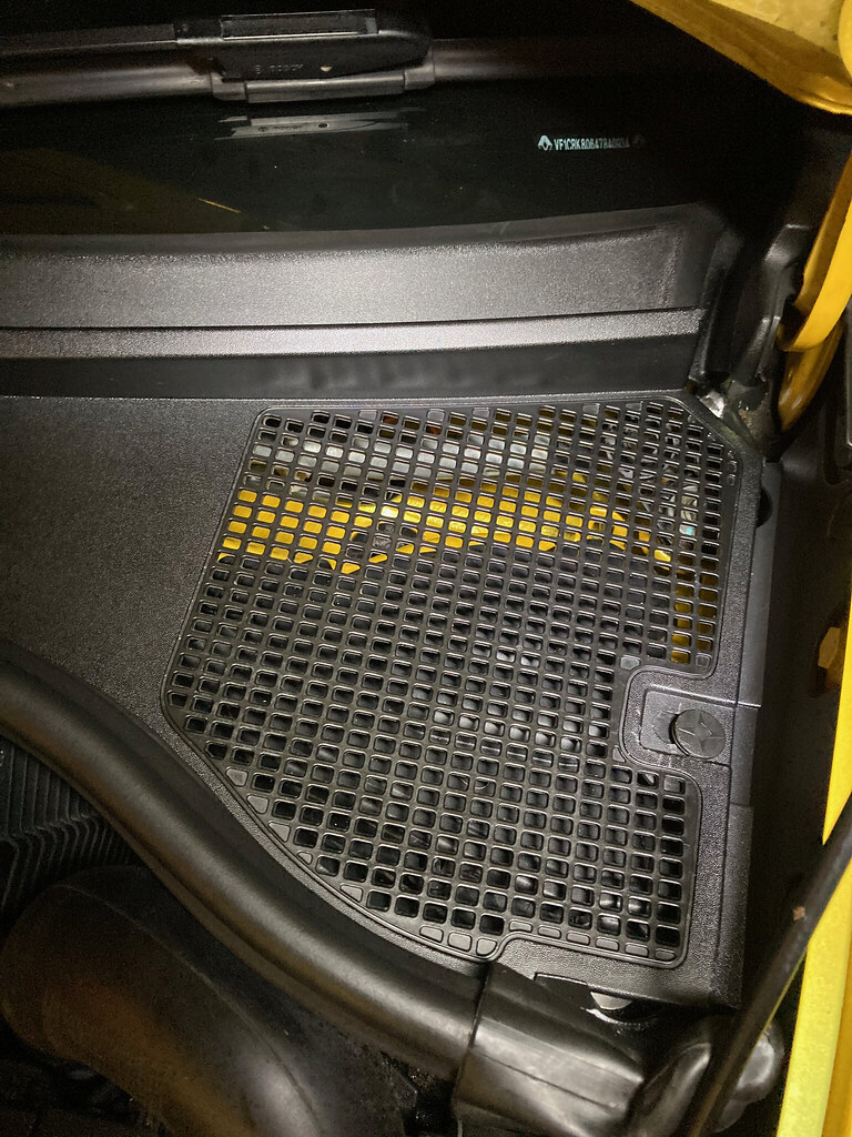

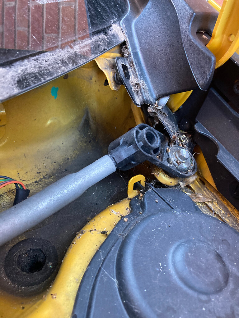

Little job I did at the end of November was cleaning out the scuttle panel drains.
I noticed that when I cleaned the car, and hosed the windscreen, I opened the bonnet and there was some standing water, draining slowly in the scuttle under the plastic mesh grille.
Thinking this is not right, I used one of the guides on here to address the issue.
Pics of my findings and after cleaning :blush:
On first removing the scuttle panel
IMG_4843
by *JMR*, on Flickr

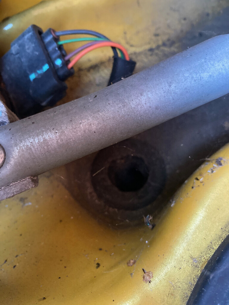

This was the side where I had the slow draining water. Drivers side.
IMG_4844
by *JMR*, on Flickr

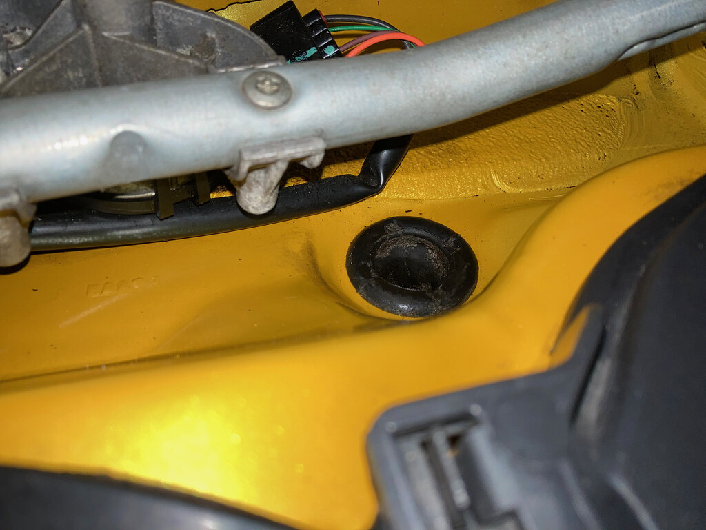

You can see the drain hole, where the little rubber plug is in the bottom left corner, a bit of sunlight shining on it.
IMG_4845 by *JMR*, on Flickr
Again a slightly clearer shot, you can see its full of crap. There's hardly any hole there to drain water out and down.

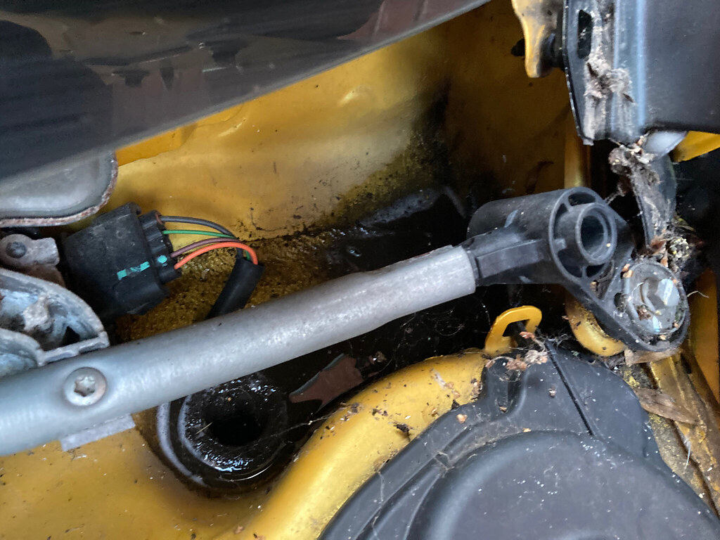

IMG_4846
by *JMR*, on Flickr

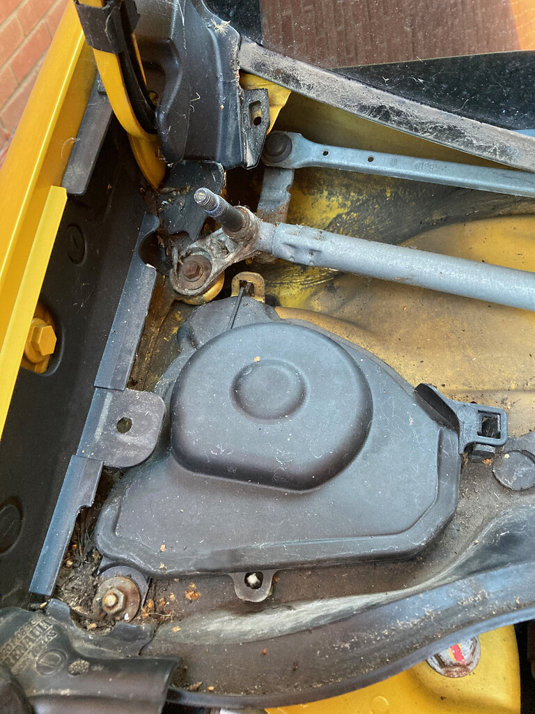

Passenger side didn't look too bad but you can see where the dirt and water has been sat.
IMG_4847
by *JMR*, on Flickr
Pretty messy, and overdue a bit of attention

This is the passenger side hole that need cleaning up
IMG_4849
by *JMR*, on Flickr
When I poured some water around it
IMG_4854
by *JMR*, on Flickr
I used a spray bottle, and took the plastic pipe off it and stuck that in the rubber plug holes to clear out any mess.
You could instantly feel it moving dirt out of the way and you could see the water draining down, and coming out under the car.

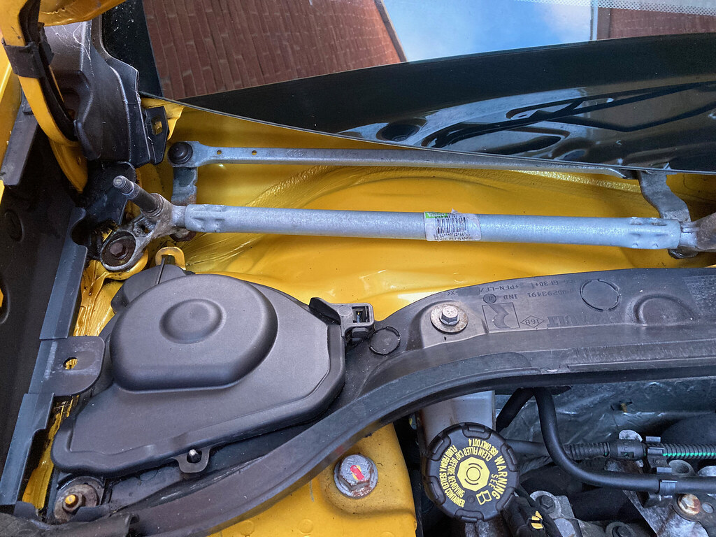

Heres the drivers side after a good clean with APC and a bit of polish
IMG_4850
by *JMR*, on Flickr
Miles better
IMG_4852
by *JMR*, on Flickr

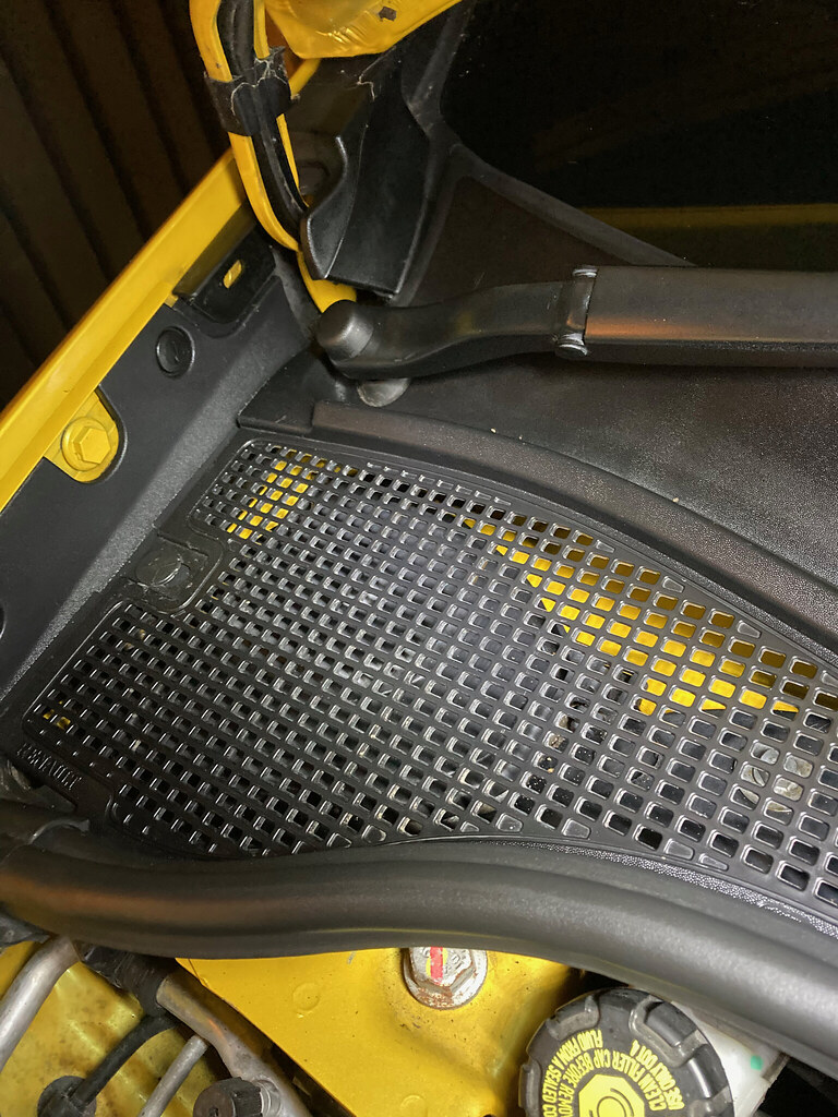

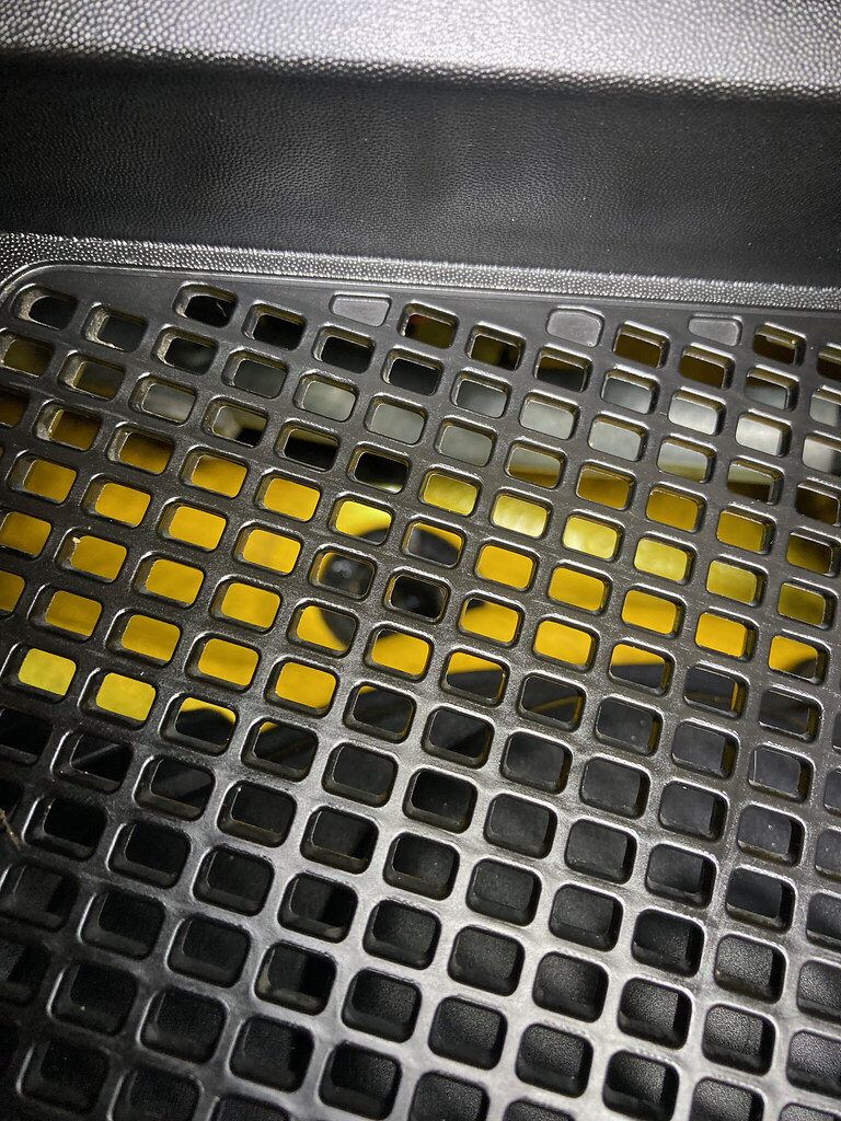

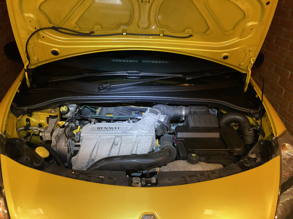

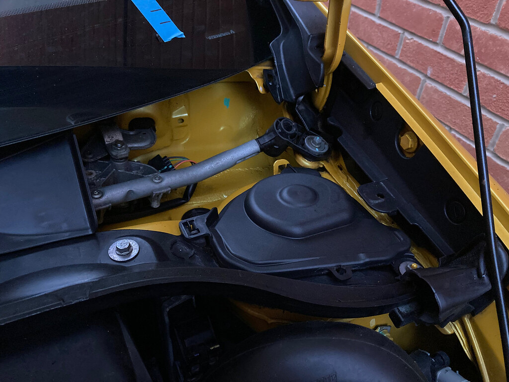

And scuttle and grilles re-fitted
IMG_4858
by *JMR*, on Flickr
IMG_4859
by *JMR*, on Flickr

Easy enough job.
Most difficult part was being careful removing the wiper nuts.
Drivers side was easy, passenger side was a bit stubborn.
No breakages though, and I put some copper slip paste on the threads so they'll be easier to get off next time if I have to do them again.
I've had the car 4 years and only done this once.
