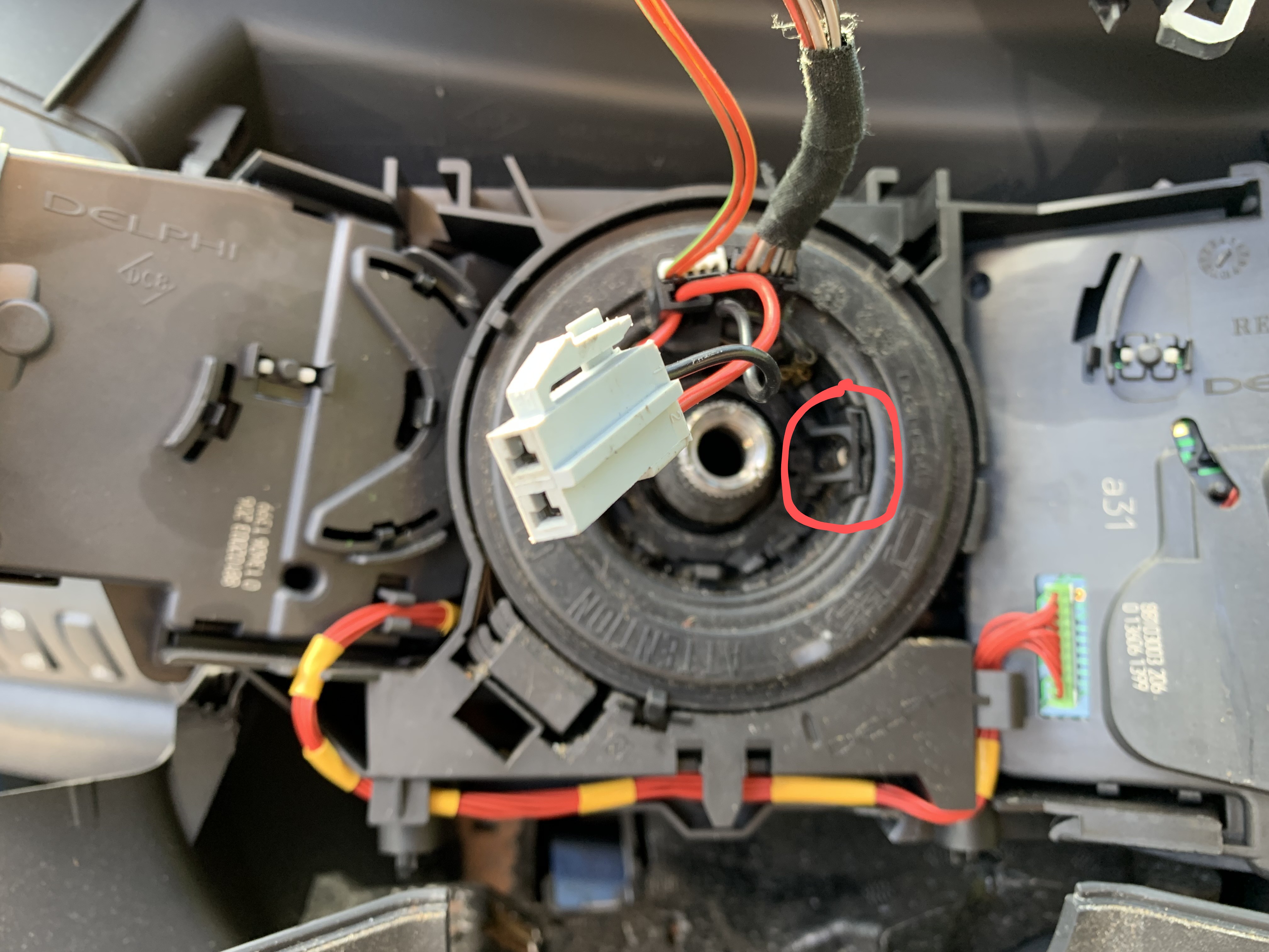

Before I put it all back together I compared the two steering wheels and what caused this problem with the damaged clock spring?
Noticed that the OMP-wheel is a little shorter and perhaps puts more pressure on the clock spring and damaged it that way or maybe just torqued to the wrong spec?
Anyway, hope to avoid this when I get my new clock spring.
Yeah I've made the same mistake on mine, I've fitted an aftermarket steering wheel with OMP boss and thought everything was fine as,you know,the boss is made to fit a Clio MK3 but it's crap.
If it starts clicking from the steering when you put everything back on don't drive it, you'll just break the squib ring, there should be no noise at all.
The standard steering wheel is made so that those "tabs" push on this part circles in red on the squib ring so that when it does it rotates freely,if this doesn't happen like with an aftermarket wheel boss then it will end up breaking soon enough, I've modified my wheel boss to make this work and it's been okay so far.
Reactions: Don Hogg
