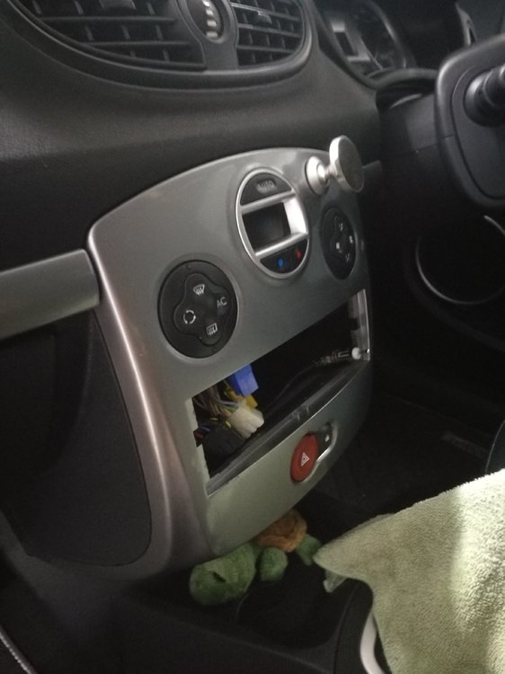

So i finally got around to installing the head unit I purchased a while ago as I had a bit of free time.
I had got all the connectors needed to make this a simple plug and play install and still retain the factory steering wheel controls.
The items are form Aerpro if anyone wanted to get them also.
I had watched a few videos on the internet on how to remove the standard head unit, and easily enough put some BBQ skewers in all four holes, push outwards on both sides and it slides out easily enough.
The hard part was disconnecting the plugs at the back which were really stuck in place.
all ready to go back in and also this head unit has microphone for phone calls, (not that anyone calls me........ so lonely........
I routed it to run up the
steering column and drilled a hole into the surround and double sided taped it into place. Seems to work well
After this, I thought everything would be a super easy install...............IT WASN'T
Trying to push the head unit back into place with all those new cables behind it, was something that i could not explain the difficulty of. It just would not go back all the way in.
After maybe 25 mins of swearing i got it super close and then BAM it clicked into place. Hooray!!!!! Then realised the plastic surround needed to go on before pushing it into place....BOoooooooooo
Out it came and the struggle continued on for another hour or so. I finally got it into place again, and downloaded the sony app which is pretty useless if i must be honest. But you can change colors of the stereo through it, so YAY??
