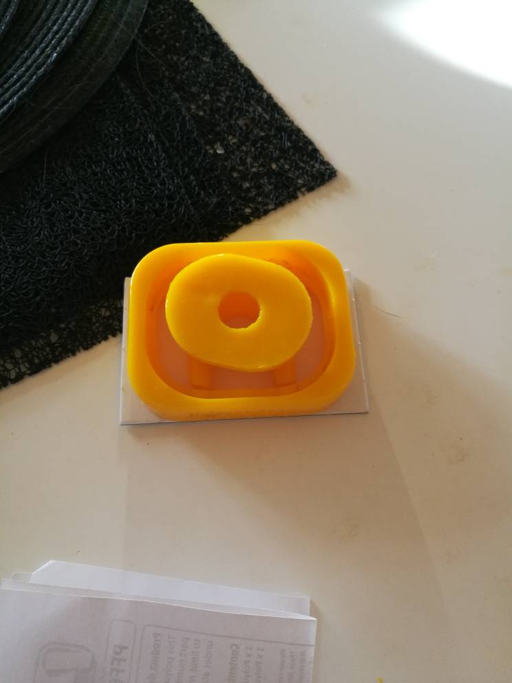

Got a rs gear knob as I really could not stand the OEM slanted one
Then got brake fluid and the lightweight crank pulley from Rene
Planning to do most of over the next month or so7135f810c74524fa4063ad831ffb7654.jpg60eef44be6b7f7a152b88be3bbdbe927.jpg397a3a9d0e0ee1eb1efa0e36315254a7.jpgfe896d1e78a290d09f6fdf7ea728cd94.jpgf45dfd3d44bd2504714dc40a19dadc80.jpg

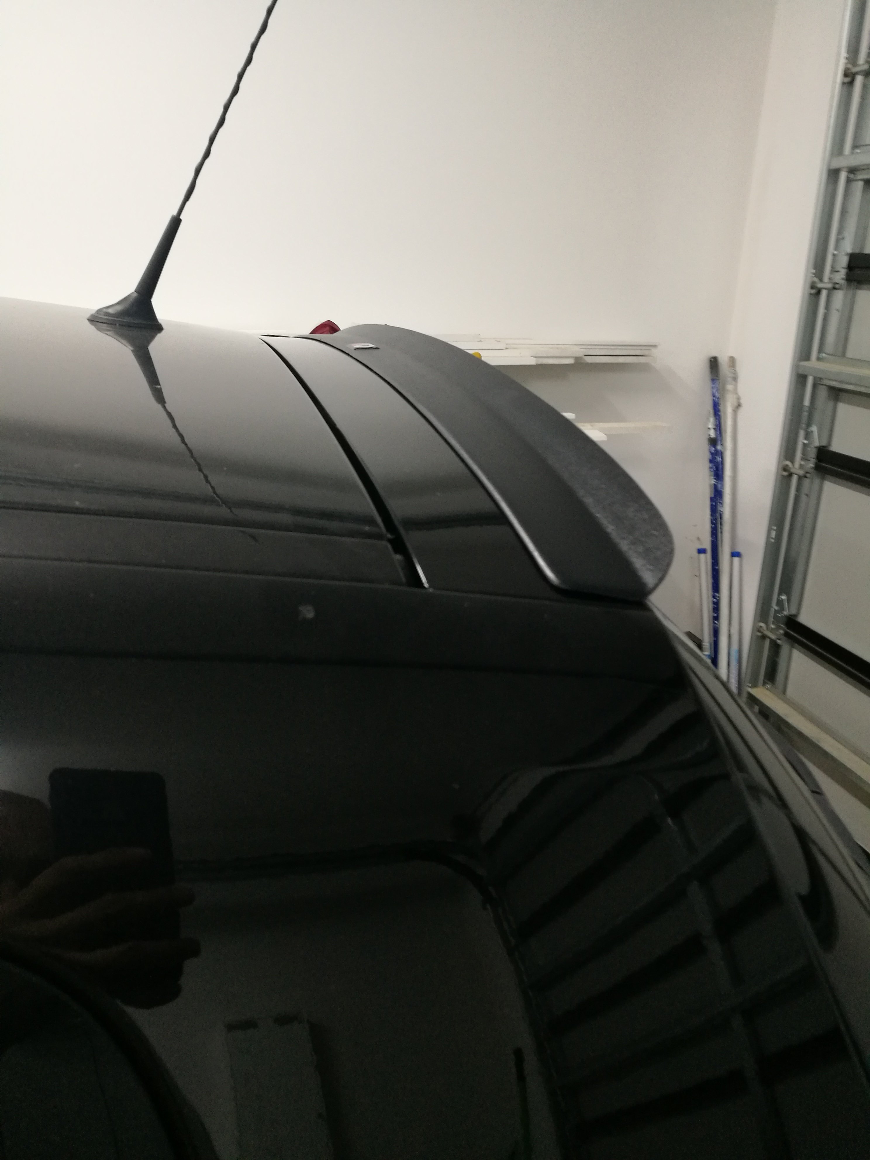

I also picked up a Maxton design rear boot lip spoiler, i always wanted the A1 gp rear boot lip but they dont fit sadly and saw this and ordered it right away.
IMG_20190525_163356.thumb.jpg.b03f1c54c6a7cb59ce65bf013923dd86.jpgIMG_20190525_163343_1.thumb.jpg.85aa7364905207ba06875db1878d7c70.jpg

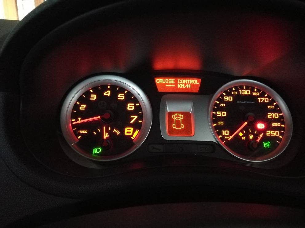

I had been noticing some weird things happening with the heater in my car on random occasions where it would blow out cold air and not warm air even with the temp set above 20.
I had asked around and from what i read the temperature on the clio 3 is supposed to sit on the middle line most of the time when the fans are on and off.
Mine was sitting on the second line and sort of stayed there, this hopefully means that the thermostat is stuffed and might help with the cold start fuel consumption also, which i noticed has been atrocious.
So i ordered a new thermostat from Renault and planned to fit it, bud sadly have been super busy and will be getting it installed next week.

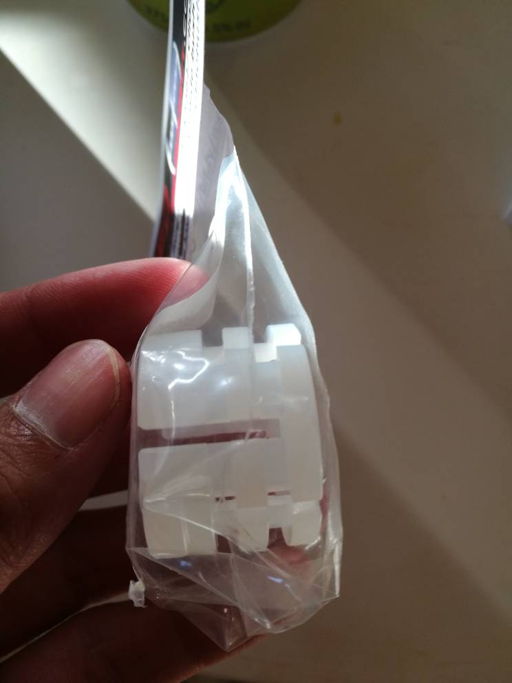

The other stuff arrived a bit faster than I thought it would.

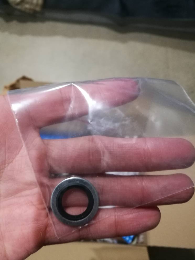

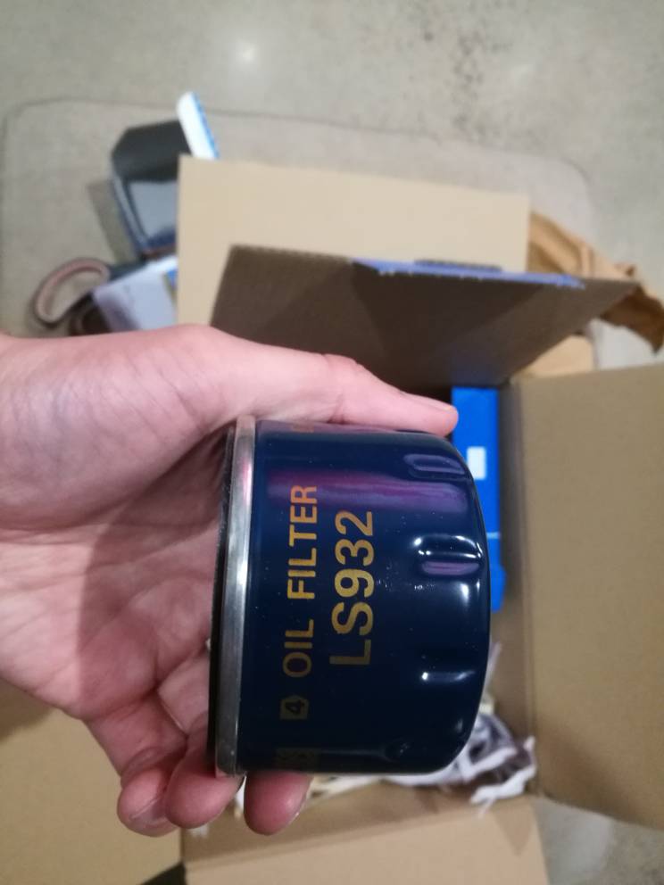

Got an oil change coming up, never noticed how small the oil filter was.
Got these parts from European Auto imports in box hill if anyone was curious. Postage was pretty reasonable also.
Guess it's time to start measuring up heights and set some time aside to swap things around.
Also the sump plug needs to be torqued to 22nm from what Google says if anyone wanted to diyc8665a05d6649e75d6e5dca88162b0a3.jpgeeb46d90e5dd78cc188e4cb8a2c640e8.jpg3d3e24d6d1dfad58c4e514f9f1dc8a1c.jpg2686340a356c226ea19ec6c34861764e.jpg

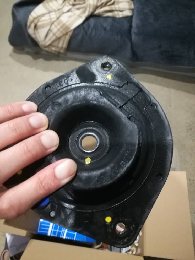

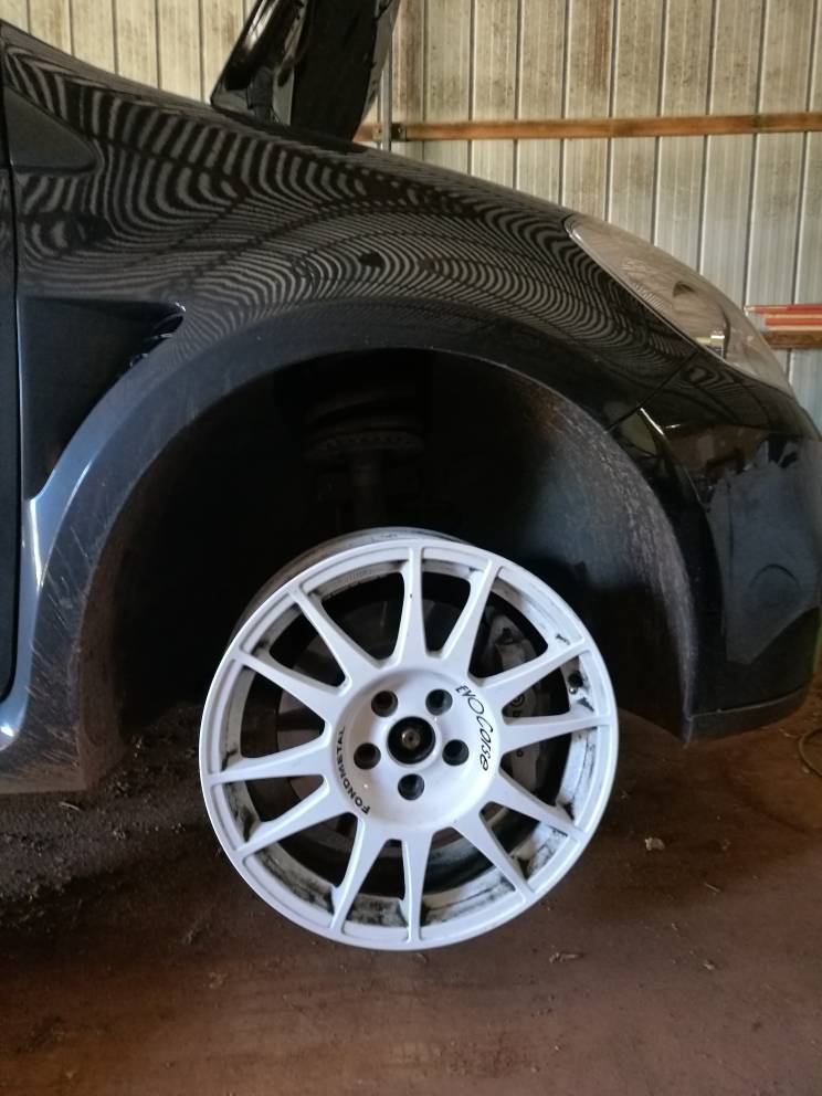

I set aside a Sunday to attempt to install the coil overs after doing lots of research on the internet about methods and reports. Most people said they had major issues with the fronts and could not figure out how they came out. From pictures and looking at them myself, it looked pretty straight forward but might need to compress the spring on the car which i was a little worried about due to safety of the spring compressors flying at my face.
The rears were standard fare and is relatively pain free to change over.
I started with measuring the standard non cup heights. I measure from the guard down to the bottom of the centre cap
FL 38.5cm FR 38.5cm
RL 40cm RL 30cm
and then got to taking the boot trims apart to start the process

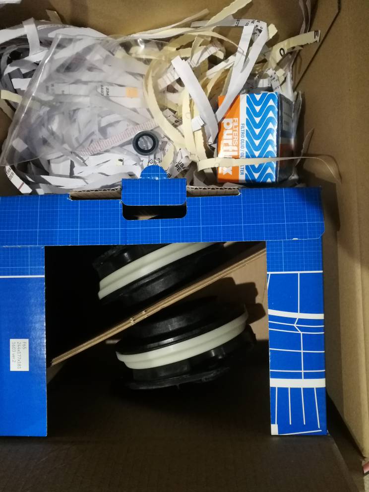

rear spring and adjuster
installation instruction
i did not take many photos past this as it was pretty straight forward installation wise
i set the hieght to the maximum on the adjuster and hoped it would be similar to Cup 197 ride height which is 7mm lower front and back capared to the non cup.
Low and behold was a full 2cm lower in the rear with the adjuster set on high. hahah
i then set about doing the fronts but with the mindset that if i could not do it easily i would not stress and take it to a shop, as i had to use the car the next day to go to work.
Removed the scuttle panel and gave the wiper linkages a bit of spray lube and cleaned the drains again since they block easily
I then started removint the sway bar link and a few other things and then dropped the hub as far as it would go. I then applied two spring compressors to the spring a few times trying to get the best approach to it.
Then BANG, one flew out and missed my face. I lost confidence and cared more about my safety and decided to put it back together and take it to a shop.
I took over 1 hour to put back the three things i removed, such a pain.
