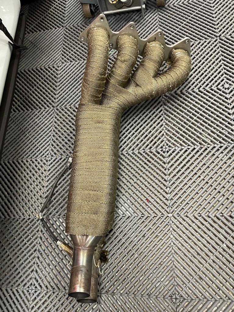

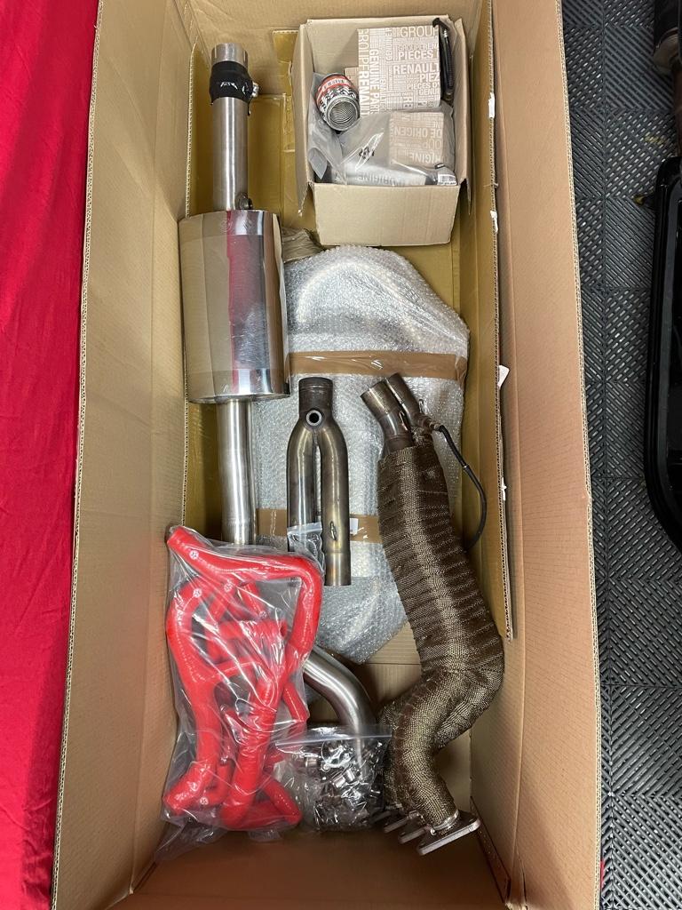

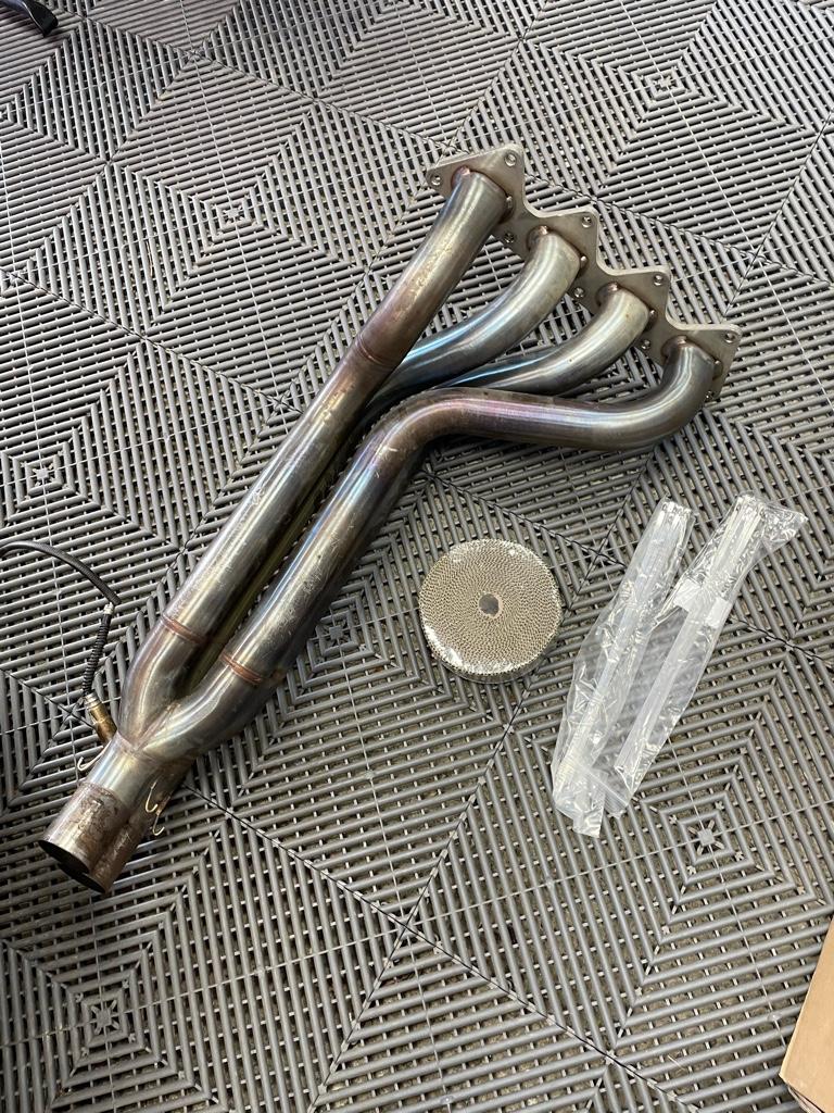

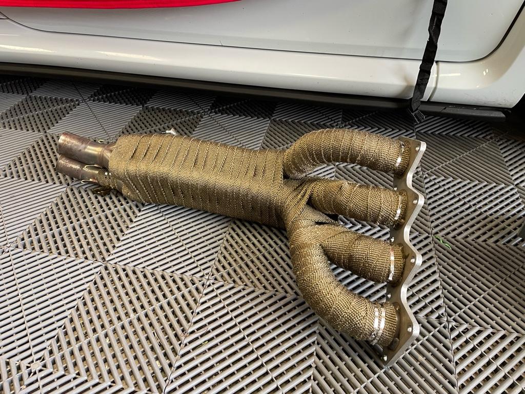

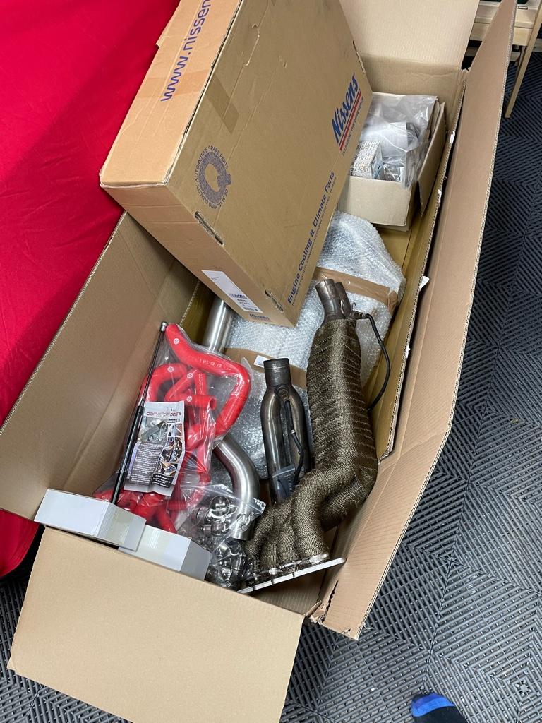

I’ve acquired all the bits of the Pure Motorsport exhaust system, I got the manifold, y-piece, resonated mid section and 200 rear section.
I went ahead and heat wrapped the manifold which is a bloody awful job, my hands and arms were itching for days. I’ve since swapped out the metal cable ties for jubilee clips which fit much better.

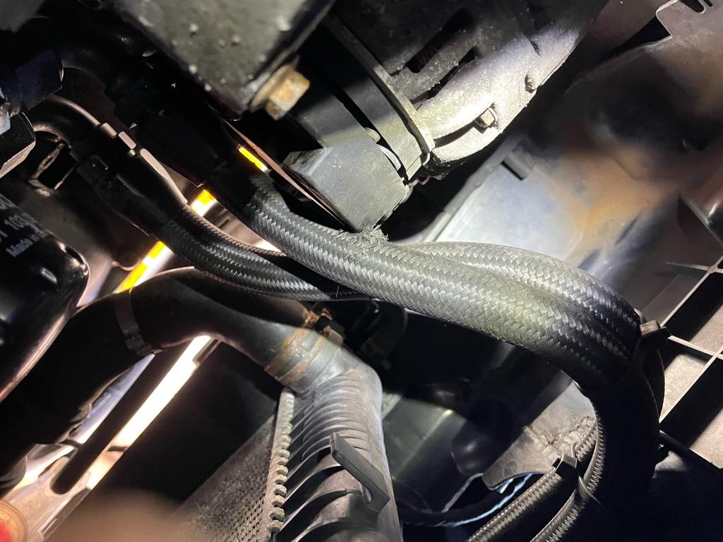

First up was the AN10 oil cooler line that has been rubbing on the edge of the alternator housing. It’s only the external braiding for now and the pipe is still in tact but I’m replacing this length of hose as I can’t risk this letting go on track for obvious reasons.

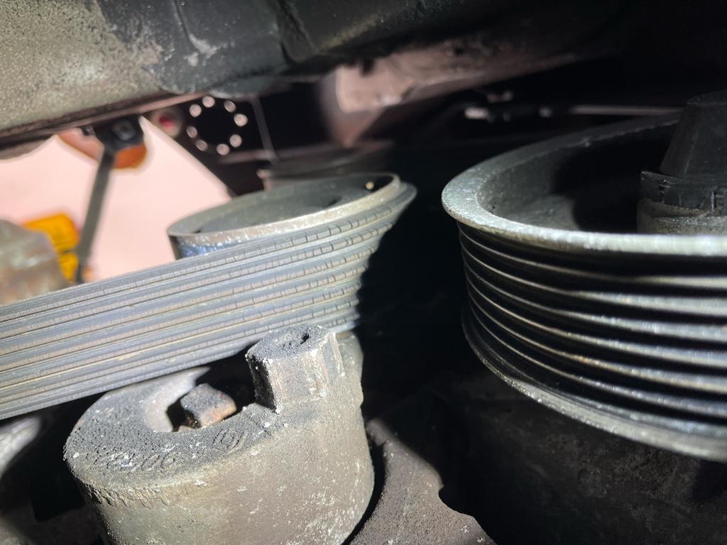

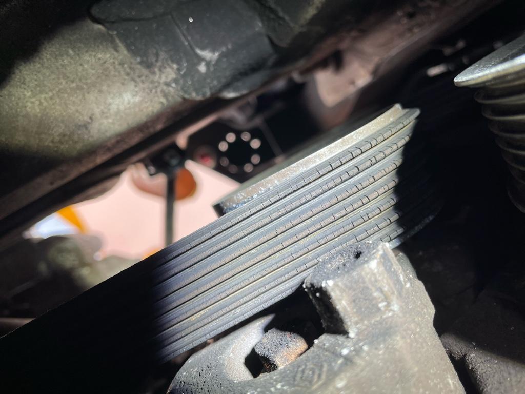

I also saw that the auxiliary belt was looking dried and cracked and actually has a small hole in it where a stone looks to have punctured it:

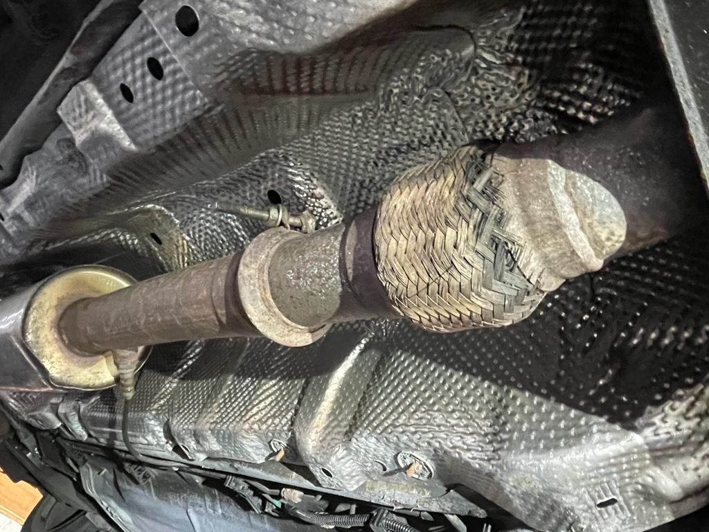

Then there’s the failed flexi joint from where I clobbered the exhaust on the trailer:

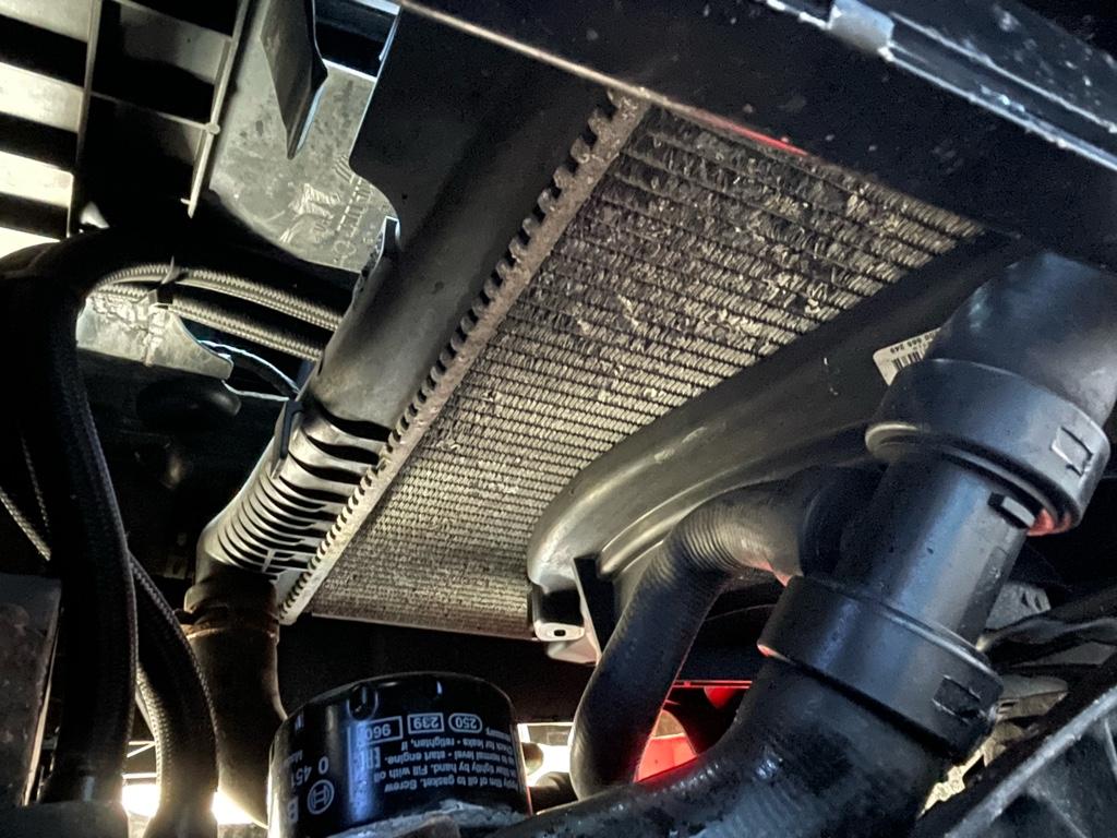

The radiator fins were starting to crumble and look a bit second hand. It’s the original and hasn’t been changed so I’ve got a new Nissens radiator to go on.

Today I dropped the car at my mechanic with the big box of bits.
The job list is:
- Drop subframe and remove eBay manifold and exhaust system (probably Toyosport) with blowing flexi.
- Weld in new flexi (this system will be up for sale soon)
- Fit PMS manifold and full exhaust system, with new OEM Renault exhaust manifold gasket.
- Cambelt, aux belt and tensioner replacement.
- Replace radiator and all cooling hoses, new coolant.
- Replaced frayed oil cooler line with new AN10 hose, re-route away from alternator housing.
- Re-tap Coil Pack #4 bolt thread as it is loose.
- Spanner check ready for track.
I’ve also been thinking that the metal heat shield that sits between the diffuser and the rear silencer is a bit overkill and has started to rattle, so that’s going in the bin, will be replaced by fibreglass heat shield on the back of the diffuser and diffuser bolts will be replaced with stainless.
