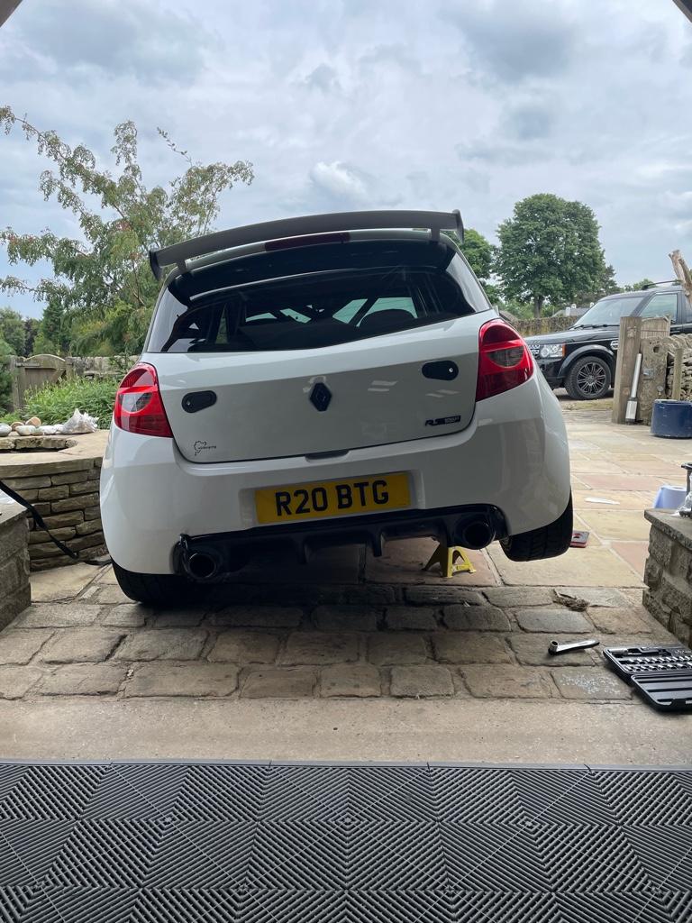

Finally caught up on some post-Nurburgring maintenance.
- Replaced the horns as one wasn’t working and it sounded like an asthmatic granny.
- Took out the glove box and retrieved the GoPro power lead that had fallen behind the dash (hence no passenger cam footage from Germany). Tidied up the GPS data logger power cable at the same time.
- Engine oil and filter. Filter was on way too tight and my wrench didn’t fit it. Resorted to the classic ‘hammer a screwdriver through it and get warm engine oil all down my arm’ technique. Oil was pretty black considering it’s only done 2 track days (Croft & Nurburgring).
- Replaced all rear caliper bolts with some high tensile ones. This is because one came out and one was finger tight in Germany. I had to bodge it with a bolt from R4R and some washers. For anyone using the search function in future these bolts are M12 x 25mm with a 1.25 extra fine pitch. The 3 OEM ones are now in my spares box.
- Gave the tyres, brakes, wheel bearings and EE brackets a once over visually. Virtually no wear on the MRFs.
- Renwewd all wheel bolts with black ones, as they were looking a bit scabby. I’ll probably renew the studs another time.
- Washed all the dead flies off.
I was going to drop the gearbox oil but couldn’t quite locate the fill plug by eye. Might wait until I’ve got a second pair of hands available. Does anyone know if the battery and tray need to come out to get to the gearbox oil full plug or can you get hands to it in situ?

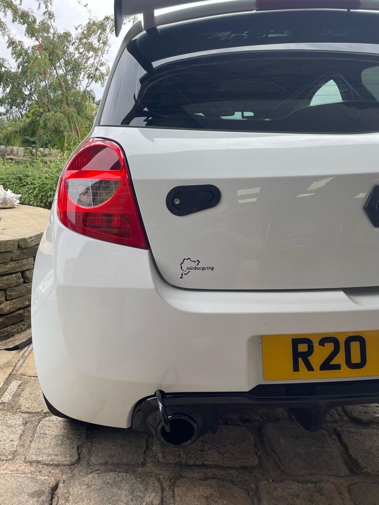

Also, put on the sticker…

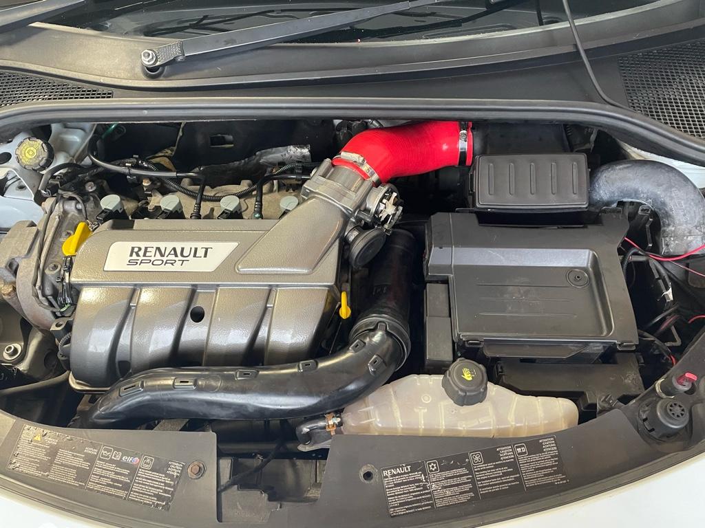

Quick update, I met up with [mention]Beany [/mention] and he kindly gave me his OEM airbox setup with BMC filter. The KTR has a nice deep induction noise but the location towards the back of the engine bay means that it’s going to be sucking in warm air. The metal shielding might protect it from radiant heat but it’s not enclosed meaning that hot air will get in there.
I put all the plastic bits in the dishwasher and gave the filter a good clean in hot soapy water. The red KTR hose is a nice touch.
I’ve already got a buyer for the KTR, sorry folks.
I do feel like mine was slower once I went from standard to KTR, I did have a brand new ITG panel filter in too.
I'm tempted to go back to standard but it sounds really good and does a few HP really make that much difference?
There's no way Renault developed the car and air intake system only for an open foam filter to increase performance, it's defo just the noise. I agree it sounds good though.
I went from a stock air intake to a K-Tec intake and then to a V6 box.
I did not really notice much of a power change with any of the intakes. I liked the noise of the K-Tec system but it was also nice to be able to hear my exhaust when I put the V6 box in.
Whilst it didn’t feel too different, but before I had the car stripped you could hear a difference at high rpm between the standard air box vs the V6
but since having the car stripped it’s all just loud noise now,
My car came fitted with a Ktr by the previous owner. It sounds good, so im happy to loose a few bhp in the summer as its a track day car and im not competing.
Although I doubt any of us could actually feel a couple of bhp using your bum dyno

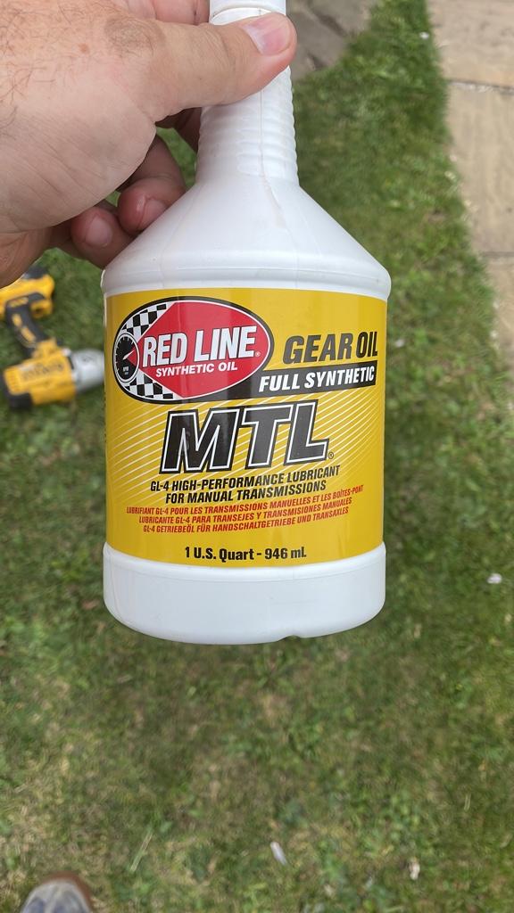

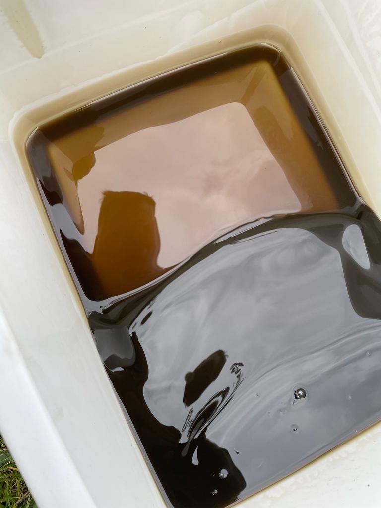

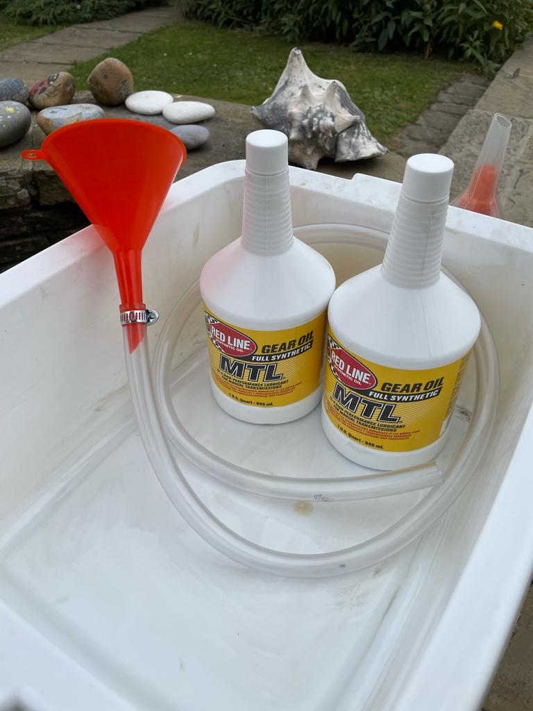

I wanted to change the gearbox oil after it was rebuilt by Ben, and then some hard mileage put on it at the Nurburgring.
Made myself a little contraption out of 1m of clear silicone hose and a funnel and roped in some help from a mate.
Oil was a little dirty, I sent it to a couple of pals for a second opinion. No metallic glittery bits so I think we’re good.
This is the crucial bit afterwards… putting the oil back in.
After hearing some recommendations I’ve gone for Redline MTL 75w80
