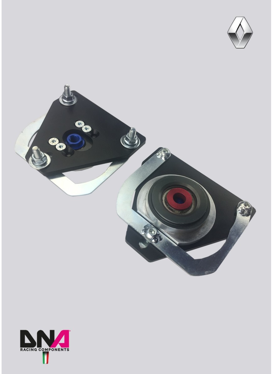

Looking at the mounting bolts for Pure Motorsports Clio 3 RS Adjustable Front Strut Top Mounts (allowing extra 1.75 camber as mentioned), it seems that it accommodates for both early & late Clio 3 RS, doesn't it? Plus, they provide a fitting option of that goes with Bilstein B14 which I'm currently having in my Megalio
what do you thing guys?
I’d say that is the castor adjustment you’re referring to.
Yeah you are right as by using the alternative stud mounting holes so the top mounts can be moved backwards, you will have 1 degree of caster to play with. However, my question was driven by the pattern of these stud mounting holes. I thought for a minute they can be used to fix this top mount on late Clio 3RS.
guess my hope just vanished :sweat:
Says they fit both late and early style on the website.
I would get a set. They look well designed

Since I'm running with solid mounts at the front wishbone & Compbrake top mounts at the moment, I'll be testing adding Power flex (801GBLK) camber adjustable - Track along with my current B14 and see!
The camber bushes add around 1-1.5 degrees. I installed some on a friends car, and they seem pretty good.
I was worried they could move, but they’ve been fine for a number of trackdays.
