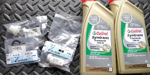

During the trackday I noticed a couple times mid session it would be difficult to find a gear, mostly second when downshifting.
After a bit of research it turned out a couple others had found this with 75w80 redline MTL and they'd found Castrol syntrans 75w90 to be a lot better. I also thought it might be that the slave needed bleeding potentially?
Went about ordering Everything I needed:
- 2L Castrol Syntrans 75w90
- Gearbox sump plug and washer
- Gearbox filler plug and washer
So this morning I drained the old gearbox oil which had only covered about 1k since the gearbox swap and it was actually quite dirty, think this might be due to the gasket stuff when sealing the box up? Either way I was shocked at how dirty it was. And weirdly after managing to get both bottles of Castrol In (albeit with a little overspill) the old redline stuff only filled up about 1.5 of the Castrol bottles, so not enough for what these boxes take? Which I found weird.

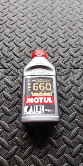

While the box oil was draining I decided to bleed the clutch slave, with RBF660.
Can honestly say the gearbox feels so much better, and if felt good beforehand! Changes are so smooth even from cold.
