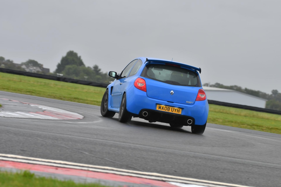

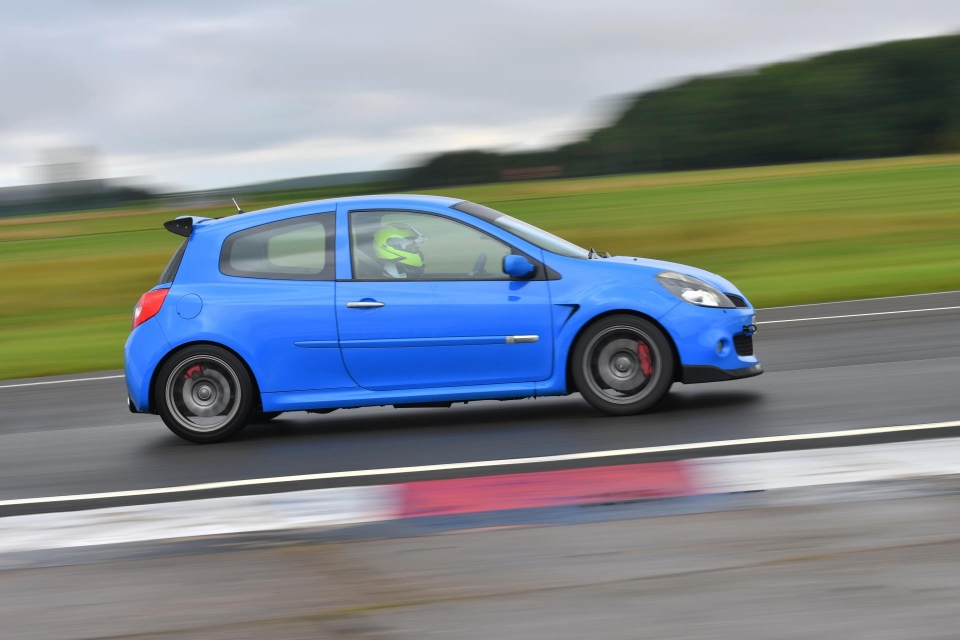

How low does it hang? I will be mainly tracking it so more worried about kerbs that anything.. I will probably keep the standard Manifold so will hopefully sound good
The light weight is a great bonus, helps offset my love of food
You can just about see it on the pictures of my car. It is quite low, but not an issue for track use I wouldn't think. I don't think it helps that I have a predator manifold on which a few people have commented on having fitment issues with too. I haven't really noticed a major issue with mine but my centre pipe is at a slightly funny angle. Only ever catches on speed bumps if they're quite high/uneven patches of road or steep angles. Mostly like driveways. Then again the car is also lowered so that doesn't do it any favours

Your car looks mint! The exhaust does look a little low but more that manageable..
Yeah I heard it weighs nothing, being a single exit will make a big difference. Have you had any issues with noise on track days?

Cheers mate. Exactly that yeah. I've been tempted to take it to a proper exhaust place and have it modified slightly
Yeah it really does, no flatspot from this Oreca system either which is a bonus
No issues so far with noise. Done Bedford twice & haven't been flagged, that's basically the strictest track you can get on too @ 87.5db driveby
