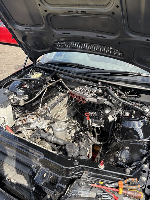

MK60E5.
Will document a few bits of this which I have found out along the way.
I am using - 6789303/6789304 - This is from the 6 cylinder E9x Models, It is important that all the parts used are from the 6 cylinder variants, I found this out the hard way again.
With some help of a friend we have experimented with flashing to M3 software but had an issue with a pump losing some inlet valve calibrations and being unable to rerun the calibrations with a 5DD0 Fault code which I was unable to clear on one unit, I bought a spare unit and just left it as the standard 6 cylinder firmware and updated some of the onboard settings using tool32.
Once I have used the ABS with the standard software I will update it to M3 in the future.
Sensors are front wheel speed sensors from 3.0 versions - 3452670424 - The white plastic gives them away as being 6 cylinder versions.
Originally I ordered the following Yaw sensor, the internet tends to say these are compatible with all model of pump - Guess what they're not!
The following is for Pre LCI but also appears to work with an E92 M3 pump too
676269-04
The correct Yaw sensor to use with a Post LCI unit as documented above
6850375
This later Yaw sensor uses a different style plug too as well as a different pin out
4 Pin Yaw Sensor
1 - Yaw Sensor Ground
2- Can Low
3- Can High
4- Yaw Sensor V+
With all that sorted and no more fault codes in the system other than missing data like the E90 instruments, Canbus messages and steering angle It was back to the mechanical side of things

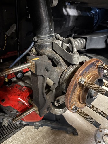

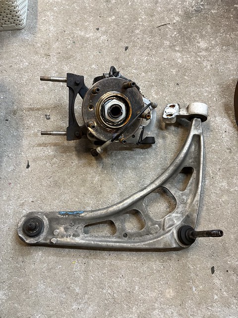

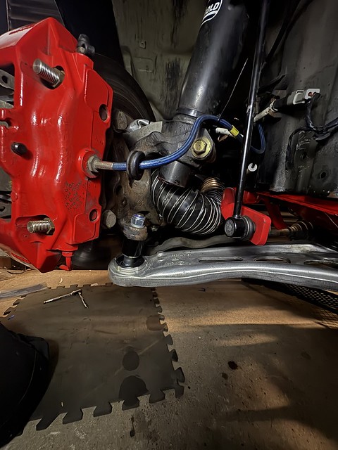

I wanted to get the sensor wiring as far away from the disc as possible.
Ground away some of the plastic which wasn't needed where the wiring went into the sensor
Added thick heat proof sleeving rated for 400+ degrees
It is close but no issues so far at the time of writing this I have tested it and no effects from heat at the moment. Going up to E46 CSL discs would create more space here which is an option for the future

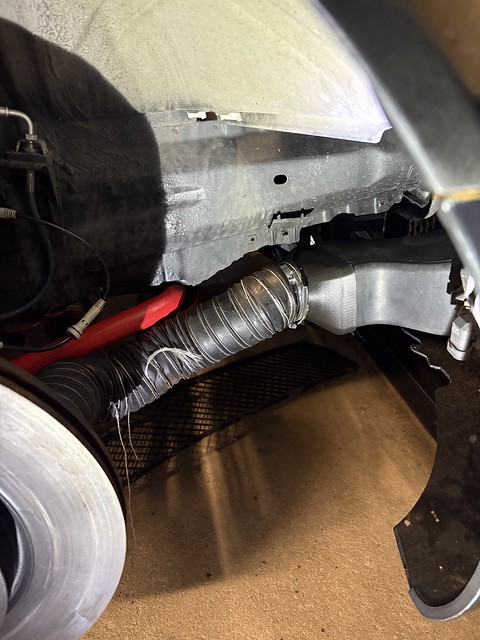

One important part of keeping these set up working is going to be cooling.

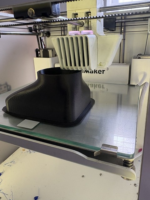

I have refitted the 3" brake ducts from the front fog lights to the front of the hubs

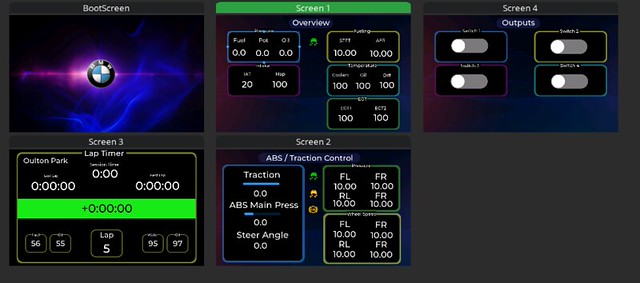

While on the topic of the E5 - Screenshot of a log from Oulton this weekend just passed.
Brakes going into EBV - Brake biasing when the rear wheels are reaching their limit of grip.
If wheel slip is detected on the front wheels then it goes into ABS
Overall the feel of the ABS is very good, no pedal feedback which was my biggest issue with the standard MK60 from the E46.
I was getting to grips with the brakes again at Oulton at the weekend and if anything over braking for corners but with a little more seat time I will get used to how late I can brake as well as getting used to how hard I can press the brakes, still only hitting just over 1000psi on braking, once or twice I hit 1200psi without any wheel slip or ABS it's just getting used to it again after years of having no ABS.

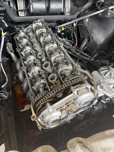

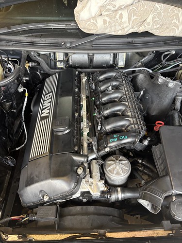

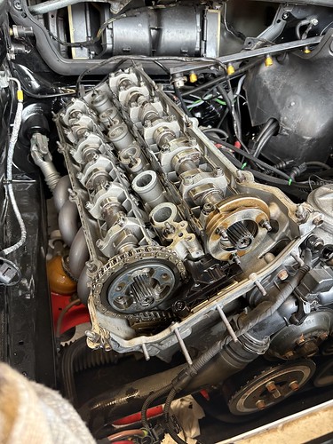

Pulled off the new tensioner I fitted at Cadwell Park last year when the bolts snapped in the block and replaced it for a S54 tensioner and idler, if it's good enough for 8k revs on an S54 it'll be much better for this engine.
Hopefully proves to be more reliable and pass the forces from the belt to the block more effectively with the larger clamping area an 3 bolts
With this tensioner you need to run the idler at the top near the alternator to take up the slack in the belt that's created with this tensioner being in a slightly different location

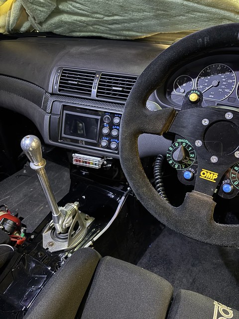

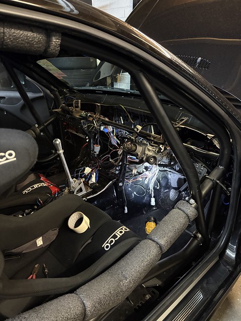

Interior - No major changes - Just been working on ensuring the instrument cluster works correctly
I have set up the Centre ABS Light to work with the MK60E5 to light up when there is an ABS fault
Speedo working correctly using one of the wheel speed outputs from the E5 directly to the cluster as it uses a PWM input
Red and Yellow ABS lights disabled.
