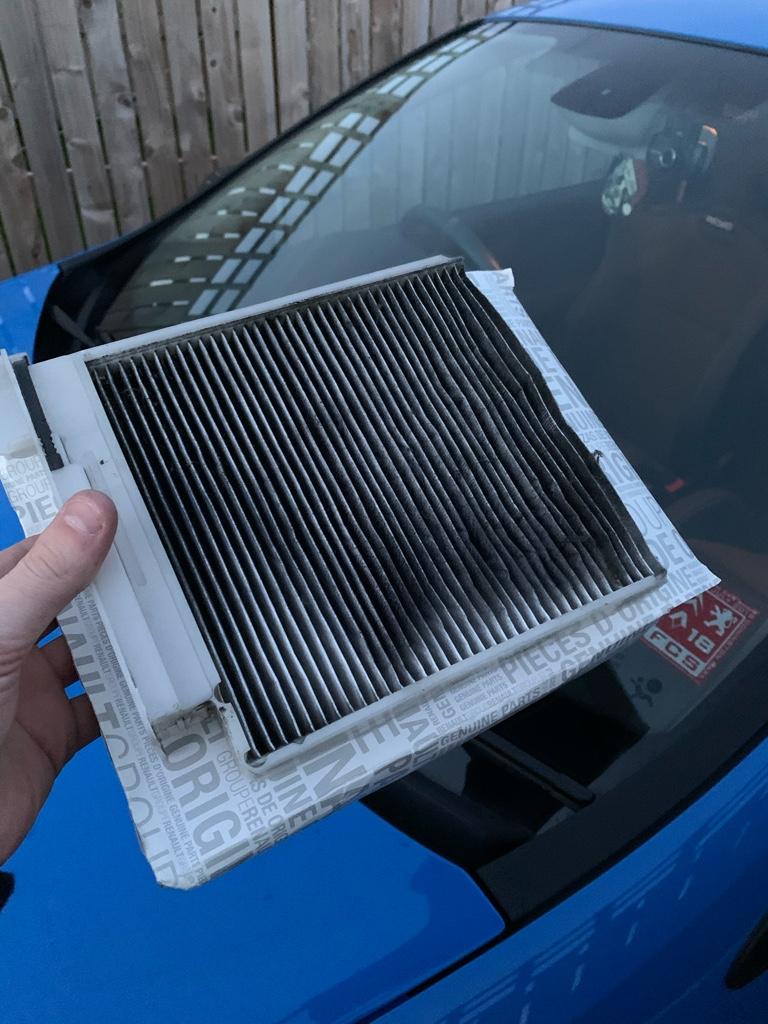

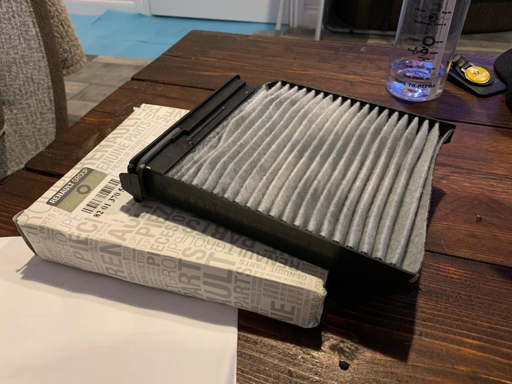

A touch dirty but not massively. Looks worse than it was however, replaced it for my own knowledge. I like to get everything checked off so I know myself when it was last done!
Old Pollen Filter out and new one in, unfortunately didn't get a picture of a tree worth of leaves in the footwell!

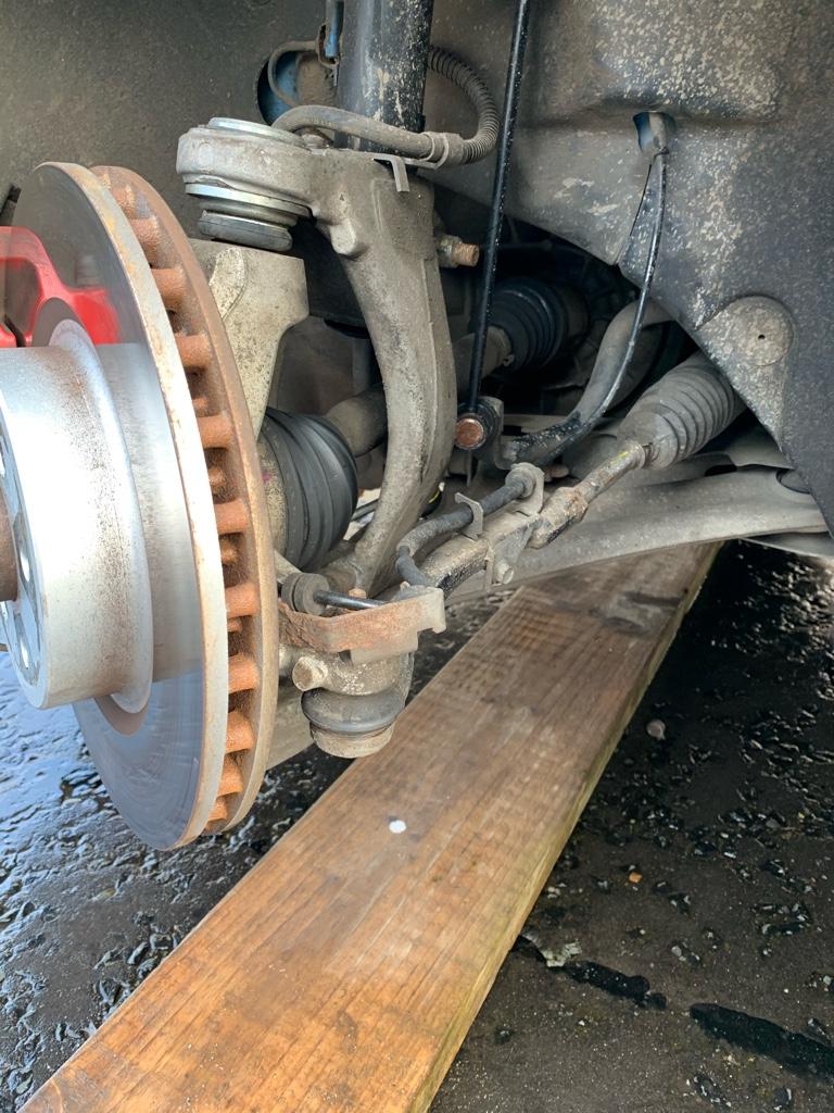

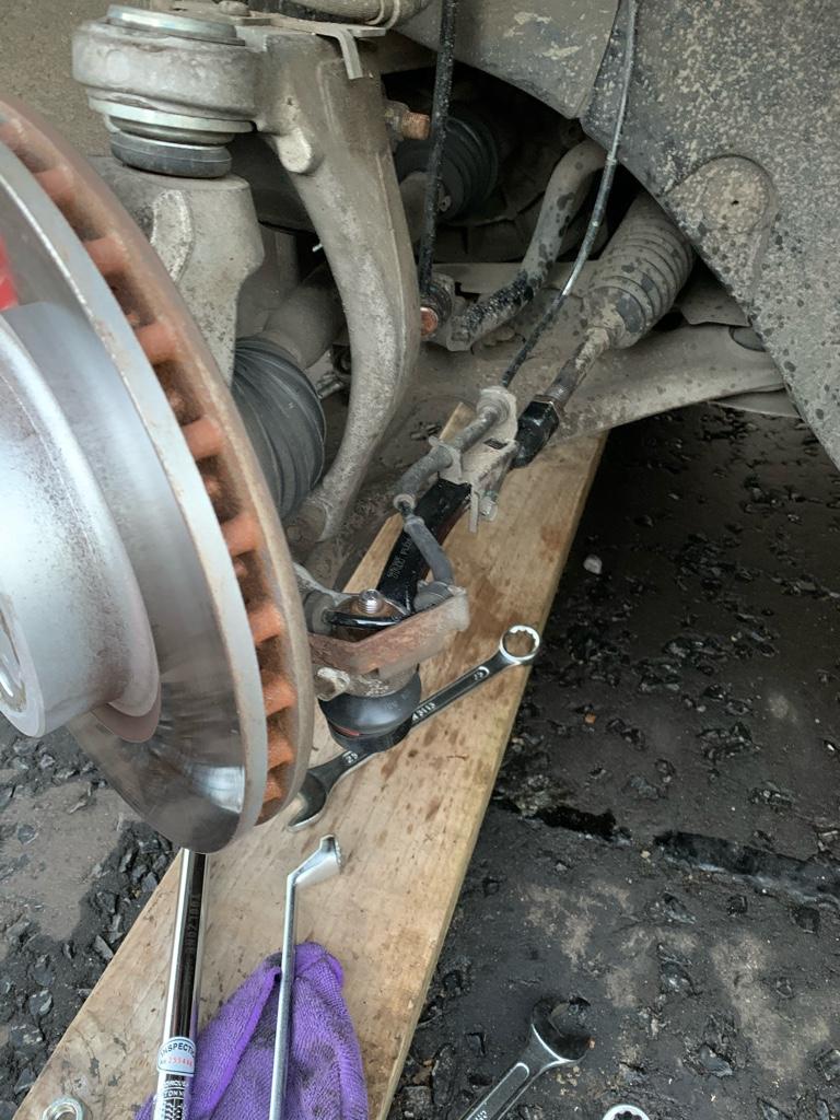

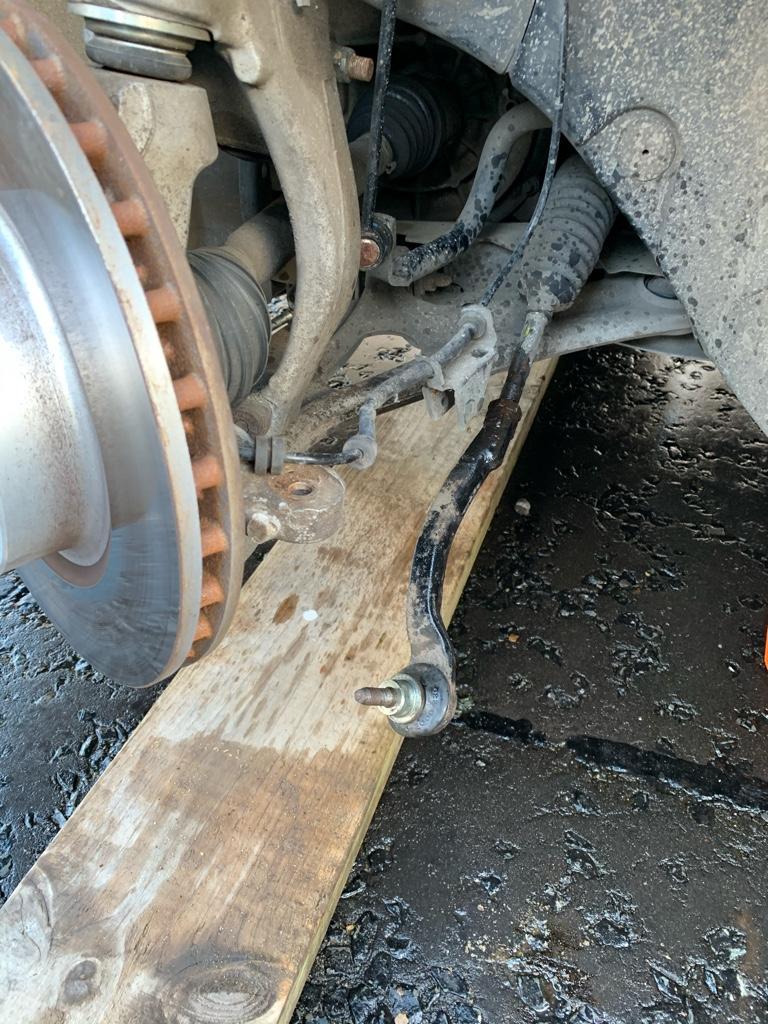

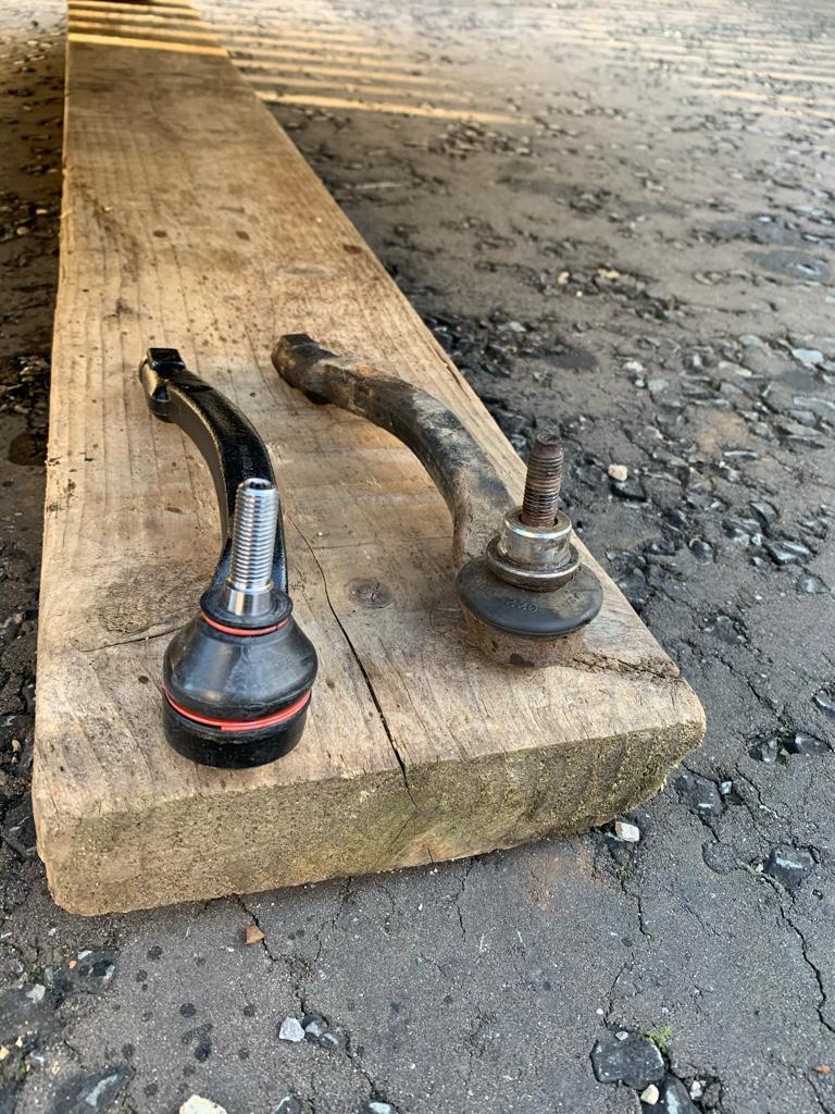

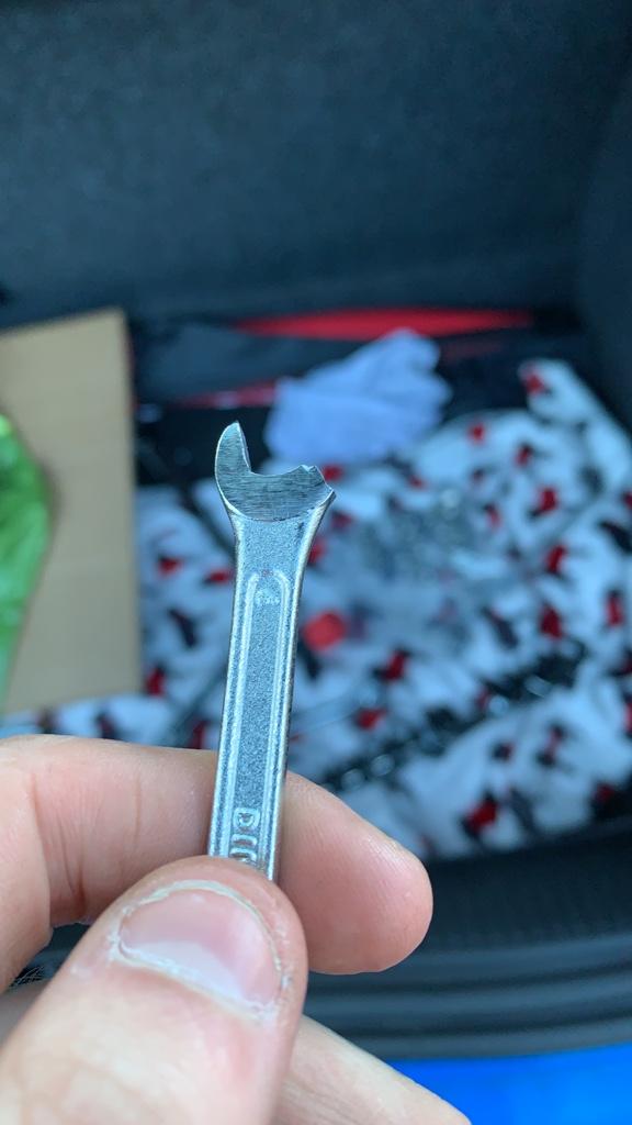

I also replaced the TREs this weekend. Made this extra awkward by not having all tools to hand but it's done now! The OSF was shot as expected, knocking seems partially fixed. Maybe still there or I'm possibly just trying too hard to hear it still. I'll be able to tell after a bit more driving!
NSF was in good condition, albeit a bit aged but replaced it anyways as I had both to hand as thought it made sense with getting another alignment done, slightly out but booked in for that doing tomorrow.
I replaced them with TRW ones, which I believe are the OEM equivalents? Made sense imo considering there was a £50 difference in each side. Crazy!
I'll report back after the alignment tomorrow.

Did you put the TRE collar onto the new TRE? (In that pic with both new and old, the old has a collar on it, did you put this onto the new TRE)?
Many people don't and can ruin the TRE.

I did indeed, just never got a picture. The first came off pretty easily which is surprising since getting the TRE off on that side was a ballache. Then the complete opposite on the other side, TRE off easy and the collar wouldn't budge! In the end it couldn't withstand having it smashed out with the vice and hammer after cutting the TRE bottom off :smile:
Cheers for asking though, normally I forget silly things like that as I'm sure most do!

Perfect! I couldn't see it in the final pic (due to angle) so was just making sure, before you go for alignment. Tim Finch sells them on ebay if you ever do need any (link).
Yep I had same problem getting mine off, was a pisstake, but managed with a lot of swearing haha.

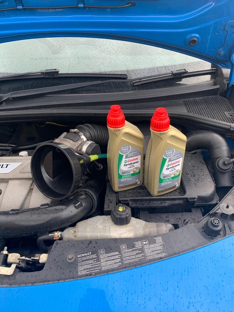

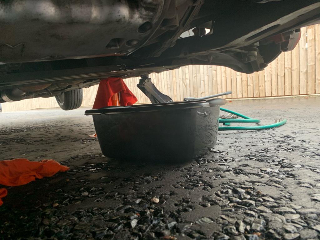

What a day... Planned out with doing a gearbox oil change, powerflex rear shock bushes and replacing the bumper support panel and only got the gearbox oil changed!
As usual, began by getting everything out in the dry to begin and it rains. About right I suppose? Any who's, I decided to go with Castrol, I spent ages deciding on elf, castrol and redline. Whilst I would've preferred redline I couldn't help but feel being ripped off from buying three bottles (I'm northern, so I'm tight).
Crappy photo, but you get the idea. Old oil out, didn't look as bad as expected but still pretty minging. Few lovely metalitc sparkles too...
I did buy a new sump plug, washer and filler cap and washer. Sump plug was perfect. However, the filler cap didn't fit? Has it been changed or have I just got the wrong part? A little bit strange, lost a little bit of oil to it but there's plenty in there. Just used the original filler cap.

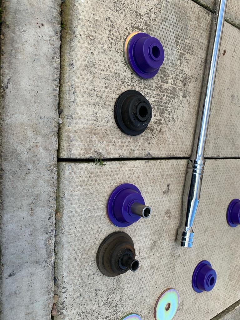

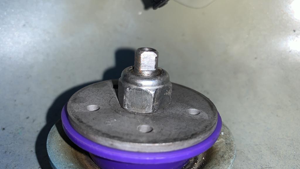

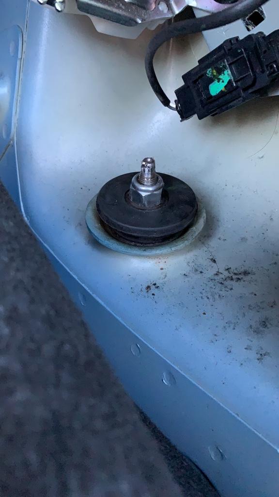

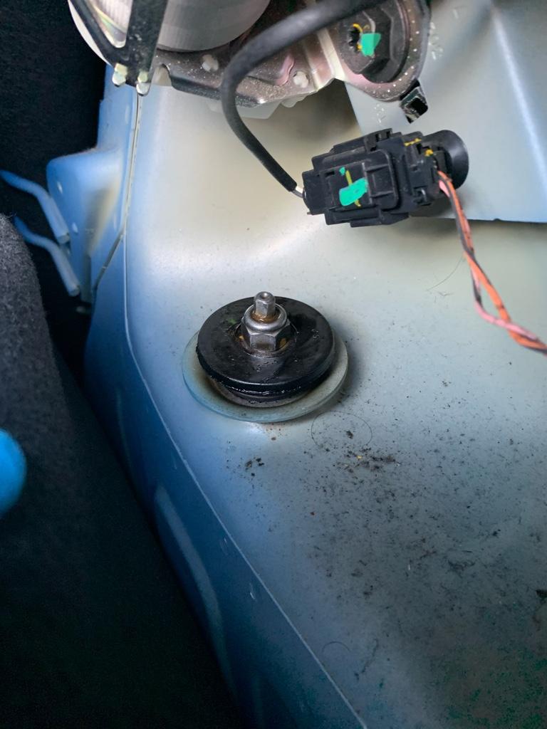

Now for the nightmare. Decided to replace the rear shock bushes with the powerflex alternatives. All was good up until I needed to reassemble.
Not a huge difference, but fairly noticeable and as expected a hell of a lot firmer. When including the washers in the kit the threads don't sit high enough to allow the nut to fit back on the rear.
As you can see the thread just finishes before the nyloc on the nut. Gutted, messed about for ages trying to get these to fit as I just though they were extremely tight fitting. Definitely need a low profile nut for them regardless of what shocks you have. Top of the strut looks a bit rough now but I'm replacing the shocks so I'm not too fussed for now.
So yes, original back on and unfortunately had a tragic loss amongst my battle with the strut.
Great way to finish the day. Thankfully nothing expensive broken. Just a bit miffed I only got the oil change done. Least I know next time that I just need the different nuts for the new bushes to fit.

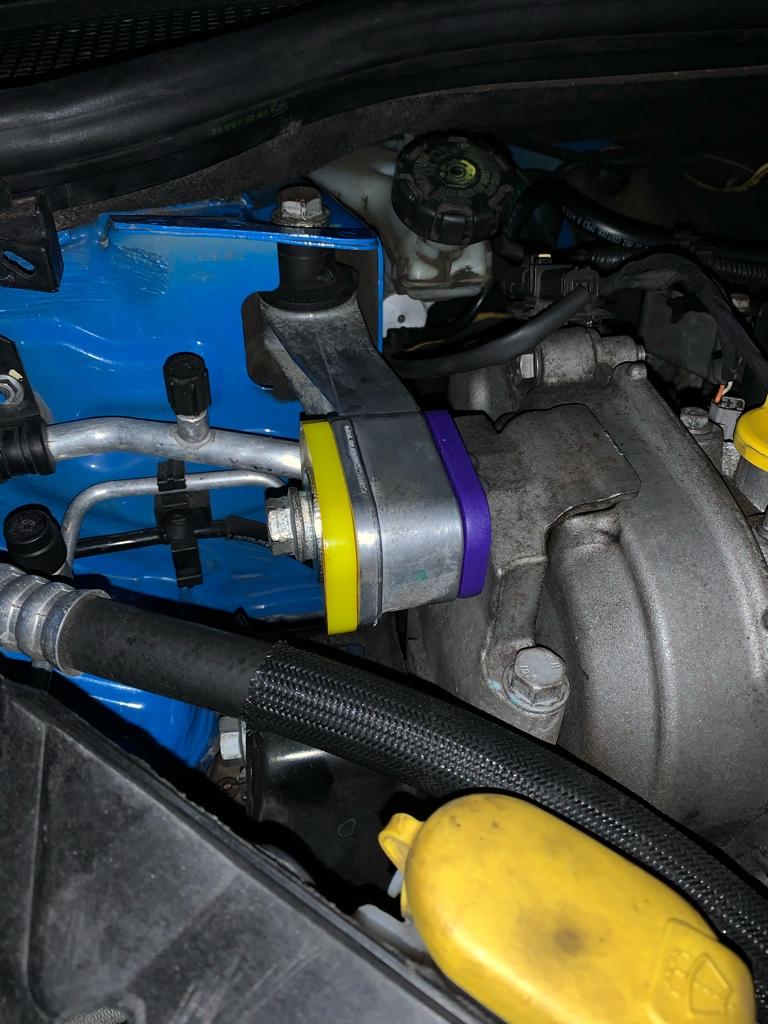

How do you find the upper powerflex mount, has it increased vibration noticeably?
Doesn't bother me too much, there was an initial period with harsh vibrations for a few days but it's settled now. There's a bit more vibration though the cabin which can make odd trims rattle at certain RPMs, vibration through the wheel isn't too noticeable.
I guess it's down to what you want from the car I suppose, if you're wanting as much comfort as possible I wouldn't recommend it. I'd rather have it fitted personally knowing it will prevent future damage to other parts!

So again, I had a bit of a headache with this. The OEM nut is slightly different to the M10 1mm nuts I got. It fits further down the thread however struggles to get started on the beginning tapered part of the thread.
So whilst these would work for my new solution too, I didn't see the point running both if the OEM nuts fit.

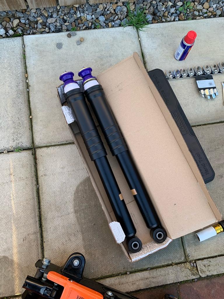

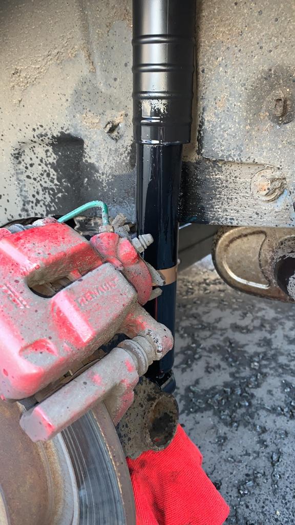

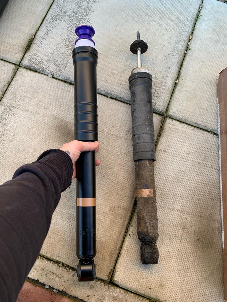

New rear shocks from KAM, £100 for both delivered. Absolute bargain for a refresh as mine were okay condition just weathered and looked naff.

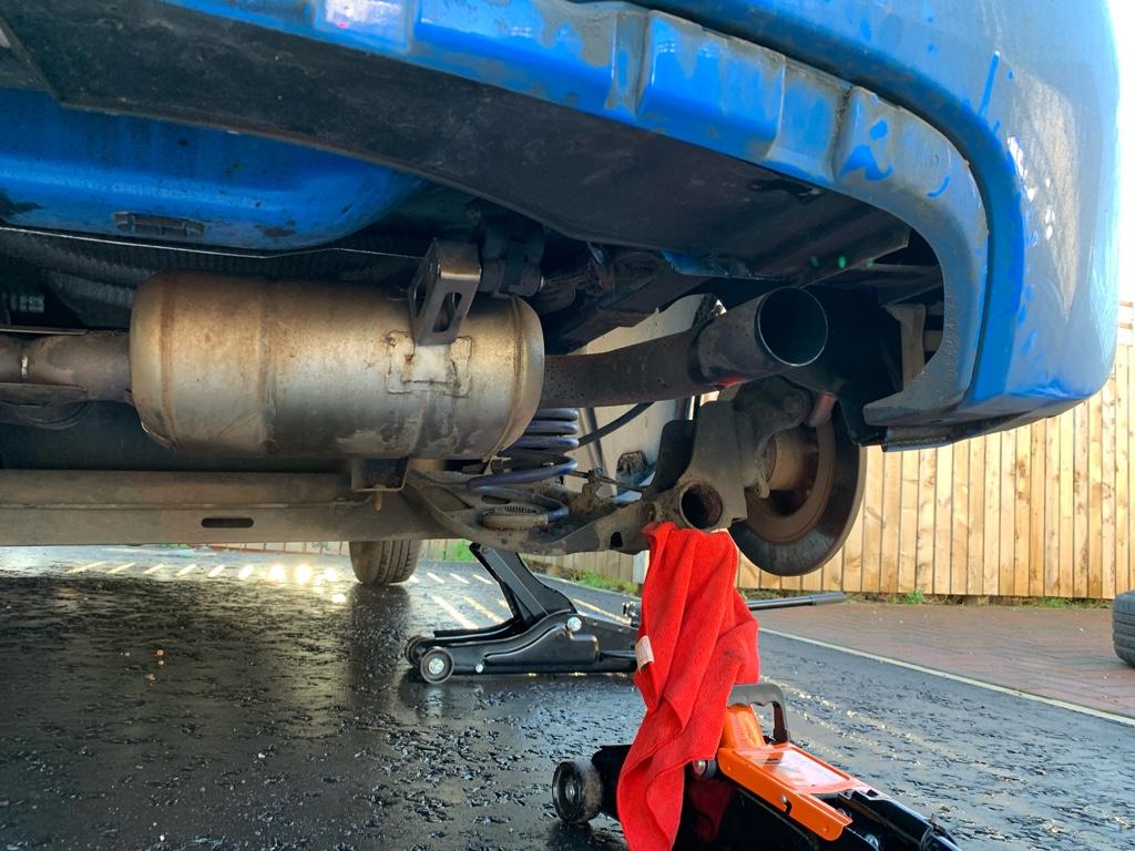

I think the 197 diffuser may differ slightly towards the rear side as on the 200 diffuser I had to remove it to make clearance to access the bolt properly. Strange as other guides I've seen can access it easily but they did have the 197 diffuser.
New VS old, OSR. Quite the difference and you can probably tell why I wanted to replace them.

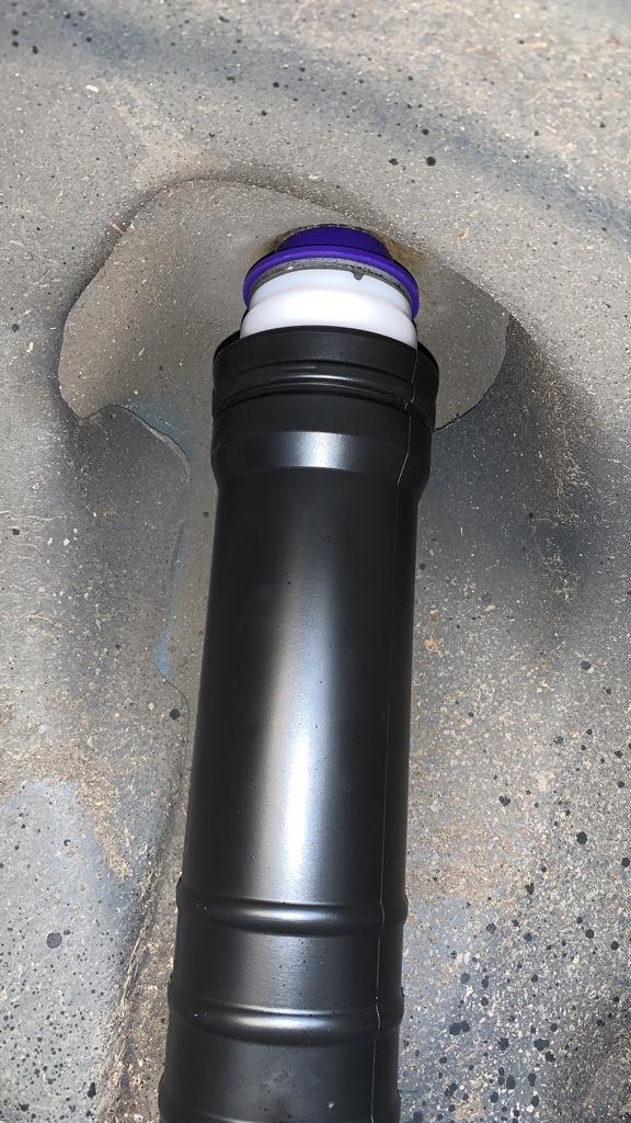

New shock seated with the powerflex bush.
I also coated both the shocks in ACF to protect them over winter. Hopefully they don't turn to dust as quickly as the others!

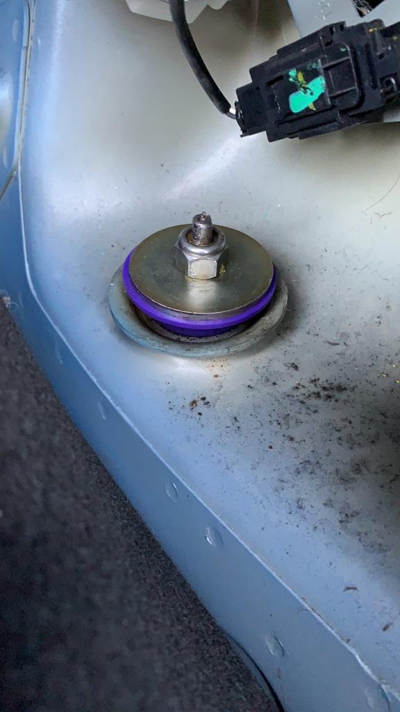

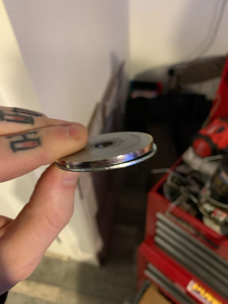

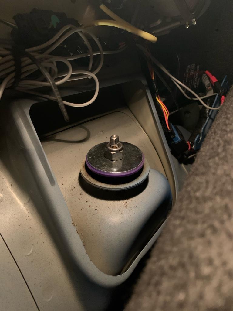

Right, so before I bore you before you get to the solution. Here's one. I cut the washers from my OEM bushes (not the new bushes ofc!) and reused these on both the lower and top side. Whilst using the OEM nuts these just clear the threads into the nyloc part. Ran these a couple of days with zero issues. I wanted the thread to be further through so here's solution two...
Sorry for the bad photo, it's dark currently and hard to get a decent shot however you can see the thread difference. I'm using m10 washers 50x10mm these are just over half the thickness of the powerflex ones which allows that little extra for the nut which is just about perfect imo.
I'll see how these go but I can only imagine them being totally fine with how stiff the powerflex bushes are. I'm also going to revert to the powerflex washers on the lower which I'll do later on in the week!
I'll update in a couple of weeks if there's any changes but I don't imagine much!
Nearly 2 weeks now with the rear bushes on the thinner washers (I have yet to change the lowers to the powerflex from the OEM ones yet) and they're still absolutely spot on. Done around 500 miles and not had any issues so fingers crossed it continues :french:
