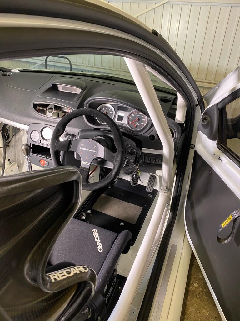

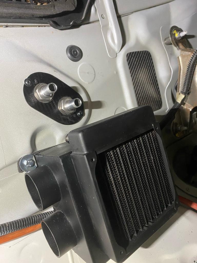

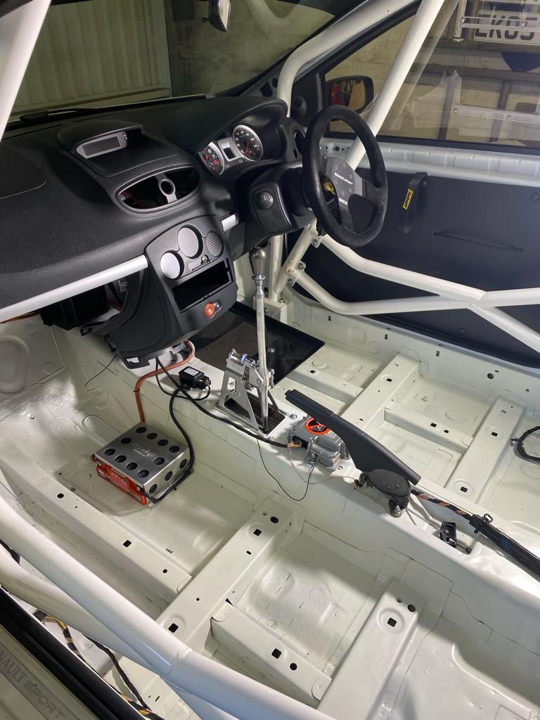

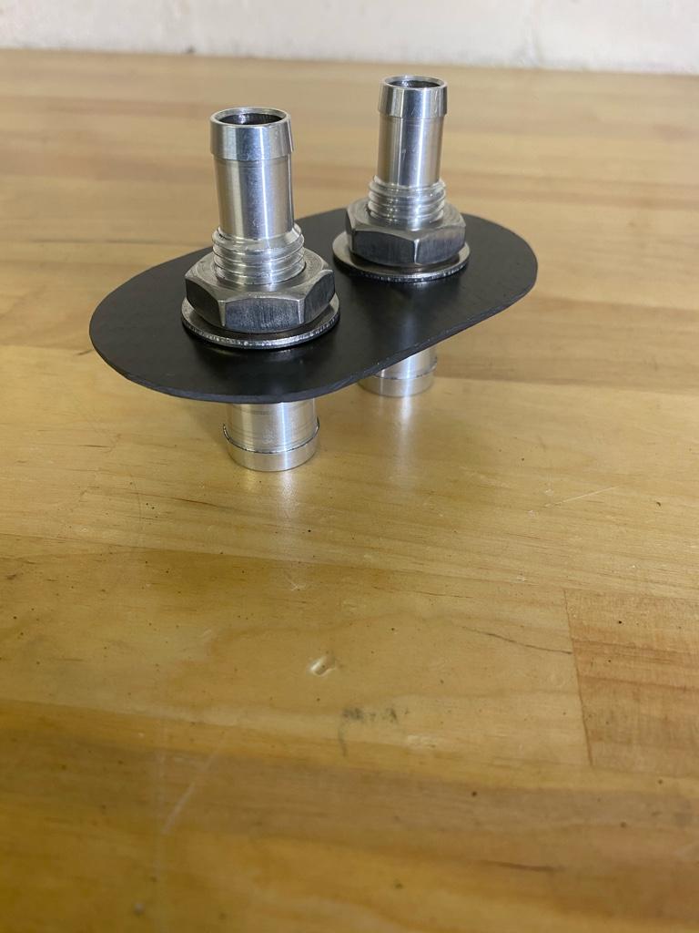

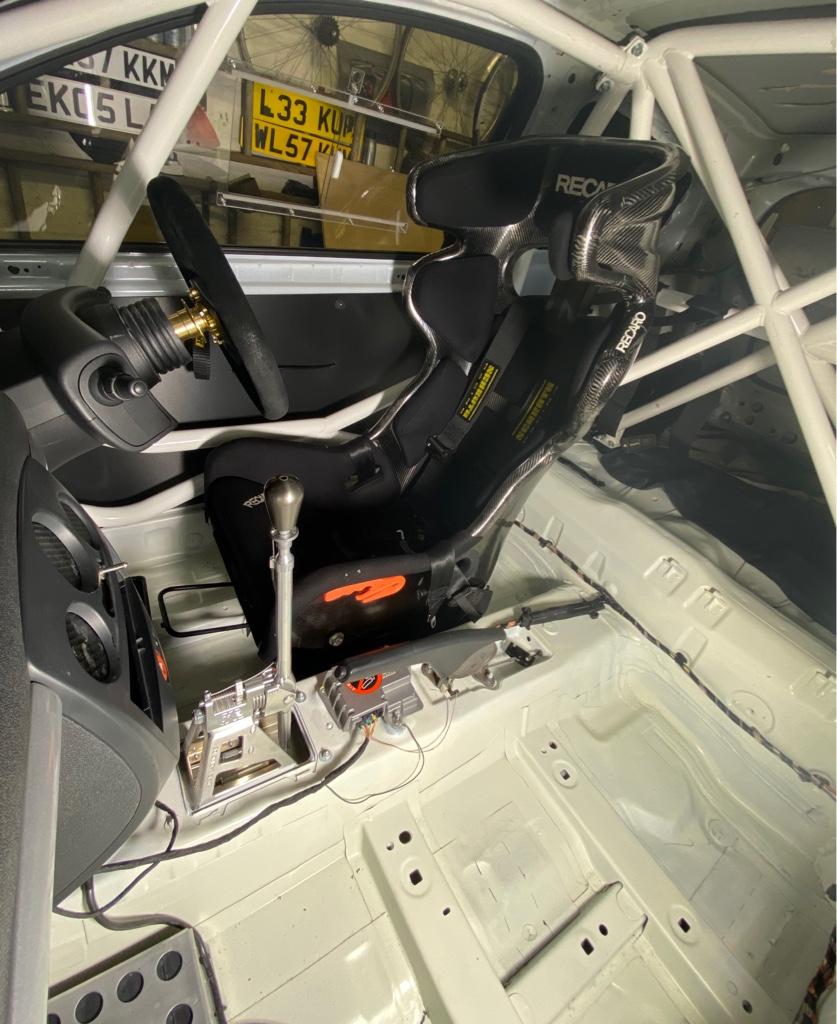

Finished the interior off this week, really happy with how it looks just some small bits left. I bought a bulkhead adapter as it looked too crude before then drilled some carbon sheet to seal off. But now I need to wait for some 90 degree bends to finish this. Also waiting for a switch to turn the motor on and off.
So that’s the todo but here’s how it looks so far, some of the lighting was the best as it was in the garage whilst it was raining.

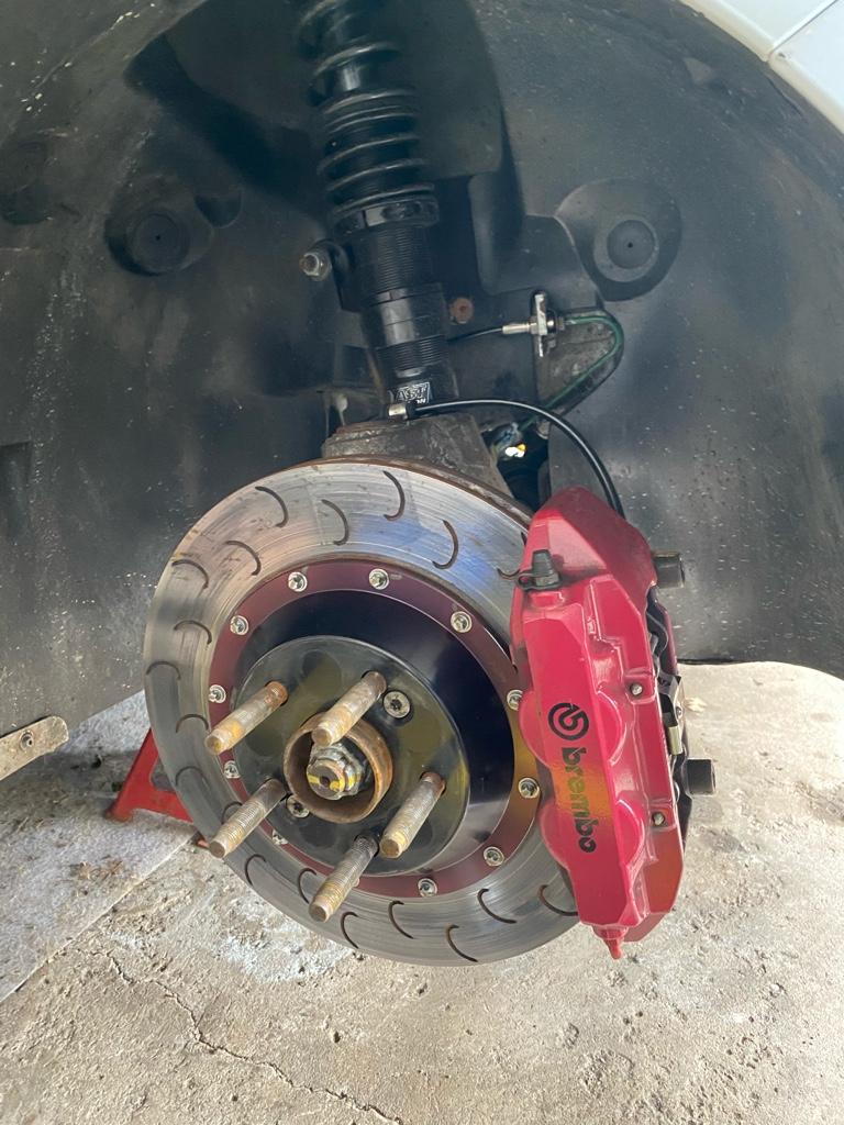

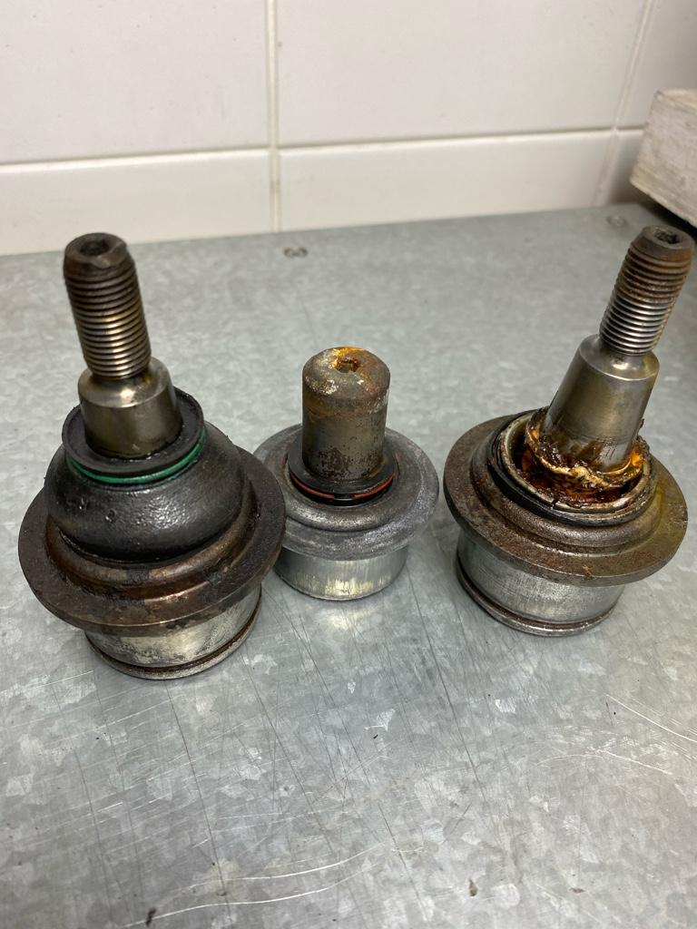

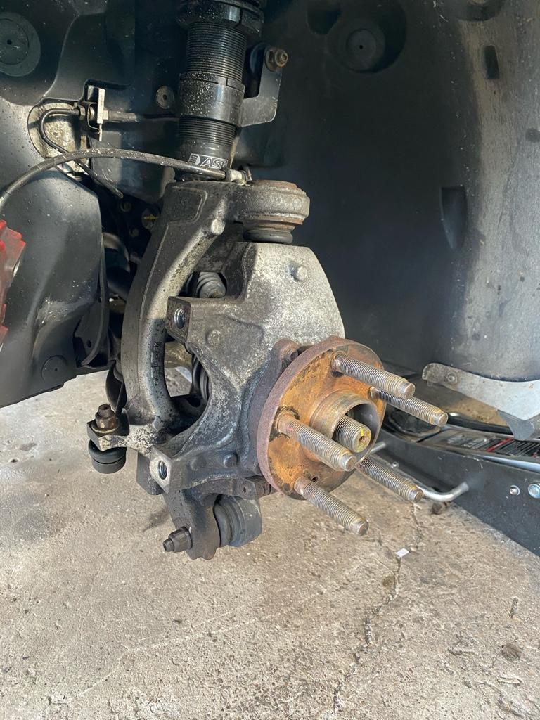

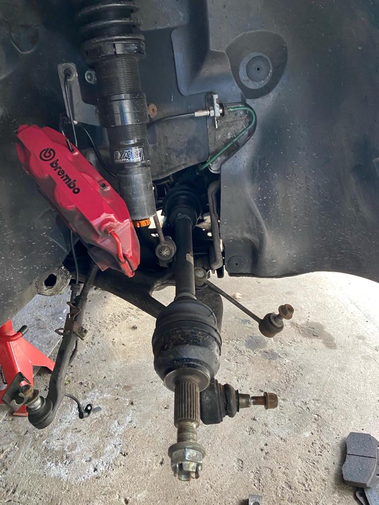

Removed the suspension today ready to fit new ball joints both uppers weren’t the best and lhf lower was in need of changing but the right lower had very excessive play not sure I can add a video and a bit pointless me adding to YouTube but a photo kind of shows the condition
Quite an easy job when you have coilovers as they don’t droop as much as stock springs.

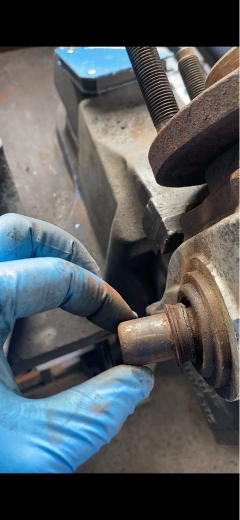

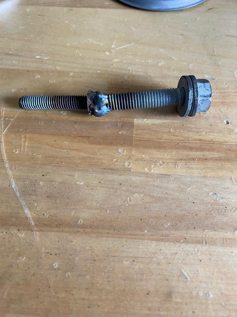

Stripped all of the hubs down and have new wheel bearings and new ball joints, bearings are actually okay but I bought some last year so may as well fit now. Only issue was the pinch bolt for both lower swivel joints were hex heads and they had completely rounded off so welder to the rescue, much easier than drilling.

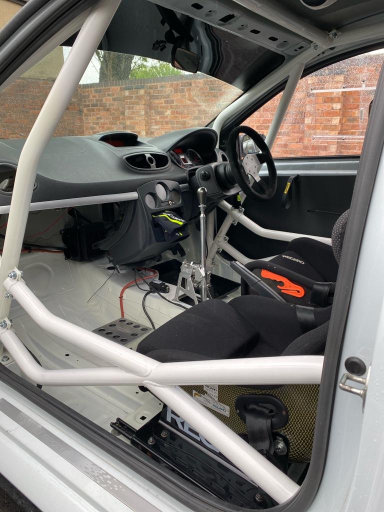

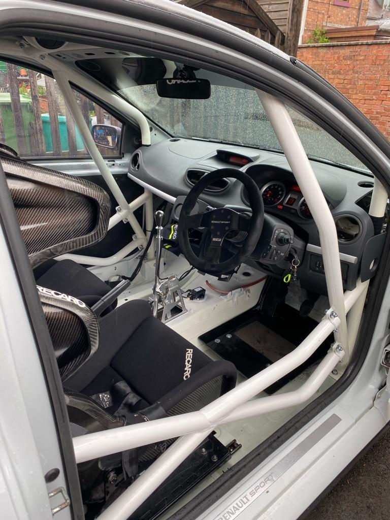

Painted interior looks great, can I ask whether you bothered to remove the factory sound deadening and seam sealant or did you just prime and paint directly on top of it? I’m doing the same with my track car build but I really can’t be bothered to spend hours scraping it off!
Tried getting some off it’s a right pain even tried using a wire wheel on drill it just melts and sticks all together so I ended up priming and painting, it’s just to look neater really

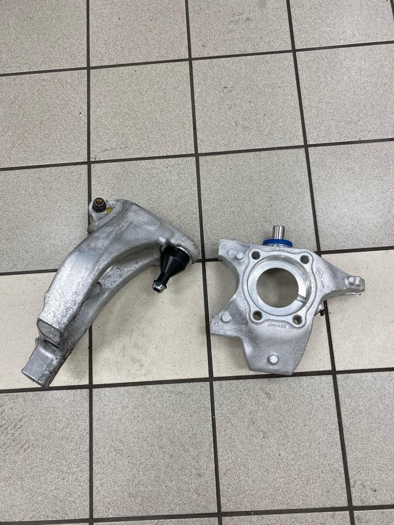

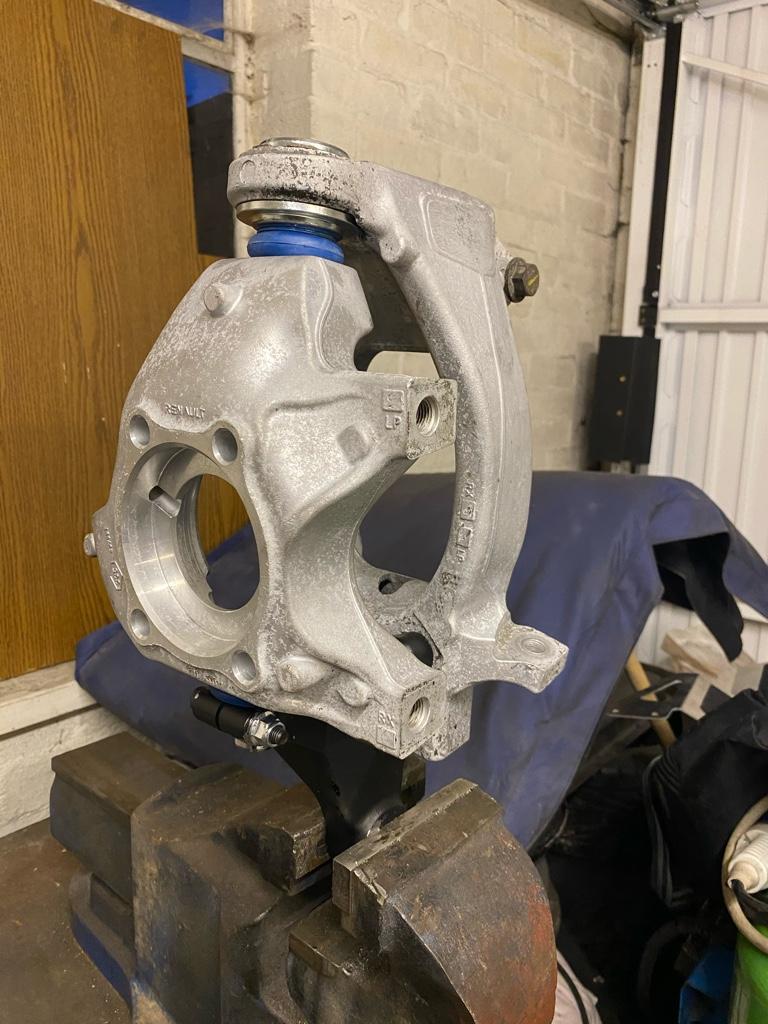

So this is the best before and after I can do, but they cleaned up really well, dropped my spare box and gripper diff at Rentune for them to fit the diff and swap the final drive to a lower ratio for hopefully better suited gearings. Should be going from 4.07 to 4.38 so looking forward to seeing the difference.
Also installed new cup racer EE brackets from retune also and wheel bearings. Hoping to install the upgraded heavy duty subframe too and then I can finish the rest of the conversion to cup racer.

When I drop the subframe I’ll put more photos of me changing the suspension over but this is all I have so far for an update.

Can I ask how much the brackets were?
So are you going for the new shafts too? As the new ee brackets make the shafts 25mm too short. Meg engine will have different ones to what rentune supply.
Yeah bought extended shafts too. Rentune supplied these too and specific to the megane conversion. Brackets are £300 I can’t find anywhere that sells them unless they’re from used cup racers and even then come to over £400
