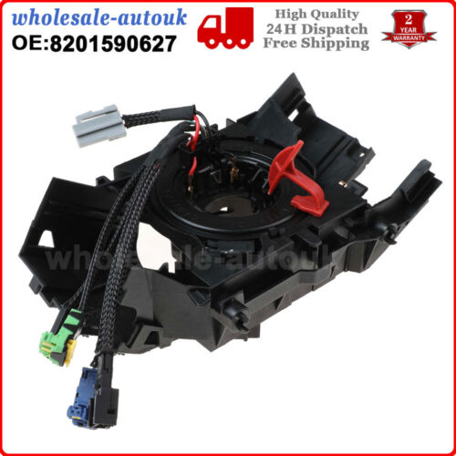

Clock Spring/ Squib, -£90-250

and just like that, I've got a clock spring (thanks @RSRowe) I've bought a 2nd hand one from the one Jamie is braking, along with his engine mounts and just ordered a new Torque mount,
so just need to get new tyres and brake pads,

Bit more of an update sadly the clockspring didnt sort out the issue with the cc so ill have to keep looking into it. However I now have a solid gearbox mount and upper torque mount and am just waiting for the engine mount to dry before it goes back on however ive finally painted the engine and intake. (Blue was a bit bright and its not getting darker lol) ive still got to paint the side cover but will do it when the mount is out the way.
