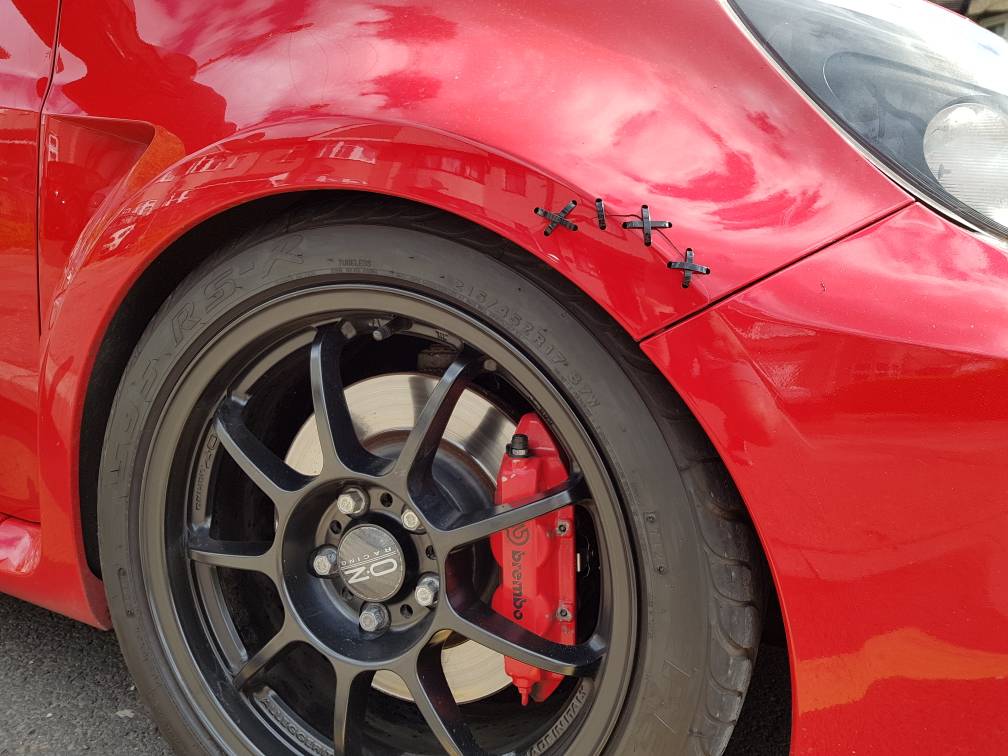

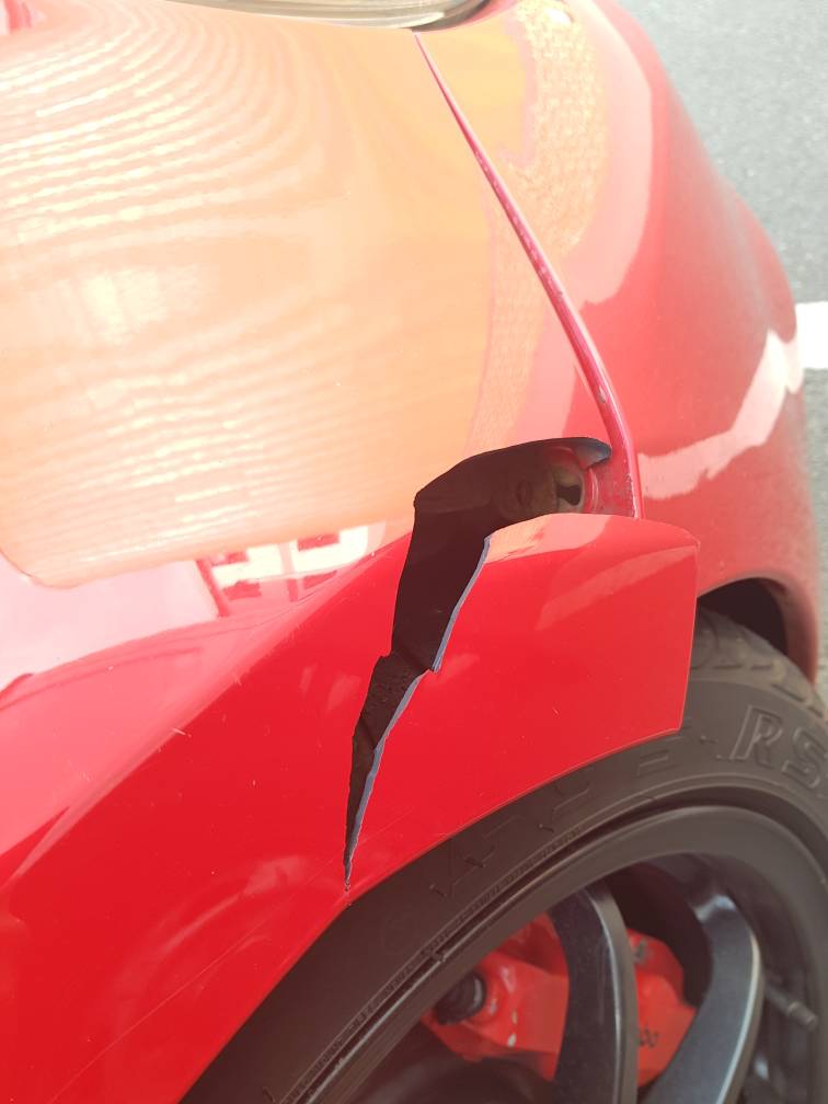

    PBS prorace pads going in tomorrow so will be good to see how they compare to my go too ferodo ds Uno...also lost driver's side wheel arch liner today on my test runs which resulted in wing being damaged so a professional repaire was in order [​IMG][​IMG]

    Haha love abit of drift stitching!
    Bad news about the damage, but could have been worse mate
    M77MWw likes this.

    How did the damage happen, did the wheel hit the arch?
  20. M77MWw
    M77MWw
    Messages:
    112
    Car:
    clio 197
    No mate the arch liner flew out so much have hit it on the way out
