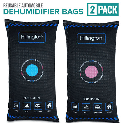

I used to get it in my old Mondeo, I found a dehumidifier helped:
The coloured dots start off blue and when the bag has absorbed water from the air it turns pink. At that point you blast it in the microwave for 6 minutes to dry it back out and stick it back in the car.
