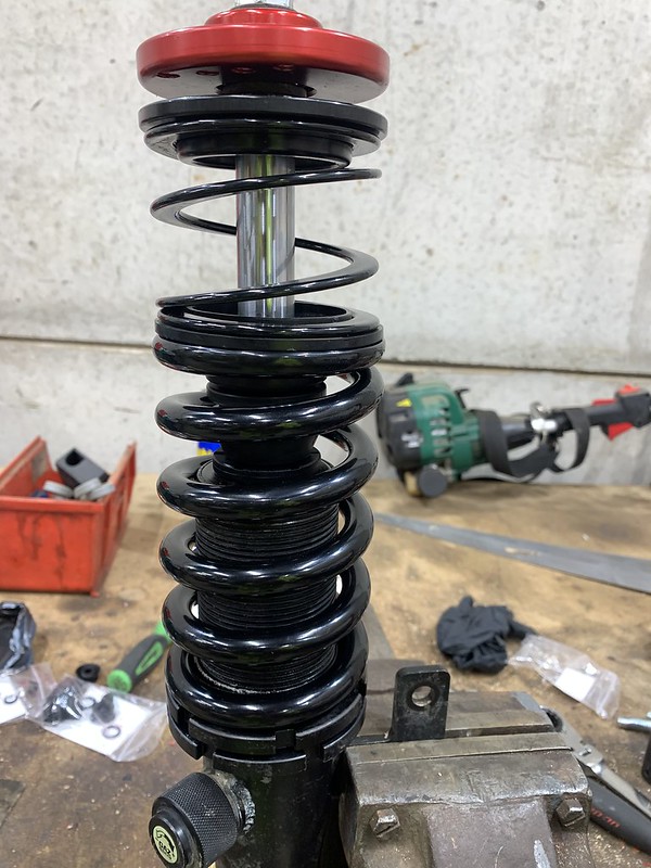

It got put onto the ramps and striped down in a big way. The coilovers were sent to Gaz for a recondition, although they only do the insides we tidied up the outsides using a bench grinder with a wire type wheel, and then added a light coat of hammerite. I sent the spings of to shotblast and powder coat as they were pretty messy

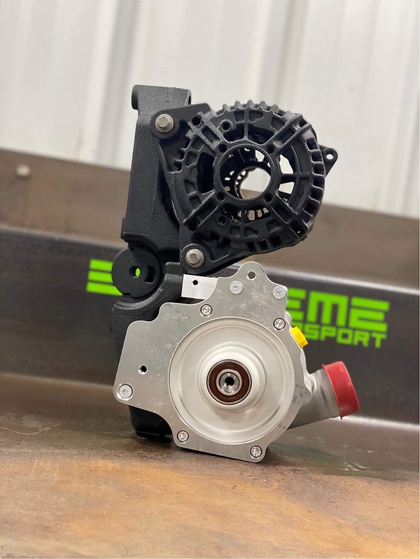

The supercharger was leaking oil from the main seal, its a common thing. Also as you saw above it was pretty spent, the metal had eaten into the Aluminum so with the help of Supreme motorsport who told me about somebody who refurbs them I was able to send the charger off, he had a spare oil pump housing, i had all the bearings replaced for low friction ones and seals replaced at the same time. Reading about it some people suggest the bearing can help create up to a pound of boost so that will be interesting. At the same time i went for supreme motorsports charger mounting. Mine was done 7 years ago and was a flat plate of metal that actually used the air conditioning compressor to mount of. It meant the charger was literally in the front bumper and allowed for a very tight fitting air filter and to be honest a lot of weight on the front end. The kit from Supreme takes of the Air conditioning compressor itself which is fine as it was not connected anyway. The result will be a much nicer weight as well as a easier way to find a better air intake solution

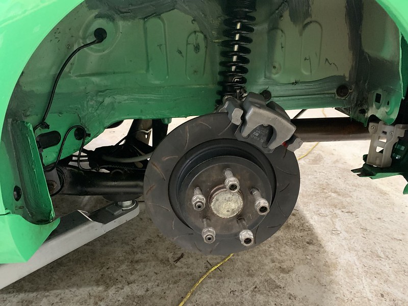

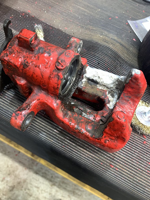

We spent a long time degreasing and cleaning the wheel arches while the liners were out. I also gave the calipers refurb with new seals. The old ones had blown all the paint and were disgusting underneith. These are temporary I just wanted to get the car back to working condition so I stripped the paint of again using the bench grinder steel wheel and a few other tools. Then just painted them with some high temp paint to hopefully match the fronts.
old
Untitled by Ross c, on Flickr
new, i also gave the disk a little once over with a wheel and a light coat of paint which will clean up with some light braking. Fitted then with Ferodo DS2500 pads as the RS29's were spent.
A lot of nuts and bolts were rusty, so these were all sanded back and given a coat of hammerite.

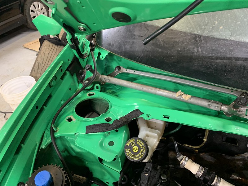

This weekend i set upon cleaning the front suspension area and scuttle panel, if you look at the history of this car it was so mint i had to get it like this. I forgot to get a full pic but even after a steam clean it was still so mucky so from this
to

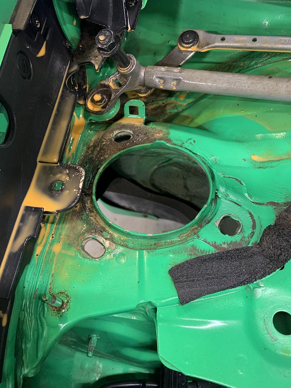

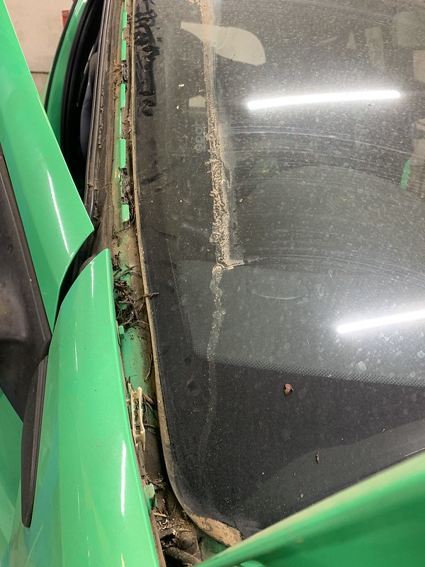

however i soon realized i needed to do more, i pulled the windscreen trims to find
Luckily i have a full plant workshop so i have a tool from autosmart which fires cleaning fluid and high pressure air (like a turbo nozle) out via the compressor which helped a lot in this clean. You can imagine as well i pulled the door seal off etc to clean that too

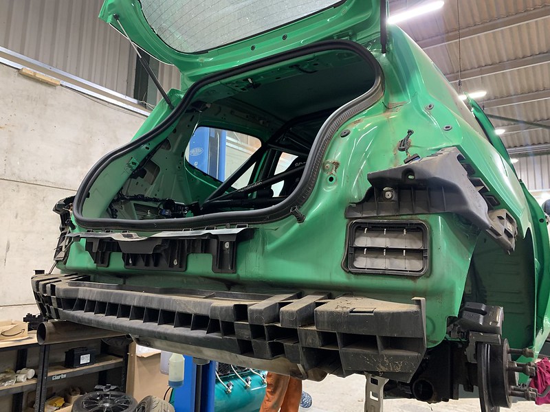

Seeing what was under that made me thing i should probably remove the rear bumper to see what's there but luckily it wasn't to bad, i previously wanted to do this but the project was getting far to big

Cleaned up the rear end and got the bumper refitted loads better too

I had already cleaned up all the real dirt white hoses, the supercharger is about to go back on
cleaned out the inter cooler pipework and which was dirty but also cleaned the dump valve now that was grim
supercharger filter and oil is here so that can go on . Hope to see it running later this week but then need to work out the intercooler pipework as we have changed the positioning of it .. also will need to do the same for the intake filter ... any ideas ?
