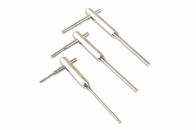

Do you think this kit would be ideal? It's been in my watch list for ages but I haven't needed to change the pads until now...
They look good but are expensive for a set of punches
