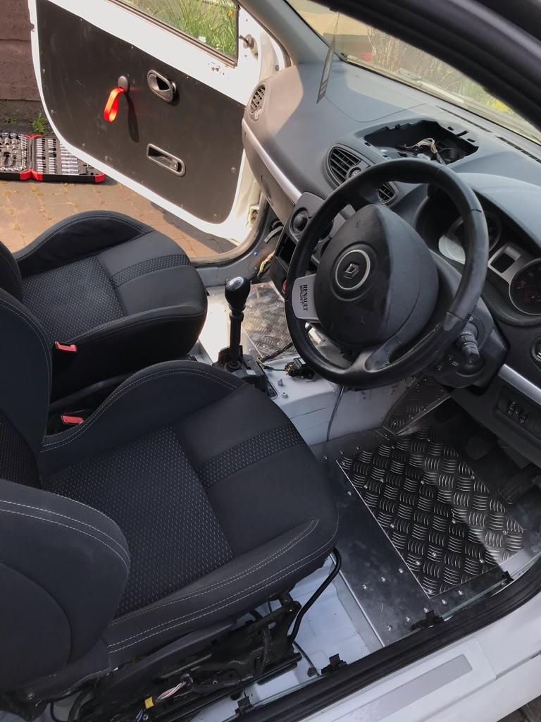

This meant that I could start attempting to make a custom foot plate for the drivers footwell. I got some plans drawn out from my cardboard aided design dry run.
Managed to knock this up.
Not quite finished yet. I have to put a footrest on and a few other finishing touches, but worked out quite good considering I don't have an AC tig and therefore it's all just cut, bent and bolted together.

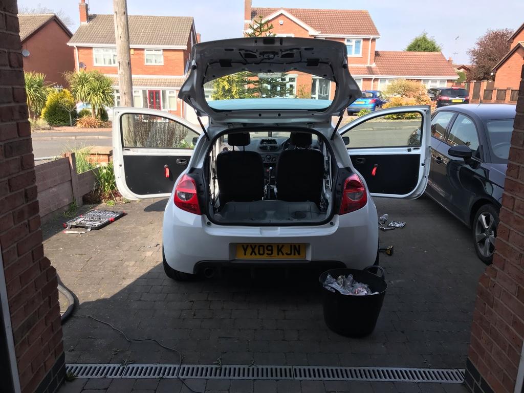

Got a bit more done today. Completed the passenger side foot plate and added a clutch foot rest on the drivers side. Also finished the rear wiper delete. Got a kit from killallwipers... not that impressed with it to be honest, but did the job. Could not for the life of me get the rear wiper arm off the motor spindle despite trying a bunch of times, so ended up hack-sawing through it.
Pop rivets aren't breaking off cleanly on some occassions, so this will need to be cut off.
Stage 2 will be harnesses, seats and a rear cage assuming I still have a job and some money and coronavirus hasn’t brought about the end of civilisation.

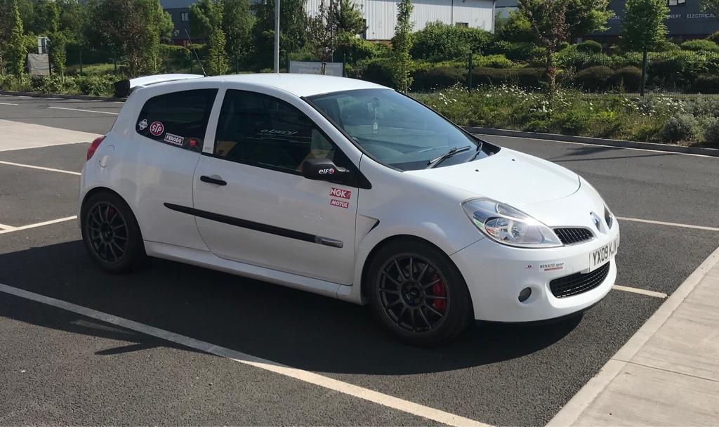

First time on track last Sunday. Took the Clio to Blyton park and apart from some slightly paranoia inducing vibration under braking the car performed really well. The driver didn't perform quite so well, but it's a learning curve :smile:

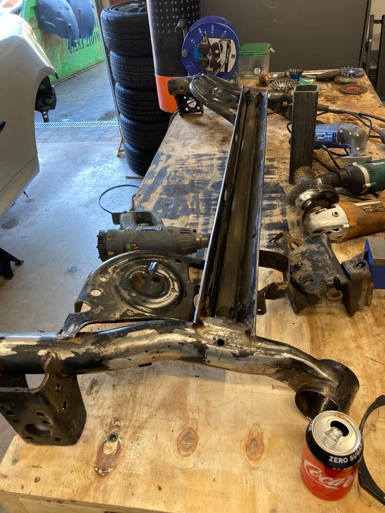

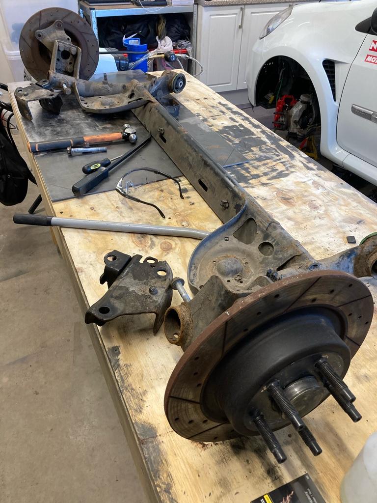

What started off as replacing the rear dampers has turned into pretty much a full rear end refresh after I found the torsion because bushes were buggered.
Decided to de-rust the beam so I can hammerite it before it goes back on.

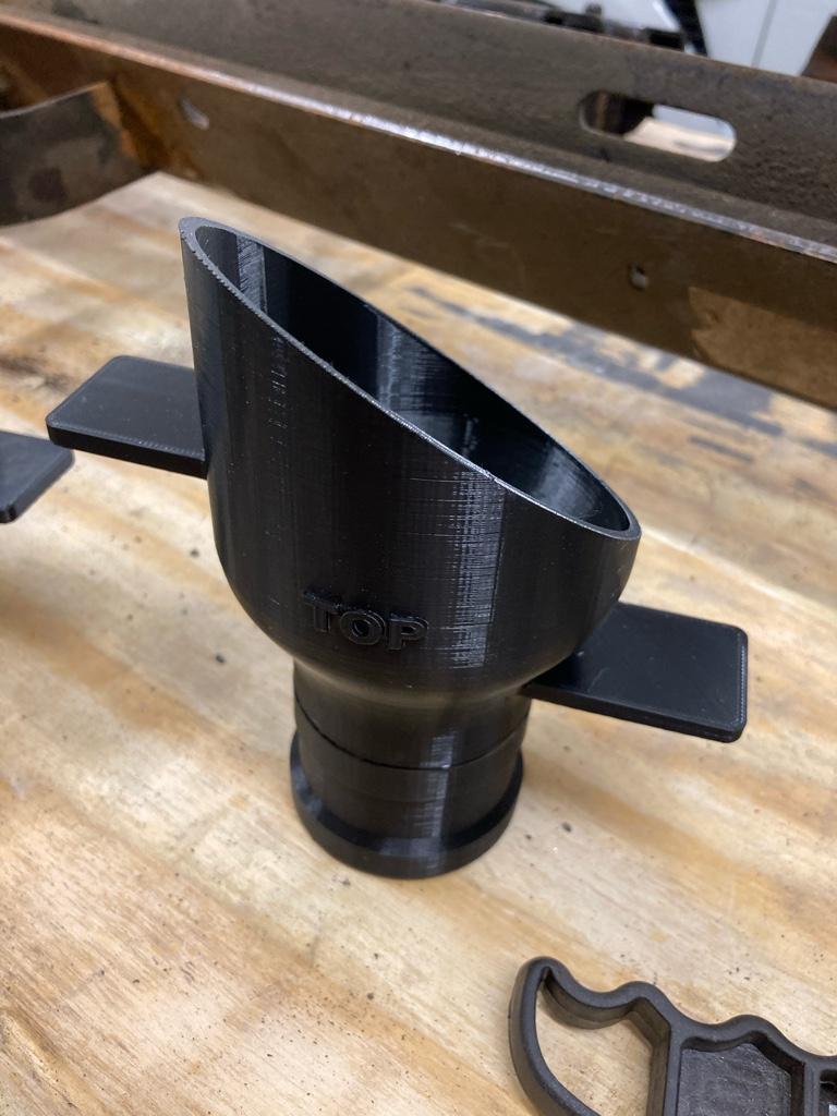

I also designed some brake cooling ducts to go in place of the fog lights and got my dad to 3D print them for me. They don’t quite fit but they’re close enough.

Cleaned up all the rear axle components and painted with what I think I've discovered to be the best underbody treatment.
  • Black Hammerite (hammer finish of course) followed by...
  • Hammerite Underbody Seal with Waxoyl
  • Finished with a coat of Halfords Satin Black
I know this is unorthodox, but I tested it out and it seems to actually work. So, the Halfords Satin Black is Acrylic paint, so it doesn't have solvent in it therefore doesn't react with the underbody seal like other paints seem to. Also, I just stick a light dusting of Satin Black over it so it takes away the horrible sticky, never dry finish. Result looks pretty shit hot IMHO...
Believe it or not this is dry to the touch but still has a slightly squishy rubbery feel.

I can't fit the harnesses until the seat arrive and I can position everything properly. In the meantime I worked on a couple of mods. Got the custom 3D printed fog light brake cooling scoops mounted.
No idea yet how I'm going to route the ducting. Open to suggestions. I've also made another little mod, again to hopefully aid with brake cooling.
