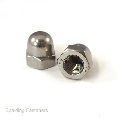

That's good to hear, I had no issues removing the old one so should be simple enough! I like using some dome nuts when disconnecting brake lines, IMO it's easier than finding something the right length to keep the brake pedal down.

Possible silly question, but why do those nuts cost over twenty quid? :laughing:
lol not sure, can’t remember if I paid that much when I got them!
