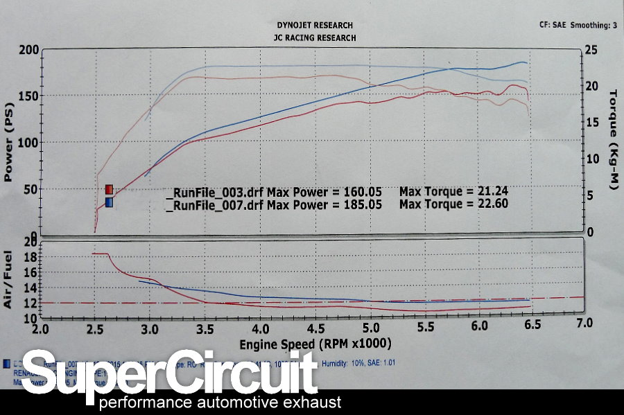

Also this is an insteresting dynoresult (first number is stock, 160 bhp on wheels, which is not far off of mine): http://4.bp.blogspot.com/-KFO0NCG-7Fg/Vm_4HW_p9iI/AAAAAAAAGec/JX8MN6A0QnY/s1600/Renault+Clio+RS+200+EDC+downpipe+%28b%29.jpg
My torque was OK at 250 nm, stock is 240 nm.
If remaping the car should get it to about 230+ horsepower, that's 50 more than stock. Womble's clio does 244 if i'm correct, man that's 60 over.

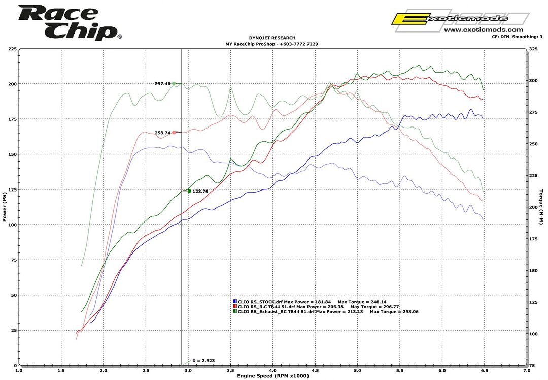

These two dyno graphs were also found:
[img=[URL]http://www.zerotohundred.com/wp-content/uploads/2015/12/Final-Dyno-Results-Racechip.jpg]dyno1[/img][/URL]
[img=[URL]http://www.zerotohundred.com/wp-content/uploads/2015/12/Renault-Clio-RS-RCU_Exhaust.jpg]dyno2[/img][/URL]
