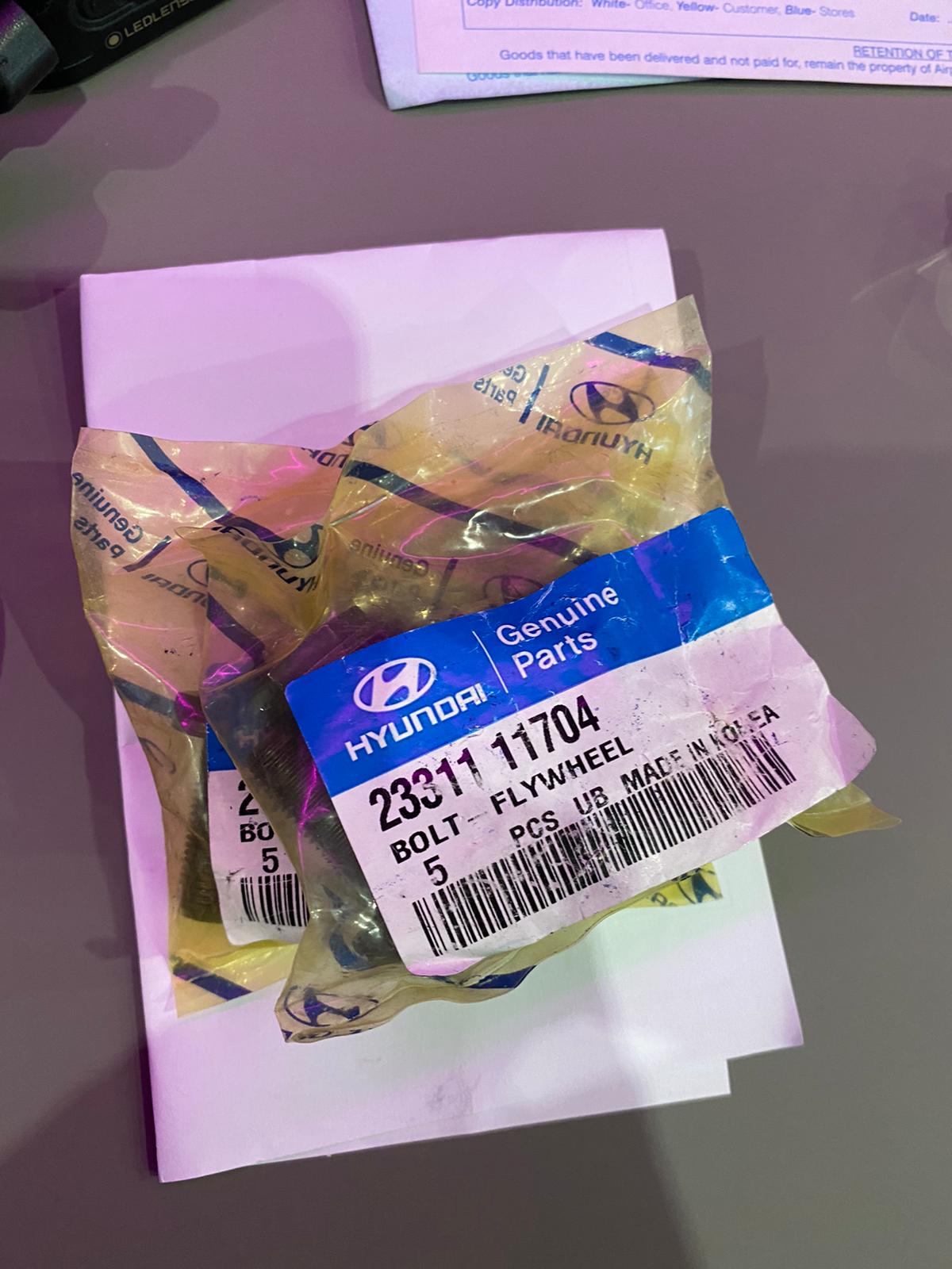

I replaced the ring gear bolts - there is less thread engagement in the Val Racing diff with original bolts due to it being thicker. It took me ages and ages to find some bolts that fit without cutting down.
Which bolts did you use?
