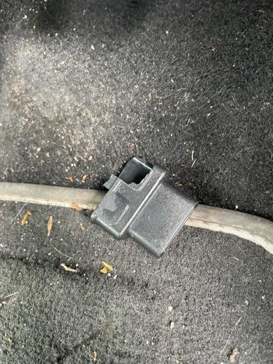

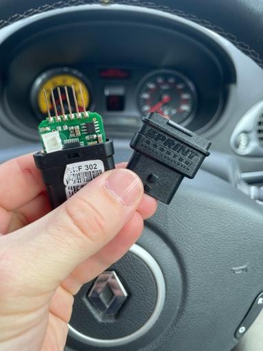

c.h 90
So i decided to disconnect the sprint booster today. While taking it out I discovered it wasn’t in particularly good condition. The body was cracked and missing pieces.
The circuit board seemed to have a bit of corrosion as well. I was optimistic that this was the problem.
However once I took it for a spin the problem was still present.
I’m unfortunately back to square one.
