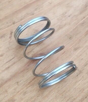

I may be a new Clio owner but I unfortunately had to bare the terrible task of manually pushing the plastic part of my gear knob down to get out of reverse. Although a small thing to do, forgetting to do it and almost sending your car into whatever's behind you is rather frustrating... BUT NO MORE!
I'm unsure if anyone has shed light on a replacement spring on here before but I couldn't find anything and I thought it be best to do my due diligence for the community, posted below is the link to a replacement spring that fits 100% and WORKS! Now don't be alarmed by the fact its for a Fiat Ducato it genuinely does fit and I thought I'll chance it for the sake of £10.
I hope this ends all of your frustrations!
