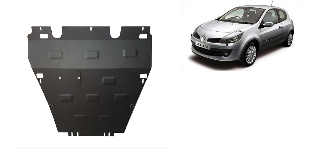

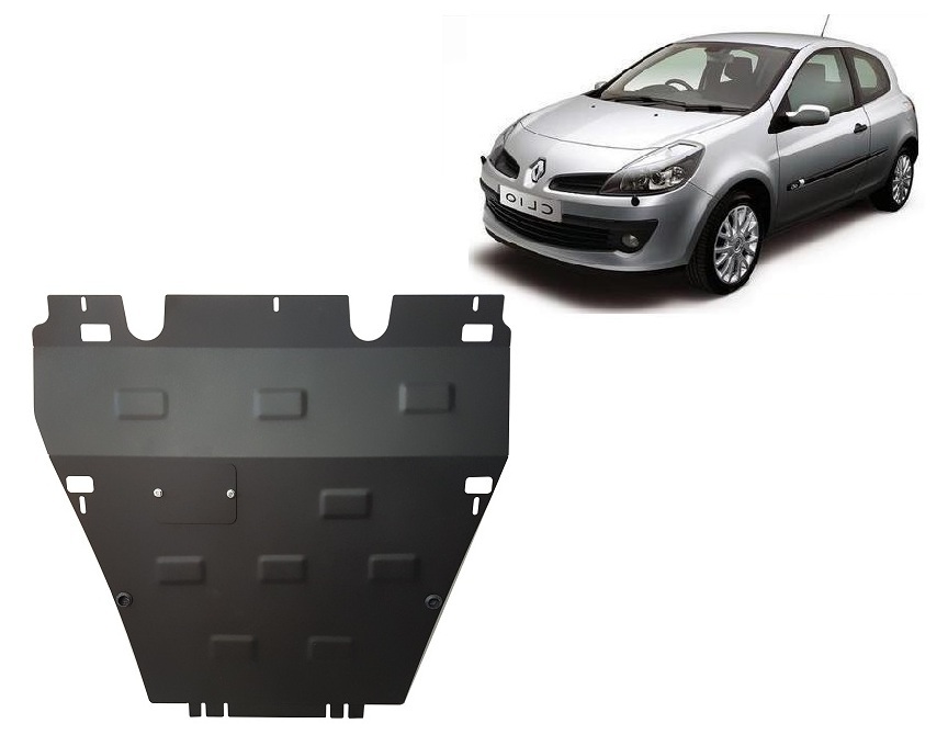

I've been really bored recently and so I've ended up buying some goodies.
I'll update you all as they come through, but I think this may be a first....
Because track car, curbs/aero.
Very interested to see how this fits, I have cut the legs off my rad support so unsure if this will secure
Look forward to the results :smile:
Me too, for such a minimal outlay its potentially got a few benefits. Obviously the protection of the sump, flattening the floor at the front and possible subframe stiffening.
It's mostly just because my car is quite low and I'm finding there's a trend of sausage curbs on tracks these days. Very easy to miss a braking point and have to straddle those curbs. Be a nice bit of peace of mind.
