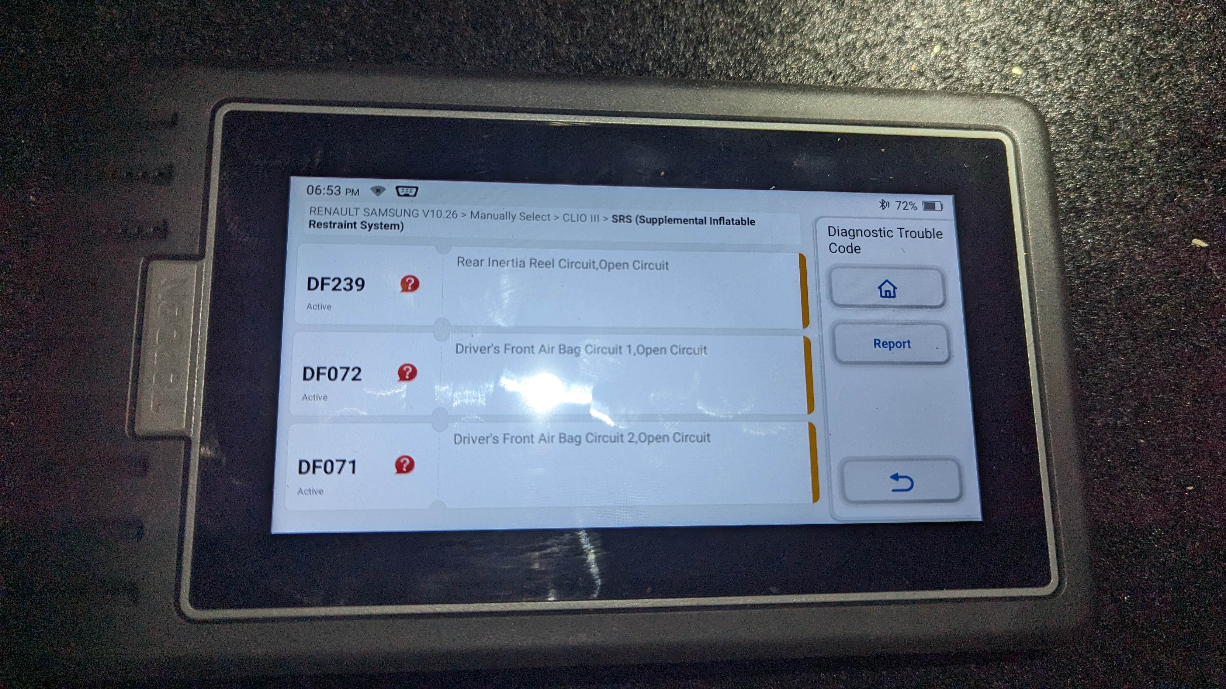

Just wondering if anyone know where abouts is or maybe have a picture of the rear inertia reel for the airbag? As i am getting the fault code below and i can't for the life of me find it,(I know about the issue for the other two front ones).thank you for the help.
Isn't the reel inertia pat of the seatbelt mechanism?
If the rear seatbelts have been removed then the car knows they are missing so they just need to be coded out.
Reactions: VeiRoNv2
Not sure to be honest,yes seat belts removed along with the seats, will have a look see if i can find it,thank you.
