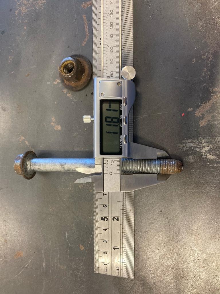

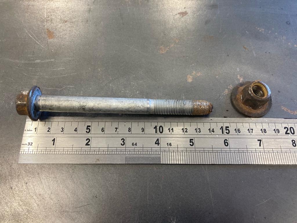

Hmm I’ve got a similar problem. My rear trailing arm bushes are pretty much dust it seems. Any idea where to get the main bolts from or a part number? These ones specifically...
