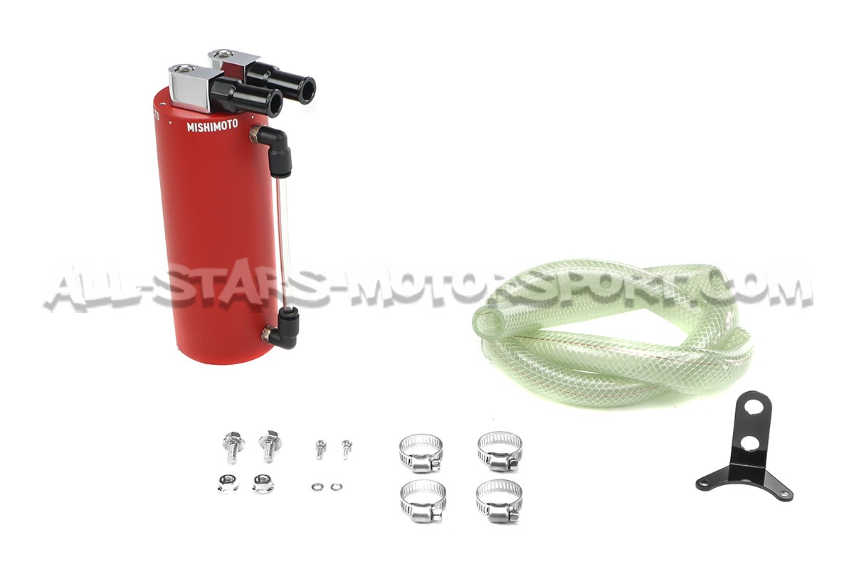

Hello im thinking about buying oil catch(from ebay) can anyone share any pics how they fitted theirs also shoud i go for catch can whit breather filter or wtihout one?

Hello ive decided to do a post after 3 mounts of catch can being fitted ive mounted it on the left side of engine bay whit simple made bracket ive used 3 post mishimoto clone catch can bought for 20€ ive blanked 1 input port on the second input port ive instaled silicone hose to the rocker cover where pcv valve was connected and on output port there is breather filter after 3 mouths of driving the car these was inside the catch can so it definetely it does work130820020_815399335905880_6007103618789699384_n.jpg206211956_5725480510856429_9075538050383916283_n.jpg212555389_893861164499654_4575156271936513295_n.jpg209327646_207133121298677_8625116354851910610_n.jpg
