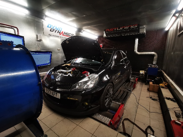

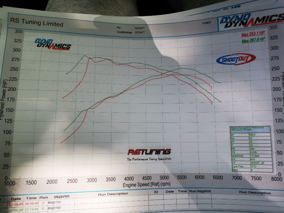

Took a trip up to Leeds today to go to rs tuning.
Car behaved itself
It had been remapped previously which I was told it wasn't. (thought it had) and made 253bhp on the dyno but was boosting at 20+psi and causing compressor surge.
I then had 630cc injectors fitted and ran it up again.
It's now making 267.8 hp at the flywheel and nearly 300lbft.
Car drives great and feels completely different!
