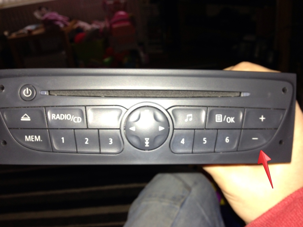

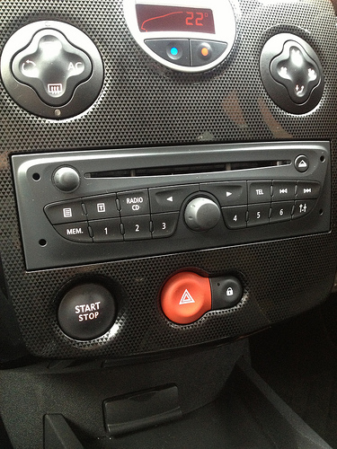

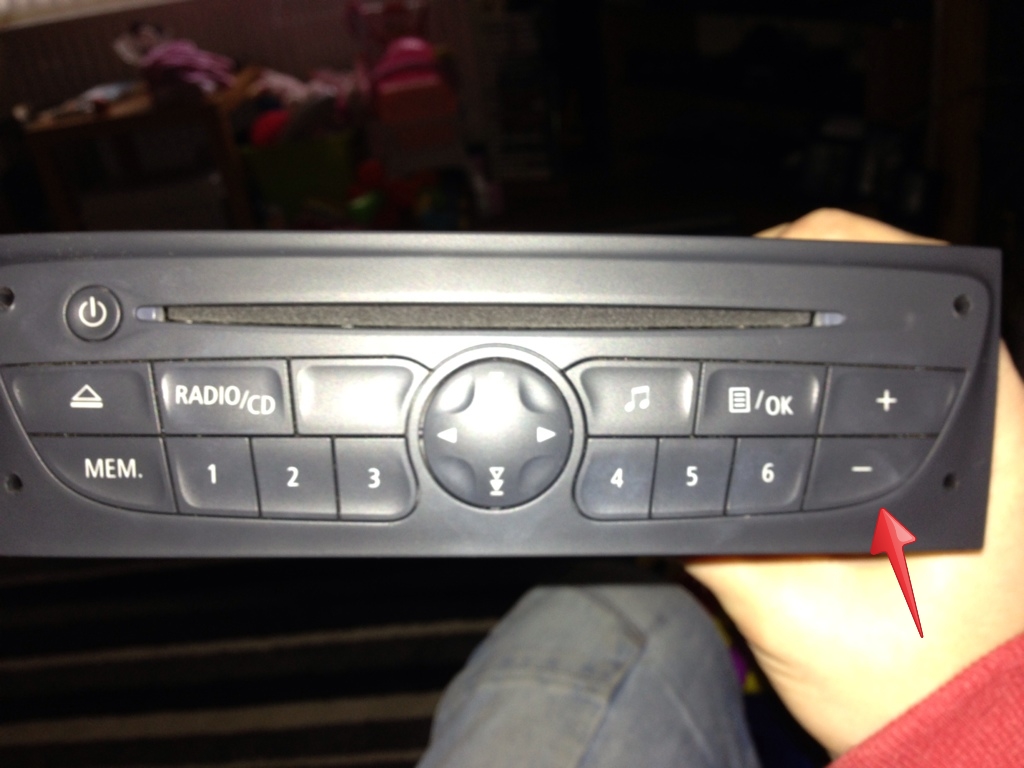

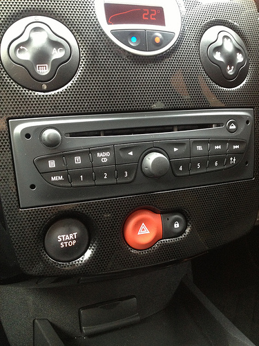

second question, my 200 currently has this head unit in it:
https://www.cliosport.net/attachments/4e96761d-24bf-471e-b9b1-55651d8942f6-jpg.1022686/
can one of these head units be swapped in and just work?
https://www.cliosport.net/attachments/8635512056_98b3f37721-jpg.1022692/
my only aim with both of these questions is just to get bluetooth connectivity in the car but keep it looking as OEM as possible, i would prefer the second way of doing this as i believe those head units have bluetooth, but i don't mind spending the extra notes to go the route of using a alpine as long as it keeps the sub display working
My area of expertise is after market sounds being honest, however the alpine display adaptor is specifically for headunits only with ‘update list’ written on the front, if the 200 display isn’t update list it may well use different protocols and probably wont work, they tend to be very specific to displays and radios they will work with as all displays/cars are different
As for the second question about the radio swap, again it may or may not work, was the second an option for 200’s or is it out of another car completely like a Laguna or Megane, if it’s an option for 200’s then it should work, although displays may be different and model specific, perhaps try asking (not buying! Just get info... but they don’t know that) your local Renault dealer if there is a unit that will do as you require to fit direct in your car... then find one and get it programmed with clip if it needs the vin put in it
Did you ever swap the head units? I picked up a 200 Cup and was hoping to get OEM bluetooth connectivity like you?
If it did work do you know the part number for the bluetooth head unit?
Reactions: Phenom
Never tried tbh, didn't want to throw money at something that I wasn't confident was going to work.
Part number for the headunit is 281159389R but i dont know if you will need the tomtom screen.
if you need the tomtom screen the part number is 259156554R.
as far as i know the headunit should be plug and play to get it woking at least the dashtop screen is were it gets confusing. lots of unsure answers to question on this.
don't know if the bluetooth headunit will work with the normal dash top display as there are a few different versions of that and could never find a clear answer.
if it doesn't work you'll need the tomtom display but your car wont have the loom needed for the tomtom display so will most likely need to source a loom from a tomtom clio or atleast the satnav part of it.

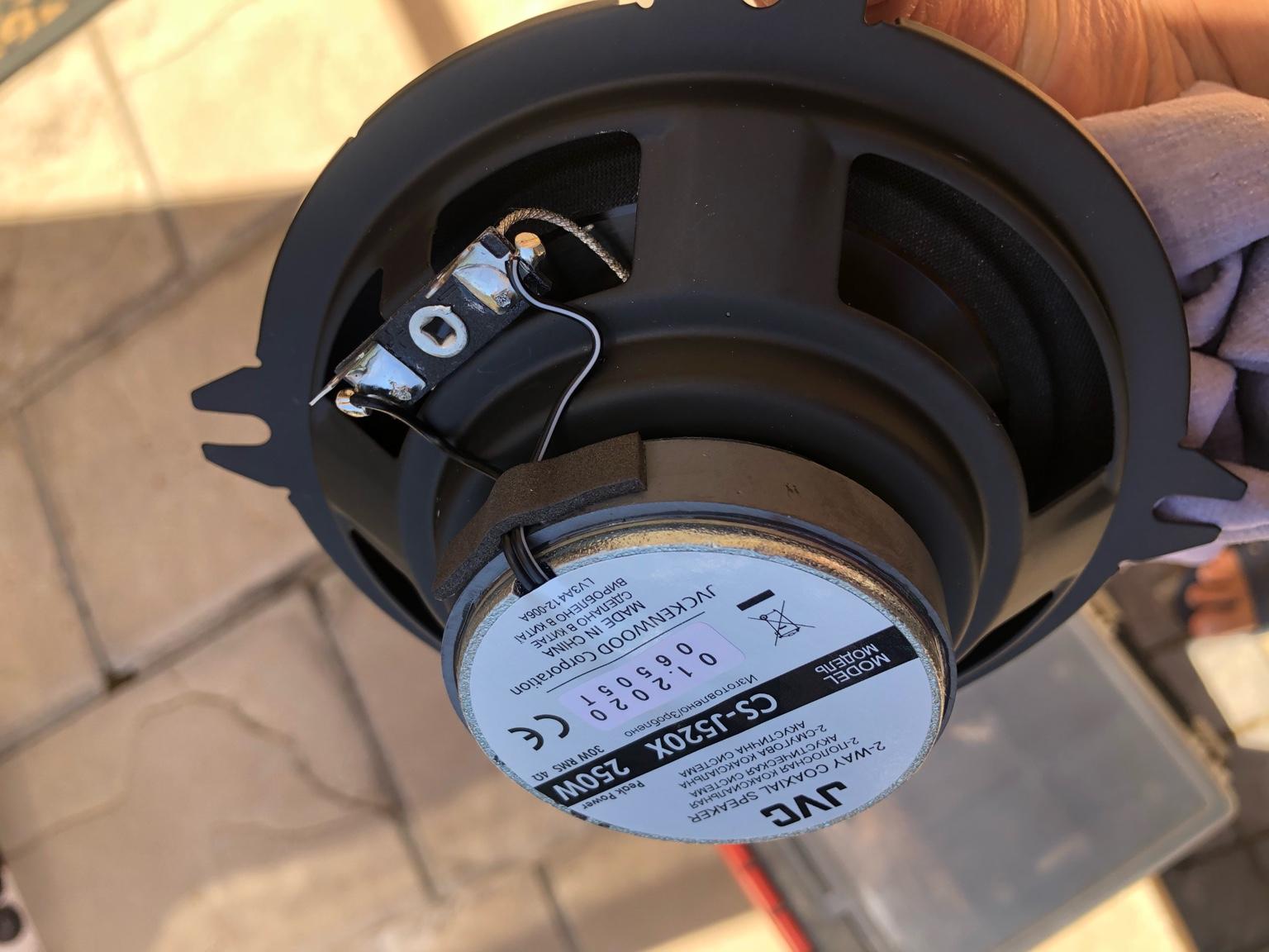

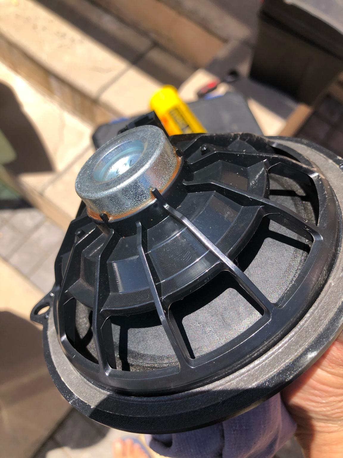

Anyways, I did install the JVC front two way speakers and... all I can say is the standard speakers are definitely better quality than I thought. In fact, even with thier tiny magnet (the JVC is much bigger and feels more substantial) they put out a fair amount of bass.
Interestingly the rear standard speakers are two ways (have a small tweeter in them) so now I’m thinking of swopping them with the front standard speakers.
In terms of head unit, it’s a Pioneer. It is a basic one but had the right features for me (iPod control and 50x4 output and pre out for sub). That alone with the standard speakers and no active sub is a pretty ok setup.

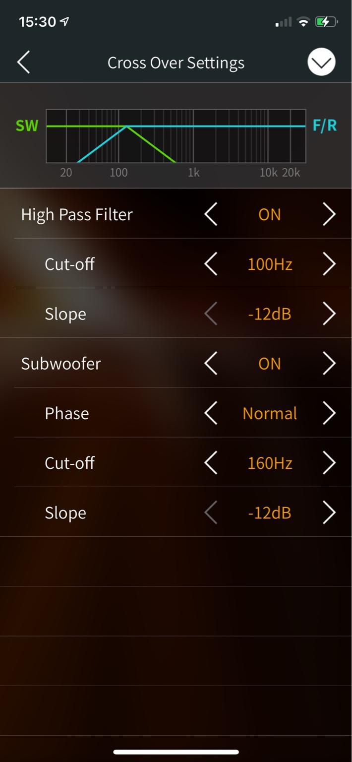

These are the settings I tuned for JVC. I had to send a lot less bass to the JVC (they distort quickly on a lot of bass) but the problem is the active sub isn’t effective enough for the rest.
From my research and other advice, a good quality component speaker setup is my next step if I want to improve the sound. Either that or just fit the big 12 inch sub I also have lying around.
Anyways, appreciate the input. As you can see I’m not an expert and have been playing around. I know a lot more now but it’s all school fees so far :smile:
Standard front speaker
Vs JVC
