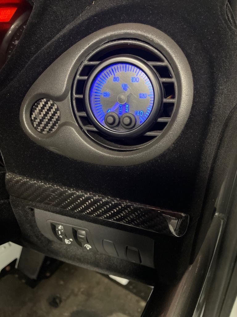

I have an oil temp gauge mounted in the driver side air vent and a Mocal thermostatic cooler.
I mainly use the coloured LED programming for warm up. Blue is cold, white ideal range, red too hot.
On warm/hot days I’m getting 110c maximum after a long session.
Prob overkill, but so is everything else on it [emoji13]
Good to know! How long is "long" session?
45mins to an hour is prob as long as I’d stay out for on a UK track day.
Prob 3 back to back laps of the Ring in summer.
