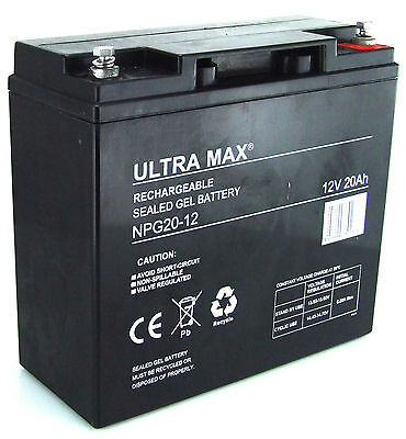

I used a cheap 20ah gel battery in a previous race car, was about 6kg and never let me down on a car used irregularly compared to an everyday.
This one:
This one:
