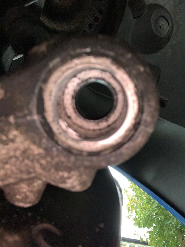

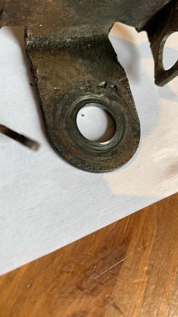

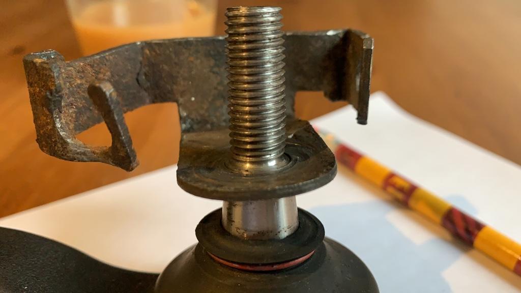

Anyone know where i can get a replacement of this item shown below. Third time its been tightened and keep getting play in it after a few weeks of driving.!!
PITA
These sit in the hub where the track rod end goes. Sometimes they go missing when you change the rod ends
Sheldon88
Is this standard on all years of the 197-200. I think you cracked it
Sheldon88
Make sense will try and find a link and buy a new one!! Cheers buddy
