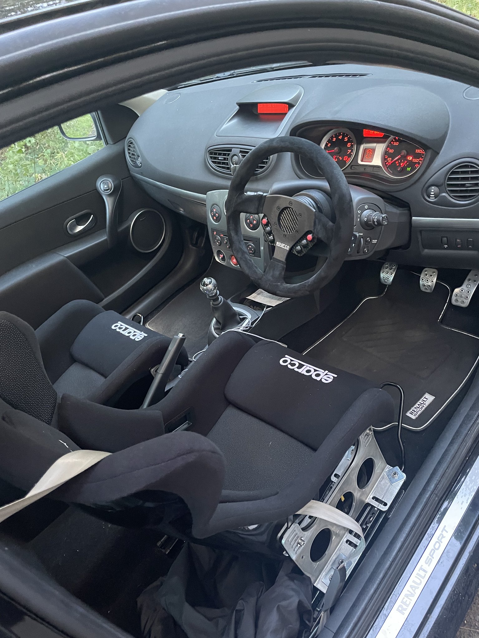

In the meanwhile I've also fitted some buckets (Sparco Grid Q) in place of the standard recaros. I wanted the buckets to be mounted on sliders, but felt that a subframe / side mount setup was somewhat unnecessary (and universal sliders always seem a bit shit from what I can gather).
So I decided to design some sidemounts which fitted directly to the floor, for a first attempt I'm pretty happy with them tbh, some tweaks will be made if I decide to make another.
Next stop is harnesses / half cage.
