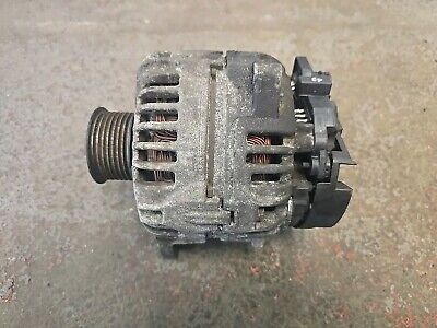

Took some bits off the car in an attempt to get access but still very tight! No idea how to remove belt etc so time for some YouTube training :wink:
Interesting spade connection - looks like it should be fairly easy to attach to the pin on the next one.
Reactions: Sean197
Now that I’ve got some photos… depending on accuracy of the diagram, it looks like the wire below might be connected to the Lamp pin instead of the Field Monitoring pin, which I think means the ECU wouldn’t get any feedback.
Could have totally wrong end of stick, but I think worth a quick test before ordering another part.
Swapping pins made zero difference :worried:
So the old one had to come out… really don’t want to have to do that again, and installing will probably be harder than taking out… so I REALLY hope the next one I try is good!
